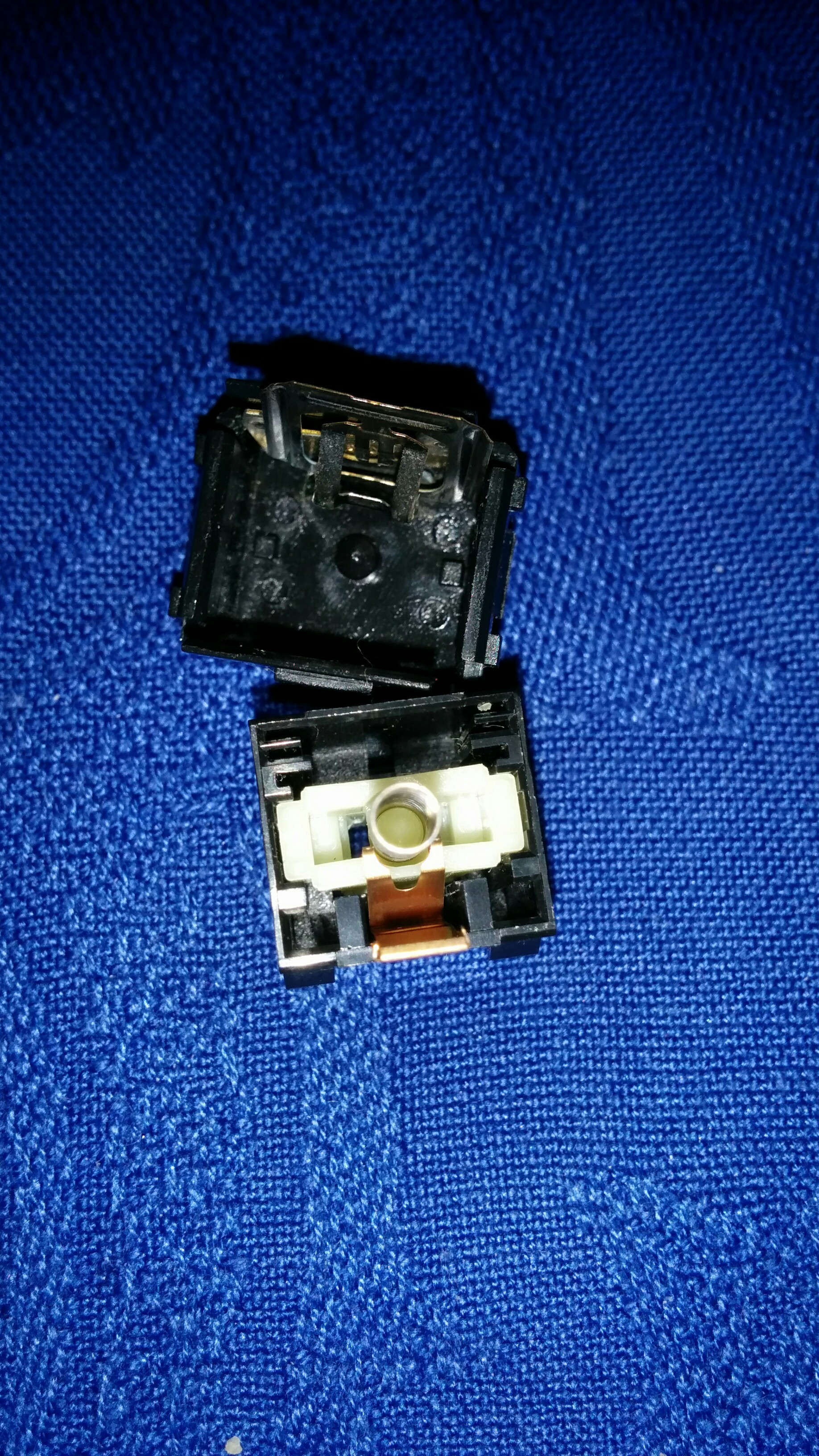

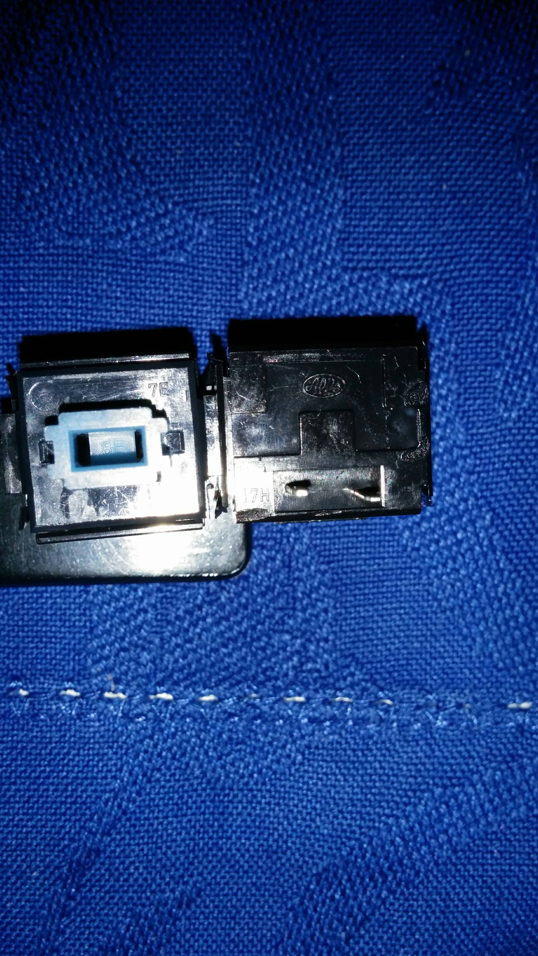

Here's the photos of the white FX disassemble switch and the blue one i've changed with:
- IMG_20140703_230908-A.jpg (780.92 KiB) Viewed 5542 times
- IMG_20140703_232648-A.jpg (829.81 KiB) Viewed 5542 times

You mean non-SMK MiniTouch — Monterey made the MiniTouch (it's a rebadged [wiki]Monterey K110[/wiki]) and the switches were sourced from SMK (the "Monterey" switch) and Himake.
Your switch above appears to be a bog standard alps.tw Type T1, which is an exact match for the photo Hua-Jie sent me of the AK-CN2 (which is no longer sold).

Yes, one uses monterey blue switches and has better caps with blue numpad characters, the other seems to use the exact same type of switches this FX ortek had. Im also switching that one with mathias silent swit i can post pics tomorrow if you want.

I don't personally need photos of modified keyboards, only original products. I always have to bear in mind that keyboards with uncharacteristic switches may be the result of transplants, especially something like blue or white Alps.
The alps.tw Type T1 switch was used by a lot of companies. Monterey bought theirs from Himake, making it an AK-CN2 (confirmed by a photo of an actual AK-CN2 disassembled). (Nobody knows whether the AK-CN2 was preceded by an AK-CN — it's clear that the design of the switch evolved, but whether it was always the AK-CN2, or whether it was called AK-CN before, we may never find out.)
The other companies that used T1 switches included ELSA Communication, Focus (in particular the later FK-2001 production) and Ortek. I forget whether I've confirmed them to be used by Strong Man — Strong Man certainly used switches with the same numbering on them, but unless you open one up you won't know what type it is.
The cheap versions were AK-C5 (clicky) and AK-D5 (linear). [wiki]Alps.tw Type T8[/wiki] is the closest that I've found so far to something matching the specs for AK-C5 and AK-D5. AK-C5 and AK-D5 are now discontinued in favour of AK-CN2 (2) and AK-DN2 (2), which are internally identical to Xiang Min KSB-C and KSB-N respectively, but the numbering is different.
There's a keyboard that rzwv has, though, with Xiang Min numbering but as I recall, T1-like internals, suggesting that Xiang Min used the same metal parts as the AK-CN2 and AK-DN2 previously, but with their own plastic parts and therefore their own numbering.
