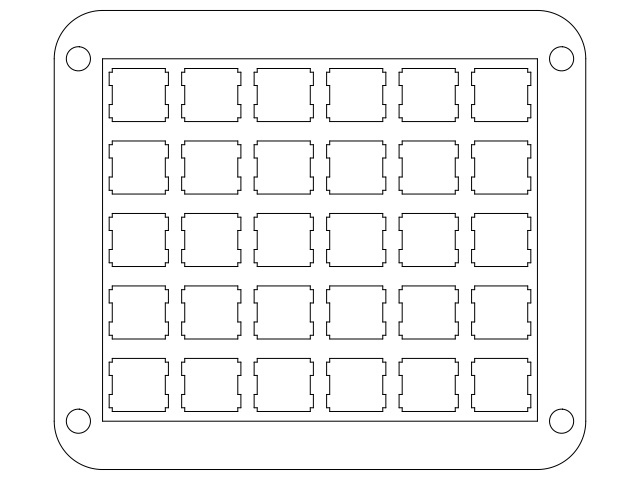

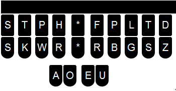

This is for a split (two keyboards) stenograph style keyboard with a numpad on the right hand. Steno doesn't offer an improvement for numeric input, so I'm adding a numpad for the right hand.
Here is the steno layout. For more information on stenography see http://openstenoproject.org/ Here is the proposed new layout with numpad on the right hand: (what program do you use to post keyboard layouts inline?)
left hand: http://www.keyboard-layout-editor.com/# ... 232f6f9d6f
right hand: http://www.keyboard-layout-editor.com/# ... 6c5171746c
This plate ought to work for both left and right.
It should make a fine stenograph for the half dozen people in the world who want that, but I want to use it as an easier to learn chording keyboard similar to the BAT (http://www.infogrip.com/bat-keyboard.html)
What do you think about this idea?
The first prototype might prompt further comments, so I'll post it later this week.

Am I missing something here? A stenograph uses chords to type full words, that BAT keyboard you linked uses key combos to type single letters, which in no way shape or form is more efficient than normal typing like they claim.
Which are you trying to replicate?

Nice idea. Looks like a more practical variant of a steno keyboard.
The lower row of the right hand is shared with the upper numpad row, right? Do you have to toggle numeric input or do use it with the asterisk key?
What are you going to do with the mounting holes that are left empty?

Somewhere in between. The plan is to make words out of phonemes using a dictionary for spelling like steno does. This makes it easier to learn than steno and more efficient than BAT. So the BAT claim of 50 WPM is false?A stenograph uses chords to type full words, that BAT keyboard you linked uses key combos to type single letters, which in no way shape or form is more efficient than normal typing like they claim.

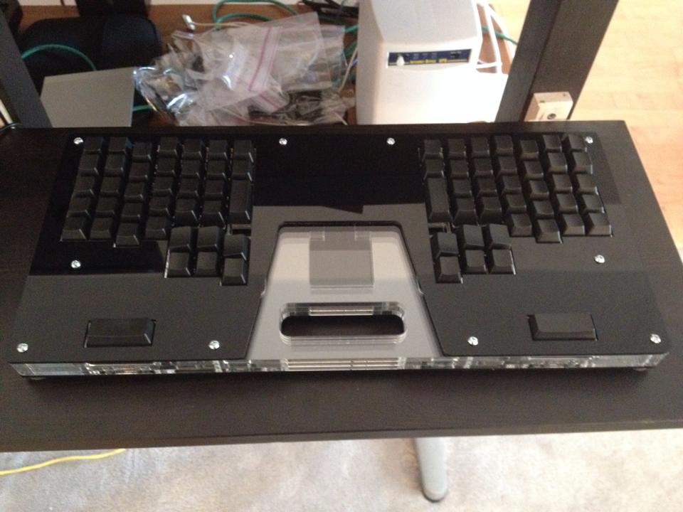

If you are looking for something easy to learn I suggest you check out the Velotype (http://velotype.com/en/) system instead. It doesn't allow you to type quite as fast as steno but it is much easier to learn and doesn't require a dictionary.
Also chording keyboards require lighter key activation force to be comfortable. You can lower cherry MX Red switch force to about 25g by cutting the 1.5cm springs down to 1cm. This gives keys which don't feel nice for normal typing but feel much more comfortable when typing multiple keys at once.
I'm currently building a Velotype based chording keyboard and have just finished the case. I just have to write the firmware and wire up the matrix and controller. It has way more keys than are necessary so that it can also be used with normal layouts, only the main chording keys have the modified switches. I've attached a picture, the CAD files can be found at https://github.com/trishume/KeyboardCAD.
- Picture of my Velotype based keyboard.
- 10552639_830175060328760_802484554600611975_n.jpg (69.86 KiB) Viewed 10389 times

In other news, I finished all the soldering for my keyboard, now I just have to write the firmware to support chorded typing.

I just wrote up a build log with more info about my keyboard: http://thume.ca/2014/09/08/creating-a-k ... -hardware/

It must be a lot different than the keyboard stenography layout
(where most fingers are sometimes often pressing 2 keys each,
except the right pinky sometimes has to press 4 keys at once).
