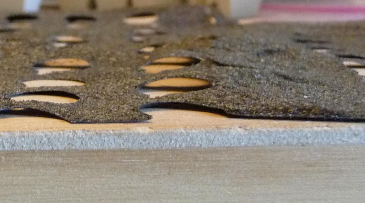

I'd say it's possible to wiggle the barrels a little more easily in the middle (ASDF) row than the others. However, I have a NIB 3178 for comparison, and those middle-row barrels wiggle a little too. I think the foam is still in contact with the barrels in either case, just under less compression. On the other hand, I have an old AT that I haven't restored yet, and a few of the barrels are really loose, to the point that you can feel and hear the difference when hitting a key.
I took the liberty of cutting the old Unsaver foam down the middle, and you can see that it's compressed almost paper thin in the middle rows.
I think the most important attribute of the foam is that it is super soft. The foam sheets found in craft stores don't seem to be as soft, at least not the ones I've come across. If the foam is thicker but less deformable, it's only going to push the barrels further away from the top plate. This can result in the key bottoming out without actuating, particularly around the stabilizer anchors. I had this problem when I tried 2.4 mm (3/32") supposedly "soft" silicone. If you can find it, I'd say super soft foam between 2-2.5 mm might be just about perfect. If you do find some that's not outrageously expensive, please let us know!

I still think that the "art foam" is a good choice, although it is fairly thick and makes it considerably harder to get the plates back together.
Personally, I feel like the added compression between the plates enhances the feel and possibly dampens the sound a bit, but that is an ideal trade-off for me.
At Michael's art supply there is a wide range of colors, a single sheet costing less than a dollar will do it for an F-122, and it is supposed acid-free for use in art projects and scrapbooking.
One day I may try a higher-tech sheet of something like silicone. I think that it is worth the wrestling match with the thicker and firmer products to get the extra compression.

I used 1/8-inch silicone foam on an XT. It was indeed a wrestling match to get the plates to slide into position, but I agree with fohat's assessment that the added compression enhances the feel and perhaps dampens the sound.
When I was sliding the XT plates, I had the impression that I was mainly fighting against the friction between the plates and the surface of the foam, although compression was a factor as well. This makes me wonder if some kind of non-petroleum lubricant could be applied to the surface of the foam -- perhaps silicone oil or a dry teflon lubricant -- to allow the plates to slide more easily. Any ideas on this?

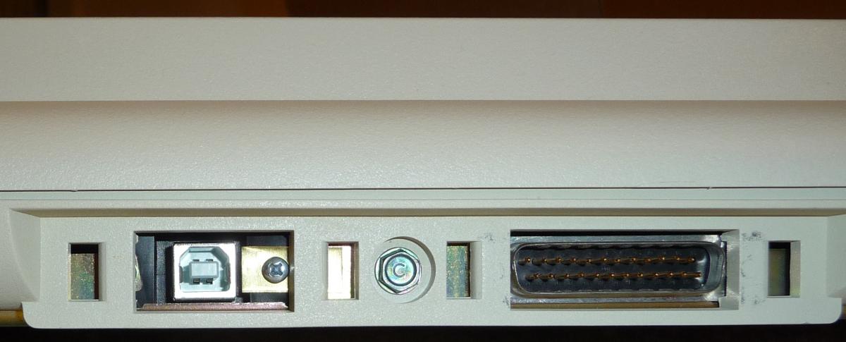

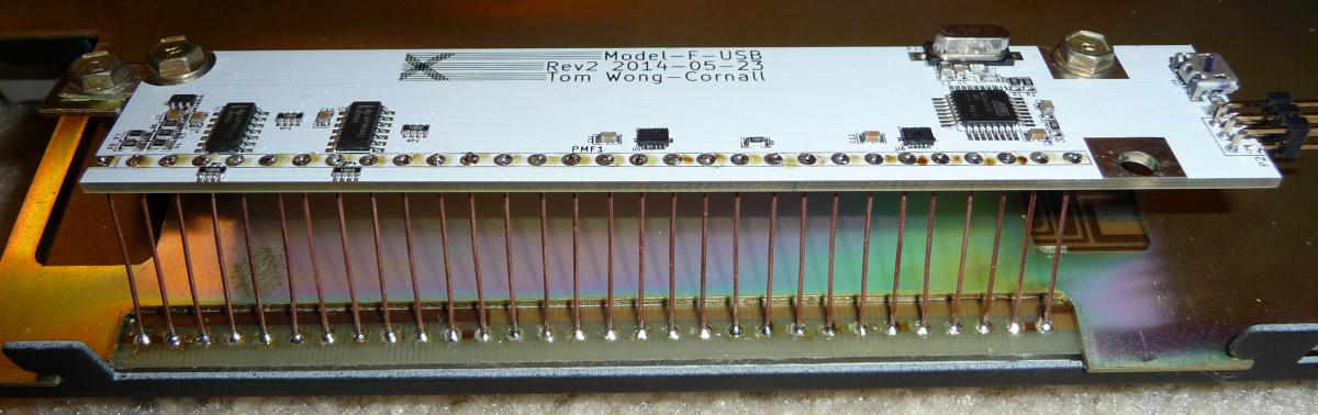

I installed an xwhatsit controller last night...
...and tonight I installed a USB connector in back in place of the 15-pin D connector.
I might install one of those nice, metal Amphenol connectors...
...at some point, but what I have will do the job until then.
