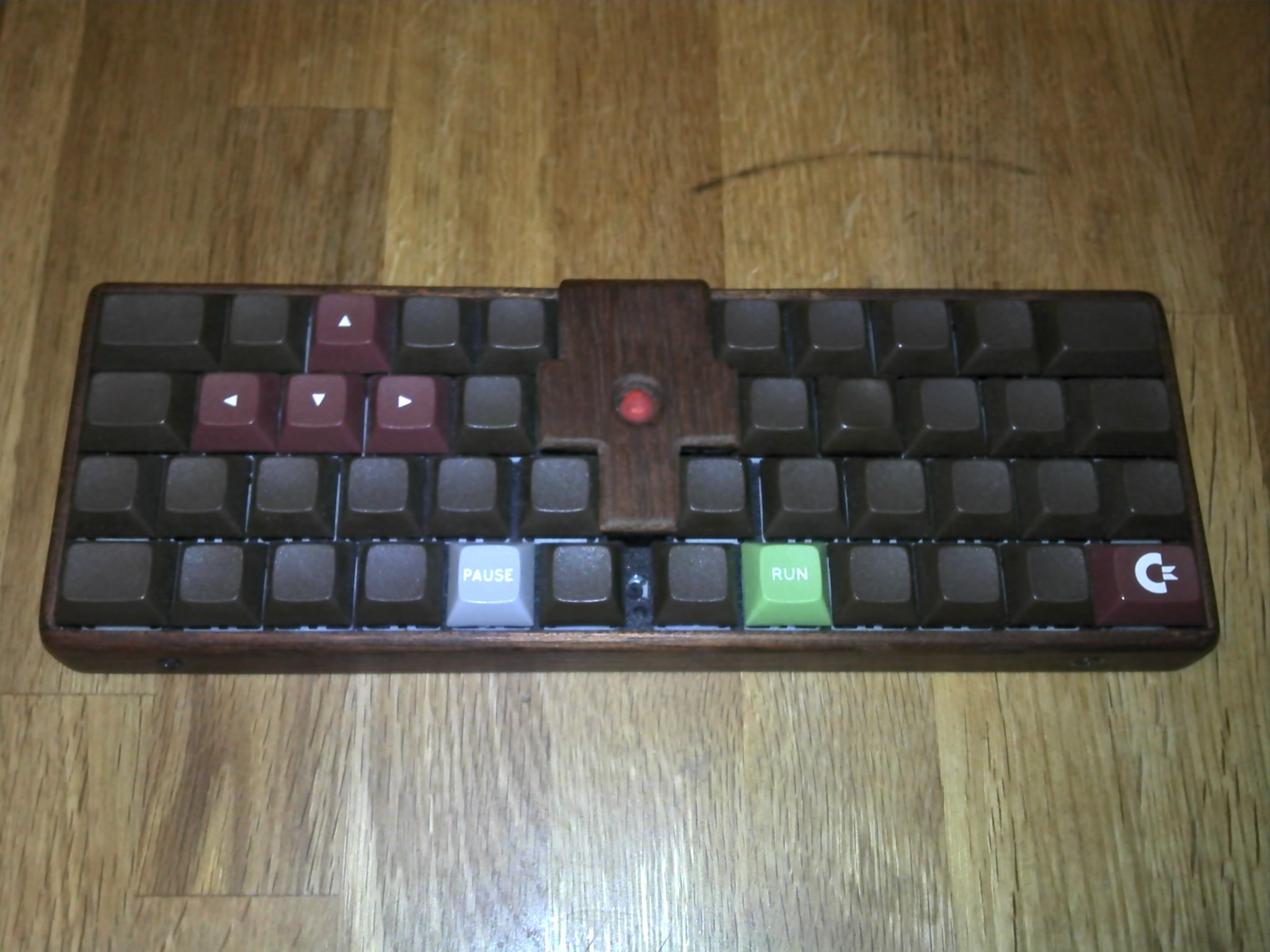

The fastest way would be to get a plate cut or have it 3D-printed and then hand-wiring the switches. Unless of course you can base your design on a pre-existing PCB. But the physical layout for a single plate is much easier to design and most probably more appropriate for a prototype.
Case design can then be done at a latter stage like you can see at my HyperNano with a retrofit mahagony frame

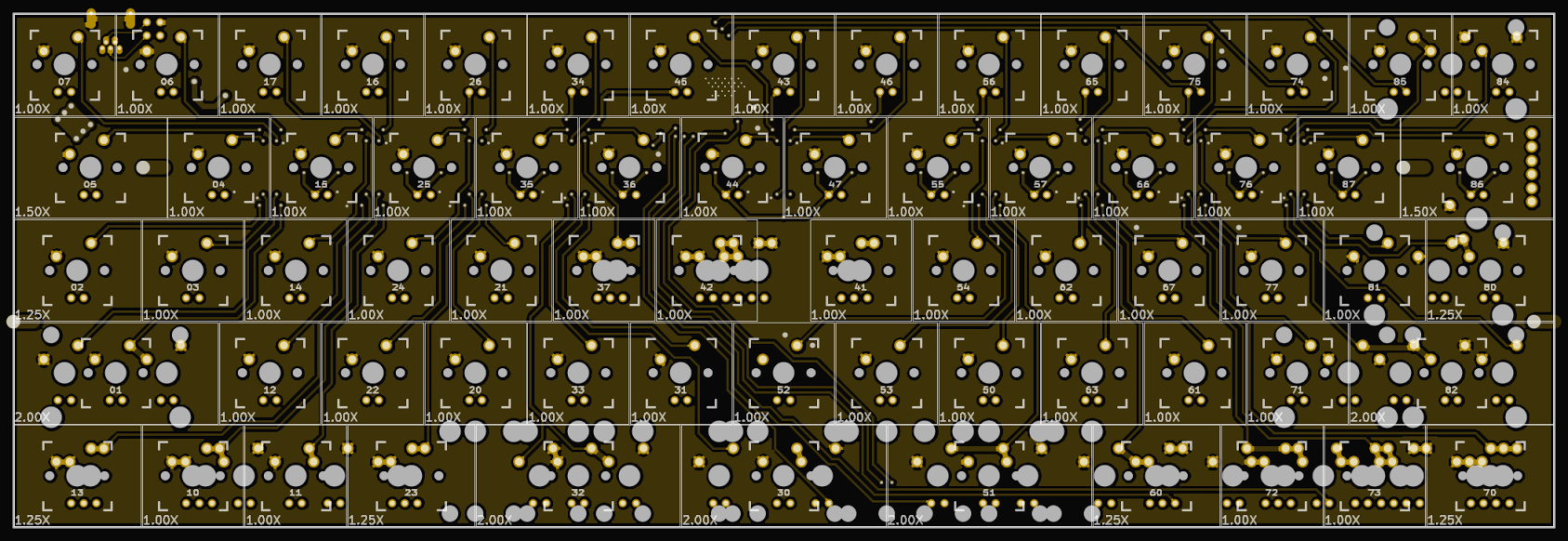

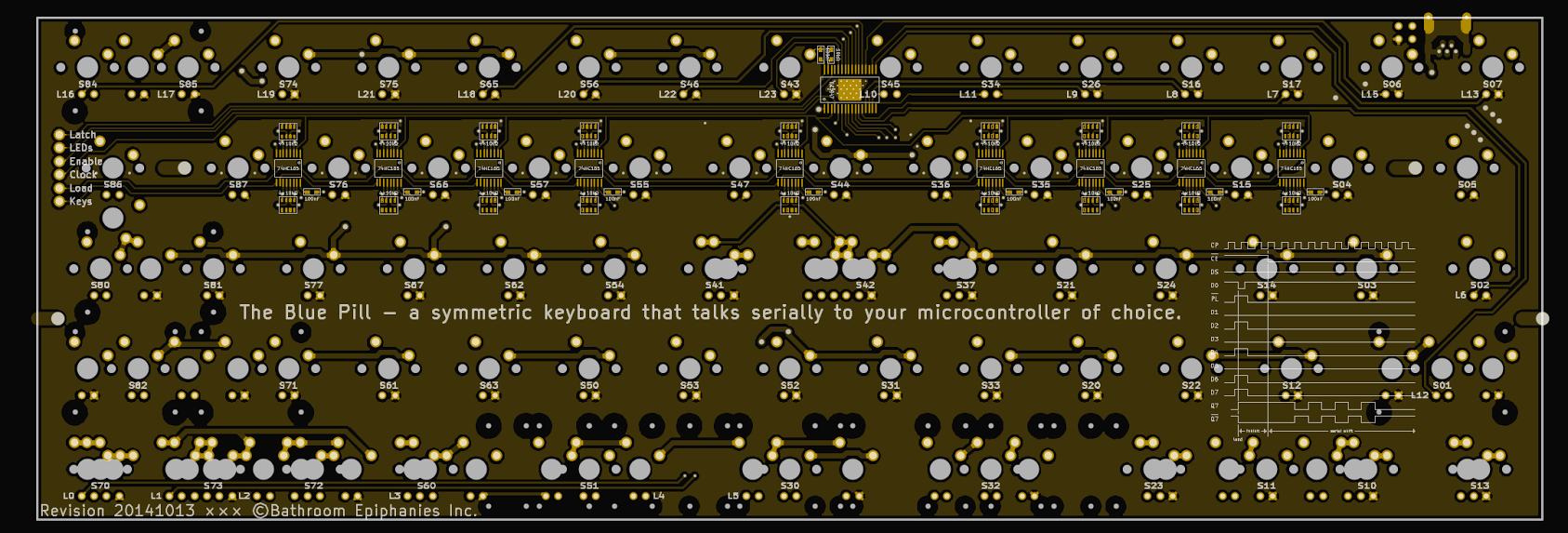

I made the PCB for this keyboard quite a while back now. My beta testers have been a bit slow on producing code for it this far.. I wrote a firmware for it myself, but that only handles the keys. There is also 21 or so LEDs on different keys. The whole thing uses serial communication, both for reading the keys and lighting the LEDs. It fits the Poker case.pietergen wrote: What would be the fastest way to make this board? I would solder the switches onto a PCB, no plate. Would I have to design the PCB myself, or do you guys know of existing designs that I could use/ alter etc.
I thought this is related to the Hyper Micro, if not, please put it in the right subforum, mod! Thanks.
I just don't seem to have a photo of the PCB anywhere =P Here is an old render. Top and bottom.

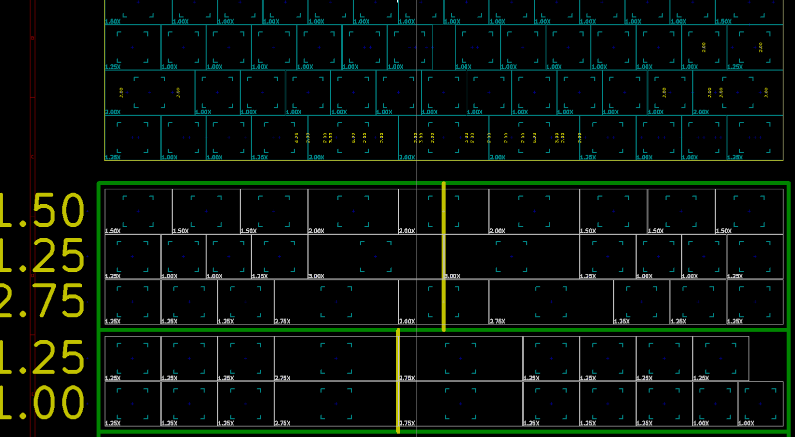

All these setups should be in the final version of the PCB. I don't think it is possible to put three 1 unit keys in the bottom right corner.. The shift key splits into two independent keys, if I remember correctly at the moment.
The gap in the home row can be shifted one position to the left to support a more conventional layout. There are two sets of space bar row configurations to suit the different gap placements. (I think I also added support for the regular Filco style space bar row with a 6.25 unit space bar.)
Many, but not all switch locations are compatible with PCB mount pins. The stabilizer PCB mount holes needs to be drilled depending on the chosen layout. They interfere too much to all be drilled.
The ICs are nine 165-PISO shift registers http://www.ti.com/product/sn74hc165
and one TLC5947 LED driver http://www.ti.com/product/TLC5947
In addition to that a micro controller is needed to drive the whole thing. The Teensy fits into the Poker case under the PCB. Some wiring is then required to hook everything up. I made a mess on the one I built, but I will clean that up once everything is set, hot melt gluing the Teensy into place.
