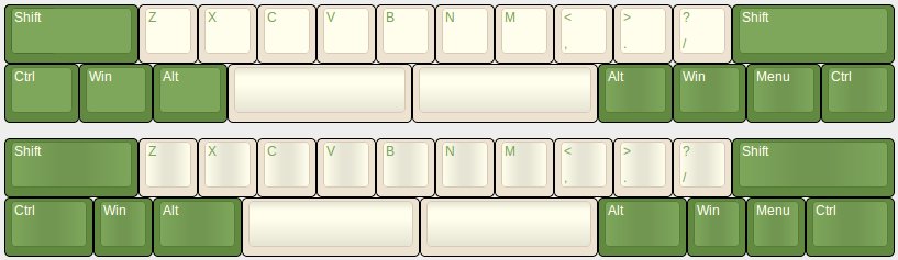

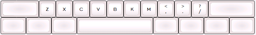

Without stepped keys, there is exactly one reasonable configuration where the bottom row mods are all the same size and the space bar is centered:
Many keyboards have different sized modifier keys or the space bar is off-center slightly, or both; which is fine I guess, but we can do better:
This arrangement also visually separates the modifier keys from the normal keys not only by size, but spacing, which I think is an underused design element. Of course you could just use 1.25U modifiers spaced out like that, but then the top of the case would have to have little prongs to fill the space and it would be ugly.

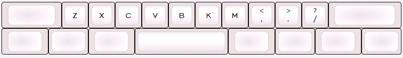

Here is a variation:

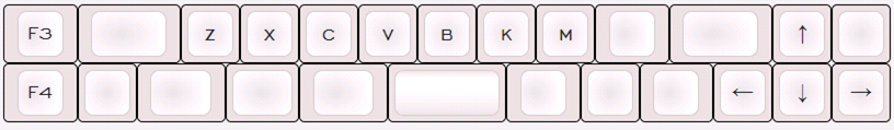

Having stepped and hat keys in the design palette gives you options when you are working on weird layouts, for example with the arrow keys integrated into the right hand side of a 60% board, how do you visually separate the arrow keys from the right hand modifiers? Here's one way:
Mind you, these are very narrow hats we're talking about here, the "brim" is only 0.125U on each of these.

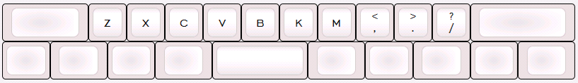

This is such a silly nonsensical constraint to apply to designs. Here, have some better symmetry and more usable modifier positions:
(Though the right shift is still a key too far away. Better would be to add a column between hands, and move the slash key elsewhere on the keyboard.)

Okay fine... better would be something with two split hands, more space between finger and thumb keys, and not arranged in a rectangular grid-like pattern.
But while we’re leaving those as constraints, this works pretty well, in my tests on little prototypes.
Also, if you like, ignore the key labels. Use those “win” keys for some kind of function layers, move shift to be directly to the sides of the pinkies and put a few symbol keys to be where the shifts currently are, etc.
Making the bottom row symmetric relative to the “home row” and concentrating it toward the center of the keyboard is a very significant improvement over the brain-dead bottom row on a standard keyboard.
