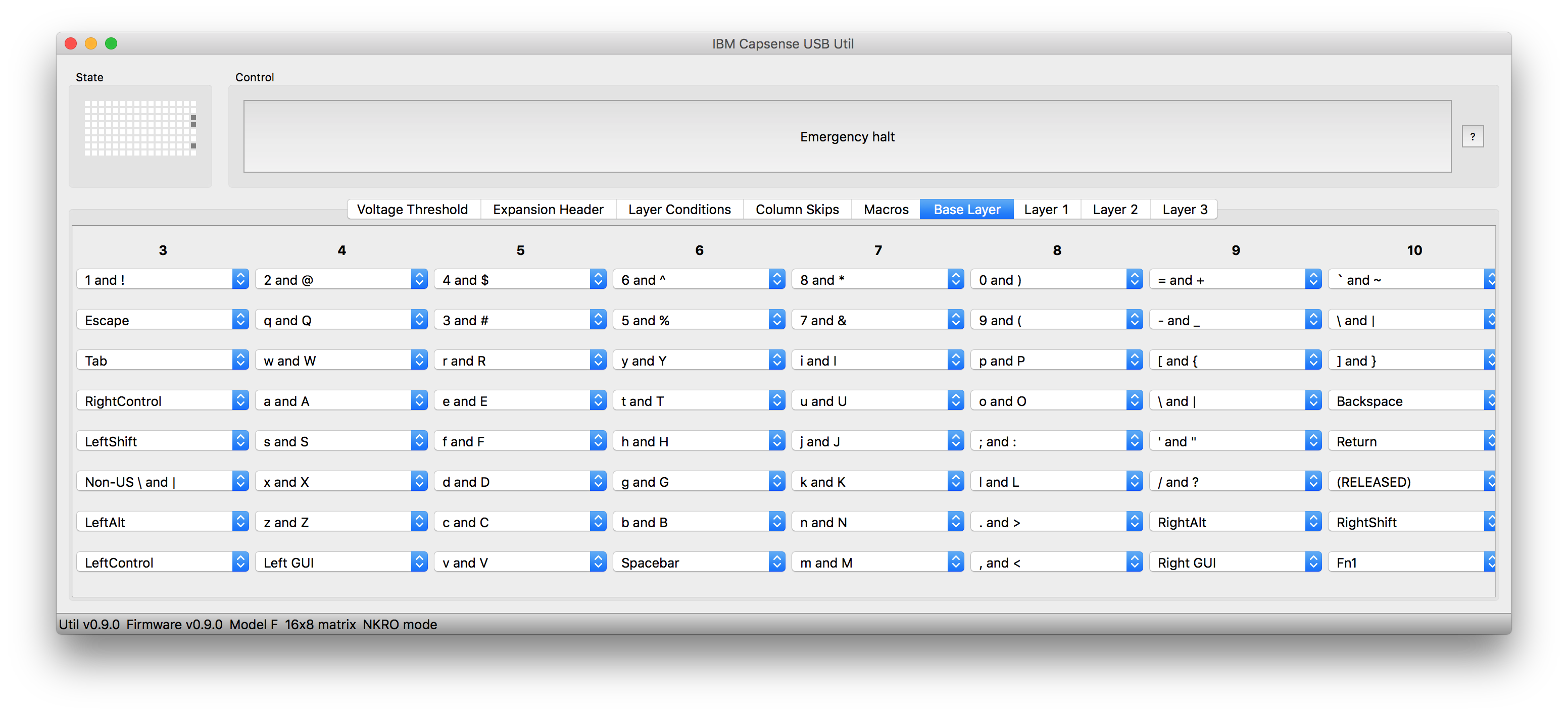

That's how I have my Kishsaver mapped. Pure HHKB style. Caps Lock is Control. Shift + Shift = Caps Lock macro. The two extra keys (the red Control keys in the photo) are the interesting ones. I use the one on the right as Fn of course, which is missing from where it should be on an HHKB.
The left corner key, meanwhile, I use as another Control — my fingers insist on using it when they feel it's there! — and I have layer lock macros setup when I use it with the number row. Control + 1 = navigation layer lock. Control + 2 = numpad layer lock. Control + Esc = return to base layer.
Here's my config:
That extra key is the thing I miss when I'm on my real HHKB. And my macros. Xwhatsit's controller inside my Kishsaver is much more powerful than the HHKB's.
Here's my config:
# Base Layer
0x02 0x02 0x1e 0x1f 0x21 0x23 0x25 0x27 0x2e 0x35 0x02 0x02 0x02 0x02 0x02 0x02
0x02 0x02 0x29 0x14 0x20 0x22 0x24 0x26 0x2d 0x31 0x02 0x02 0x02 0x02 0x02 0x02
0x02 0x02 0x2b 0x1a 0x15 0x1c 0x0c 0x13 0x2f 0x30 0x02 0x02 0x02 0x02 0x02 0x01
0x02 0x02 0xe4 0x04 0x08 0x17 0x18 0x12 0x31 0x2a 0x02 0x02 0x02 0x02 0x02 0x01
0x02 0x02 0xe1 0x16 0x09 0x0b 0x0d 0x33 0x34 0x28 0x02 0x02 0x02 0x02 0x02 0x02
0x02 0x02 0x64 0x1b 0x07 0x0a 0x0e 0x0f 0x38 0x02 0x02 0x02 0x02 0x02 0x02 0x02
0x02 0x02 0xe2 0x1d 0x06 0x05 0x11 0x37 0xe6 0xe5 0x02 0x02 0x02 0x02 0x02 0x01
0x02 0x02 0xe0 0xe3 0x19 0x2c 0x10 0x36 0xe7 0xd0 0x02 0x02 0x02 0x02 0x02 0x02
# Layer 1
0x00 0x00 0x3a 0x3b 0x3d 0x3f 0x41 0x43 0x45 0x4c 0x00 0x00 0x00 0x00 0x00 0x00
0x00 0x00 0xa5 0x00 0x3c 0x3e 0x40 0x42 0x44 0x49 0x00 0x00 0x00 0x00 0x00 0x00
0x00 0x00 0x39 0x00 0x00 0x00 0x46 0x48 0x52 0x00 0x00 0x00 0x00 0x00 0x00 0x00
0x00 0x00 0xe4 0x81 0x00 0x00 0x00 0x47 0x32 0x4c 0x00 0x00 0x00 0x00 0x00 0x00
0x00 0x00 0xe1 0x80 0x00 0x55 0x54 0x50 0x4f 0x58 0x00 0x00 0x00 0x00 0x00 0x00
0x00 0x00 0x87 0x00 0x7f 0x4d 0x4a 0x4b 0x51 0x00 0x00 0x00 0x00 0x00 0x00 0x00
0x00 0x00 0xe2 0x00 0x00 0x03 0x57 0x4e 0xe6 0xe5 0x00 0x00 0x00 0x00 0x00 0x00
0x00 0x00 0xe0 0xe3 0x4e 0x2c 0x56 0x4d 0xe7 0xd0 0x00 0x00 0x00 0x00 0x00 0x00
# Layer 2
0x00 0x00 0x1e 0x1f 0x00 0x00 0x60 0x00 0x57 0x00 0x00 0x00 0x00 0x00 0x00 0x00
0x00 0x00 0x29 0x00 0x20 0x00 0x5f 0x61 0x56 0x00 0x00 0x00 0x00 0x00 0x00 0x00
0x00 0x00 0x00 0x00 0x00 0x00 0x5d 0x00 0x00 0x00 0x00 0x00 0x00 0x00 0x00 0x00
0x00 0x00 0xe4 0x00 0x00 0x00 0x5c 0x5e 0x00 0x00 0x00 0x00 0x00 0x00 0x00 0x00
0x00 0x00 0x00 0x00 0x00 0x00 0x59 0x55 0x00 0x58 0x00 0x00 0x00 0x00 0x00 0x00
0x00 0x00 0x00 0x00 0x00 0x00 0x5a 0x5b 0x54 0x00 0x00 0x00 0x00 0x00 0x00 0x00
0x00 0x00 0xe2 0x00 0x00 0x00 0x00 0x63 0xe6 0xe5 0x00 0x00 0x00 0x00 0x00 0x00
0x00 0x00 0xe0 0xe3 0x00 0x2c 0x62 0x00 0xe7 0xd0 0x00 0x00 0x00 0x00 0x00 0x00
# Layer 3
0x00 0x00 0x1e 0x1f 0x00 0x00 0x00 0x00 0x00 0x00 0x00 0x00 0x00 0x00 0x00 0x00
0x00 0x00 0x29 0x00 0x20 0x00 0x00 0x00 0x00 0x00 0x00 0x00 0x00 0x00 0x00 0x00
0x00 0x00 0x00 0x00 0x00 0x00 0x00 0x00 0x00 0x00 0x00 0x00 0x00 0x00 0x00 0x00
0x00 0x00 0xe4 0x00 0x00 0x00 0x00 0x00 0x00 0x00 0x00 0x00 0x00 0x00 0x00 0x00
0x00 0x00 0xe0 0x00 0x00 0x00 0x00 0x00 0x00 0x00 0x00 0x00 0x00 0x00 0x00 0x00
# Layer Conditions
(1 0 0) 1
(0 1 0) 2
(1 1 0) 3
(0 0 0) 1
(0 0 0) 1
(0 0 0) 1
(0 0 0) 1
(0 0 0) 1
# Column Skips
[1 1 0 0 0 0 0 0 0 0 1 1 1 1 1 0]
# Expansion header
+ 1 50 60

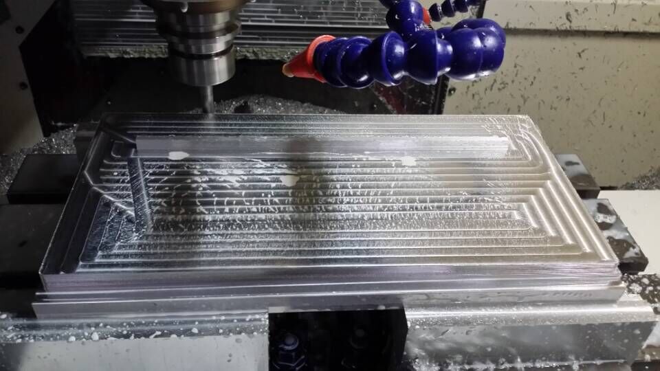

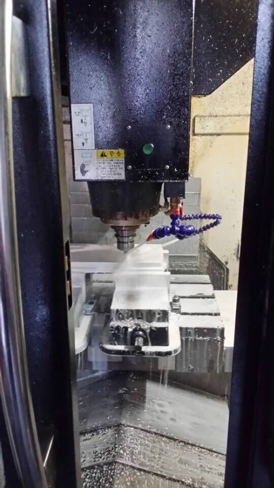

The final major piece of the project is currently in production. The factory sent me some photos of the aluminum case prototypes in the CNC milling machine. In the second photo you can sort of recognize the keyboard's distinctive "pencil holder" bar. CNC milled prototypes are very expensive - they essentially take a block of solid aluminum and go inch by inch with drills and other tools to remove a bit of aluminum at a time.
