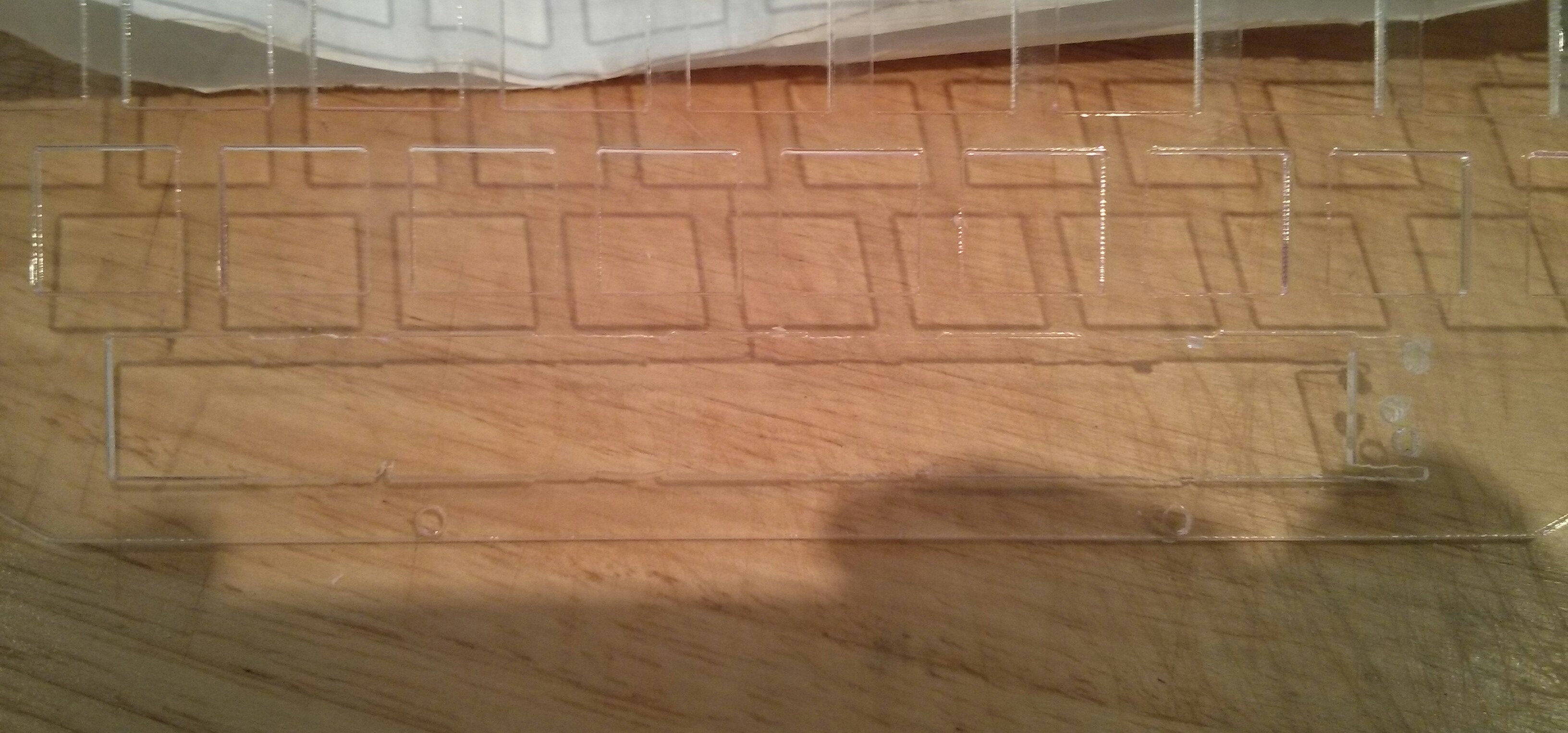

So, we started putting it together. All was going well:
Until we discovered that the top plate I had cut had the bottom row switches 0.5u out! So we then cut it all into 1 big slot where they will actually fit...

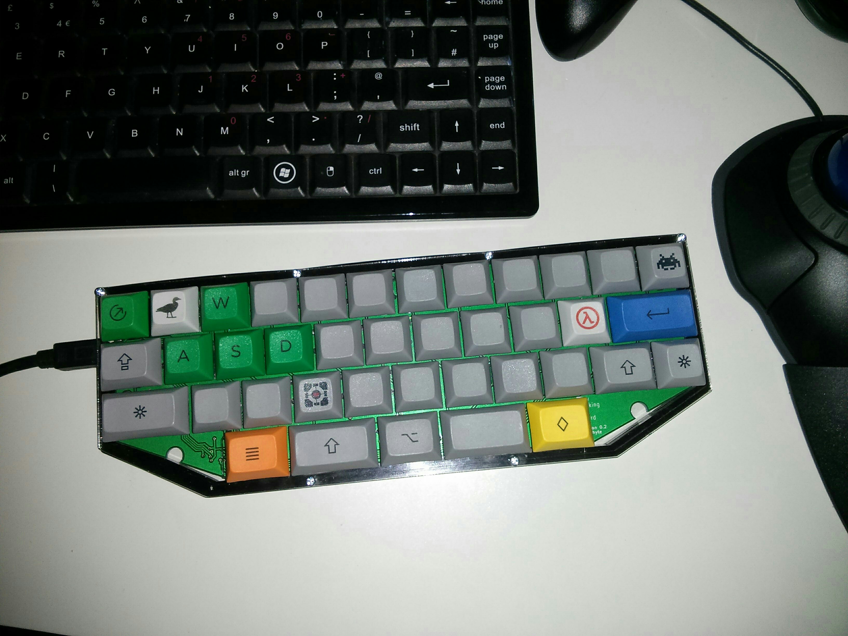

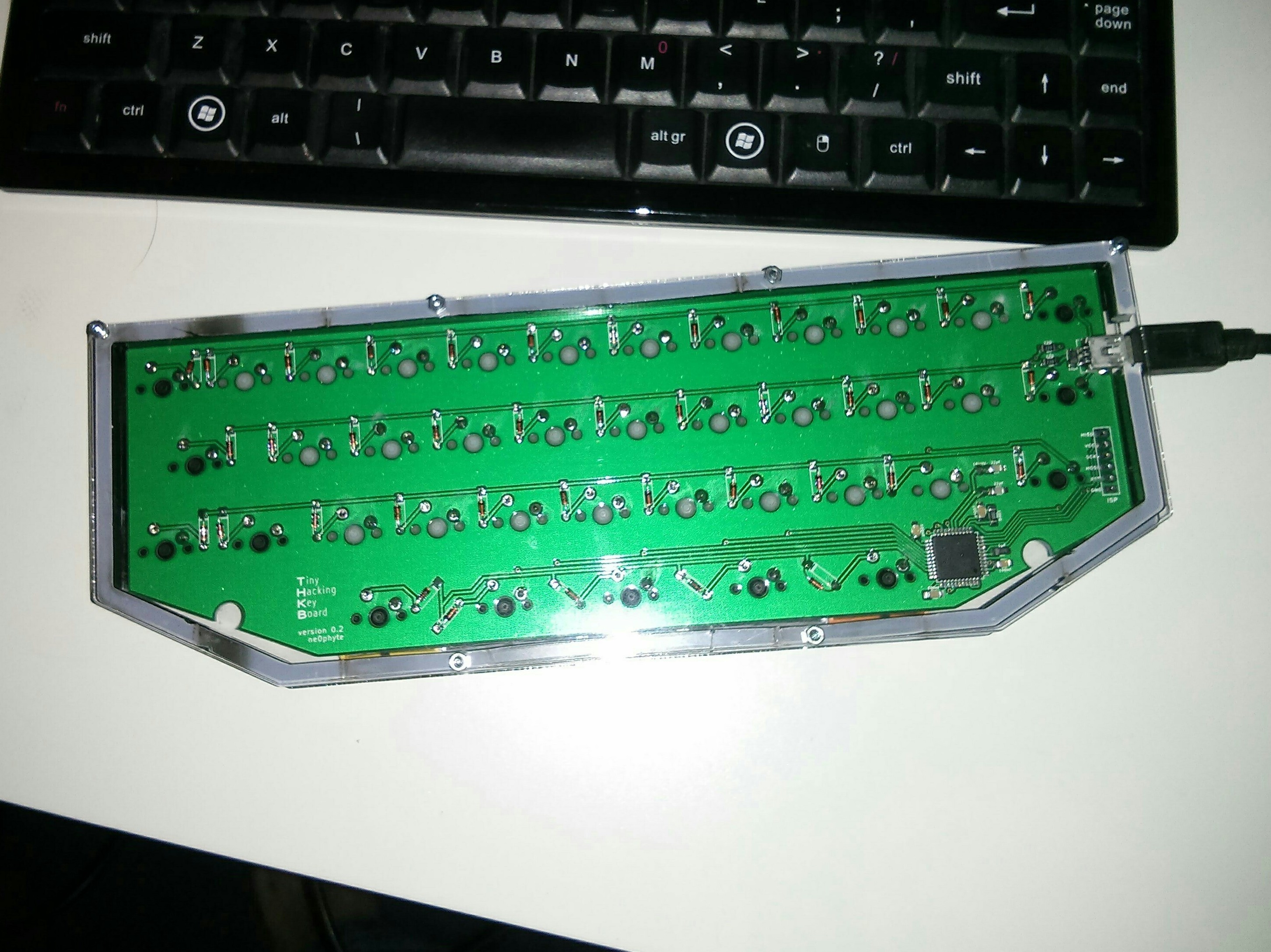

Finally got her built! I can provide the files I used for the case if anyone wants, but there are some issues with them which I'll try to fix if anyone wants them!
The case is built from black and clear acrylic (so you can see the pcb through the top and bottom) and I've used a mix of Gateron brown switches (for the alphas) and Cherry blues (or the mods). The keycaps are kind of whatever I had lying around.
Thanks to ne0phyte for all the work he's put in on this great little project and for the help he gave me with programming it!

- Plasmodium
- Location: UK
- Main keyboard: QPAD MK80
- Main mouse: Logitech LX3
- Favorite switch: Cherry brown
Thanks! There are definitely some issues with it but overall I'm very pleased with the effect. Still getting used to typing on blanks (and it's not even fully blank!) and finding my punctuation on different layers!

Hi folks, here's mine (without a case, I'm not good with materials...)
A couple of caps have a wrong profile of course, most notably the R2 control.
However, I found out I can't get used to the bottom row layout, the middle 1.25u key confuses the hell out of me. So if anyone's interested, I can pass on the PCB (with everything soldered except the switches) to someone else in Europe for £20 shipped ('s what I paid for it). Here's a pic of the soldering. EDIT: ... aaand it's taken.

Those are SA Retro. The SA profile caps are made (these days) by Signature Plastics, and they're more-less available only through group buys or second-hand.

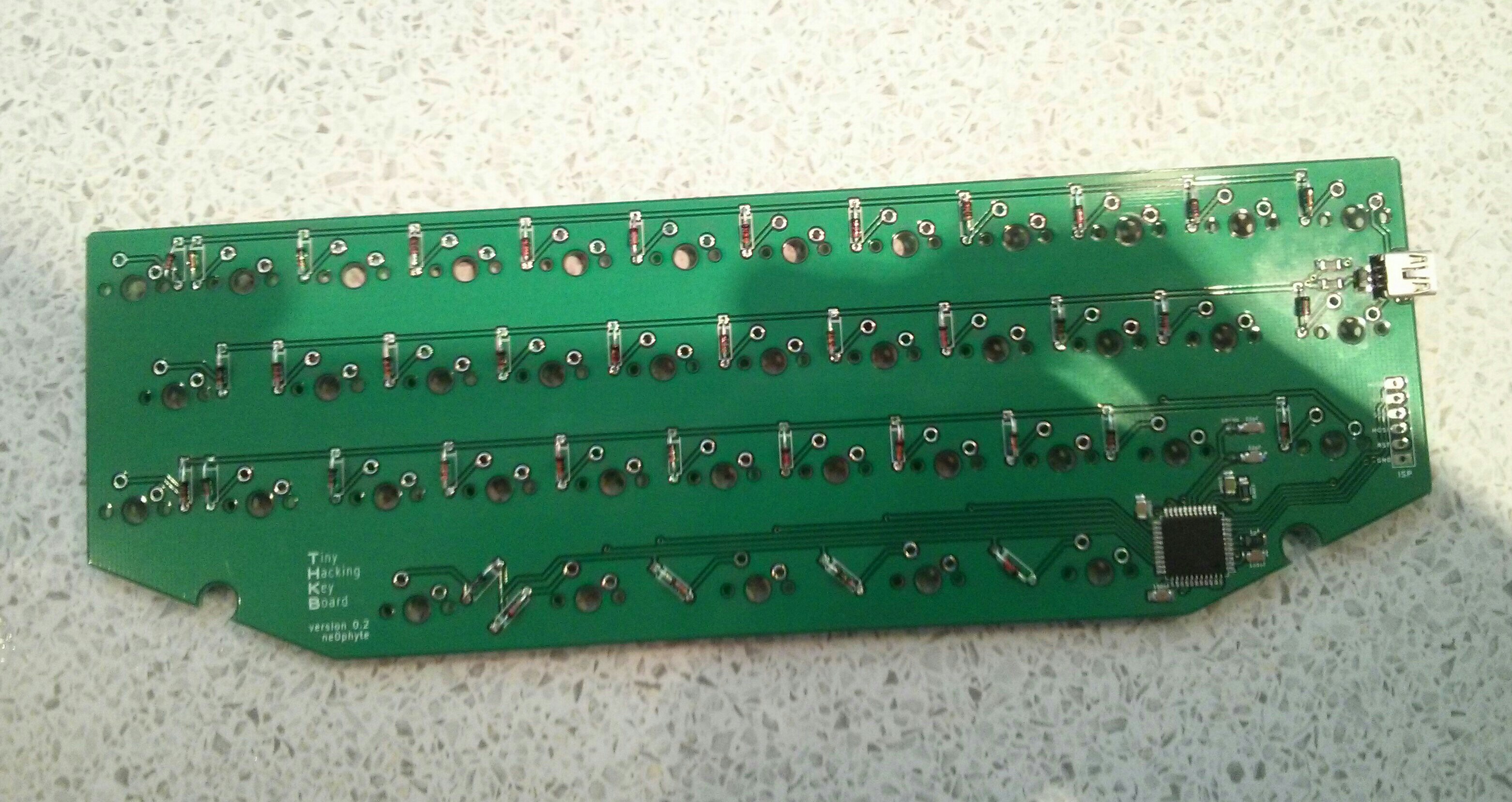

Aaand I'm back once again
I stumbled across a box with the components to assemble ~25 THKBs today which motivated me to work on the PCB again. Just a few little things that were missing and keeping me from ordering the next batch.
LED
I was unsure if/where to put LEDs so I went with something easy to do: one 5050 RGBW LED in the bottom left.
The idea behind that is to have a little hole or slit in the mountplate and a piece of translucent plastic on the back.
A little RGB dot/line should suffice to show some status (like which layer is active) and it's very minimal.
-> Any opinions on this? It probably won't work without a mount plate (too bright)..

I think I mentioned this a while ago already: USB is now on the top side of the PCB which reduces the case thickness even further.
Toast
Was curious if I could put my avatar on it
Screw holes
Changed the diameter to 3.3mm, which is between the tight and normal fit recommendation for M3 screws.
Latest PCB rendering:

Great to see you back! The prototype was such a fun project, I hope you are able to finish this!
Is it just me or are some of the switches mounted sideways on the new PCB?

Ah! Careful with mounting switches at 90 degree angle: http://blog.komar.be/gh60-evolution/

I changed the 90 degree switches back and added another RGBW LED on the right. I really hope the LEDs turn out good, I'm still worried whether it's a good idea because it most likely won't work without a mount plate...
You can dim the LEDs, but plain 5050 (5x5mm) LEDs aren't pretty to look at
EDIT: How about soldering pads on both side so you could optionally put the LED on the back and leave a little hole in the case? Or maybe even both sides.
