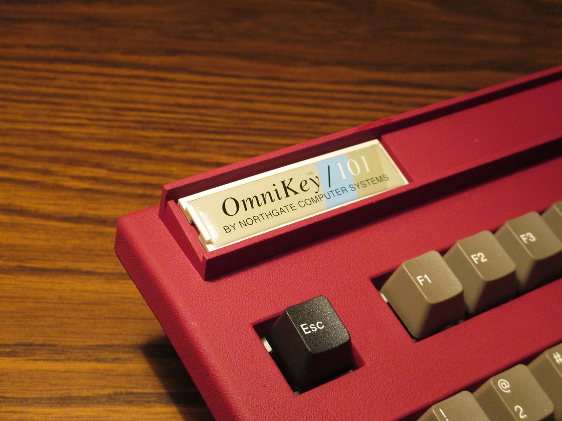

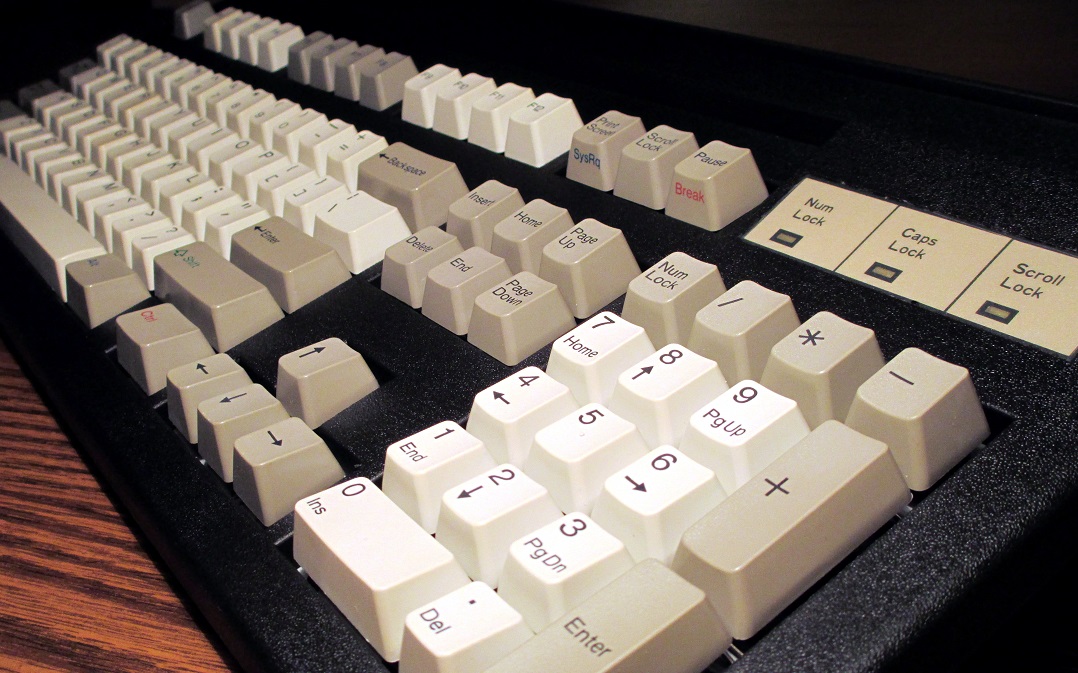

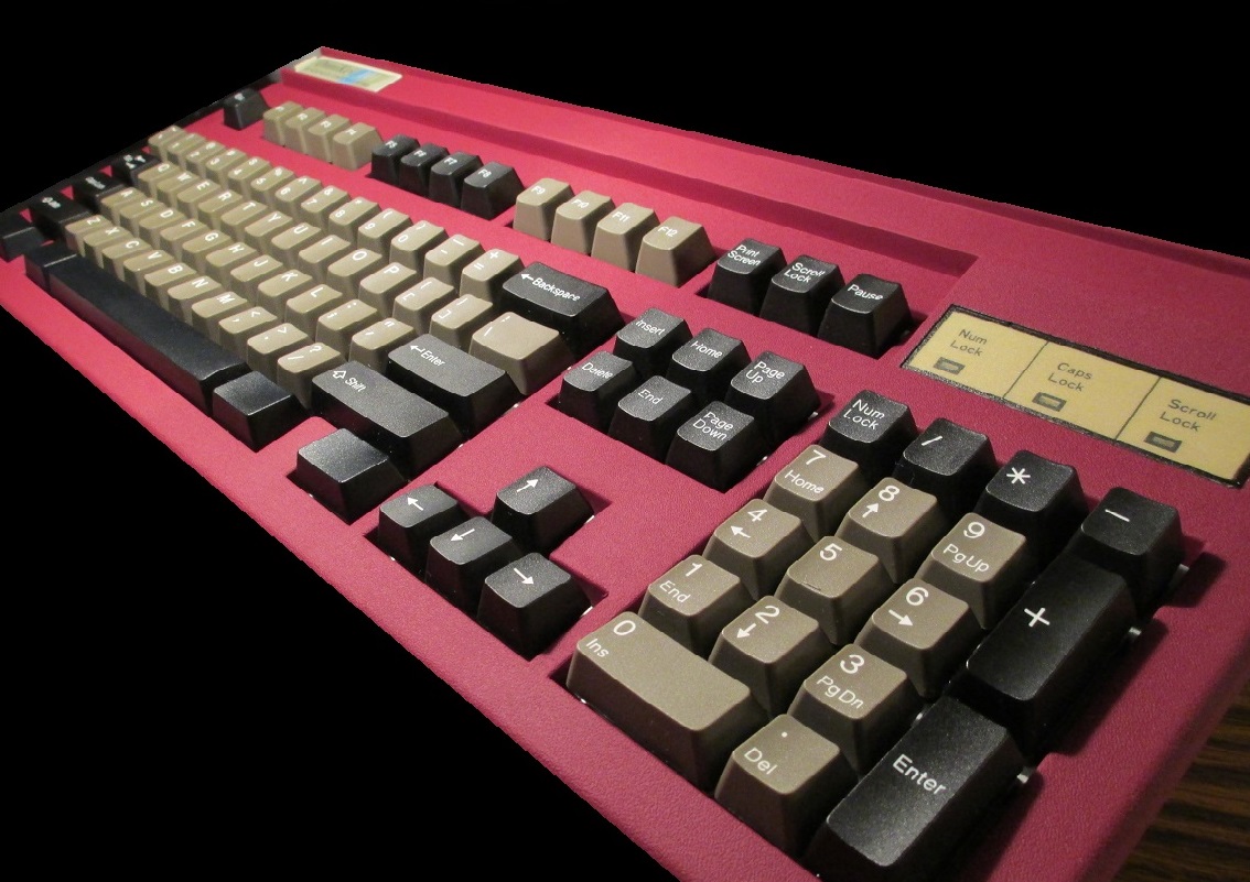

Thanks to guidance on painting from XMIT and Fohat, here are my two Northgate Omnikey 101 keyboards with SKCM white Alps, one with the case painted burgundy red and the other painted flat black using Dupli-color vinyl/fabric coating:
The burgundy keyboard has Alps-mount Tai-Hao doubleshot ABS Dolch caps except for the 1.5x blank black ABS mods and 7.0x black ABS spacebar from Matias. The switches in this one feel smoother and lighter than those in the black keyboard.
The black keyboard has the stock doubleshot ABS keycaps.
The DIN6 connector on the rear of the Omnikey 101 case has exactly the same holes for the mounting screws and connector opening of the DataPro flush-mount micro-USB female connector and 1-ft cable to male micro-USB. I intend to install a Teensy/Soarer Converter and the flush-mount micro-USB connector in each of these keyboards. It is nice to know that this modification is completely and easily reversible. A Teensy is not required for this keyboard to work -- an active PS/2 to USB adapter will suffice. However, I would like to remap the boards to my HHKB-like layout.
Fohat has previously posted the pin assignments on the Omnikey 101 header for Clock Data, Ground, and +5V in post 157 of the following thread on GH:
https://geekhack.org/index.php?topic=49 ... msg1262678
However, there are 2 additional pins -- does anyone know the assignments for these pins? Which pin carries the LED information?

Ooooooooooohhhhhhnnnggg!!! That looks really nice!
(Sorry, I can't help with the question about the pins, I'm just here to laud your paint job).
I especially like how the finish gives a good texture to the plastic. Is that why you chose this specific paint?
Question: When sanding, what happened to the original mottled texture of the plastic? Did you sand down the texture or did you use a very fine paper? Did you use a primer? How thick did you go with the primer?
- Hypersphere
- Location: USA
- Main keyboard: Silenced & Lubed HHKB (Black)
- Main mouse: Logitech G403
- Favorite switch: Topre 45/55g Silenced; Various Alps; IBM Model F
- DT Pro Member: 0038
@lancre: Wish I could take credit for how the paint job looks, but apparently the product is so good, it requires very little work or talent.
My first keyboard-related paint job was the steel barrel plate from an IBM XT keyboard. The plate was dotted with corrosion, which required sanding. I sanded the plate down to bare metal, applied a primer coat, sanded, and then applied several light coats of Rustoleum satin black with light sanding after each coat had dried overnight. This was fairly laborious and time-consuming, and now with the plate inside the keyboard and mostly covered by the keycaps, no one can see the nice paint job! But I know it is there! BTW, I used 400-grit wet/dry emery paper, and I employed wet sanding with intermittent rinsing, which keeps down the dust.
In contrast, painting the plastic tops of the Omnikey cases was a breeze. XMIT and Fohat helped greatly with painting tips and product recommendations. The Dupli-color vinyl/fabric coating requires only thorough cleaning of the plastic. I soaked the case tops in a solution of OxiClean detergent in hot tap water overnight, scrubbed lightly with a sponge, rinsed with hot tap water followed by a rinse and light scrub with 70% (v/v) isopropyl alcohol, and air-dried overnight.
Dupli-color does not require sanding, either of the starting surface or between coats. It also does not require primer or a prep coat. I applied several thin coats of Dupli-color, allowing several minutes between coats. I kept applying coats until the coverage looked complete and even. The case could be handled after about an hour, but to be on the safe side, you could let it dry overnight.
