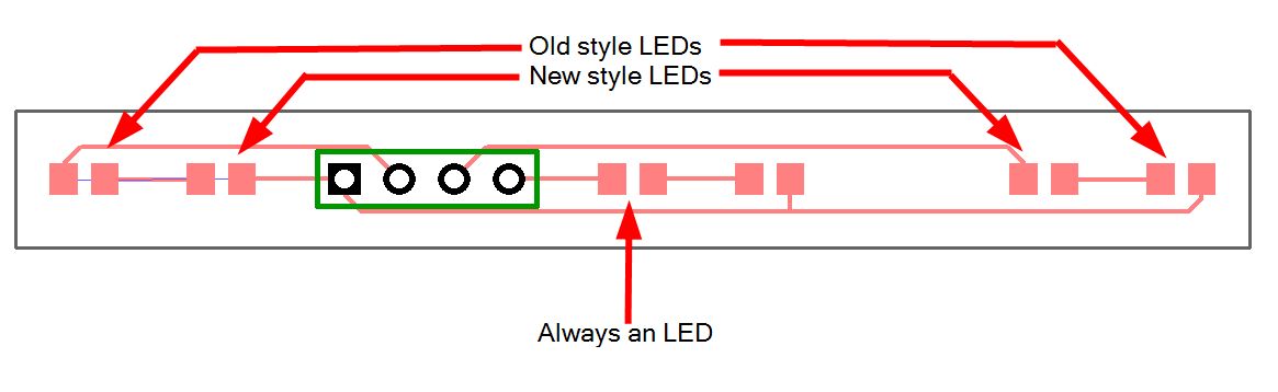

i actually took old/new LEDs into account with my design. The FExt PCB top has two silkscreen 2.25" x 0.25" rectangles at the top right corner. The new LED strip will be placed in the lower rectangle if the case top is the older style; the upper if the case top is the newer style. Attach with standard double-sided foam tape.
Each LED circuit requires one diode and one resistor in series and it doesn't matter which one is "first" in the series (though diode direction is very important). I put an 0805 surface mount pads at both 0.75" and 1" from a central pair - so you would populate the 1" pads with LED to get "old" style or the 0.75 pads with LEDs to get "new" style - then populate the remaining pads with resistors. The LEDs can be almost any color you choose, but there is a little skill in choosing LEDs and resistors - i should take some time to suggested specifics for red, amber, green, blue, purple, white.

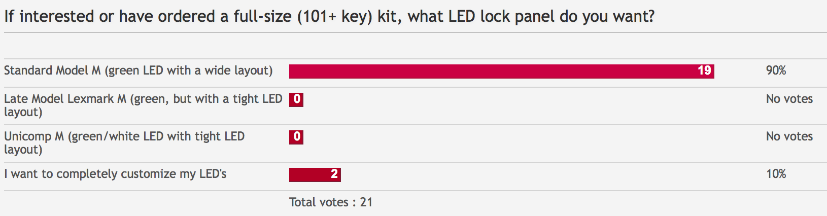

So back on this LED quagmire on the full-size kits. I have started another poll about options there. If you HAVE ordered an Full-Size kit, or plan to, PLEASE vote early. Essentially, I am trying to understand how many of you are comfortable with the LED panel being a drop-in replacement for the legacy Model M (meaning, the LED's are green and in the standard M location), or how many of you would either be putting these kits in LATE model Lexmark or Unicomp cases with a tighter LED layout and/or you want to try another color besides green). I can say this, regardless of the results, the only complete LED board will be the standard green M... but I am trying to decide if we should offer DIY bare boards for the others. Again... appreciate the early votes. It helps this process move along.
This is the one board that WCass put together put together that will account for the LED spacing of both designs:
This is the example he provided to show the differences (from Unicomp's site):

I set the LED strip up with surface mount LEDs and resistors (thinking flatter surface on the back to affix tape to) but then added through hole for connector. I'm thinking now that i need to go all the way with two versions (all surface mount AND all through hole) or one design that supports both - because some folks are more comfortable with one assembly method versus the other or prefer the old school LED aesthetic.
One question; are we going with common anode or common cathode?

EDIT: Thanks everyone for voting on the LED bit. I think we have what we need
