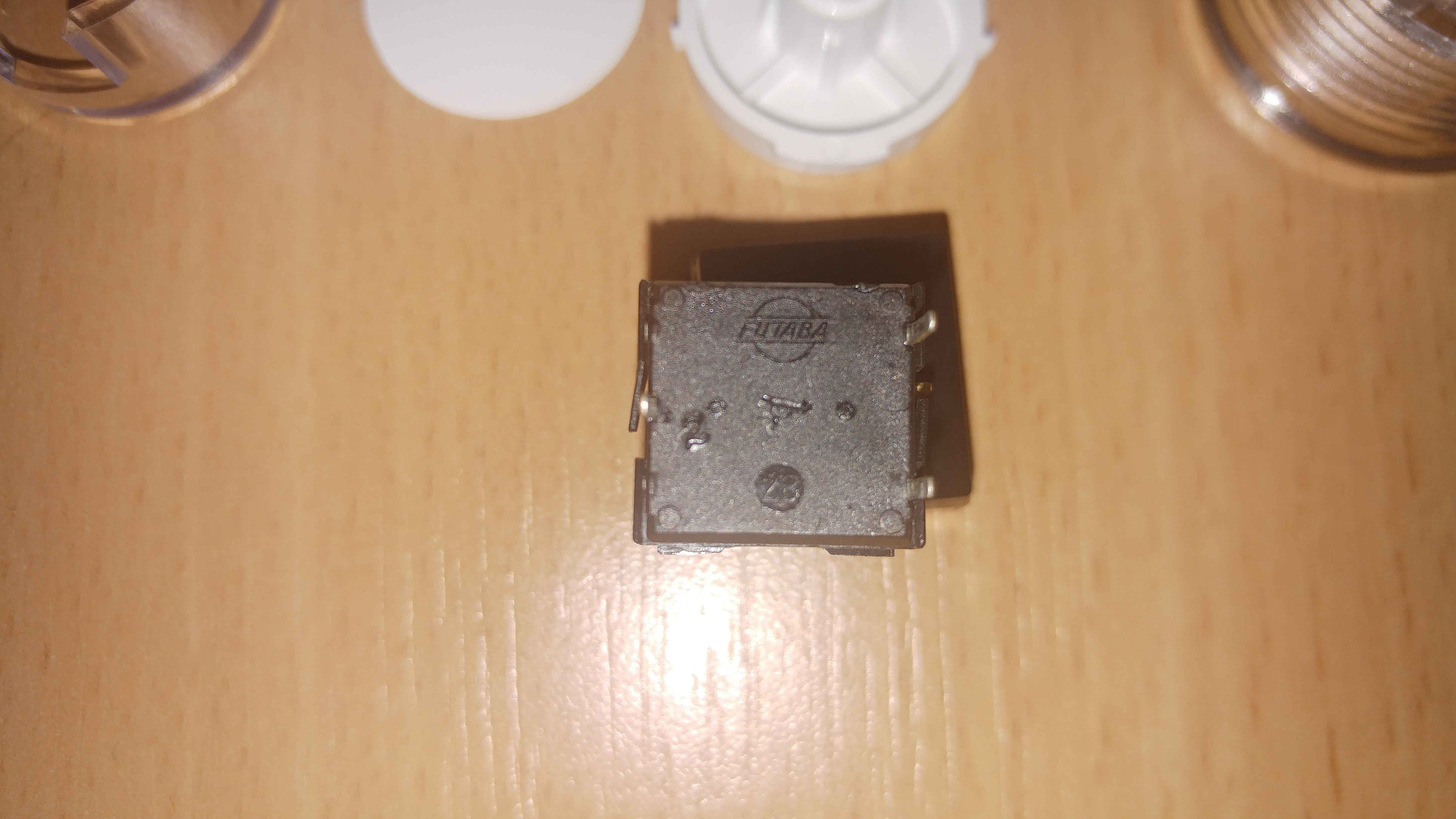

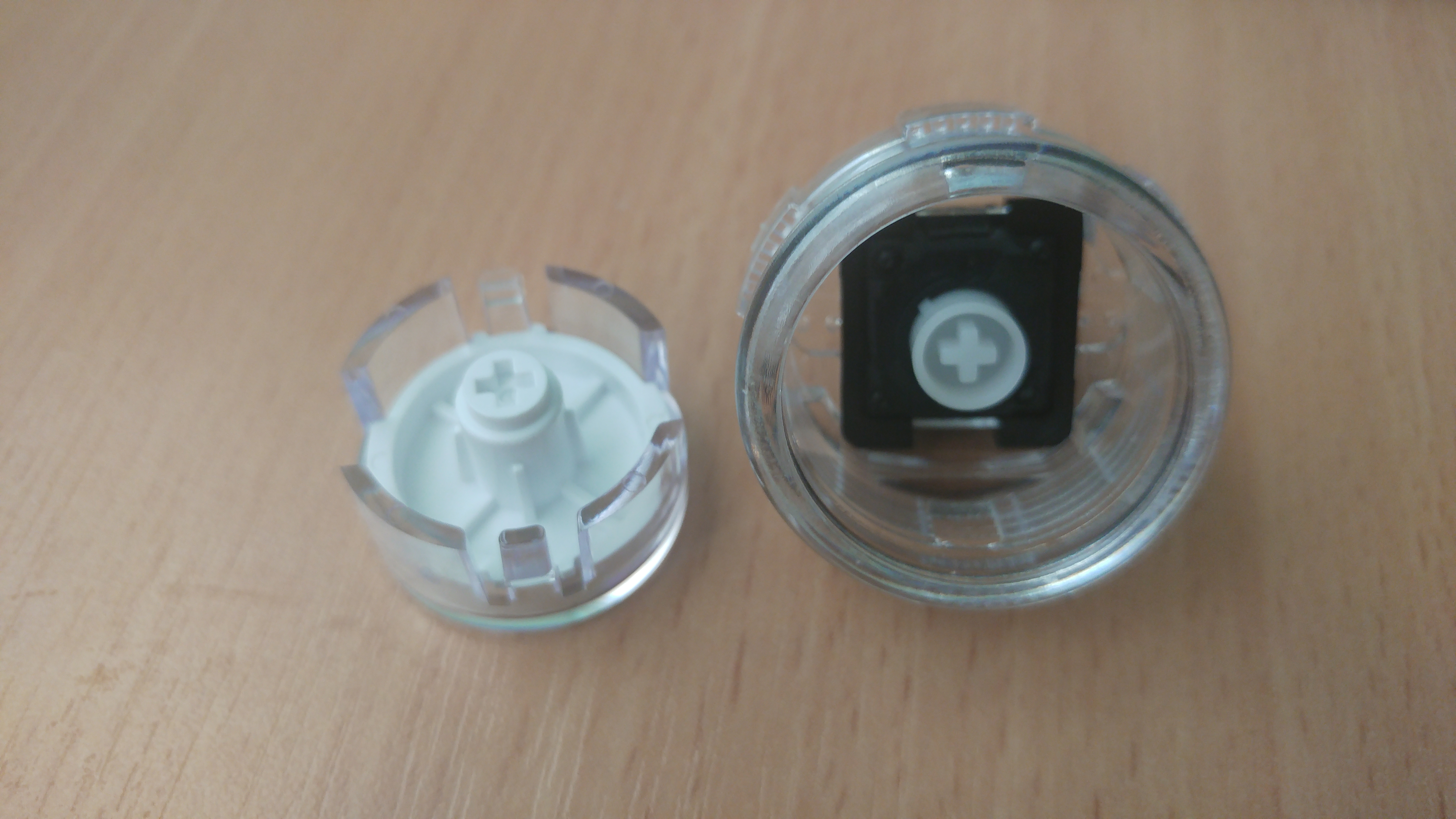

Recently I bought some Samducksa Crown SDB-201 Screw In Arcade Buttons that uses some kind of Futaba switches.
I thought that it uses a dedicated switch like Sanwa and Seimitsu, or uses Futaba mechanism inside dedicated mold (some Chinese arcade button knockoffs uses ALPS-clone switches with different mold).
When I opened the button I was surprised to find out that it uses Futaba MA with MX mount variant steam, since I recently bought OBS-MX arcade button mod (with uses original cherry mx keyboard switches)
Button can be easily disassembled and Futaba MA (MX plate mount variant) can be extracted from the arcade button.
It is easy way (but costly one) to get the new replacement for Futaba MA keyboard.
- futaba 23
- 20171018_150551.jpg (4.15 MiB) Viewed 13802 times

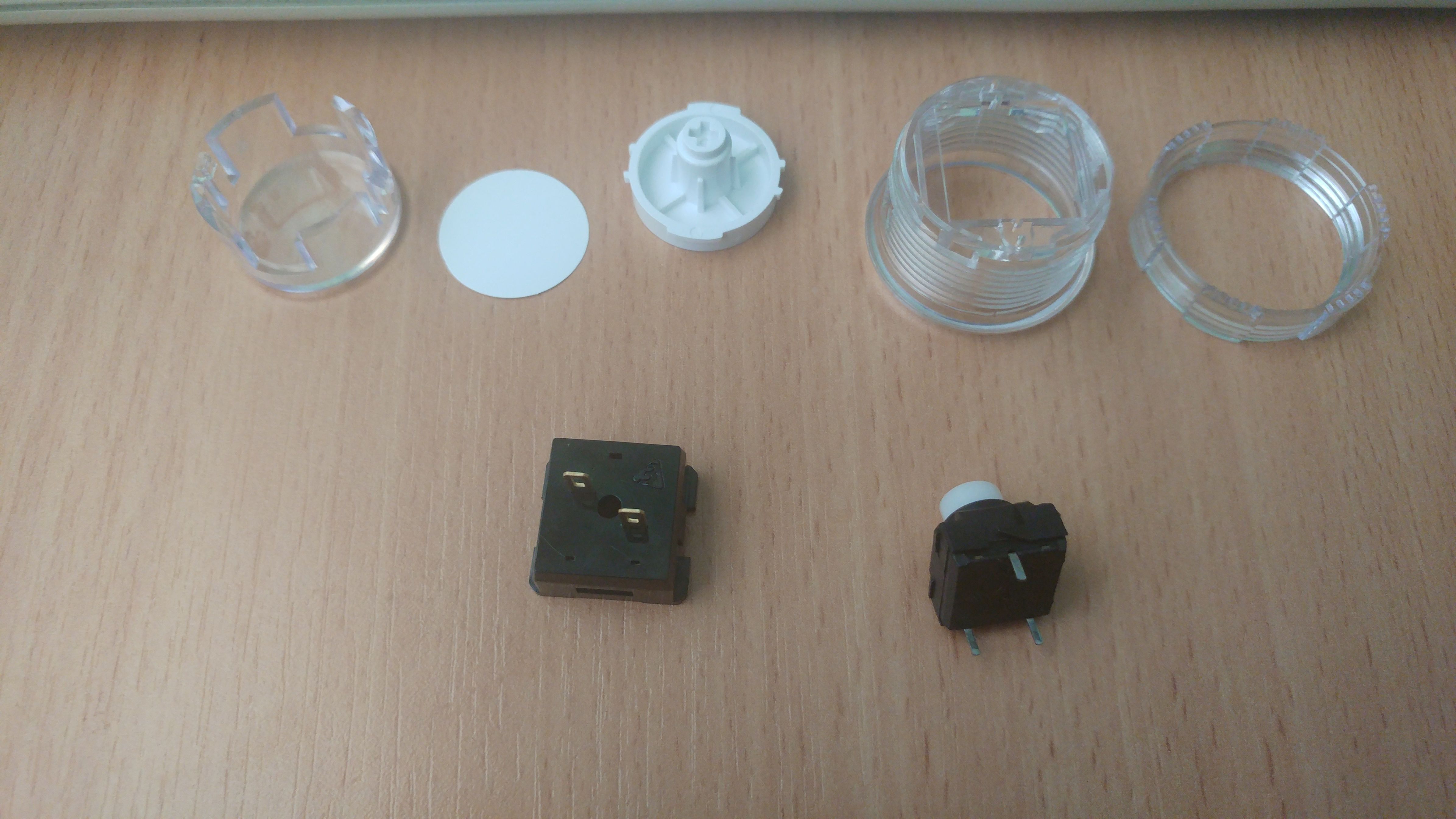

I bought a couple of brand new arcade buttons with Omron B2R-G1 switches in, but B2R is long since obsolete. The same is possibly true of MA series. With any luck, we will find out.

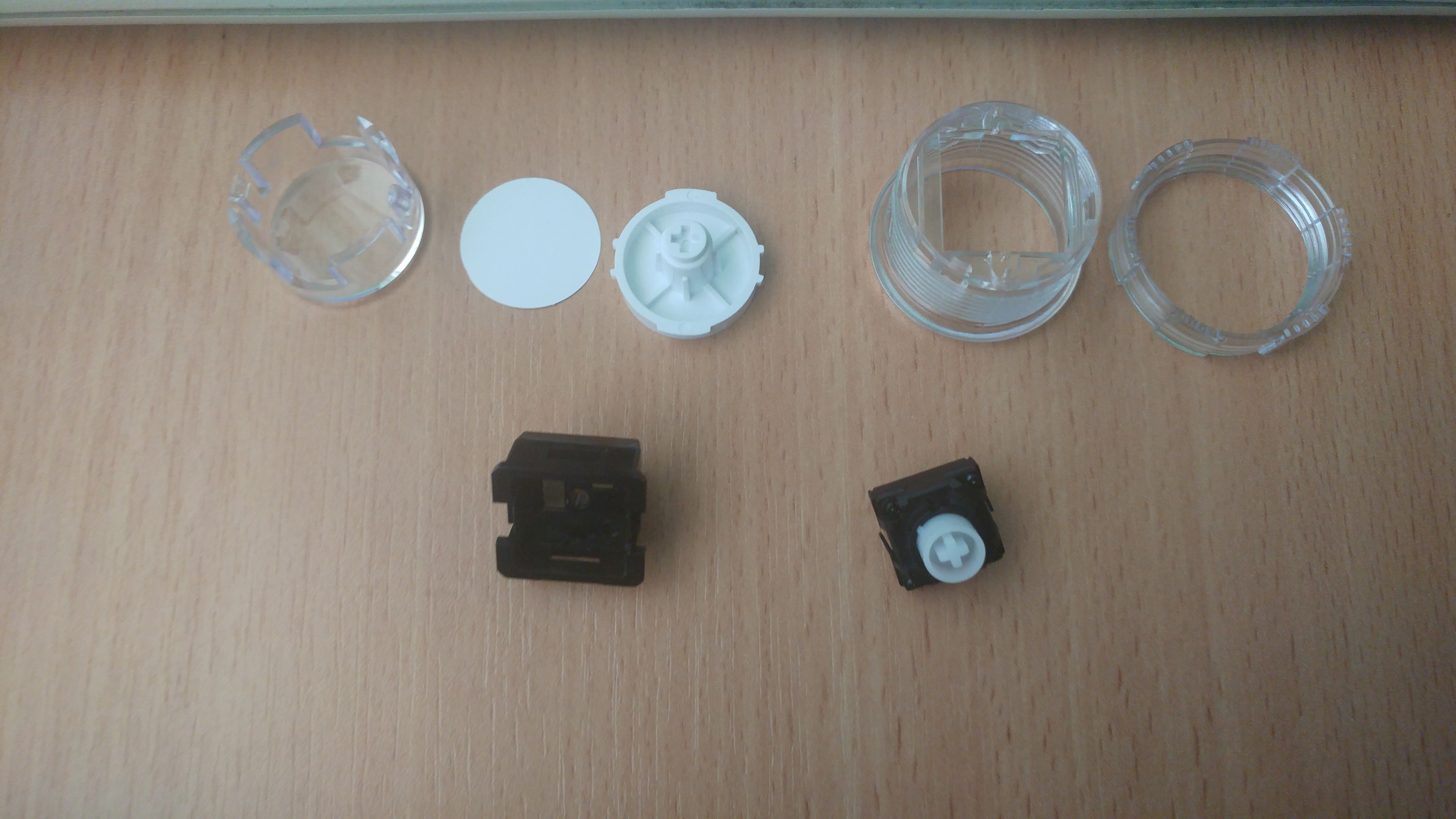

OK, so I think they've bought up all the old switches — I got something very interesting!
One switch came with Futaba mount grey, and the other came with MX mount white. Neither switch is clicky, and they feel around the same weight. (I've yet to figure out how to get the silly things apart — moar force I suppose.)
The switches are not linear either. There's very little tactility on the downstroke (and a very faint click from the grey switch) but upon release, the white gives a sharp kick just above full travel.
From what I can tell (looking at the internals of the alternate action version), the linear versions also have an inverting leaf, but the click version seems to have an extra spring for more sound. Assembled, you'd never guess that these are tactile at all.
So these seem to be MA42 linear versions. No reply yet from Samducksa but I will persevere!

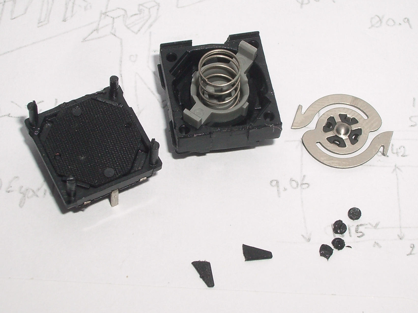

OK, so, to remove the Futaba switch, turn the button body upside down, place the adapter module upside down over the square hole, and insert a narrow implement into the bottom of the adapter module and push down hard. The Futaba switch will come out cleanly. Or may do.
The grey one is definitely meant to click, so I guess it's another example of the switches losing their click even from complete disuse:
I still need to buy another one anyway, and if I get another white one I'll open that up. Opening one up just involves slicing off the top of the "rivet" with a sharp knife and then levering the switch apart.

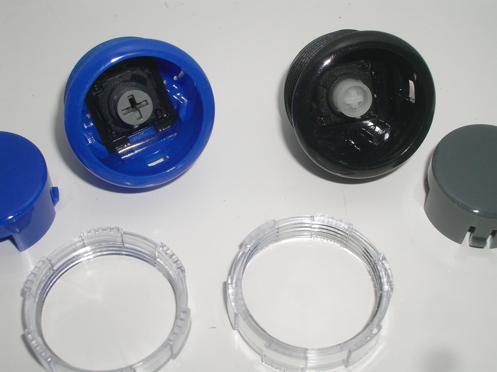

I now have: 1 grey Futaba mount (dismantled), 4 white Cherry MX mount (all linear-ish), 1 white Futaba mount (clicky).
Apparently these buttons come with four different switches, so I guess there's also grey Cherry MX mount. The supplier or manufacturer has recommended that Arcade World UK return them all for replacement with parts all using the same switch, which isn't actually the point, as it's the condition that's the real difference. However, before they do this (and I've suggested they may not want to) they're going to see if they can pick out the types I need more of.
If anyone else wants any (£3.48 with tax) let me know ASAP and I'll get them to check for a few more. They're not cheap and condition of them is poor but the grey types are pretty rare.
