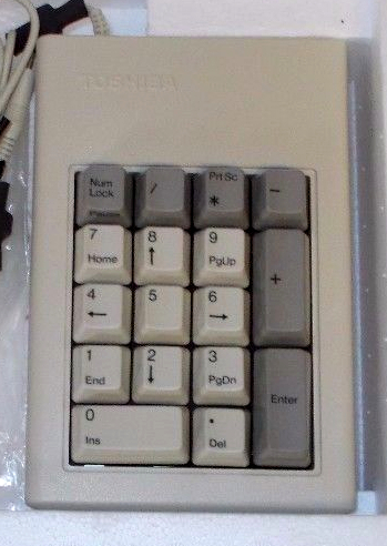

Does anyone know if this TOSHIBA PA7354E keypad is mechanical and if so what switches it uses? Thanks.

Hard to say, but the black underside of the keys and stabilized 2u keys looks mechanical to me. You can see the wire under the 0 key, and (cheap) rubber domes usually don't stabilize the 2u keys.

I would guess some flavor of pcb mount alps, probably this.
wiki/Alps_common_mount_low_profile
My reasoning for this guess is I have seen it on similar numpads and other toshiba products.

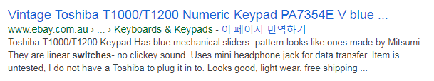

Googled PA7354E switch, and got the following result. It's just a google capture, the eBay link is now corrupted and does not show the contents of the google cache.
Blue slider, looks like Mitsumi, linear, non-clicky...

Thanks mike52787 & arkanoid, yeah the "T1000/T1200" is a giveaway although that does not does not automatically mean it uses the same switches as the T1200 which we have seen here at DT before more than once:
photos-f62/toshiba-t1200-minitouch-t465 ... BA%20T1200

This is the Mitsumi one:
http://kbd.rzw.jp/mitsumi_/toshiba_j31tp002/
This does not have the black under the keycaps.

seebart, if you look at Print Screen button, it becomes obvious that even if the switches aren't the same, the caps are. Those are probably the same molds and use the same mounts.
I once owned one of those T1200's and it came with NEC looking switches, white, but it was an alps compatible stem on the sliders. I would put money on WHATEVER switch in in that keypad, it has alps compatible keycaps.
I suppose it is possible that Toshiba was just very anal about consistency and matched them perfectly, but that seems like a stretch to me.
Either way, personally I am in no short supply of alps compatible keycaps for a number pad xD It always seems these are what my leftovers are, so I don't know if I would take the chance either without knowing for sure what the switch is.
Keycaps are different as well.Daniel Beardsmore wrote: This is the Mitsumi one:

Right, like I said two posts up does not automatically mean it uses the same switches as the T1200. Thanks for the infos.

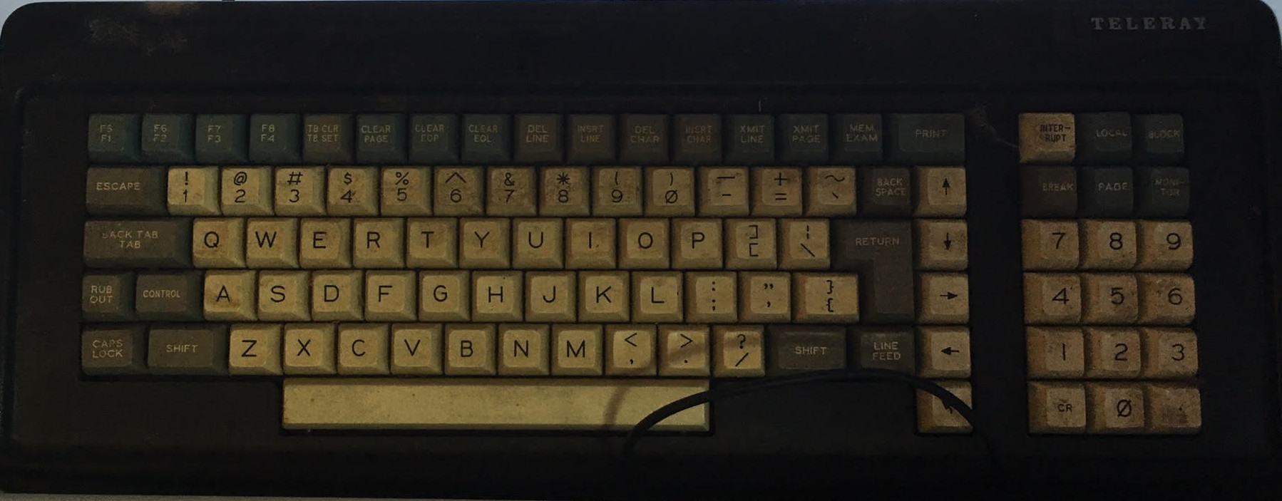

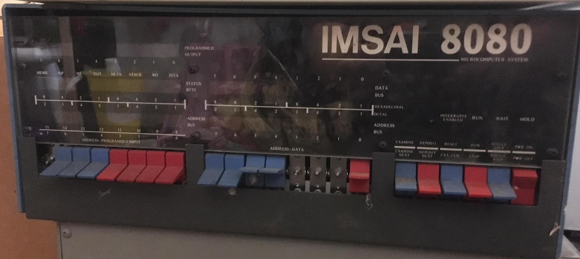

5 x S100 machines, hundreds of docs, 8" floppies, and misc too including an iconic imsai 8080:

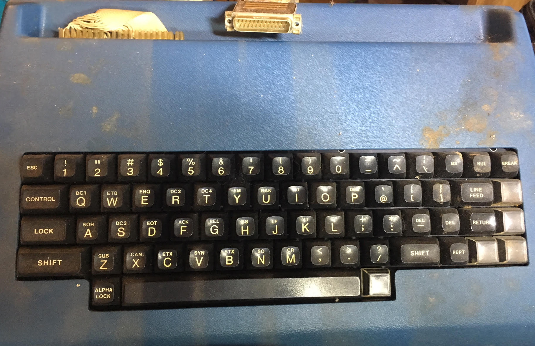

Teleray 1062 (No wiki entry, even for the manufacturer): ... and a keyboard with no label or manufacturer: Thoughts?
Included were two keyboards:Teleray 1062 (No wiki entry, even for the manufacturer): ... and a keyboard with no label or manufacturer: Thoughts?

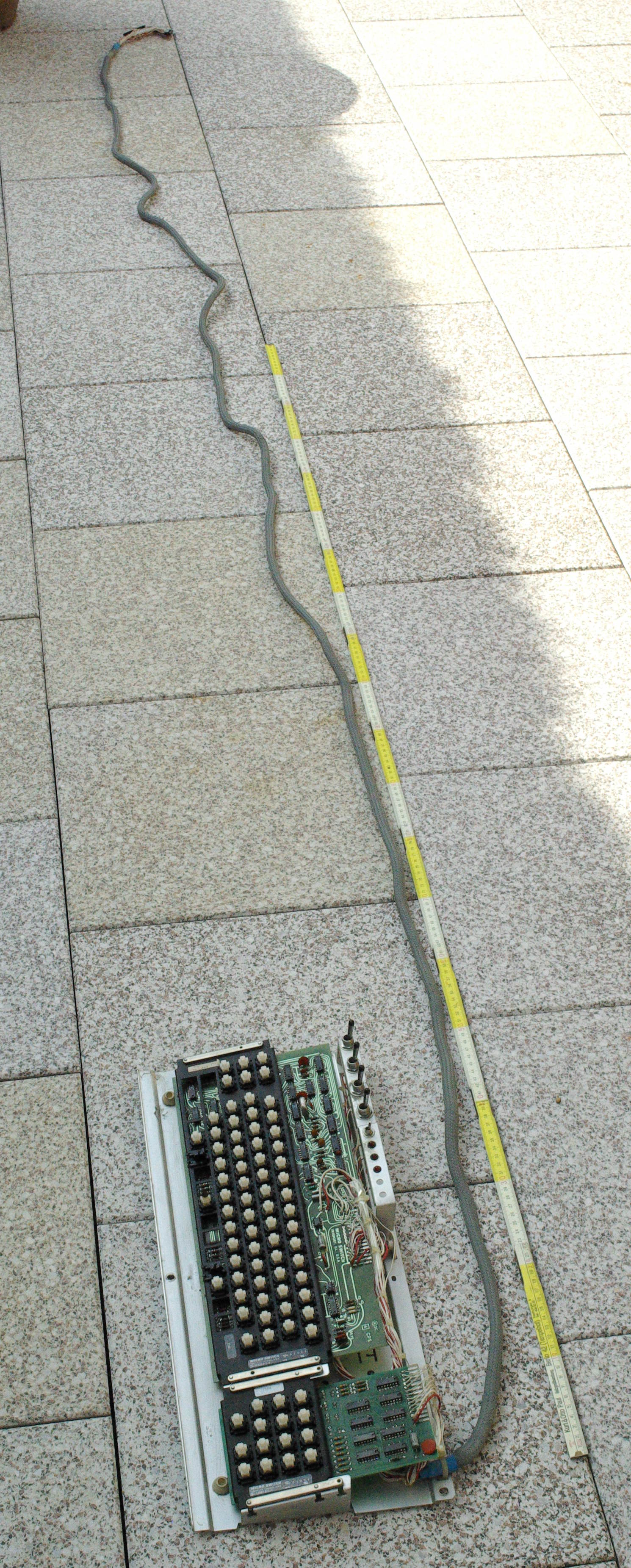

No, a friend of mine is downsizing and I'm one of the few people he knew that appreciated and made sense of what it all was.
I'm clueless too - especially since the connection is almost 12ft of ribbon cable! I'd love to know what it is.
Correction - the connection isn't ribbon cable, it's an edge connector and I just noticed that there's TWO edge-connector sockets. Can this thing drive two machines?
Honestly, I don't see how to open it up. It looks riveted together.
- seebart
- Offtopicthority Instigator
- Main keyboard: Rotation
- DT Pro Member: 0061
Good man!
Possibly, one of my Honeywells has a very long connector but not for two machines.
Of course it could be opened with force which might not be worth it. But I really just meant more better pics of the keyboard itself.

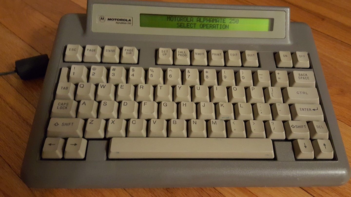

Hi guys,
Anyone know if this paging keyboard is mechanical? I don't think its likely but wasn't sure. Manufacturing of these seem to have began in 1997, ignore me

Sorry can't tell you from those pictures, someone else here might be able to though. Definitely not Cherry MX that's right.consideringquiet wrote: Well, this thing is not a keyboard, its a calculator. I know what it is, its a Victor 1665, but the switches are whats weird to me. Any ideas? Sorry the pictures are awful, its basically cross mount black switches. Definitely not MX, for sure.
