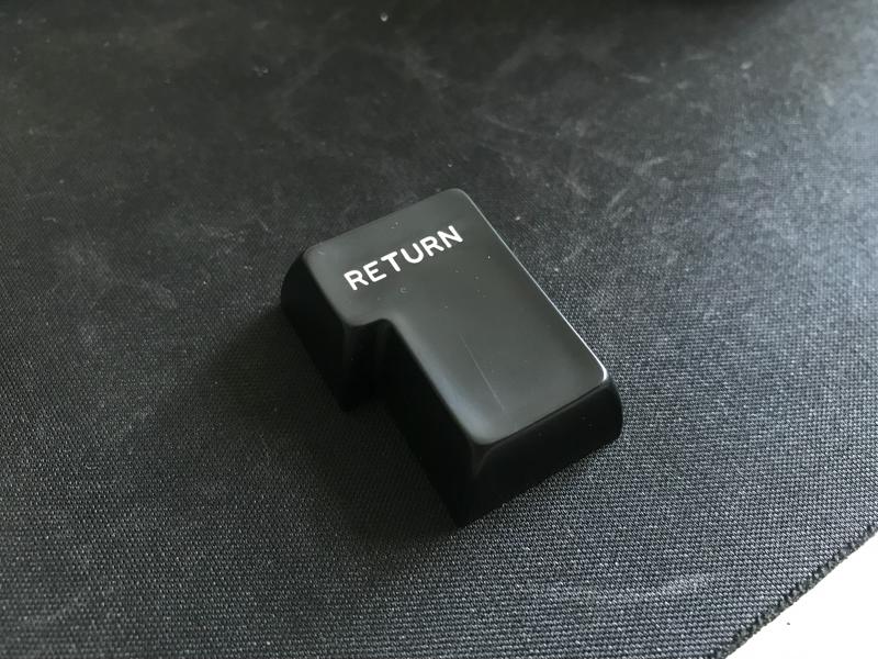

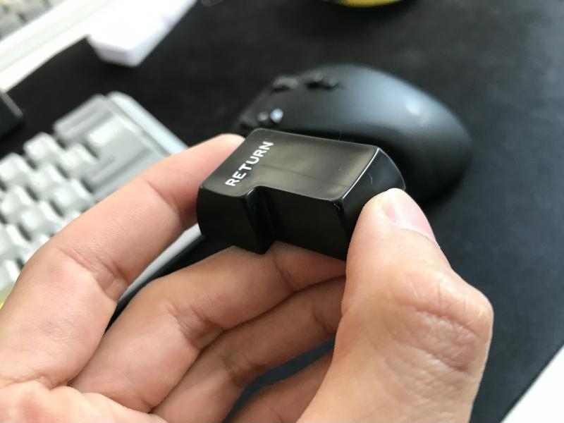

Got my order this week.
received everything but the iso enter have a big scratch on it :cry:
I know SP SA always have some minor blemish, but does it look right to you guy?

I think that's a flow mark rather than a scratch. It happens when plastic has started to cool down before filling out the entire mold, so it doesn't 'weld' together seamlessly.

yeah, my enter has the same mark :( black colour, too.

:cry: :cry: :cry: :cry: :cry:
Disappointed with SP quality.

SP had the same problem with their recent run of Nuclear Data, but it affected all the alphas, not just ISO Return. I don't know if their molds are getting worn out, they got a bad batch of plastic from their supplier, or they are just rushing to get keycaps out the door, but I think they need to figure this out quickly before it affects any other sets.

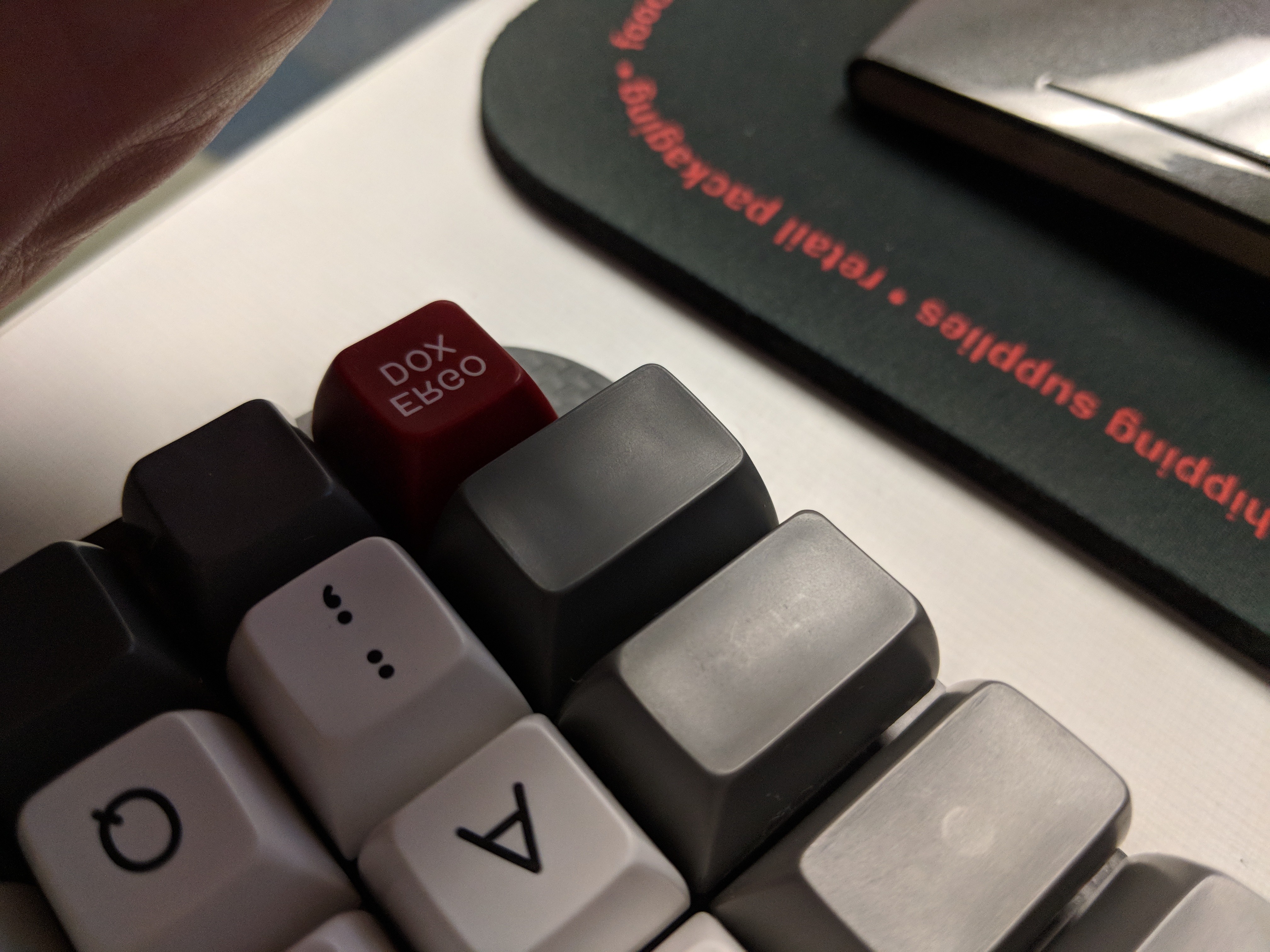

Here are some pics, as promised.

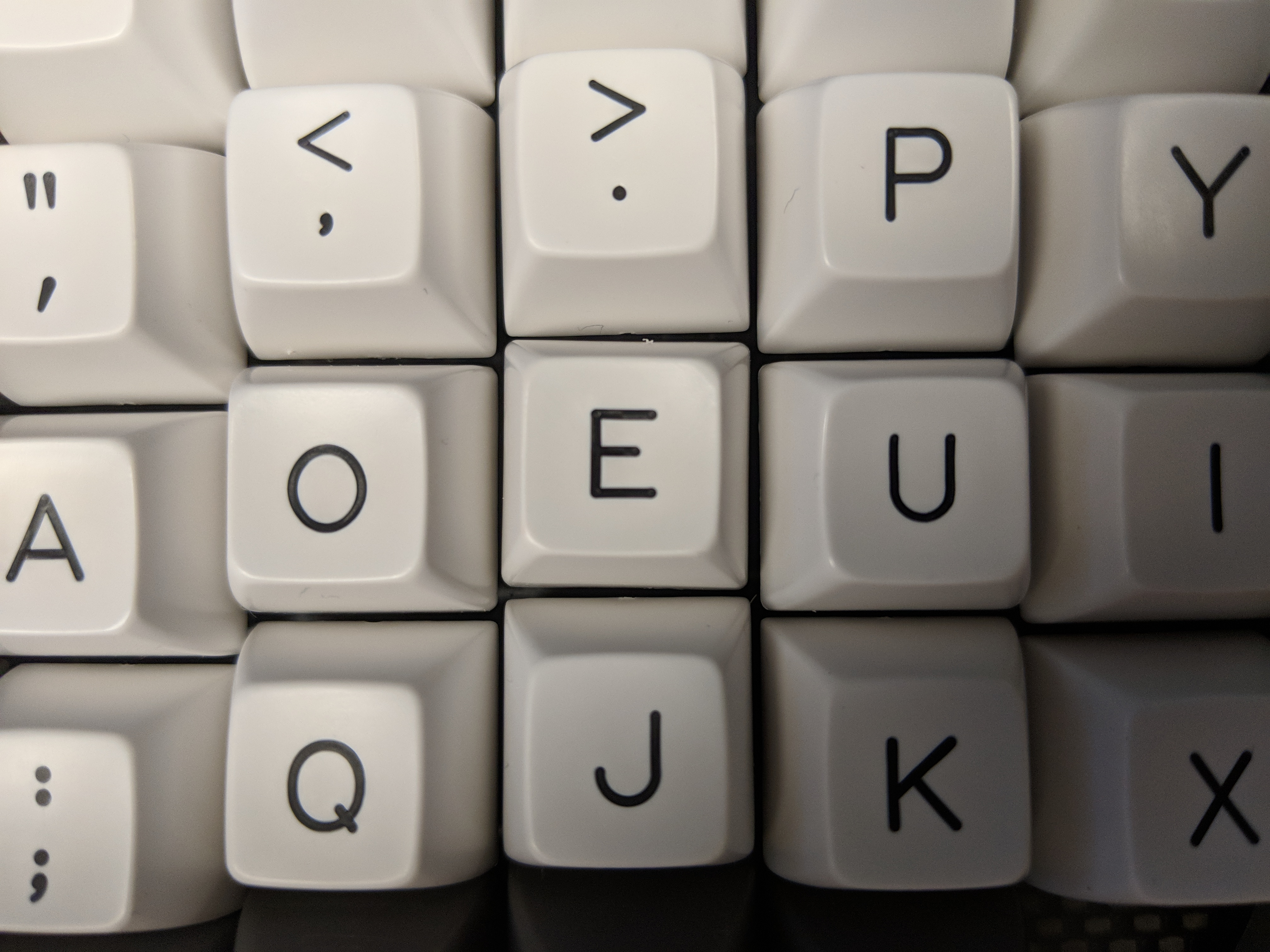

My Dvorak F key is twisted (can verify the stem/switch are straight, as this does not look twisted on any other capset)
My Dvorak E key is twisted (can verify the stem/switch are straight, as this does not look twisted on any other capset)
Not sure what this says, but it's clearly not a blank cap.

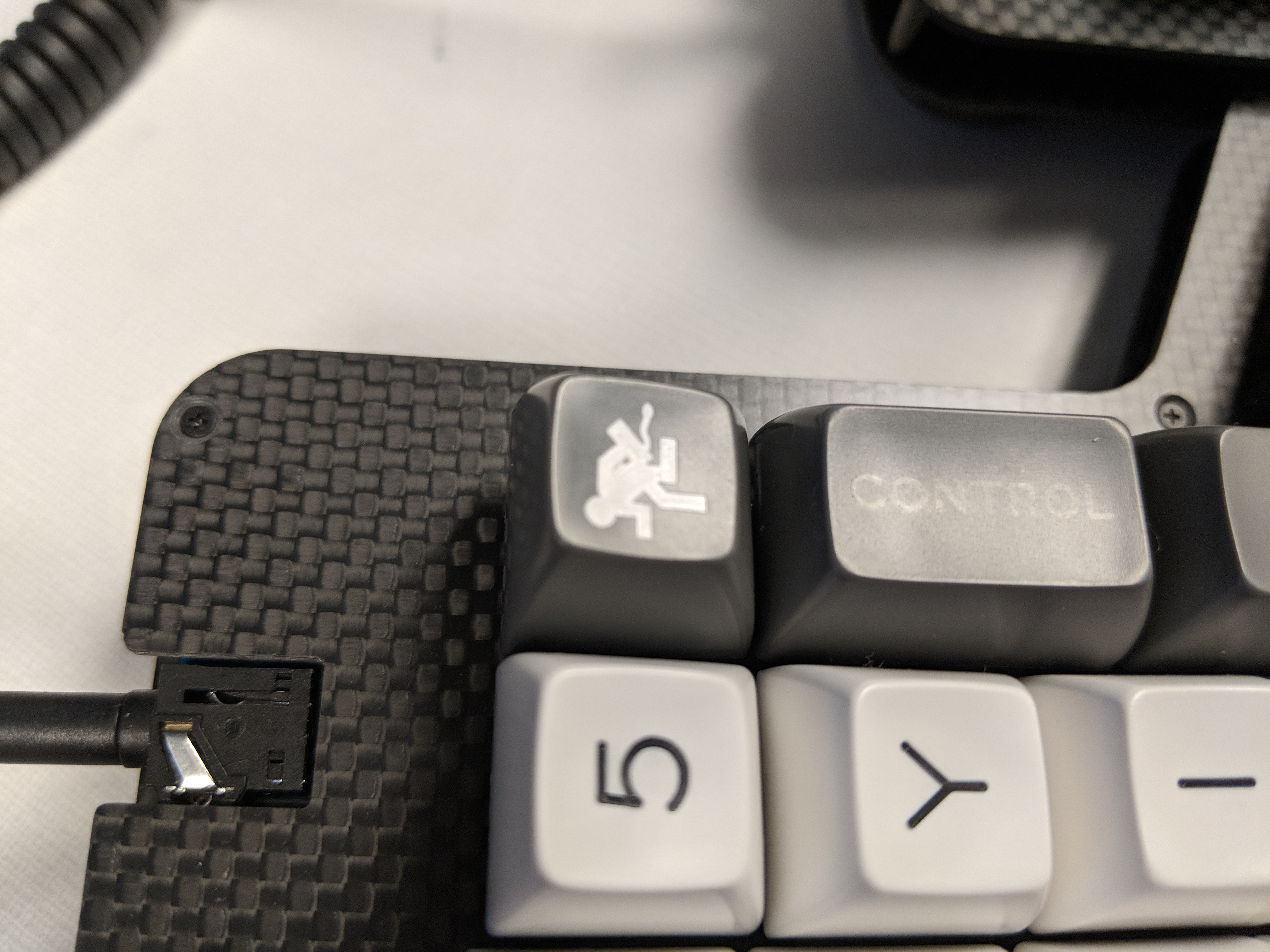

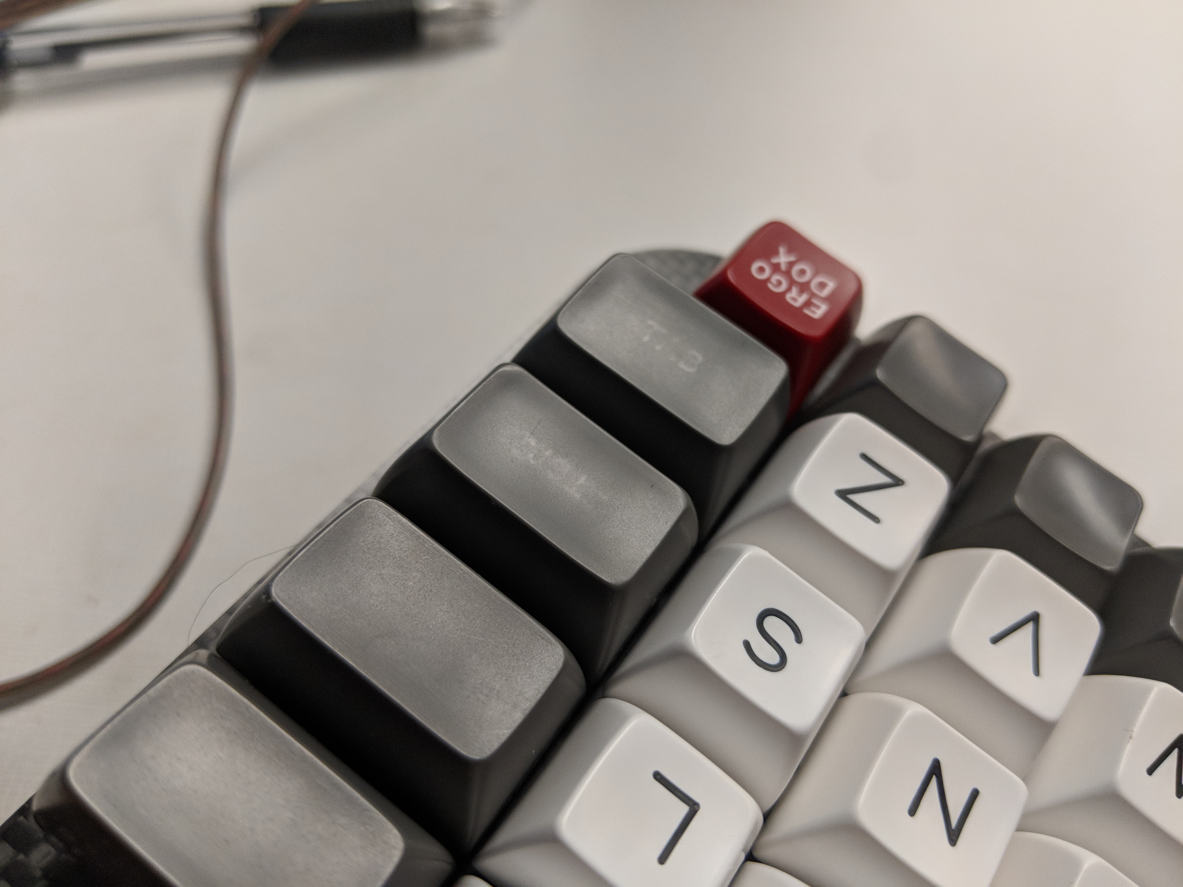

Here you can see two keys with ghosted text - one is clearly TAB, but I can't read the other one well.
This is the clearest ghost text.  It's almost like they double-shot it with the same color.

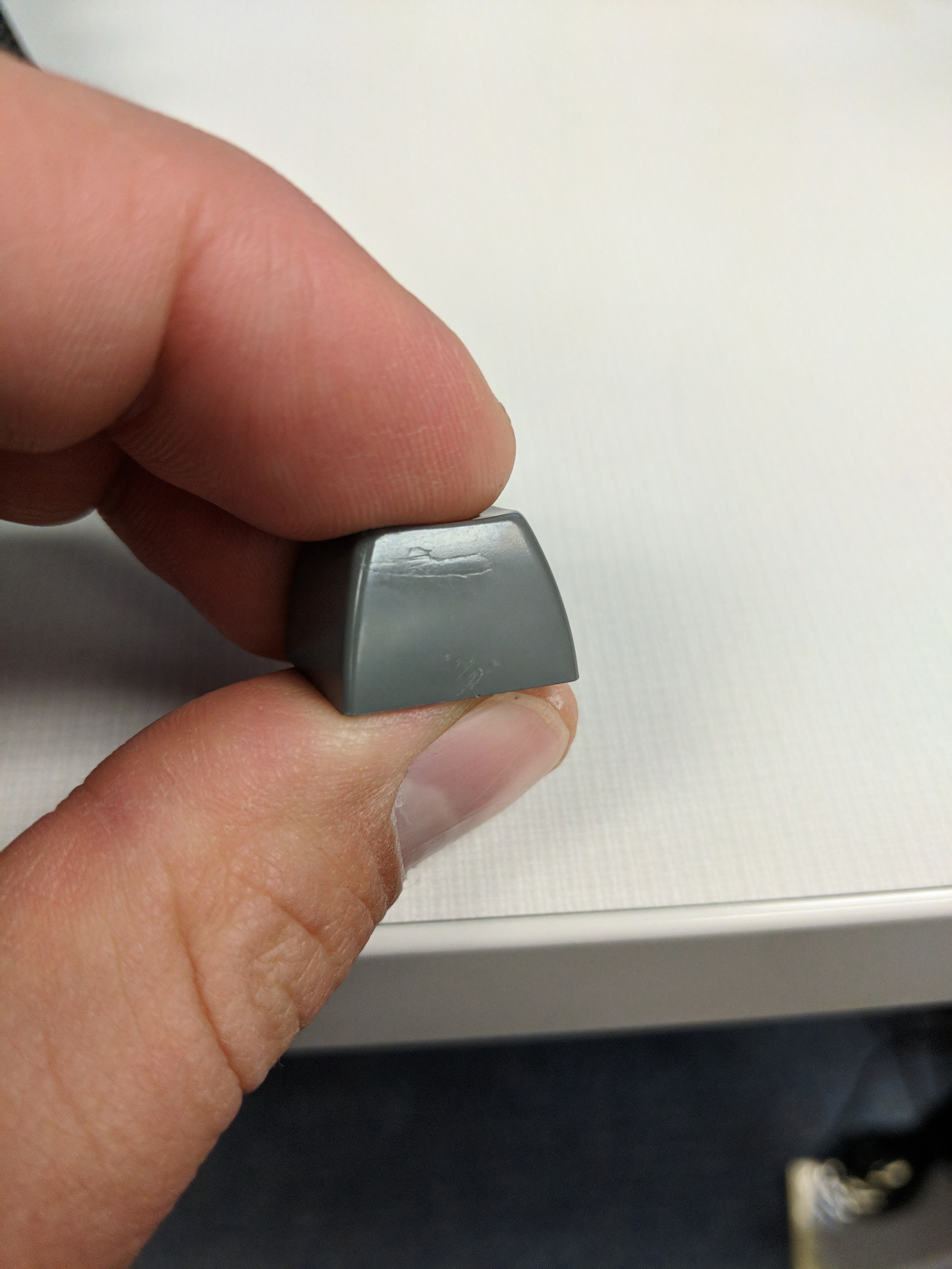

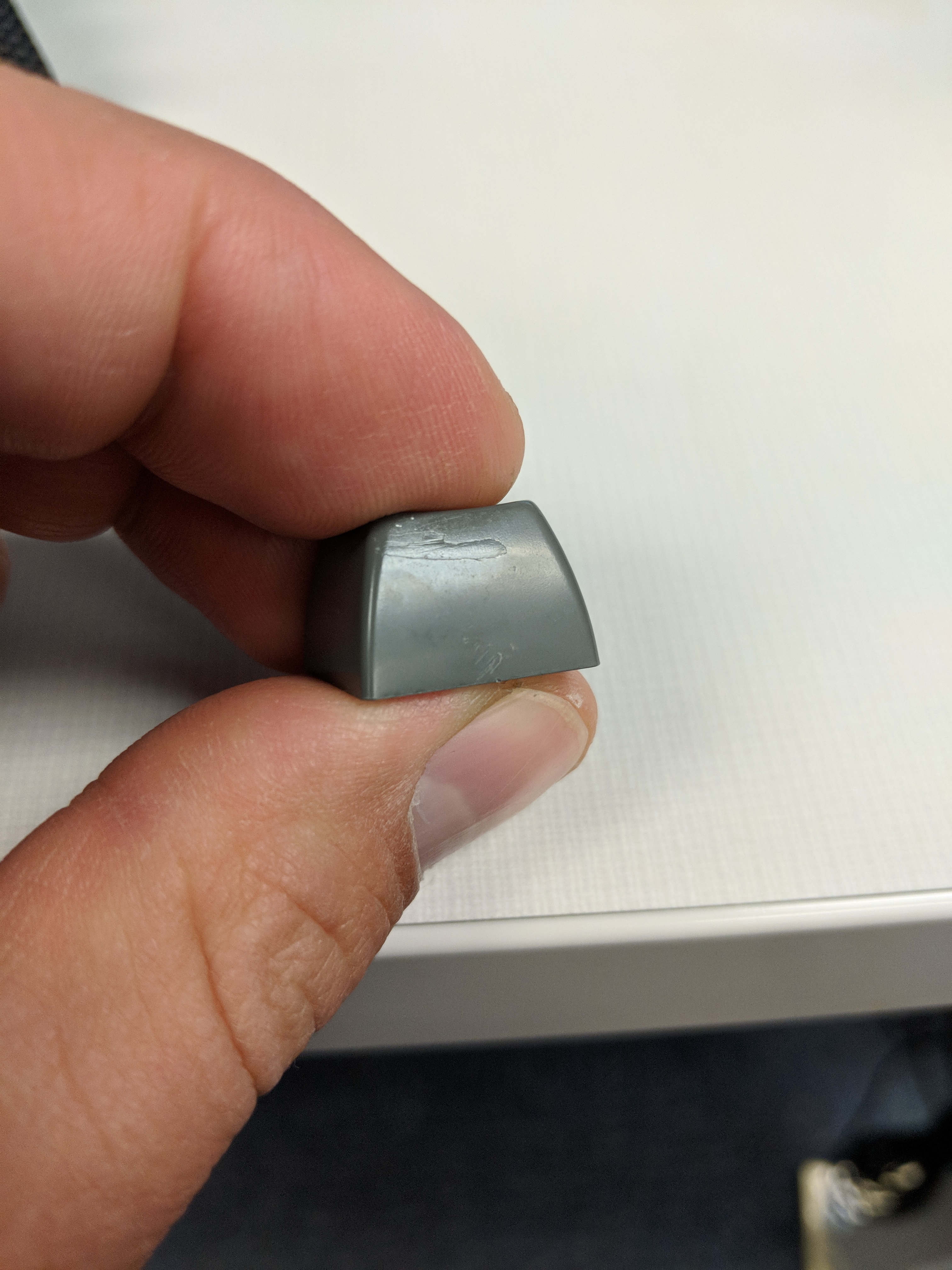

Here are a couple shots of the "bubble" I mentioned earlier - this is typical of this issue.  (I had these on my DangerZone caps, too)
It's not a huge deal on a R3 blank key, because you can turn it such that you don't see it all the time, but it's still frustrating.

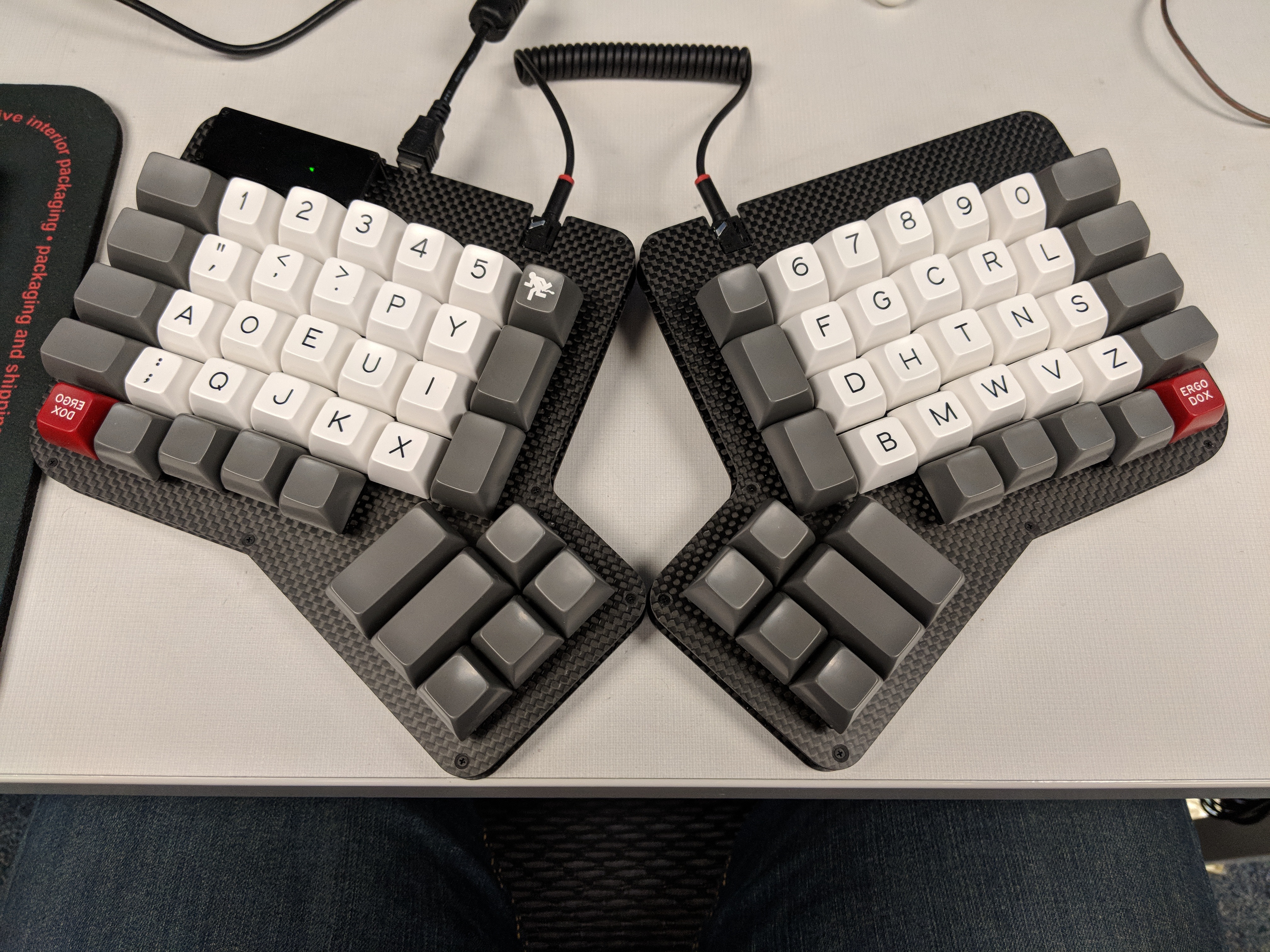

They do look good on my ErgoDone
The overall effect is good.
