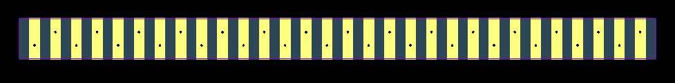

Yes, that will do. Again, make sure that this is made 0.8 mm thick. The zip file attached can be send directly to any PCB manufacturer. Shipping will likely be more expensive than the boards themselves.
- Shim.zip
- (2.75 KiB) Downloaded 261 times

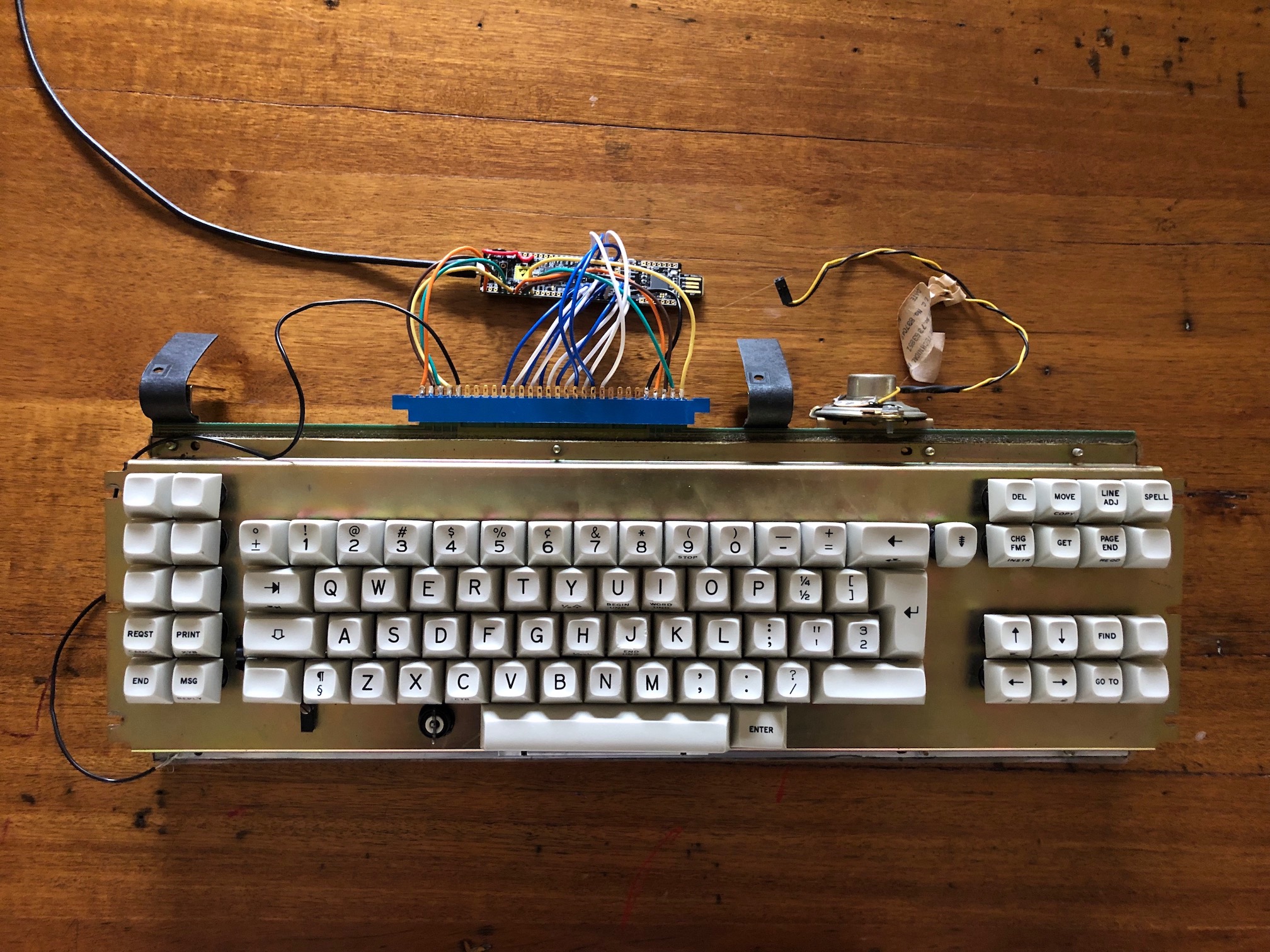

My 30 pin connector from ebay arrived this week, so I had a go at wiring up my DisplayWriter last night. Happy to report that CommonSense is working well with it.
Thanks for your help with this wcass. I ordered some of your shims from oshpark, but haven't had to use them yet (the 1.6mm connector actually seems to be a fairly snug fit).

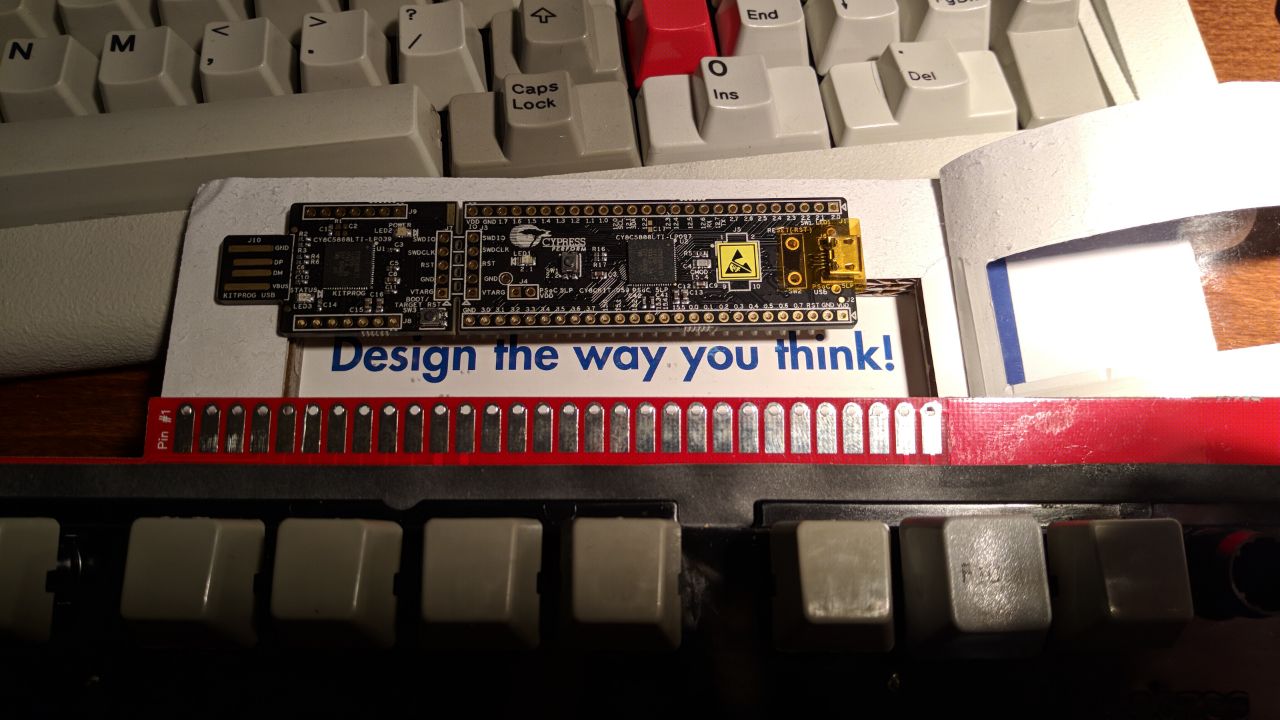

after years I'm finally ready to bring my FEXT to live and do it with the CapSense!!
First of all, happy to see the great success here! This will soon even be Bluetooth... omg..

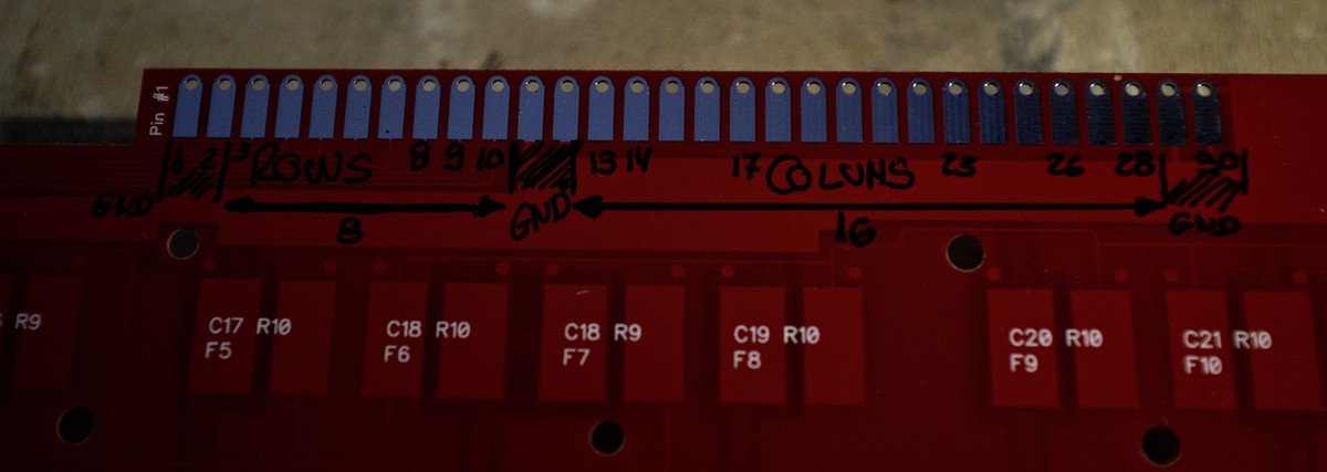

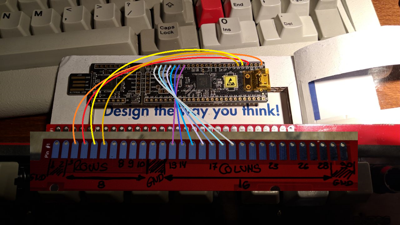

Anyway I wanted to ask and propose to make a couple of explicit pictures/drawings of the wiring between controller and board(s) and then finally put it in the first post of this thread and in the documentation/github: what do you think?
If nothing fancy is ok I can offer myself to do a picture based on this one: For instance I know from i$ this one: So to avoid errors, the idea in this case would be to wire Pin 3, the first row, to P2.0 then Pin 4, the second row, to P2.3, etc (even if not clear where a 7th or 8th row would be mapped to, if at all possible), correct?
Similar for the columns, I expect Pin 13, the first column, to go to P1.1, Pin 14, second column, goes to P1.2, etc.., also correct?
And I guess it will be easy to find similar for model F XT/ Beamsprings / etc but I think what is important for the guide is to offer one or two examples, the rest is then more intuitive.

Congratulations!
Similar for the columns - there are 24 of those, but if you want more than 16 you have some desoldering to do.
As long as you solder cols to columns and rows to rows - you're fine (you can solder cols to rows and rows to columns - that would also work). if you wire col0 to column 2 and col2 to column 1 - your layout will look funny, but things will work.
I'm not an artist - but I take patches
You can make a pull request or just PM the file to me - works either way.
I dunnot about BLE, haven't touched keyboards in like 3 months. Work, y'know
Yes. There are 8 rows - 2.0, 2.3, 2.4, 2.5..

Hi Again DMA,
quick double-check: so the 8 columns would be: 2.0, 2.3, 2.4, 2.5, 2.6, 2.7, 12.7 and 12.6, correct?

Those are rows. Can only be 8 of those.
Columns are 1.0, 1.1, 1.2... - up to 24 of those.
You'll need xwhatsit solenoid daughterboard for actual driving, but this board can control it.

Thanks again, really. I got up and running with this keyboard and everything works flawlessly.

I have a 3278 I'm trying to convert. I'm having trouble getting a clear picture of how to use the CY8CKIT-059 device to achieve this, could someone help me out? Thanks.
- JP!
- DT Pro Member: 0194
Does CommonSense support a solenoid / solenoid driver like the Xwhatsit's?
- DMA
- Location: Seattle, US
- Main keyboard: T420
- Main mouse: Trackpoint
- Favorite switch: beamspring
- DT Pro Member: NaN
@PancakeMSTR what part of picture is unclear?
@JP! - yes, ExpHdr pins are for that. ExpHdr_0 and ExpHdr_2 will be solenoid driver active pins if you select "solenoid" in hardware setup.
- JP!
DMA wrote: 16 Jul 2019, 18:45 @PancakeMSTR what part of picture is unclear?
- Main keyboard: Phantom TKL
- How do I wire the 3278 pinouts to the controller?
- Do I use xwhatsit's solenoid driver?
- What do I do once it's wired up?I.e., what steps do I need to take to program the controller once it's wired up?

* you should figure that out yourself. Who knows what pinout _your_ PCB has.
* you can, although I can't personally understand why would one trade beamspring sound to an ersatz-typewriter. You can figure out how by reading the source, of course - but I'll add a README section about that thing.
* read the documentation. It tells you. The most complicated thing is making sure you wired your controller to PCB properly and chosen proper switch type when building firmware. The most finicky thing after you connected the controller is configuring thresholds - but it's described in enough detail - once you see the interface it will be obvious.
- you should figure that out yourself. Who knows what pinout _your_ PCB has.
- you can, although I can't personally understand why would one trade beamspring sound to an ersatz-typewriter. You can figure out how by reading the source, of course - but I'll add a README section about that thing.
- read the documentation. It tells you. The most complicated thing is making sure you wired your controller to PCB properly and chosen proper switch type when building firmware. The most finicky thing after you connected the controller is configuring thresholds - but it's described in enough detail - once you see the interface it will be obvious.
