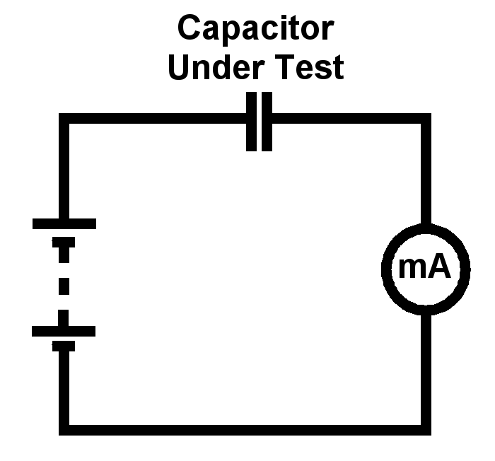

I can't really comment further as I don't know the size of the cap you are testing. I've tried checking new ones for ESR and can't get a reading on ones smaller than 0.01µF.
To put it simply a capacitor lets AC through it but blocks DC. As they get old they can start to Leak, ie let DC through. If one in your keyboard has started to open, damp will have got in causing it to leak. If one has opened enough to see there's a good chance the others have to a degree. If a capacitor is connected across rails for de-coupling and it starts to leak it will draw DC current and pull the rails down.
I don't know what equipment you've got but you can test for leakage by connecting the cap in series with a battery and a milliammeter, or a multimeter on milliamps.
The battery should be as near to the rated voltage of the capacitor as possible. The meter may twitch while the capacitor charges but should then read zero.

Thank you so much for the tips. I'm going to try the multimeter + battery that you explained.ThePillenwerfer wrote: I can't really comment further as I don't know the size of the cap you are testing. I've tried checking new ones for ESR and can't get a reading on ones smaller than 0.01µF.

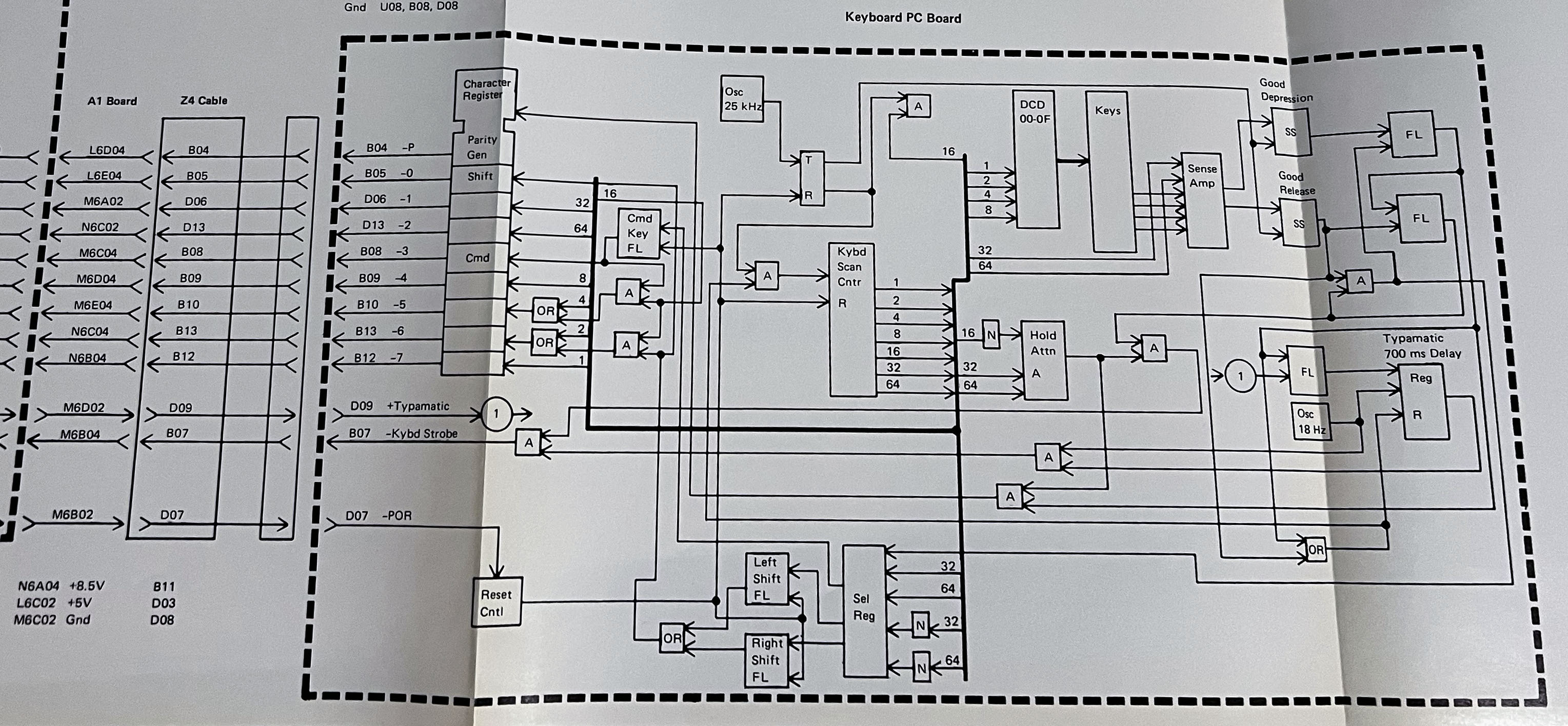

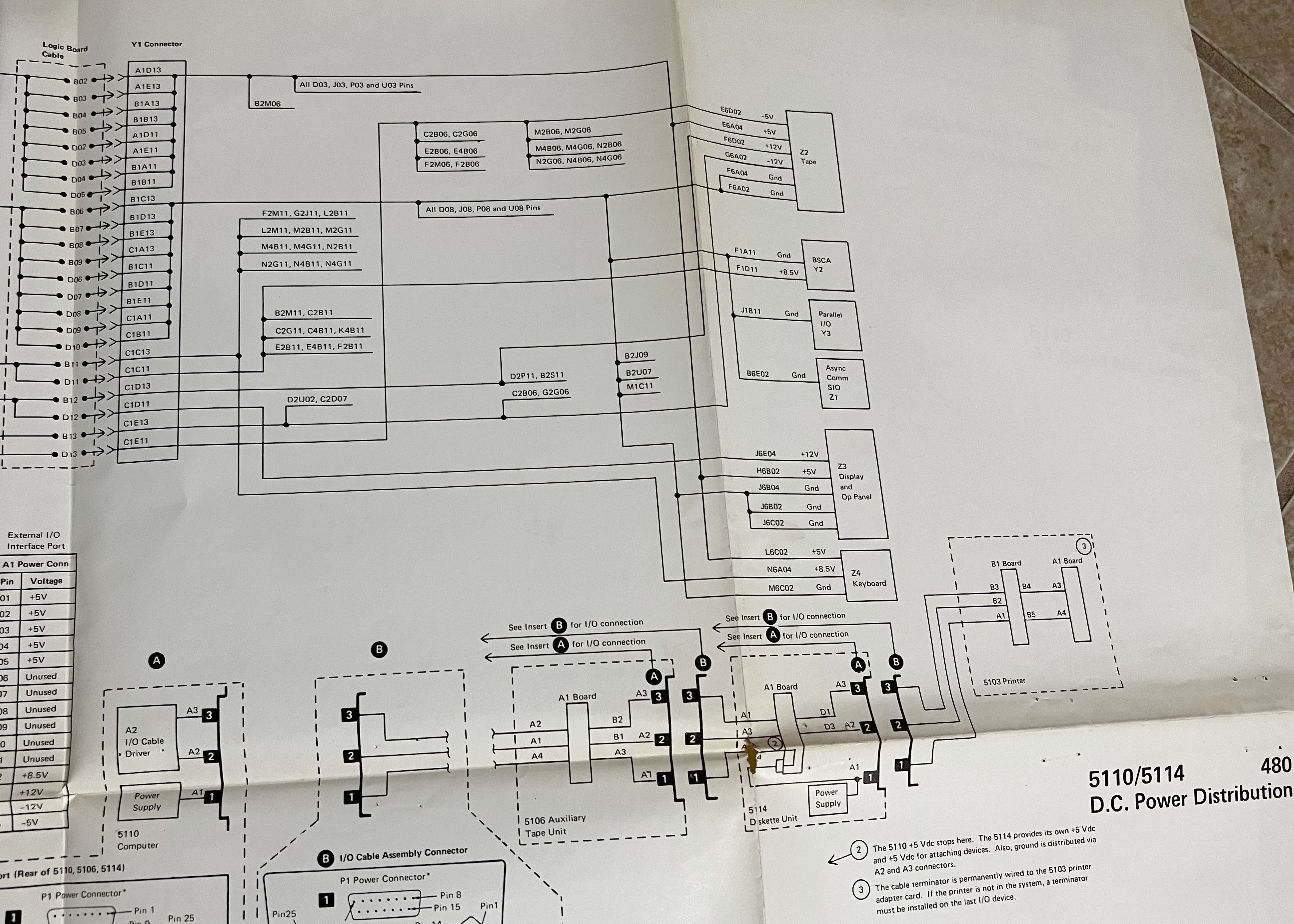

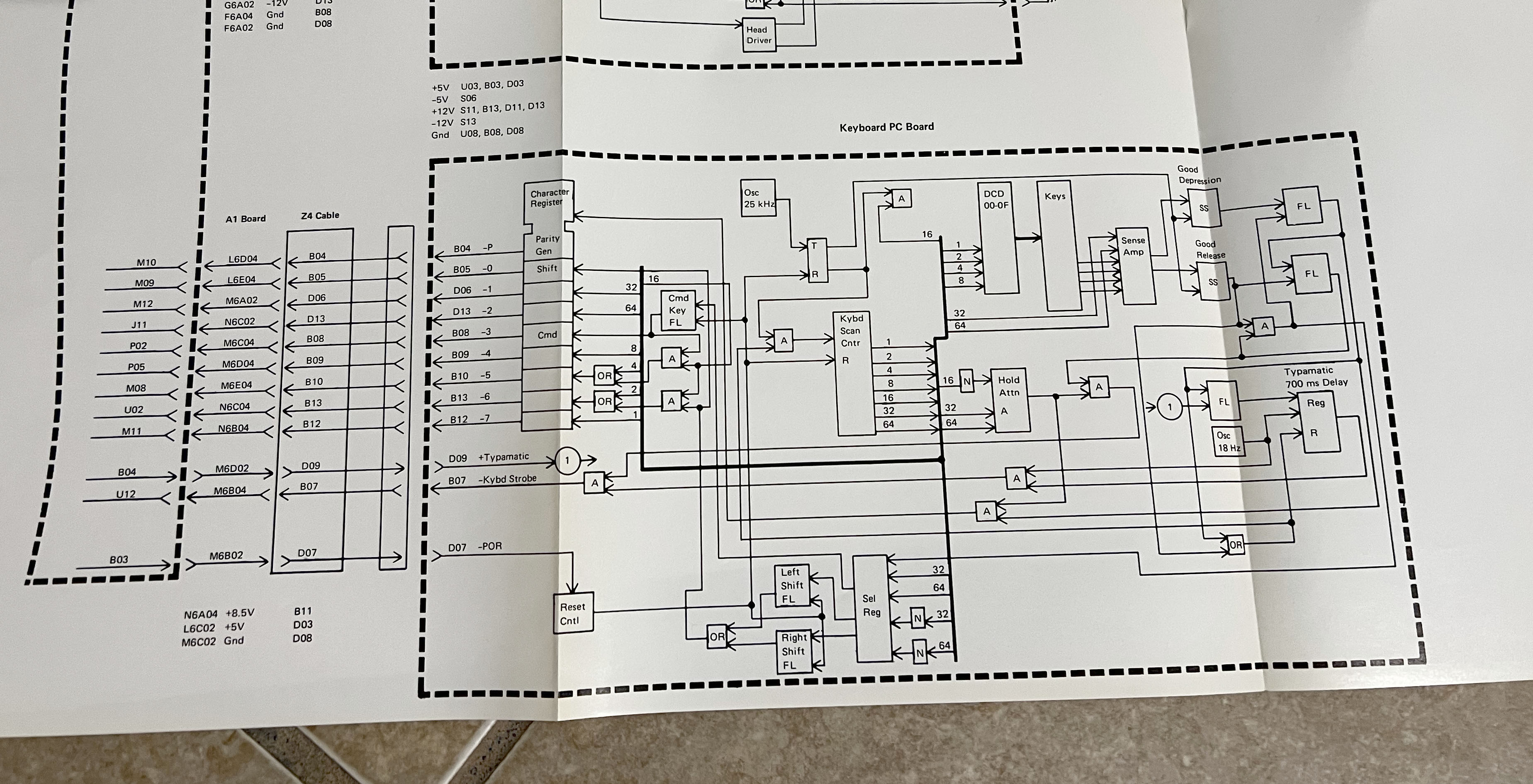

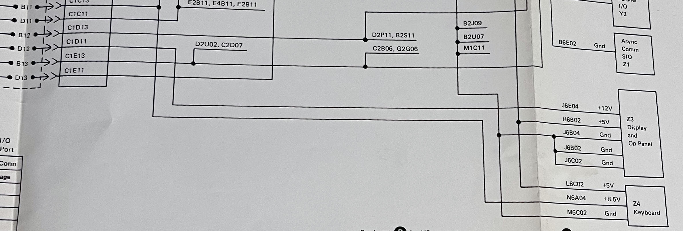

I realize this is an old thread, but in case it helps:
This is from the IBM 5110 Logic Manual, I have a full physical copy.
The top part (off the page of the poster) is for the tape unit.
On the bottom left are annotations related to the keyboard (N6A04, L6C02, M6C02). These come in from the Y1 power connector.
It still remains unclear to me what the +8.5V is used for.
If anyone has a spare 5110 keyboard, please let me know, I need it
