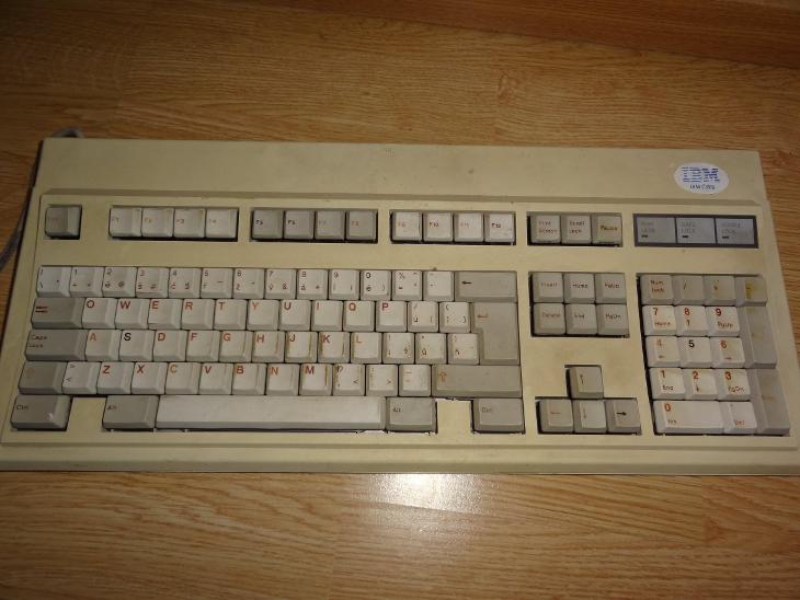

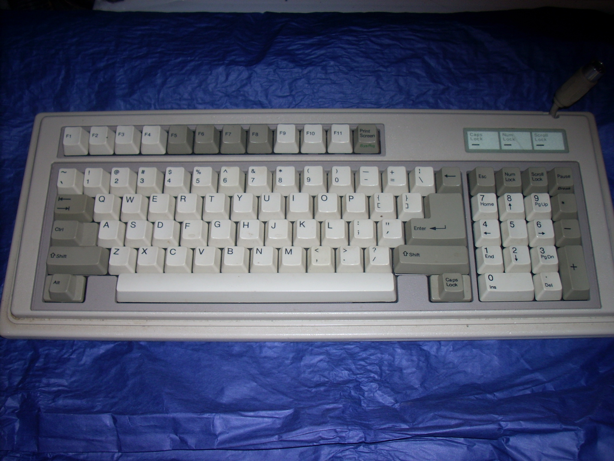

BTC is the only manufacturer that I know of that did that. If ESC is 1.25, the slight S-curve of the case profile also increases the likelihood that a keyboard is BTC.Keybug wrote: 19 Jan 2019, 22:11 Is this a BTC keyboard? Does escape as the only extra-wide key on the board pretty much *always* signify BTC? Thanks.
IDENTIFY THE KEYBOARD thread
- Location: Stockholm, Sweden
- DT Pro Member: 0011
- Polecat
Focus also had the wide escape key on some models <FK-6000=attached> but I don't think this one is a Focus.Findecanor wrote: 19 Jan 2019, 22:59 BTC is the only manufacturer that I know of that did that. If ESC is 1.25, the slight S-curve of the case profile also increases the likelihood that a keyboard is BTC.

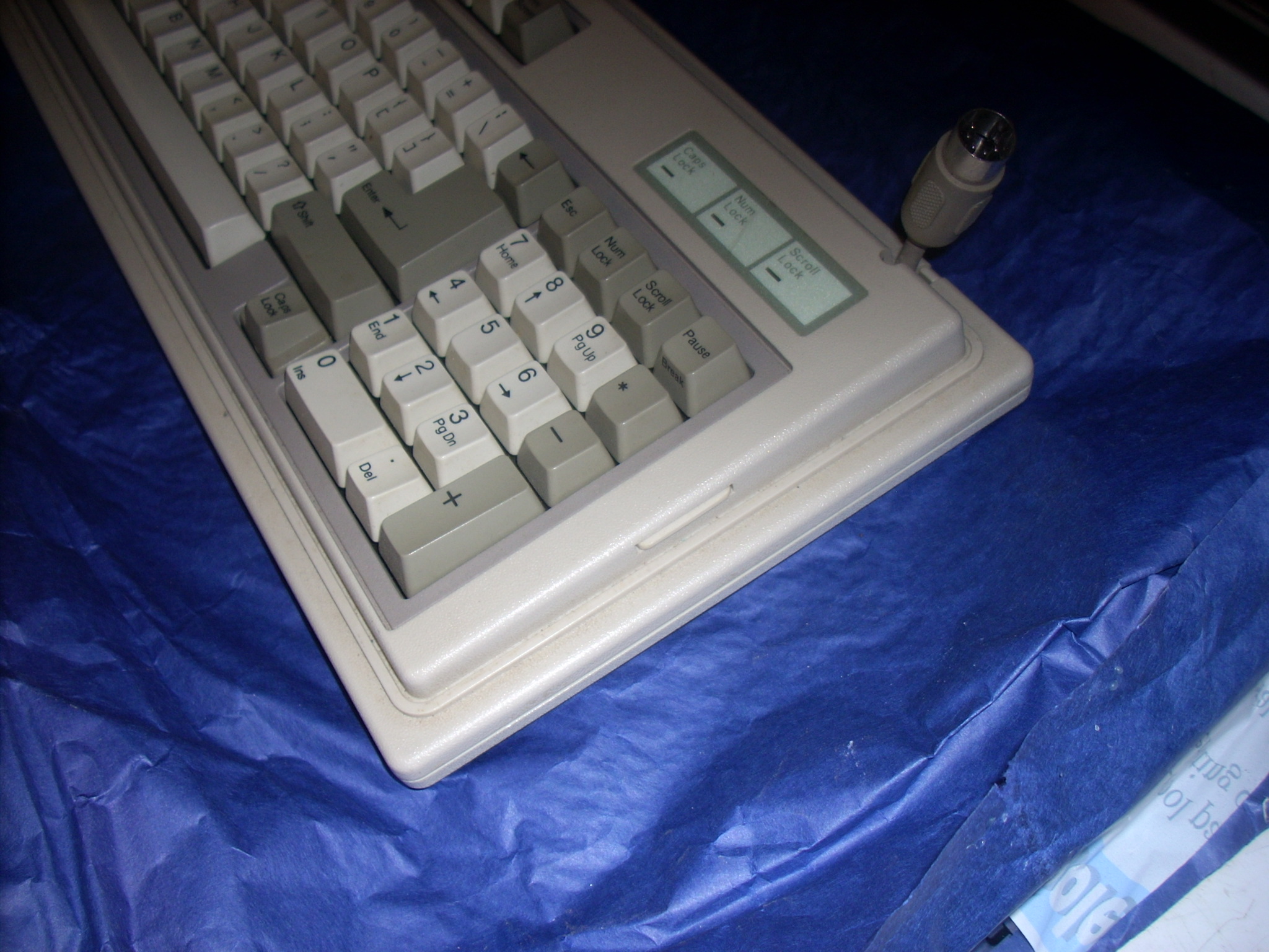

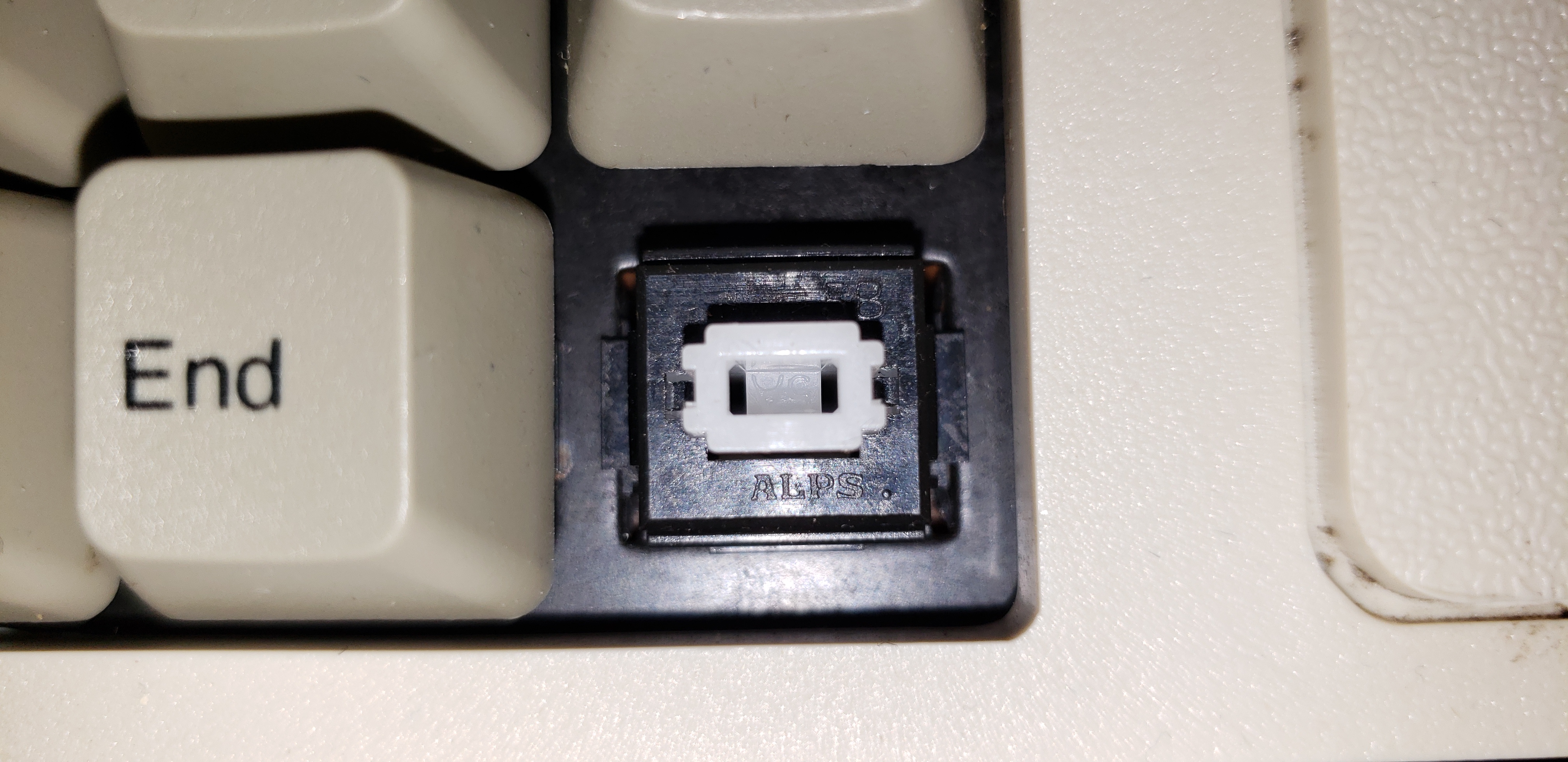

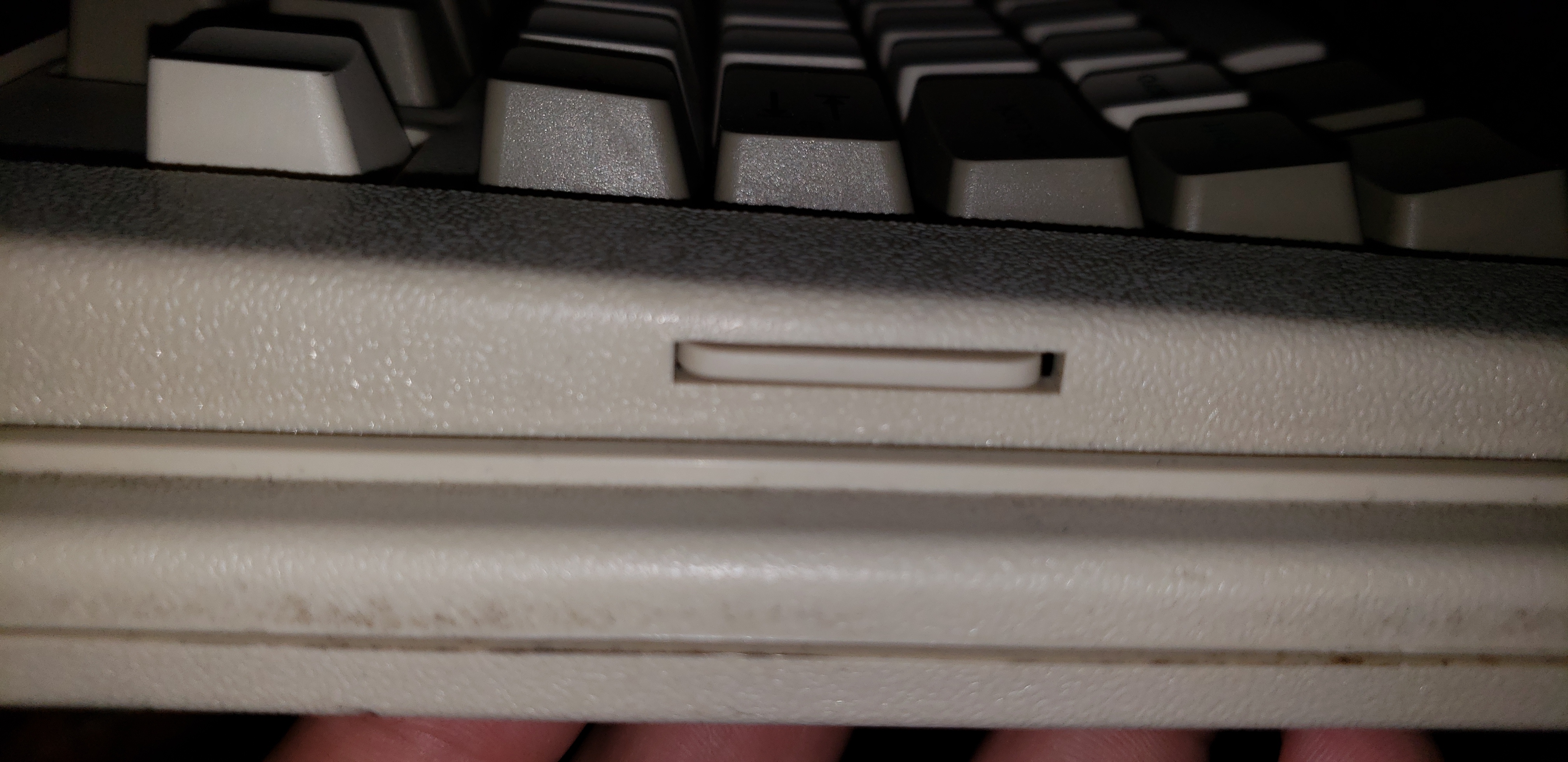

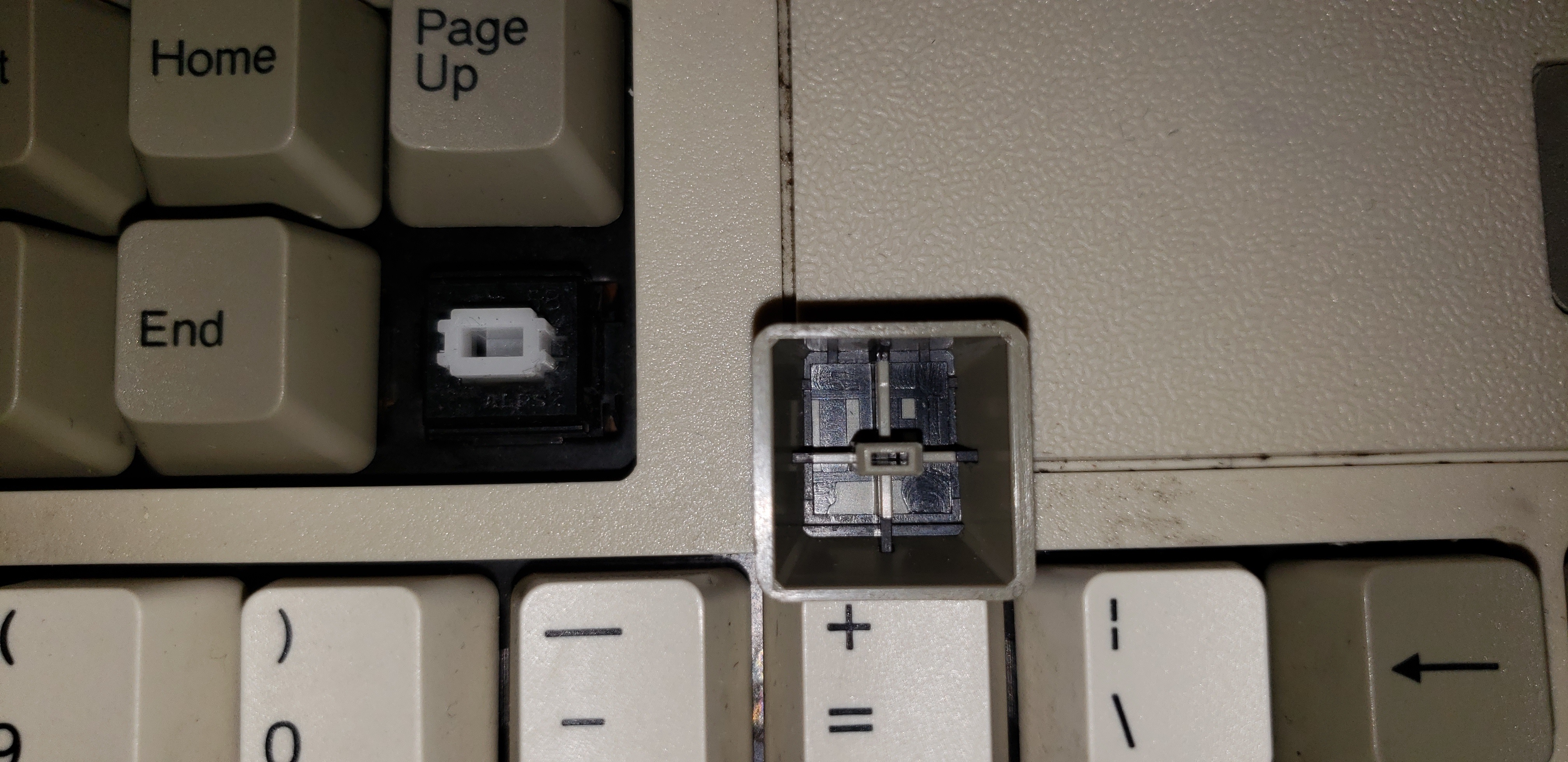

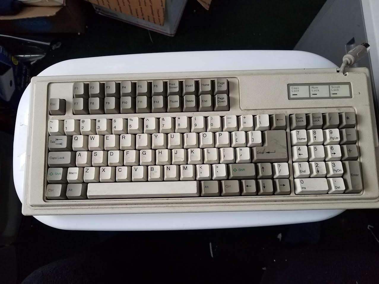

Hi, I'll try to keep this as short as possible.
I bought this keyboard off of Ebay, however the seller didn't have much info on it. There's no sticker on the back, and I haven't been inside it yet (if that even matters). Here's what I know so far...
1. White Alps SKCM ("pine" I think)
2. The connector cable is tiny (as seen in photo) making me think it's from a portable system.
3. AT/XT switch on the back.
4. The flip out feet have "I-80" molded on the underside.
5. The keycaps are doubleshots, but I don't know the type of plastic and there's no yellowing that I can see.
6. On the sides it has latches very similar to the Compaq Portable 1's keyboard.
Any information would be appreciated, thank you.

Quite likely a luggable portable PC’s keyboard. The macro key is quite interesting: it was programmable.
The caps are definitely ABS. Doubleshots always are. It’s still a good colour because it’s been kept in a box all these years, most likely.

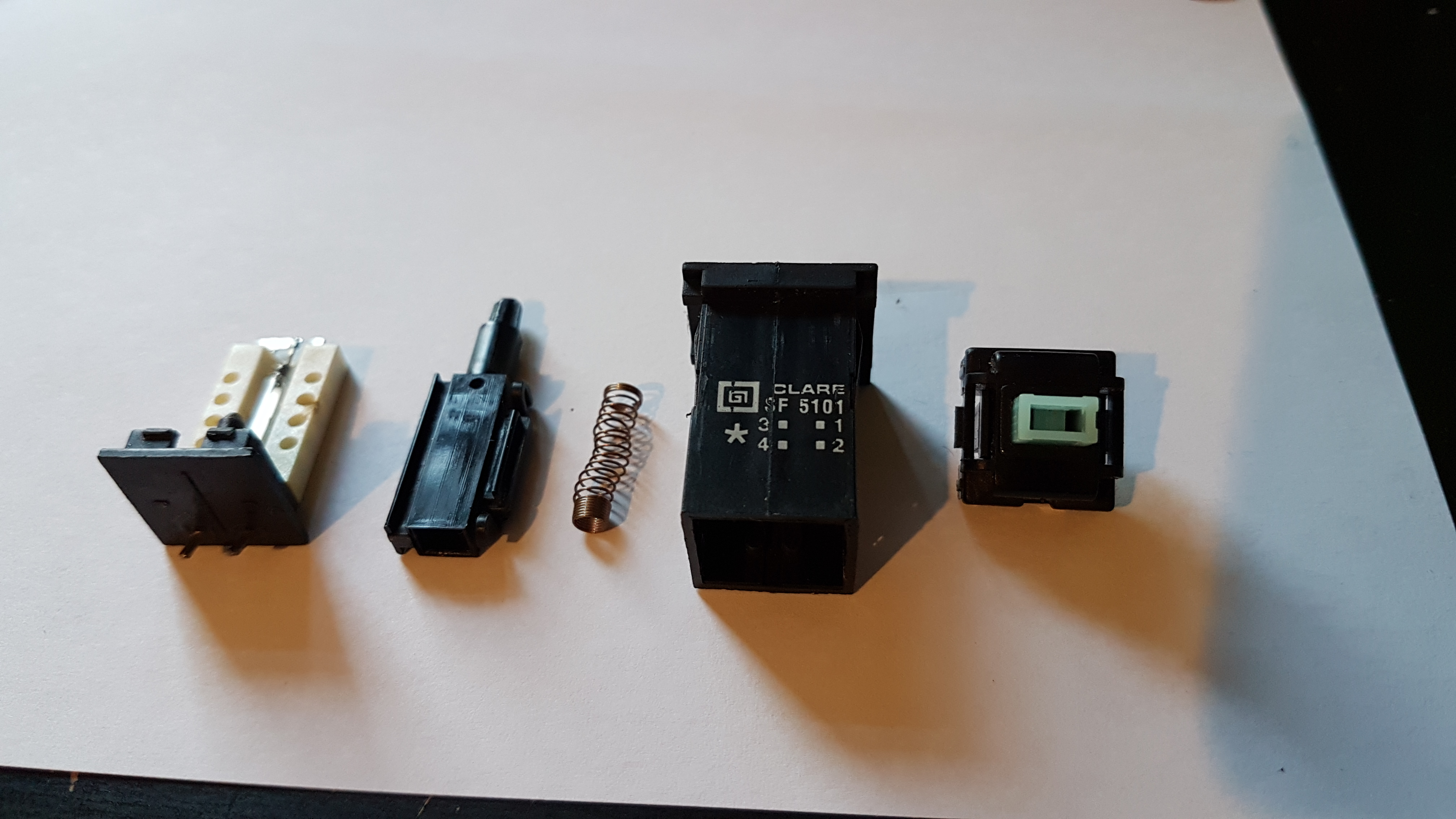

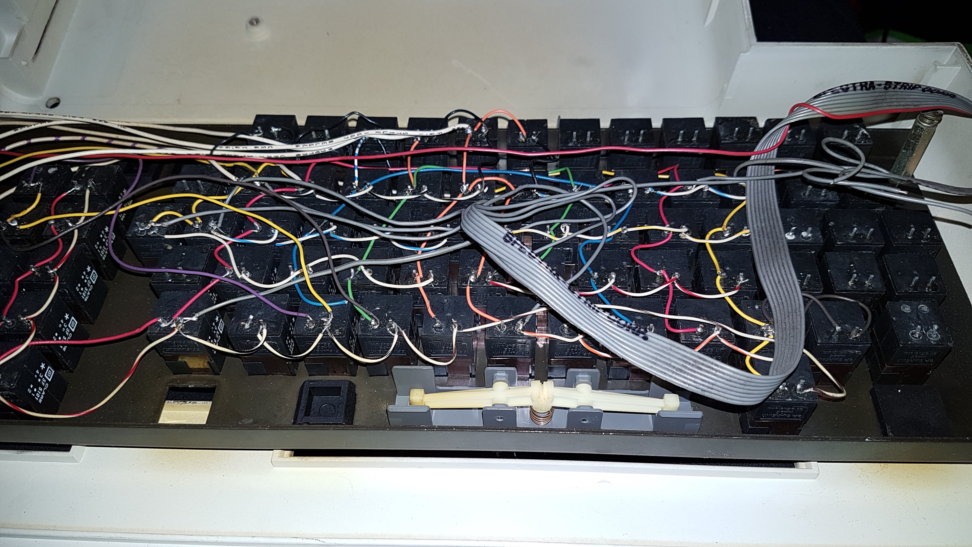

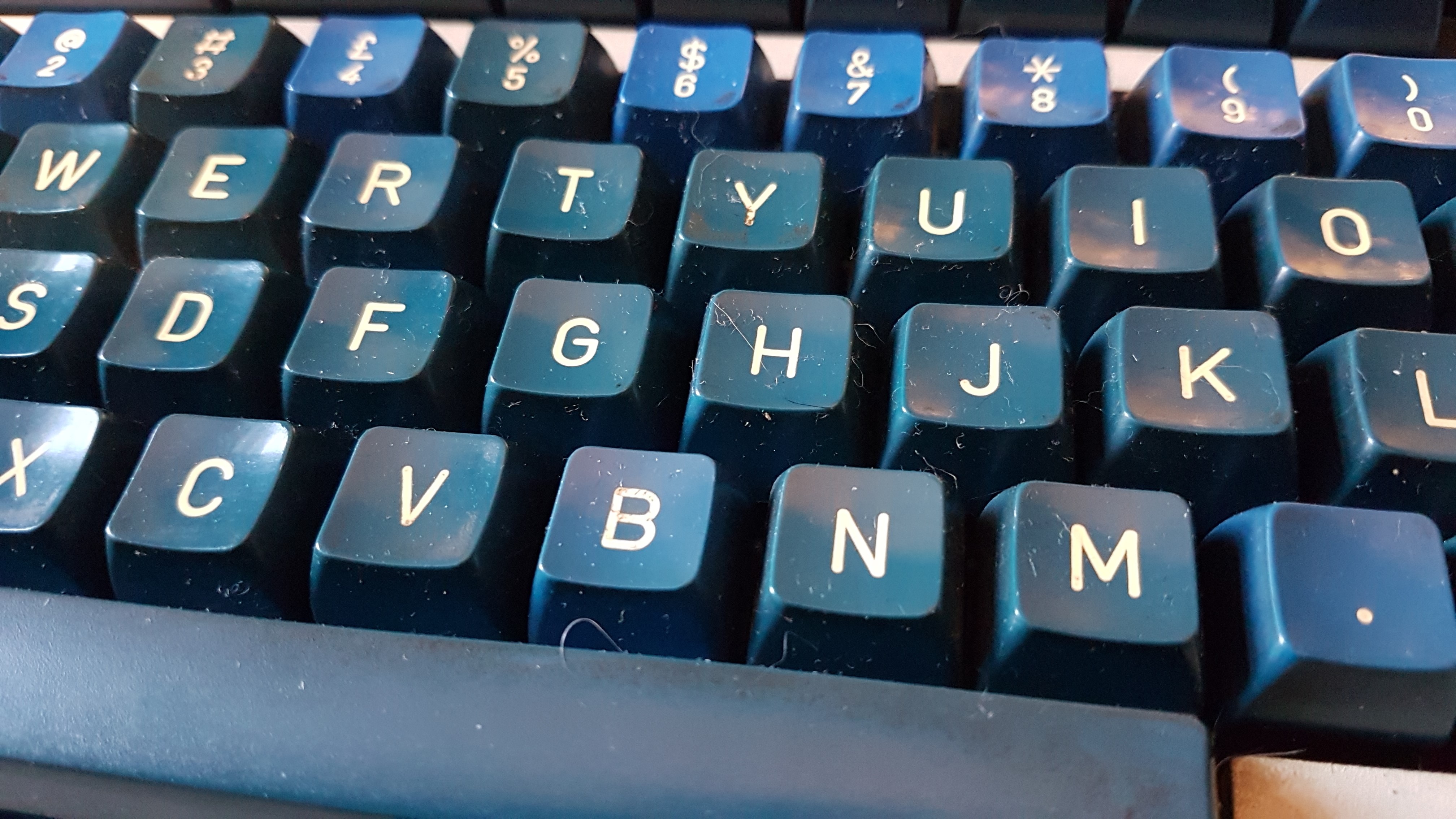

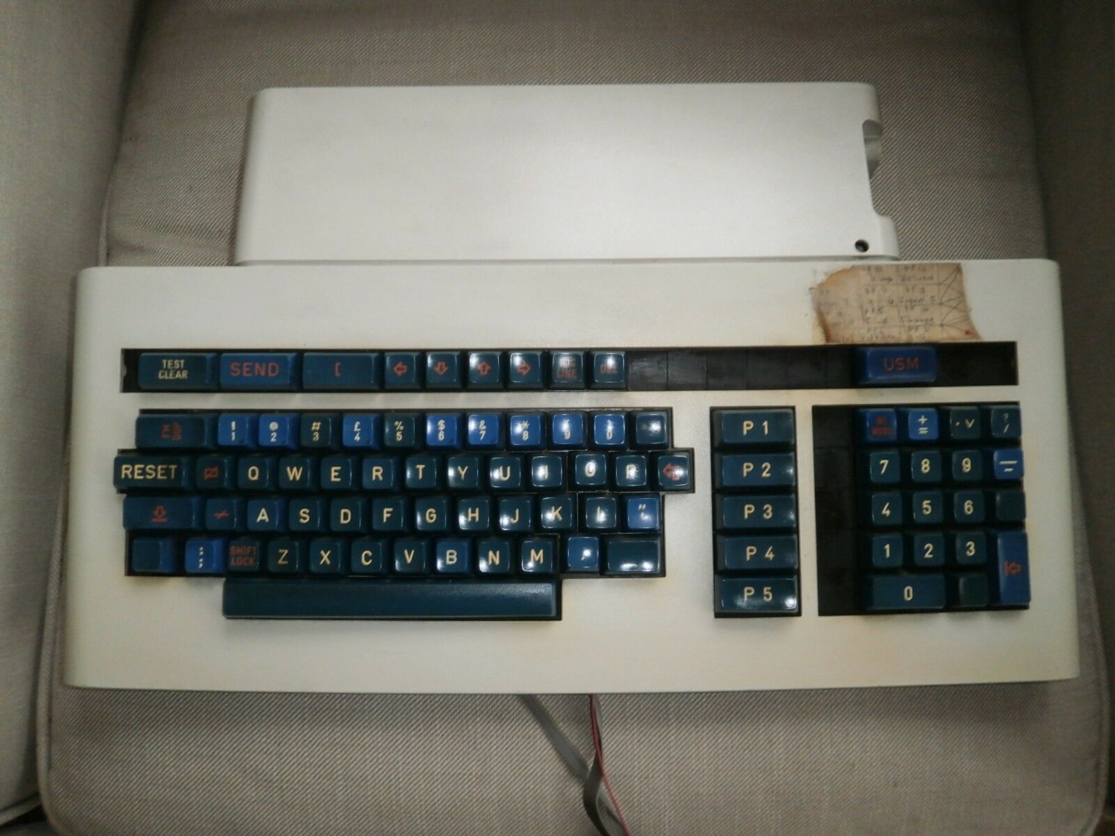

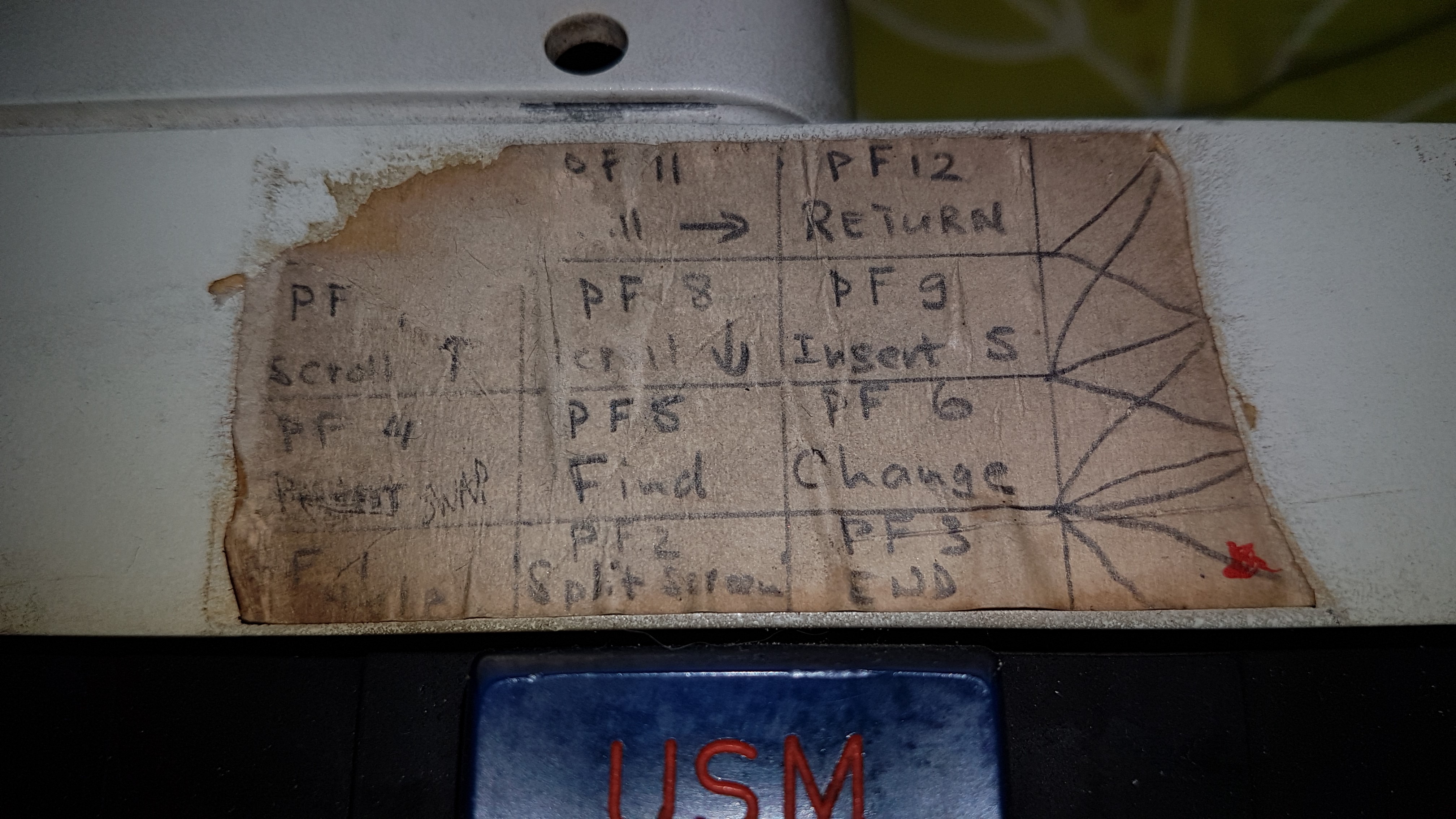

Anyone know anything about this? It looks like an Alfaskop 3700 keyboard (or a similar model) but I can't find anything on it. The keyboard matrix is hand wired and has ribbon connectors soldered to it. Possibly someone's DIY keyboard? It apparently has Clare-Pendar switches but I cannot confirm until I get it.

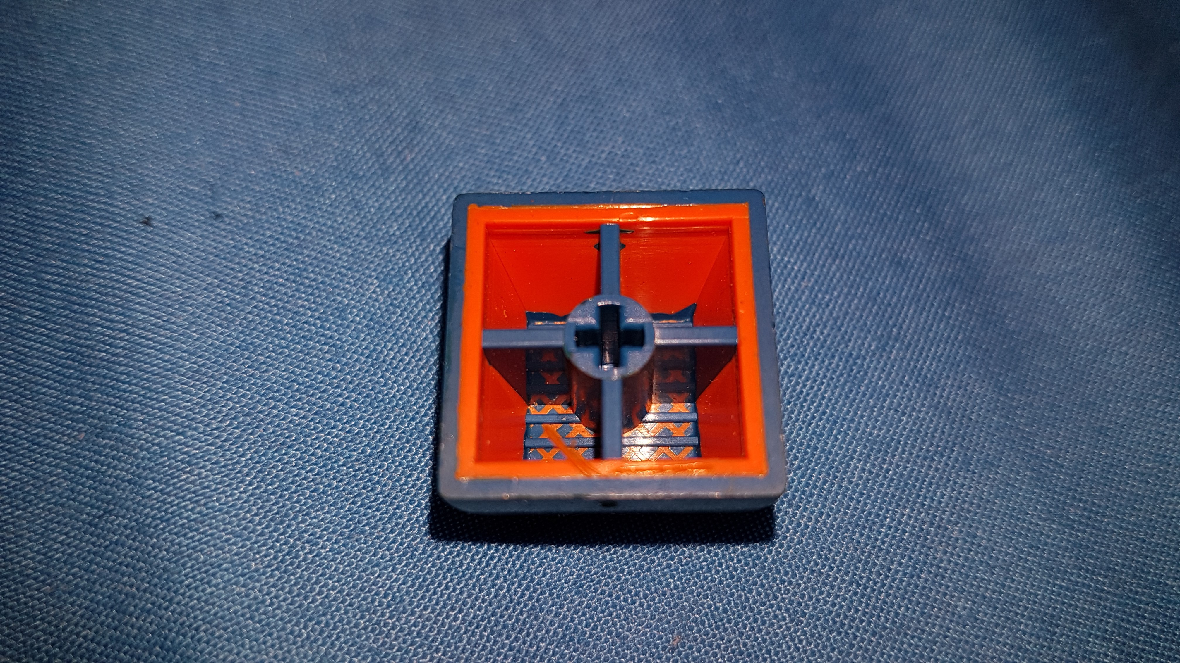

Hello! I was referred here by a friend who said you guys can help identify almost anything.
One of my friends in an enthusiast group for the game "The Talos Principle" pulled the textures out for the terminal, and we've been having a heck of a time trying to figure out what it's modeled after. Croteam is known for doing high-quality scans of real objects for textures, such as actually going to ruins in Albania and Egypt to get very accurate texture work, and so it's just a matter of curiosity to see what terminal they might have gotten this from.
Thanks much for your time!

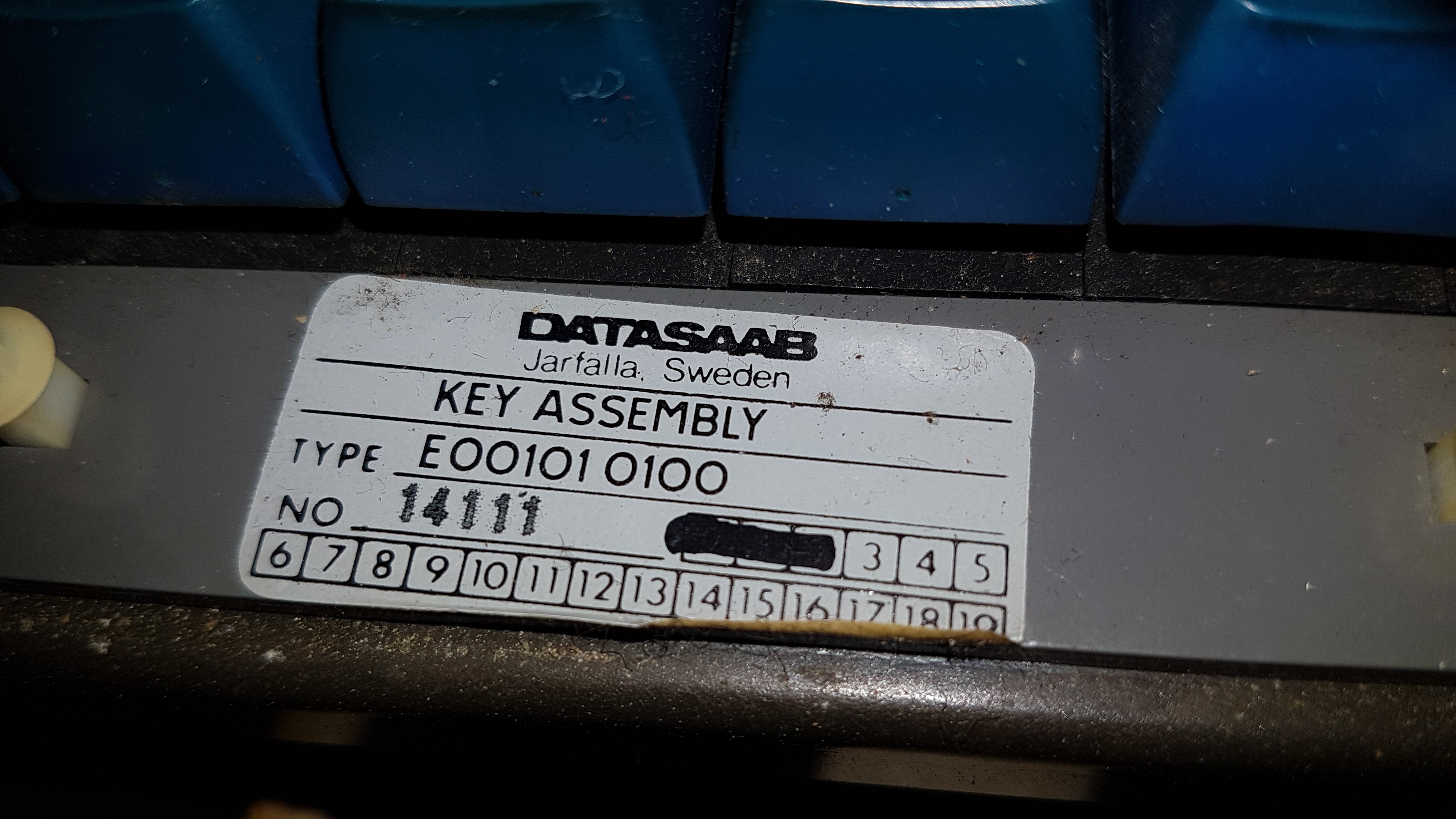

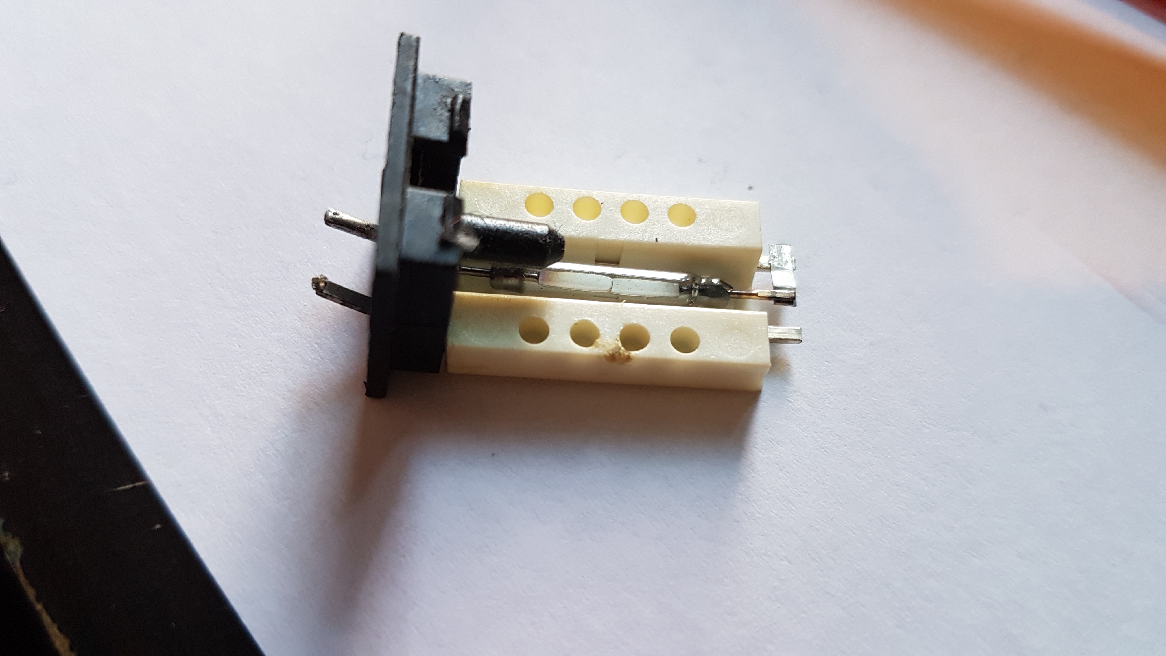

Update - Pulled the spacebar and there is a sticker underneath confirming it is a Datasaab keyboard (Type E00101 0100). Switches are Clare-Pendar SF 5101 (magnetic reed). After seeing it in person, I am confident somebody took an old Datasaab keyboard, desoldered the switches, put them in a strange layout and hand wired them. Still would like to know which machine this originally came from though. (Apologies about the big images
Comparison with an SMK 2nd Gen. Notice the bent spring - it's missing the magnet too :c

What was the hand wiring hooked up to: a Teensy or something vintage? Seems a strange layout to try to use today, given the lack of alpha block keys. You'd need to memorise some pretty weird combos just to type brackets and commas!

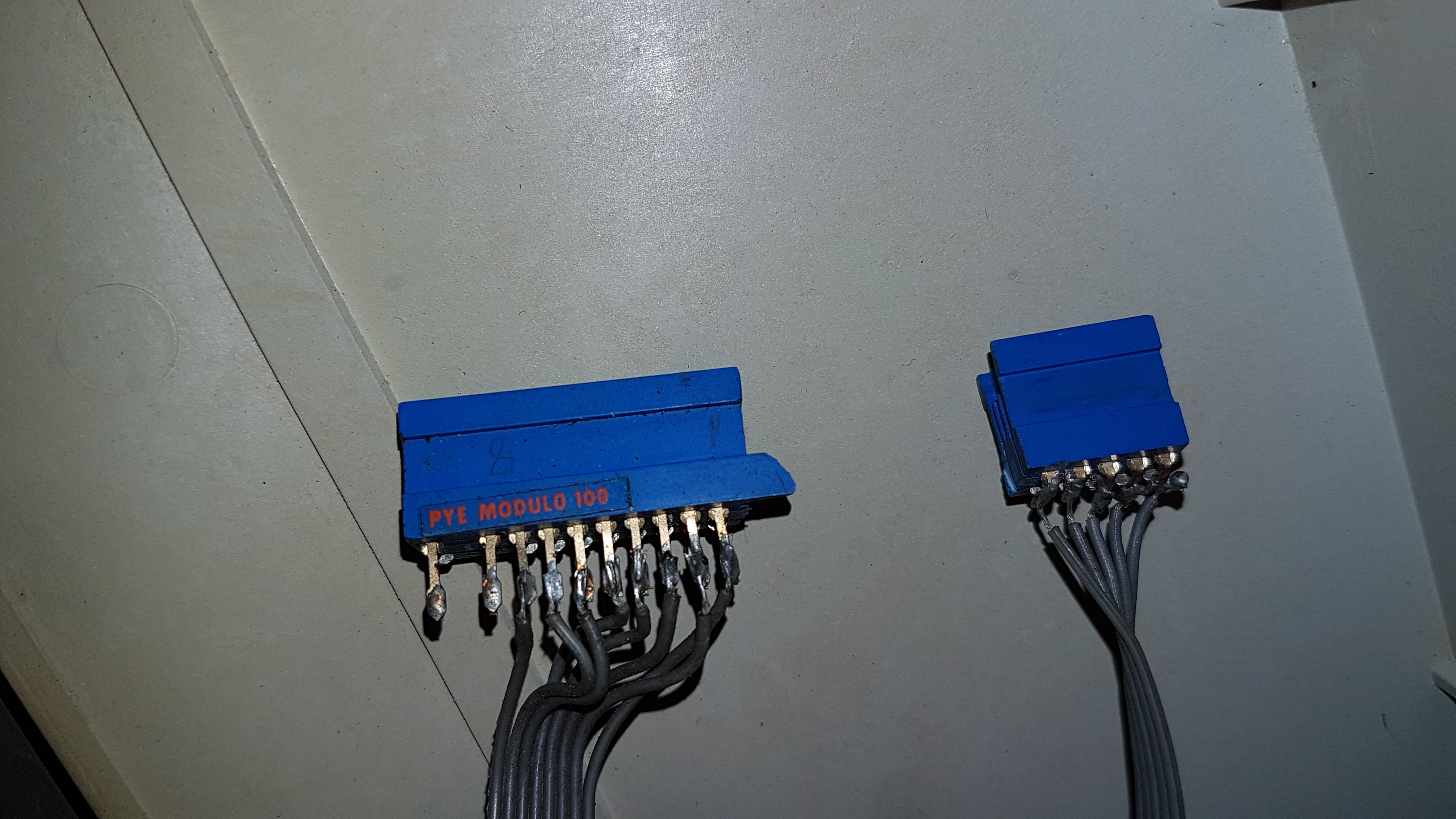

@Muirium - nope, no controller. Appears to be wired as a 5x8 matrix.
looks like an old PYE PCB edge connector someone snapped. Coolest part is this old masking tape where someone has written what looks like a diagram for the PF keys! I really wish I could source the missing keycaps - would make a cool restoration project.

This keyboard came from an Alfaskop 3500 series terminal, which were sold from 1974 on until the end of the 1970ies, when they were succeeded by system 37 aka the 3700 series with reddish brown keys, not blue ones. There were several models in the 3500 series, also custom-made systems, but this one definitely has been tinkered with. That's sad, but, on the other hand, it probably wouldn't have survived otherwise.Aran.E99 wrote: 30 Jan 2019, 17:08 After seeing it in person, I am confident somebody took an old Datasaab keyboard, desoldered the switches, put them in a strange layout and hand wired them. Still would like to know which machine this originally came from though.

Thanks, I figured as much but thought it was an Alfaskop 3700 since theres little info on googleOleVoip wrote: 31 Jan 2019, 19:53This keyboard came from an Alfaskop 3500 series terminal, which were sold from 1974 on until the end of the 1970ies, when they were succeeded by system 37 aka the 3700 series with reddish brown keys, not blue ones. There were several models in the 3500 series, also custom-made systems, but this one definitely has been tinkered with. That's sad, but, on the other hand, it probably wouldn't have survived otherwise.Aran.E99 wrote: 30 Jan 2019, 17:08 After seeing it in person, I am confident somebody took an old Datasaab keyboard, desoldered the switches, put them in a strange layout and hand wired them. Still would like to know which machine this originally came from though.

Ha, what a wiring job! I see whole switches with nothing connected. Definitely fair game to do your own Teensy refit.
You may well be right that particular keyboard only survived because someone chose to do this. Such old gear always has a story.

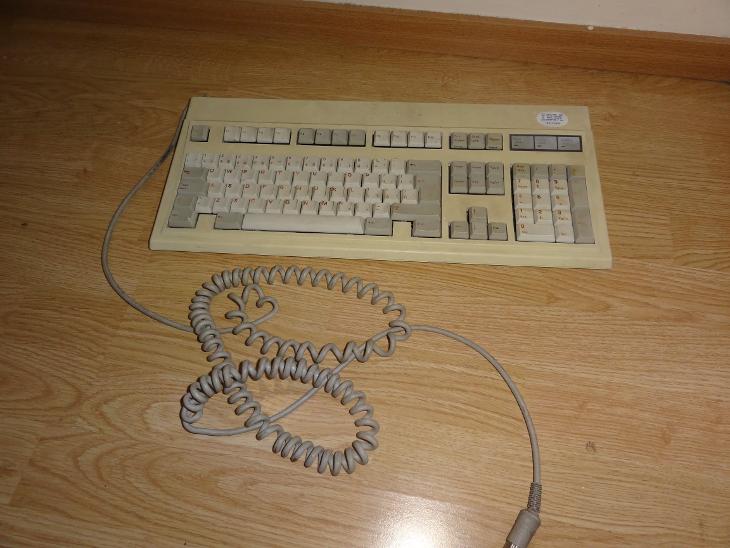

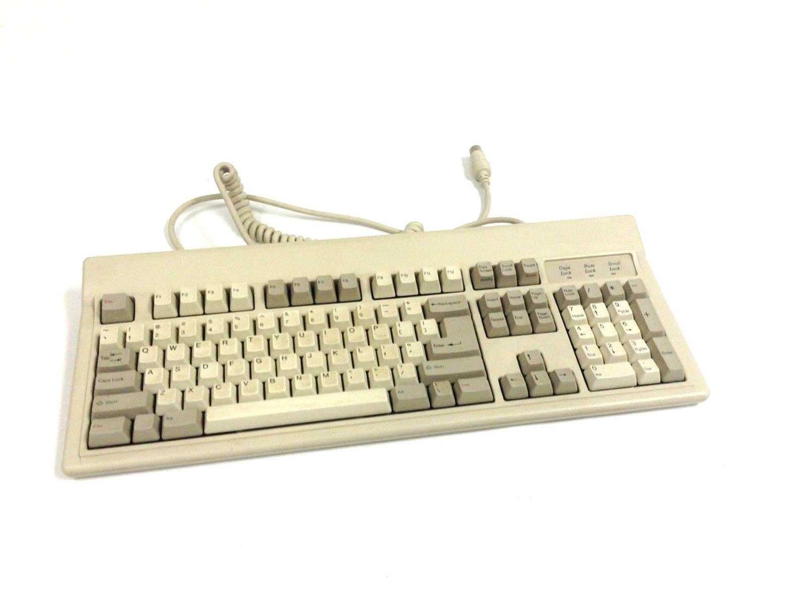

Does anyone know what keyboard could this be?
Model name is Typ 263.12
Thank you
Thank you
