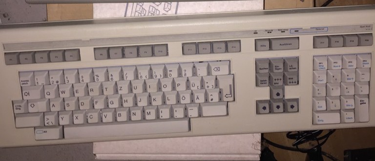

So I recently ordered this keyboard and I would like to know what is it. It uses cherry mx blues and the caps seem really nice. That's all I know for now
- Location: Stockholm, Sweden
- DT Pro Member: 0011
It looks like it was taken from an old laptop.
Laptops from Mitsubishi and Toshiba were in that colour scheme, but I think Toshiba's had Alps switches. Mitsubishi had small function keys like that.
Oh, and Dolch's luggable computers had also that colour scheme but I've not seen that exact layout.

It's definitely interesting and I'll try and make it work on normal computer. Also got few basic keyboards with white alps. I'd say a good deal for 40$

Same color scheme than Bondwell keyboards with Cherry navy blue switches. Very interesting.

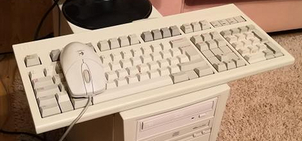

The programmable Northgates with winkeys and an LED in the up arrow are what I call "Generation 4", which were also sold under the Avant brand name (Avant Stellar and Avant Prime). Here are a couple links with info on those that should answer your questions:
http://lowendmac.com/2006/avant-prime-r ... -keyboard/
https://pythonconquerstheuniverse.wordp ... -keyboard/

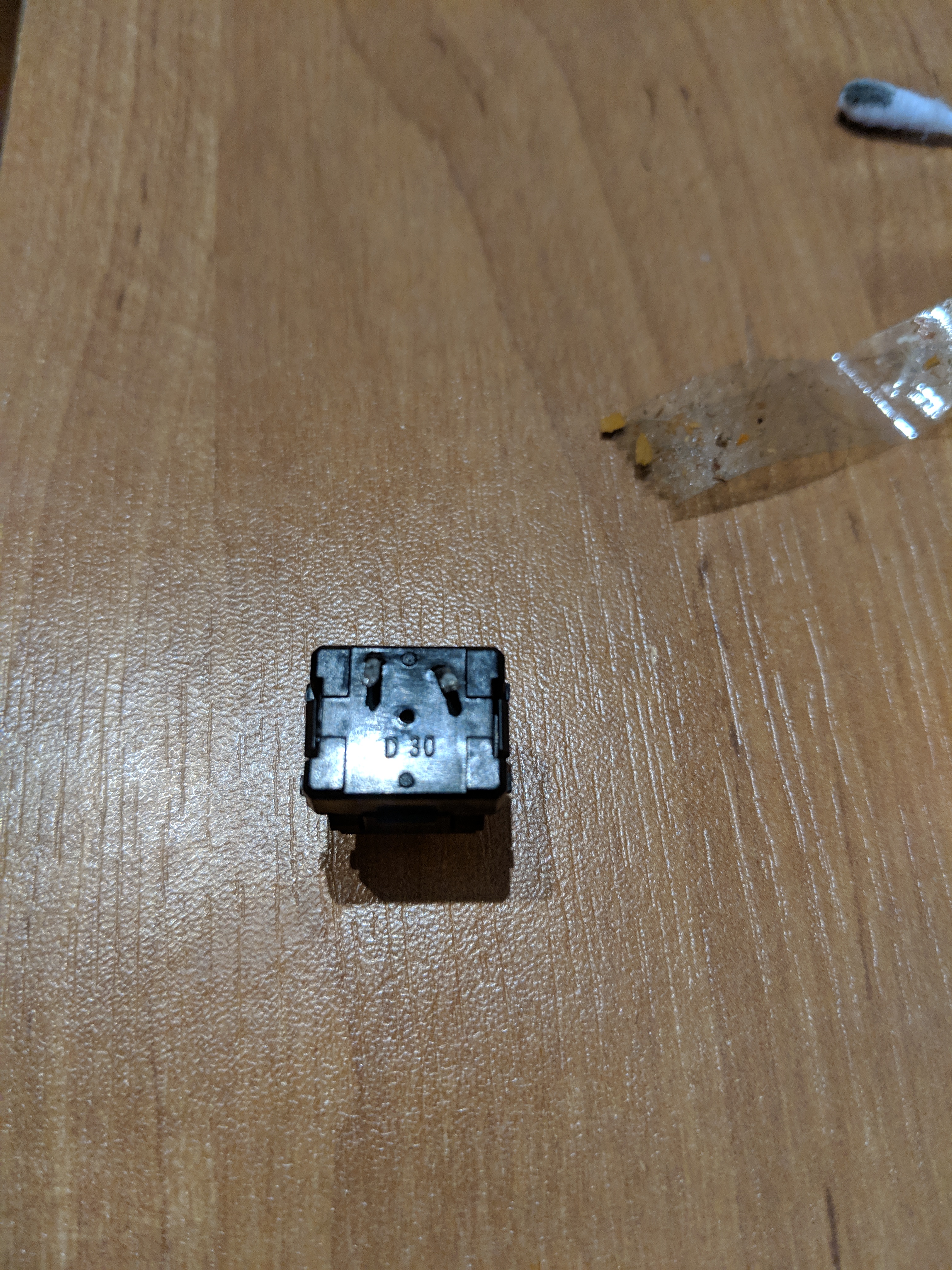

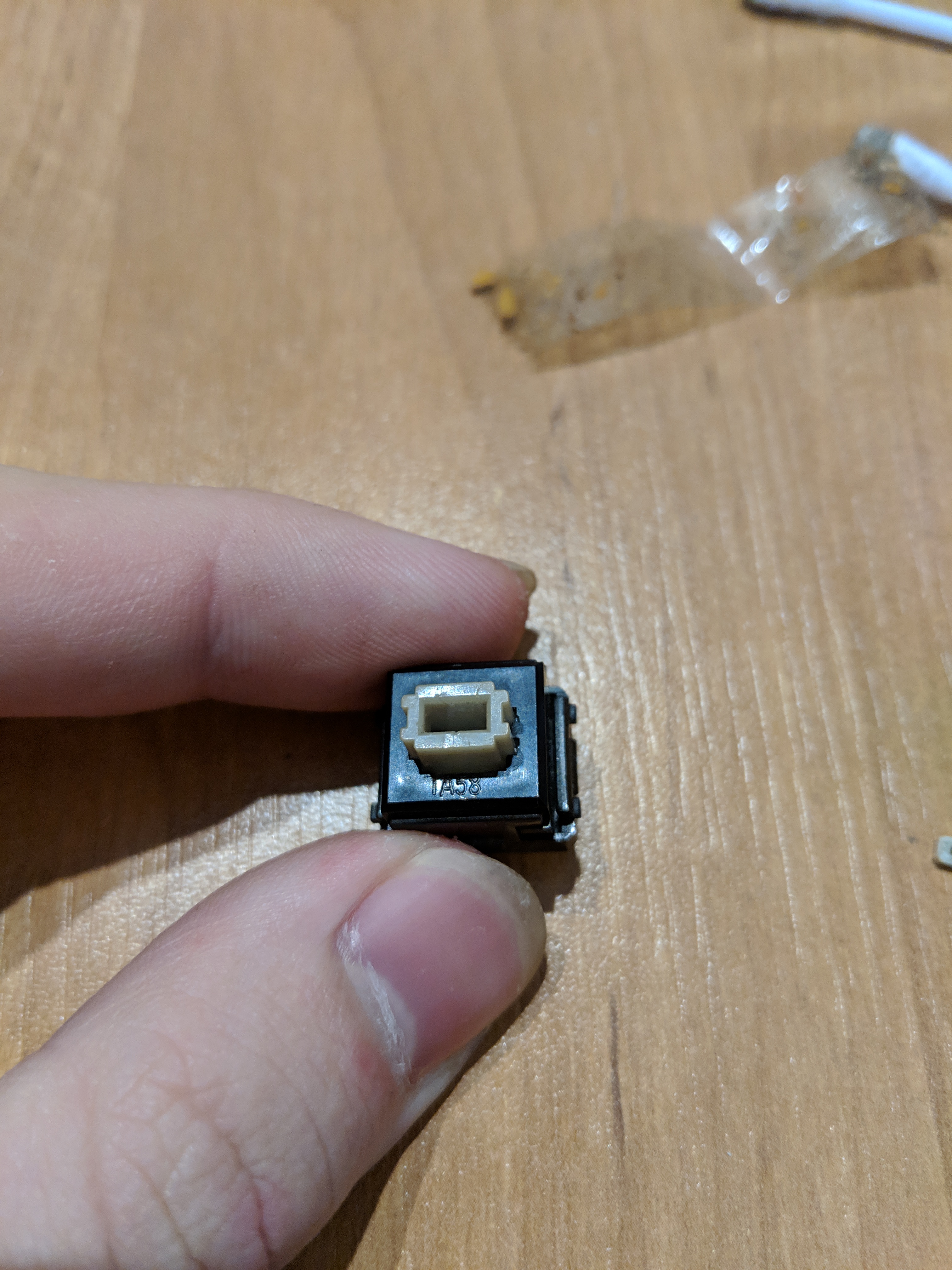

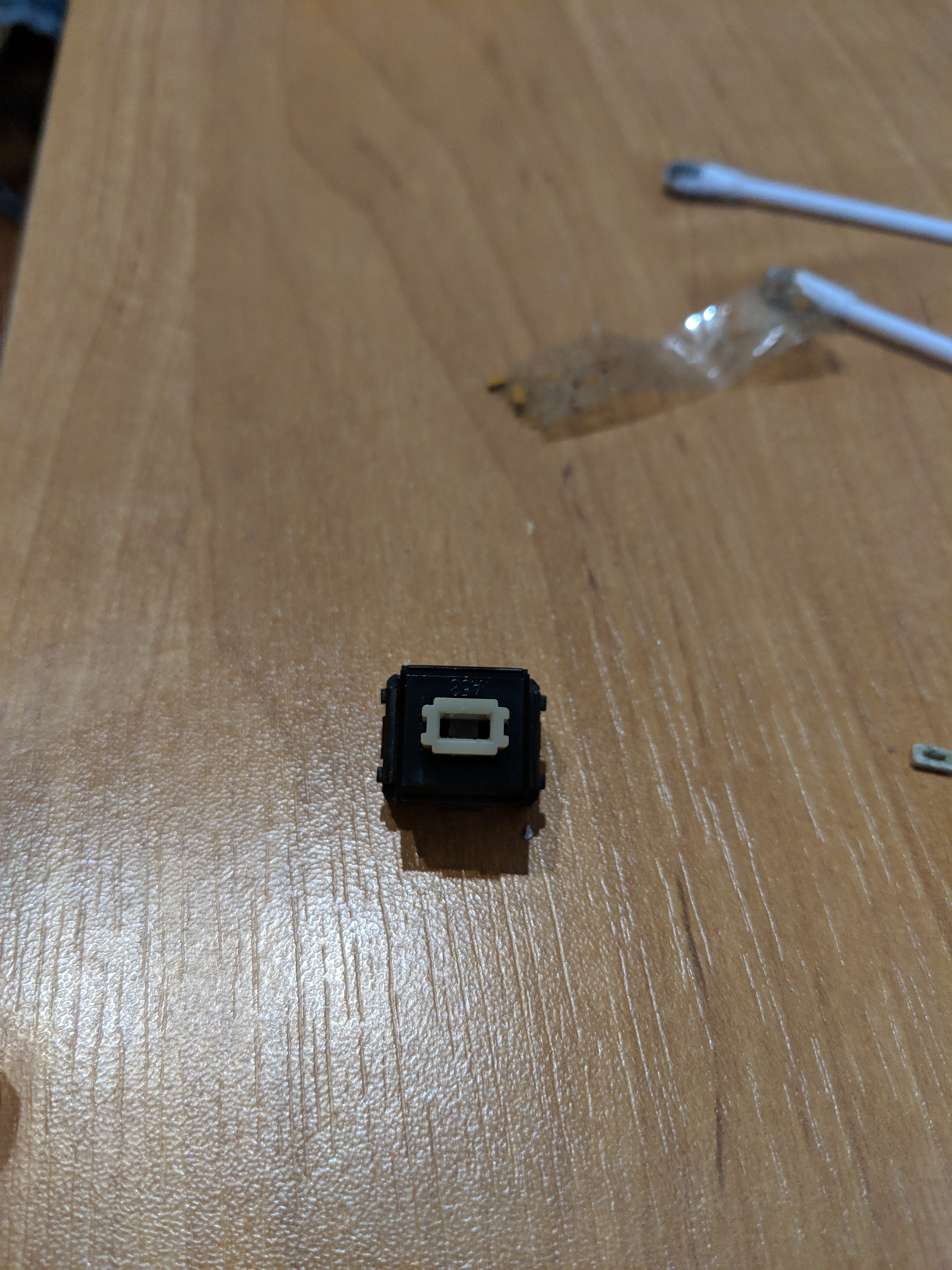

So I've got this from a NTC keyboard. It's full of "White alps" they sound way clickier and sharper than my other white alps, plus they are missing alps logo. Could someone tell me if its a clone or something? Thank you
- swampangel
- Location: Canada
- Main keyboard: Northgate Omnikey 101
The outside housing tells you it's a wiki/Four-tab_clone -- getting more specific probably involves opening it up. "Louder and clickier" makes it sound like wiki/Hua-Jie_AK_series is a possibility, but there may be many others.
