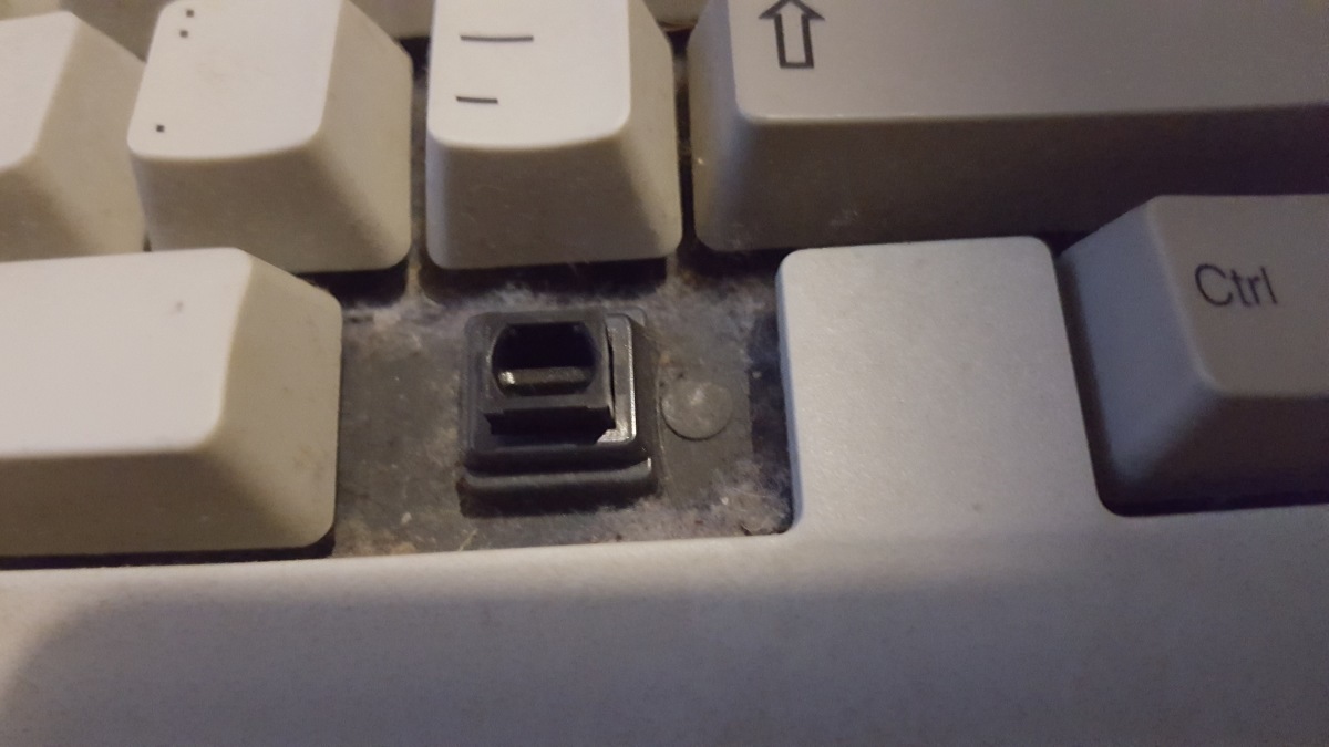

Could anyone indentify the switch in the photo? I do not have the keyboard, but I'm considering purchasing it. To me it looks like dome with a slider type, but I can't identify which it is.
Thanks!
Thanks!
- switch_1.jpg (118.21 KiB) Viewed 6745 times

Can confirm NMB dome with sliders.Voima-tonna wrote: 09 Feb 2019, 16:49 Could anyone indentify the switch in the photo? I do not have the keyboard, but I'm considering purchasing it. To me it looks like dome with a slider type, but I can't identify which it is.
Thanks!

Thanks so much! I thought they might be NMB, but the color threw me off.

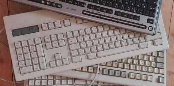

I have found this on ebay
https://www.ebay.de/itm/Used-Vintage-me ... rk:48:pf:0
I do not think that it is a Chicony board, but a NTC KB-6251. Is this correct? And what kind of switches does it have? Simplified or complicated white ALPS? Is it worth the money?
- Chyros
- Location: The Netherlands
Yes, that looks like a NTC instead. Note the FCC ID of FMA, and it also uses NTC-type keycaps.ghostdawg187 wrote: 11 Feb 2019, 12:14 I have found this on ebay
It's difficult to say with certainty what the switches are as the picture is very dark, but even if it IS complicated, it's bamboo type, so not as good as the older pine variant.

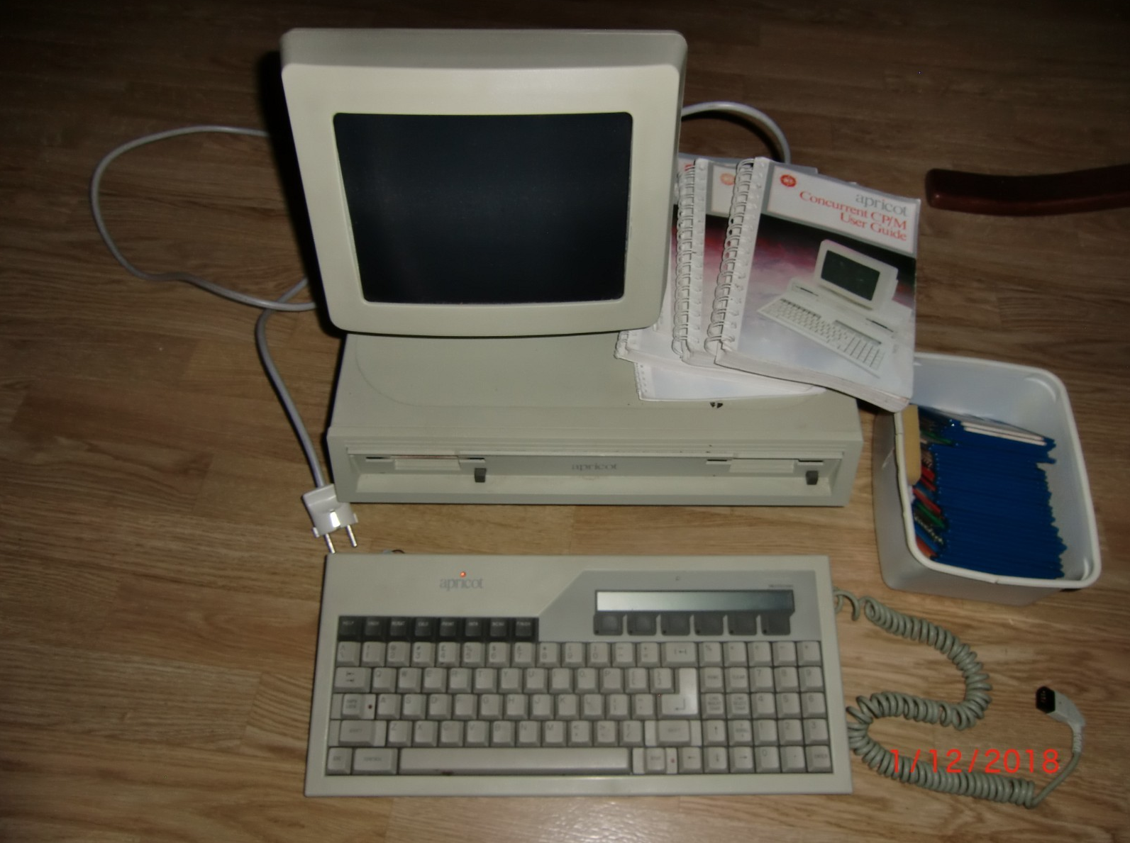

Obviously an Apricot computer/board, but does anyone know which model and if it's actually worth getting?
