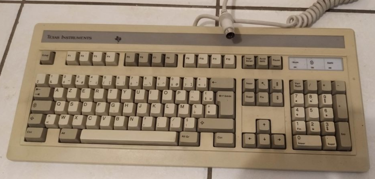

Hm, having mixed feelings about this one. It looks extremely flat, but could still have ALPS, no? Anyone got an inkling? Thanks!

looks like NMB slider over dome, but I'm not sureKeybug wrote: 10 Sep 2019, 22:45 Hm, having mixed feelings about this one. It looks extremely flat, but could still have ALPS, no? Anyone got an inkling? Thanks!
I don't know what it actually is, but it's similar to this keyboard : viewtopic.php?t=13636 so I would guess it has the same switches

Myoth: I actually found an NMB board with space invaders in a practically identical case. What made you assume it's sliders-over-dome?

The caps, probably. The profile is very different for SI.Keybug wrote: 12 Sep 2019, 13:24 Yes, Rafi-made for sure!

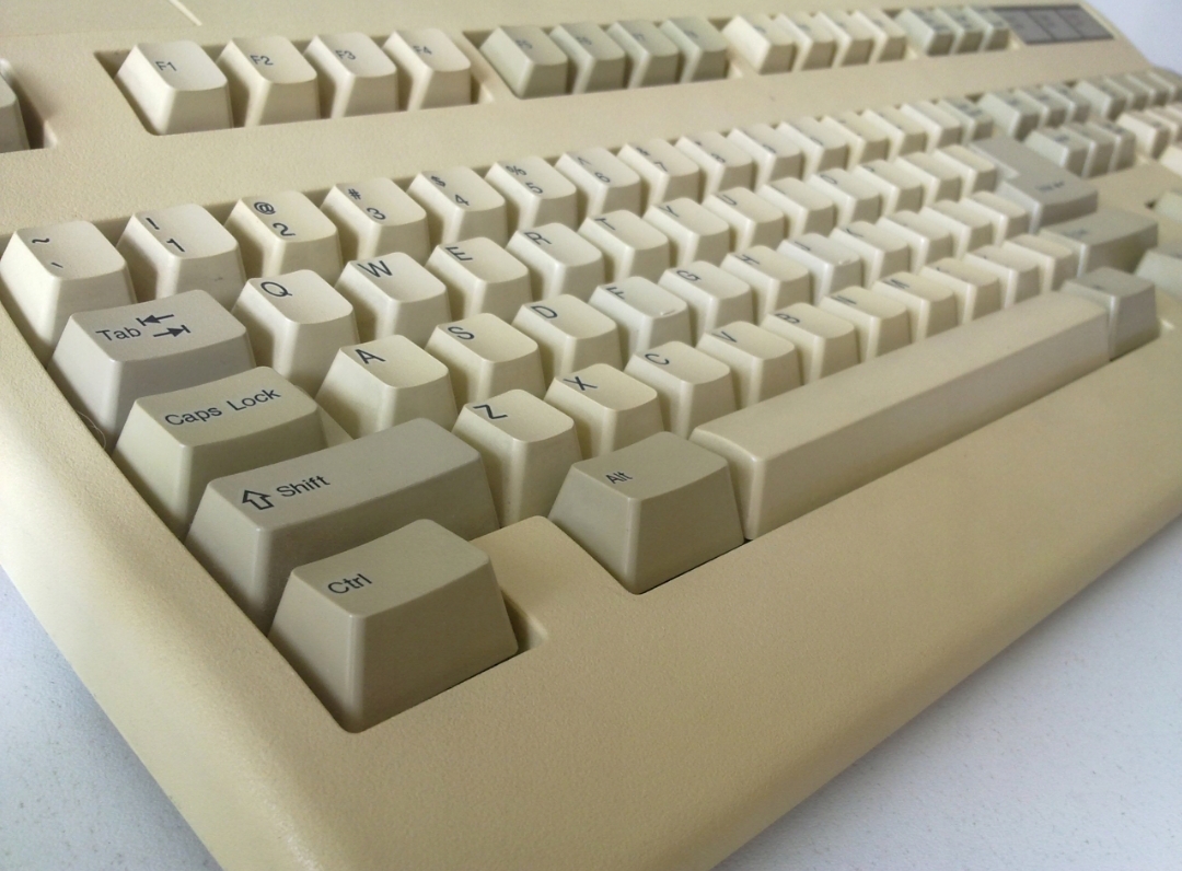

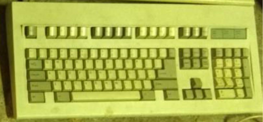

Found this online, looked similar to model M in the thumbnail but upon further inspection I couldn't really guess. The only thing known about it is it's from 1992. Any ideas? It's a tricky one I guess

Key Tronic rubber dome. The rounded case with rounded corners and front lip is very characteristic.Neonkyle wrote: 17 Sep 2019, 16:40 Found this online, looked similar to model M in the thumbnail but upon further inspection I couldn't really guess. The only thing known about it is it's from 1992. Any ideas? It's a tricky one I guess
Could be hit or miss: some are good, some are mushy. We haven't found a way to tell which ones are which.

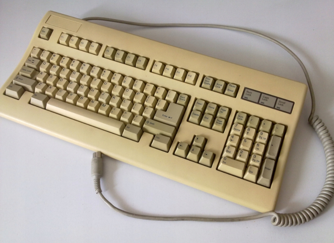

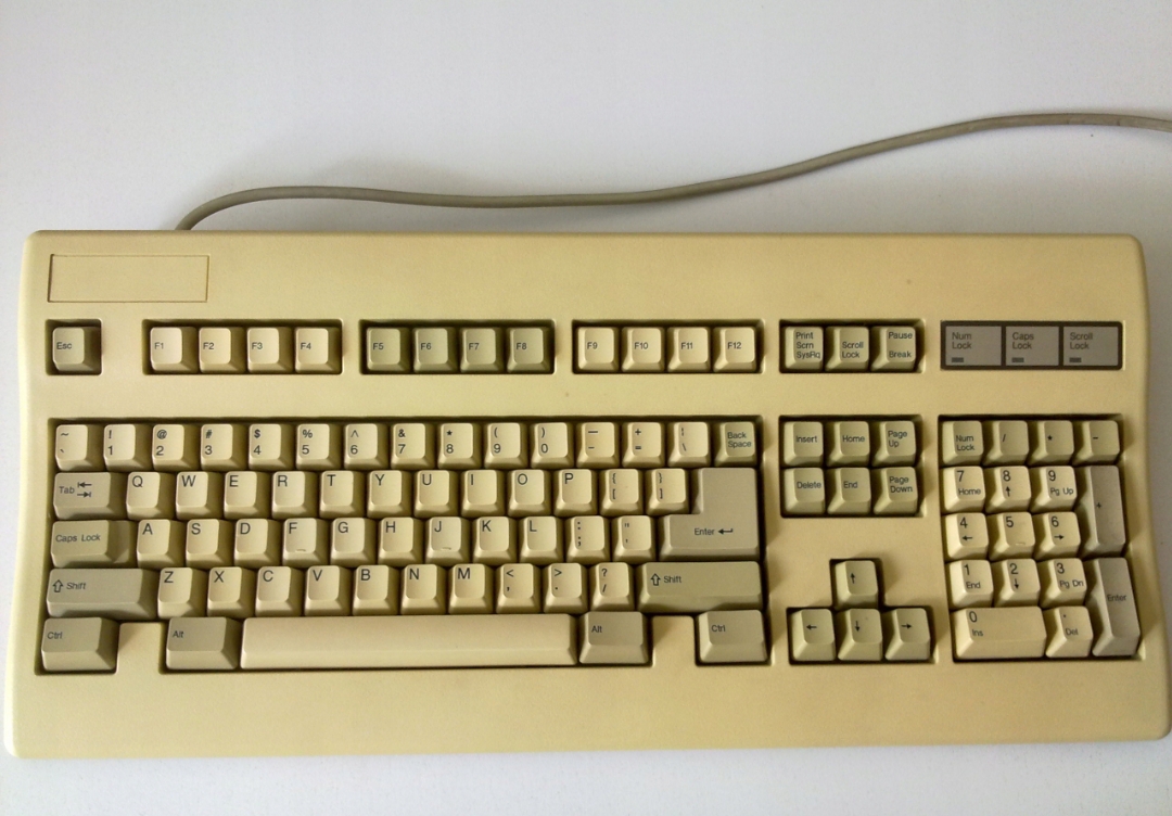

What about this one? I'm looking to get into collecting old keyboards, and its hard finding anything decent here.
Found that online too, zero details on that one, aside from blurry bad resolution images.

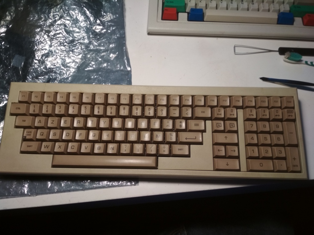

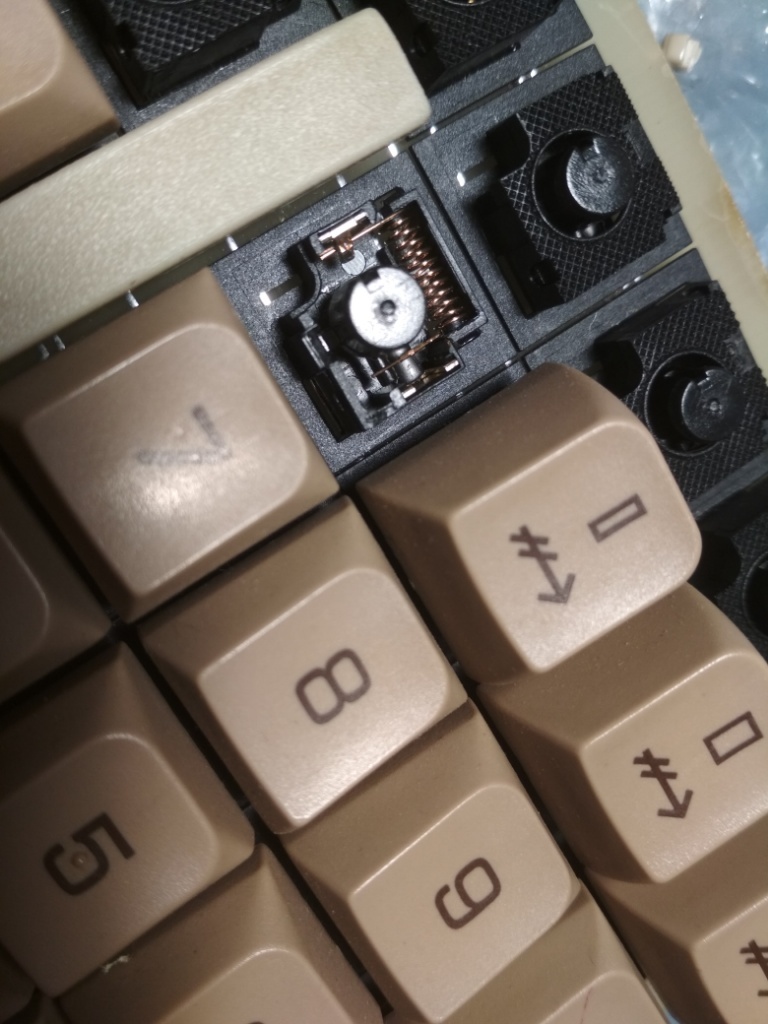

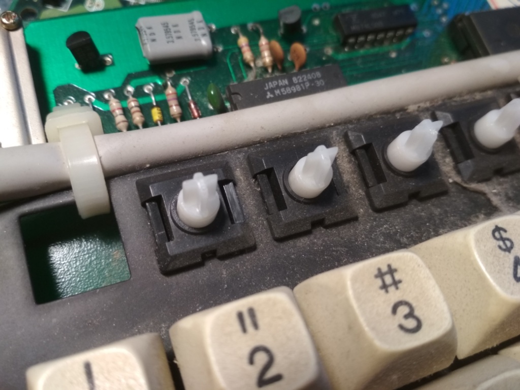

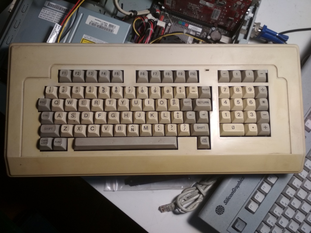

Hi there - new here but very much bitten by the bug...
Picked up these two recently, expecting to easily be able to identify them, but neither has any identifying marks I can find. Both seem pretty CP/M-ish. The first has incredible thick ABS keycaps, but other than that feels very cheap & rough. The second has low DSA-like PBT (?) keycaps and really smooth linear switches. I prefer my keyboards tactile, but this one would be a beauty to type on.
I bought both 2nd hand in NL, but the smooth board is FR-style AZERTY and has a flip-out Calcstar function key hint card.
1st, 'cheap' board:
2nd 'smooth' board:
Note that I cleaned both boards after these pictures were taken.
1st, 'cheap' board:
2nd 'smooth' board:

First one looks like smk vintage linear or clone for the switches.
The second, what the hell are those switches?

viewtopic.php?f=8&t=5167&start=
You know, that mount looks almost something like this. Let me do a bit more research...

dionb wrote: 17 Sep 2019, 23:29 Hi there - new here but very much bitten by the bug...
1st, 'cheap' board:
2nd 'smooth' board:
Took me a while, but I had torsion spring in my head… I couldn't figure out why.
viewtopic.php?t=9821&start=30
Here you go! Phillips Torsion spring switches.
viewtopic.php?p=208657#p208657
They are exactly the same as yours.

Are SMK Vintage switches supposed to be even remotely smooth? These aren't in any event, and the build quality (plastic used in the cross) looks lower than on pics of SMK Vintage switches.Lbibass wrote: 17 Sep 2019, 23:46 The first one looks like SMK Vintage linear. I know I have seen the second one somewhere…
Yep, those are the switches! In fact not just the switches - those keycaps are the same design too, with the square front and rounded back, and same font.Lbibass wrote: 17 Sep 2019, 23:56 [...]
Looks like a Philips board then.

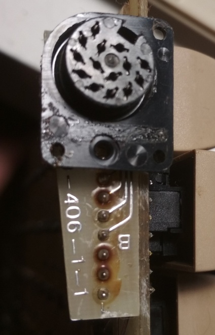

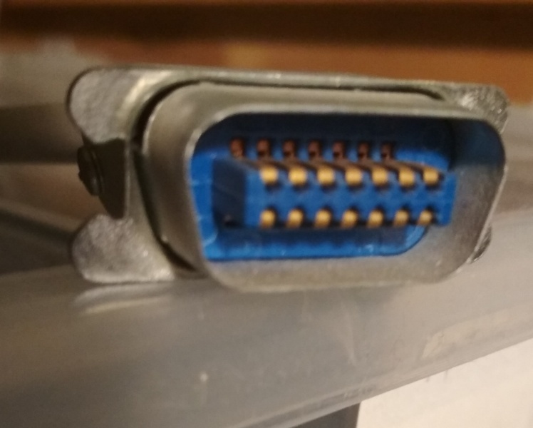

Any idea what kind of system they came from, and what that DIN-19 connector might talk? I recently made my own controller for an Osborne Variant 1 with 20 pin connector - that just passively fed the key matrix out of the cable. If this did the same it should be easy to get something hooked up. However there seems to be a bit more logic on this board than on the Osborne.
