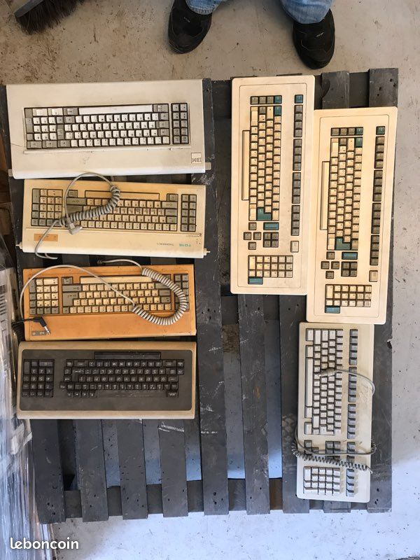

Anything worth shelling out for in this picture? The green keys' colour (top right) is reminiscent of Cherry TA boards, but everything else about those board seems rather un-Cherry. Bottom right?
On the top left, the F-XT is obvious, with a cheap (?) F-AT clone beneath it (possibly Alps or MX-clones in it?). possible a Bull board one further down, with Cherry-style LED windows? No idea about that black board in the bottom-left corner, though.

I wouldn't doubt a second about buying that lot, all of those look really interestingKeybug wrote: 30 Oct 2019, 20:20 Anything worth shelling out for in this picture? The green keys' colour (top right) is reminiscent of Cherry TA boards, but everything else about those board seems rather un-Cherry. Bottom right?

The two long boards with blue and white keys look like Fortune 1000s, some of which (not all) have very cool Digitran capacitive leaf switches (I posted about one here: viewtopic.php?f=7&t=20051 )Keybug wrote: 30 Oct 2019, 20:20 Anything worth shelling out for in this picture? The green keys' colour (top right) is reminiscent of Cherry TA boards, but everything else about those board seems rather un-Cherry. Bottom right?
Thanks.
The model F looks like a Bigfoot and the board on the lower left looks like it might be a DEC VT100 (I posted about one here: viewtopic.php?f=7&t=19795 )

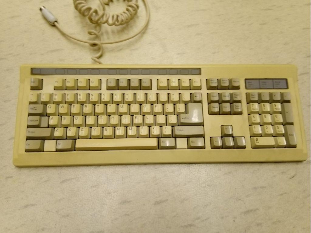

As for these: Cherry inside? (Wyse clones?)
- Location: Stockholm, Sweden
- DT Pro Member: 0011
The keycaps look like Cherry doubleshots to me. Possibly Cherry G80-130x innards in another case?

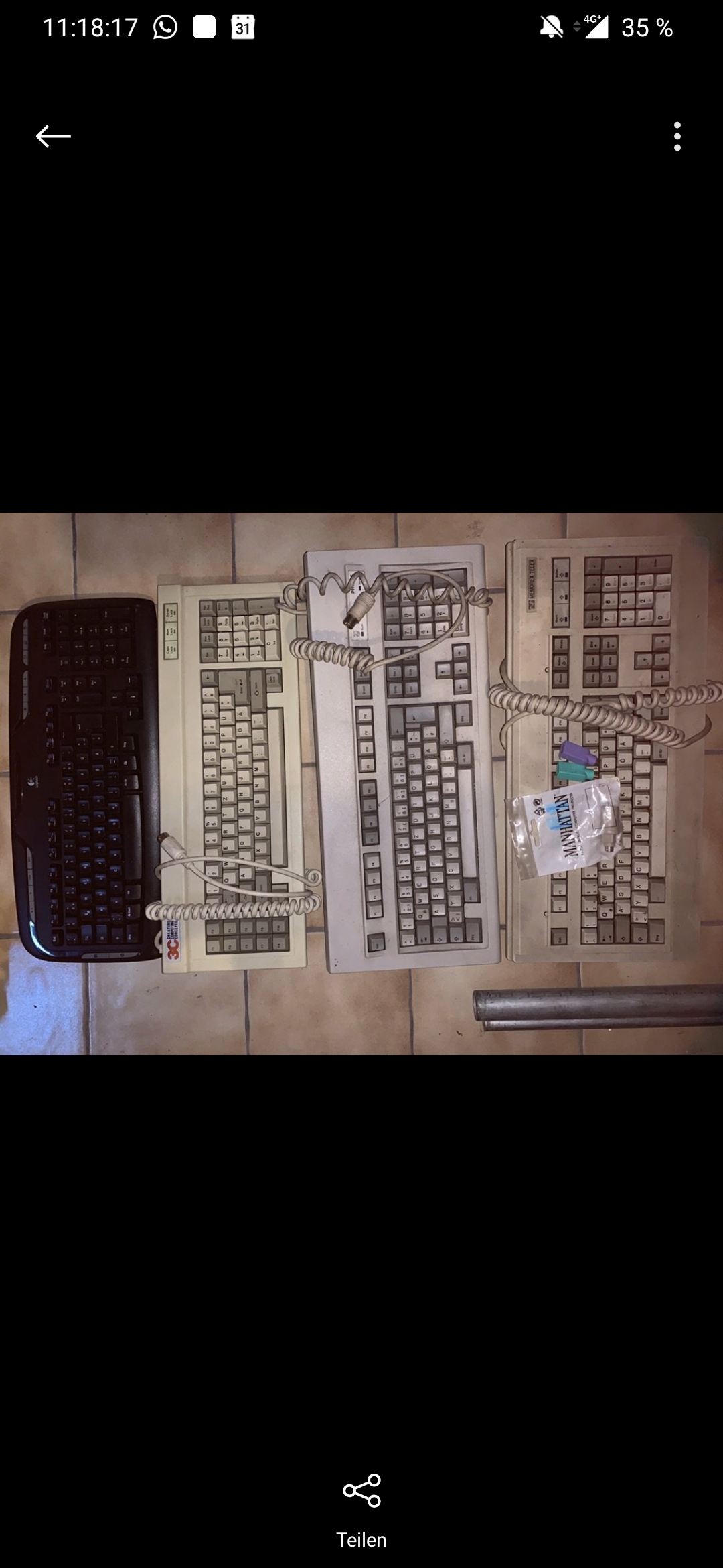

Another bunch of keyboards, I know the philips is a rubber dome and i think the memorex telex is a nmb hi-tek keyboard. Do you have any idea what the 3C branded one could be?

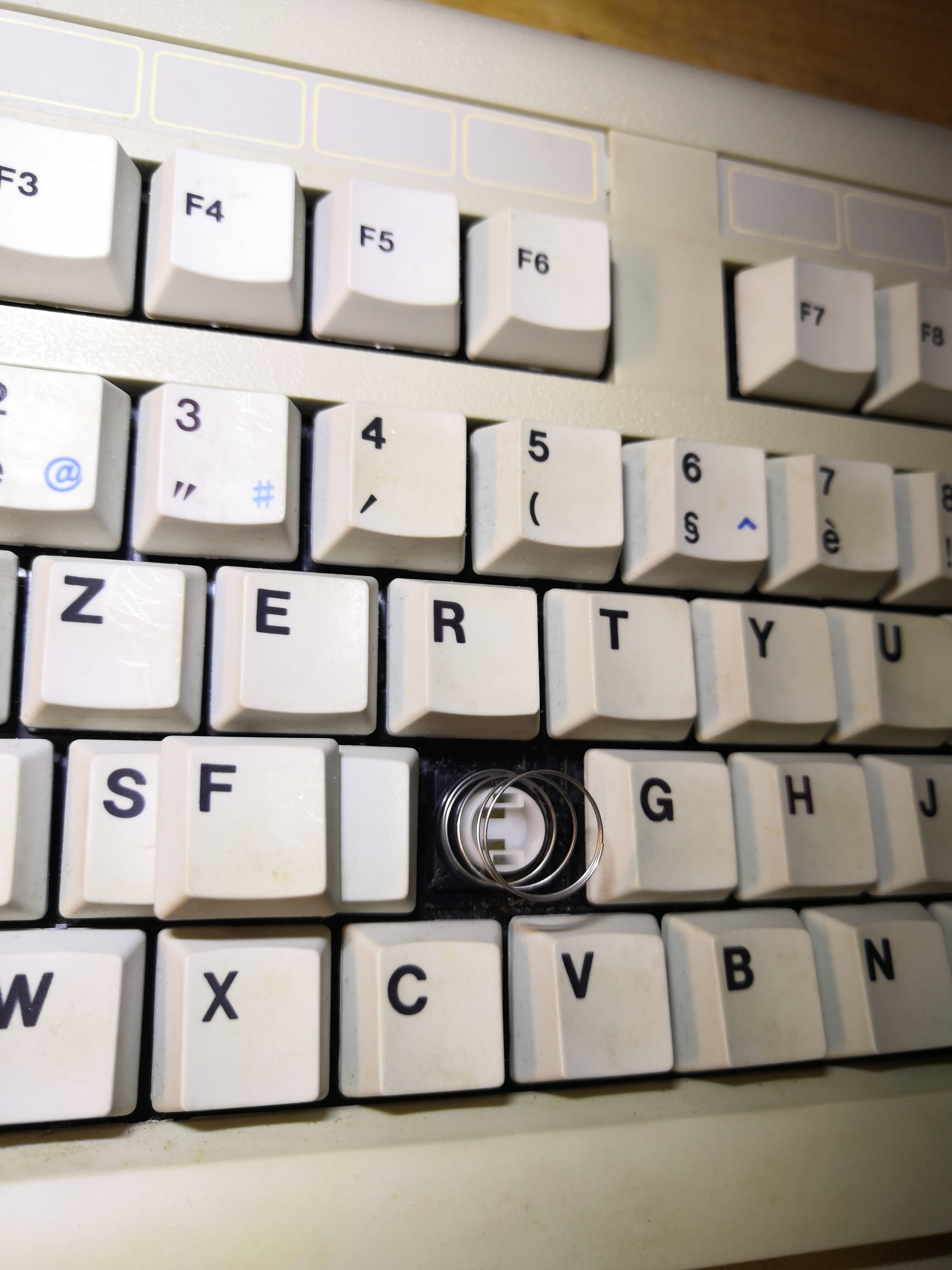

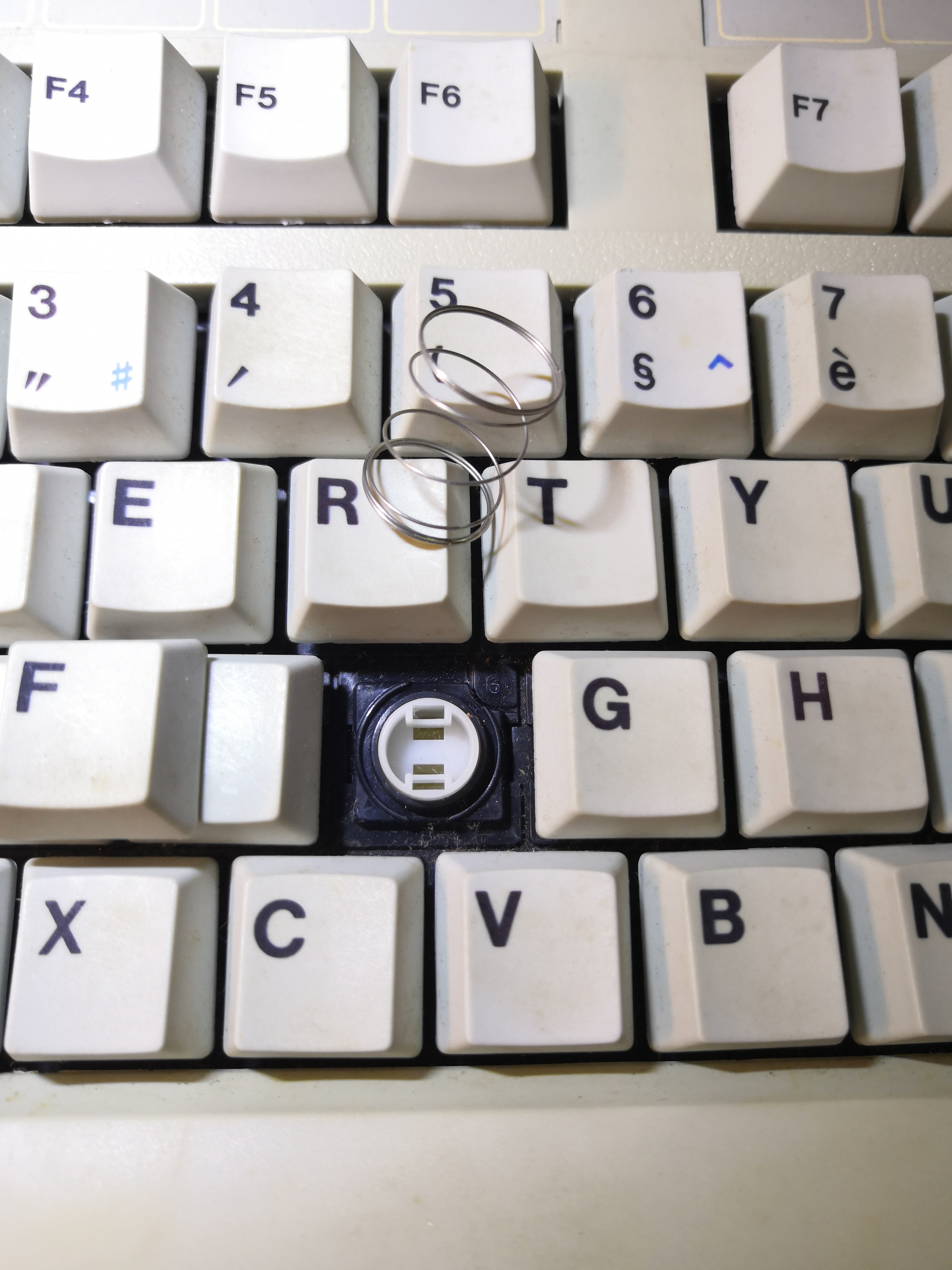

Guys, I'm having problems with this keyboard. Is this a G80 or a G81?

I bought it and the 3C branded keyboard came with white mitsumi miniature switches.
The memorex telex came with white clicky space invaders.

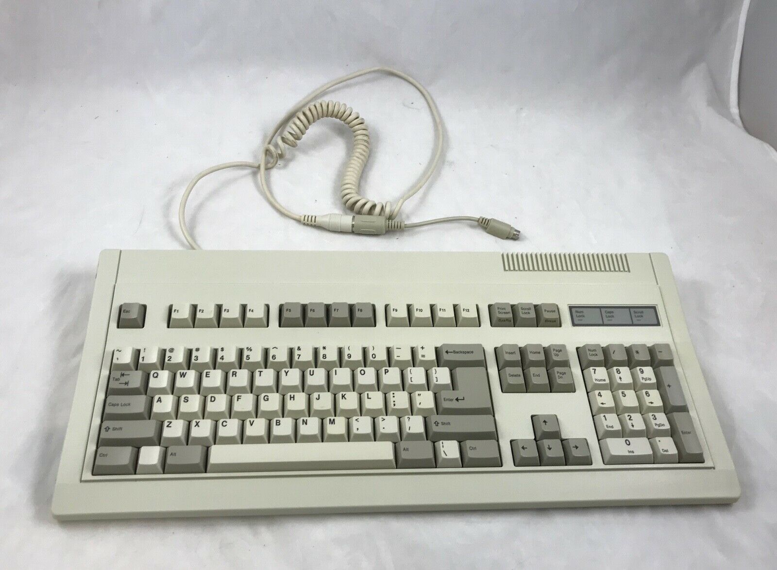

Hello guys does anyone know what this keyboard is and if it is worth buying?
- f4d3426b-cdcb-4d51-801c-3fd8c392999a.jpg (80.38 KiB) Viewed 9578 times

I have seen this case before. Looks like a wiki/Datacomp_DFK191 to me. You can have several switch options.

ghostdawg187 wrote: 17 Nov 2019, 22:23 I have seen this case before. Looks like a wiki/Datacomp_DFK191 to me. You can have several switch options.
I bought this board from ghostagw187. Member Polecat has several of this board in his collection.
To answer your question, is it worth buying this keyboard: If it has ALPS Pine White Alps switches, yes. I would skip it if it has anything else (Futuba, simplified Alps switches). Beware, the photo shows the keyboard has been used a lot (just look at the cursor keys).
- Polecat
Definitely Datacomp, and an early one from the fillers on the bottom row. The wide step on CapsLock suggests Futaba MA switches, but that's speculation. If so it's probably a model DFK-121. Futaba switches are interesting; not like anything else I've ever used. Datacomp has used that case design for decades, and may still be building a current version. The newer versions were "cheapened", with Alps clone switches and plastic plates.Felima wrote: 17 Nov 2019, 21:40 Hello guys does anyone know what this keyboard is and if it is worth buying?

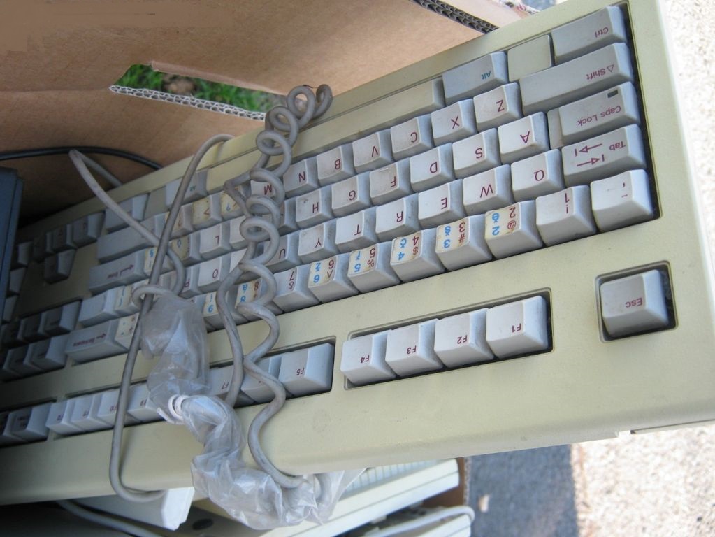

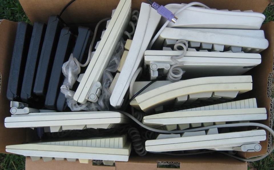

Hi,
I have a possibility to buy this box of keyboards. I have only four photos of it, the box is already sealed and ready for shipping.
Can you someone indetify keyboards - the whites one?
thanks a lot !!!
thanks a lot !!!
