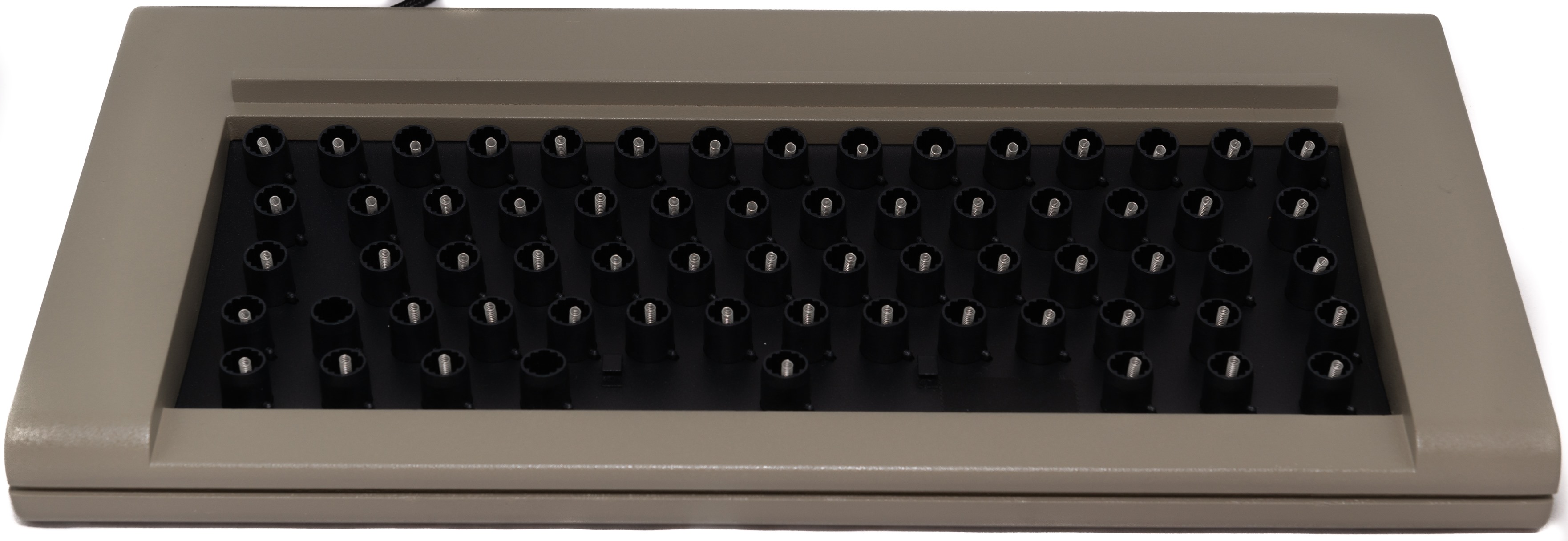

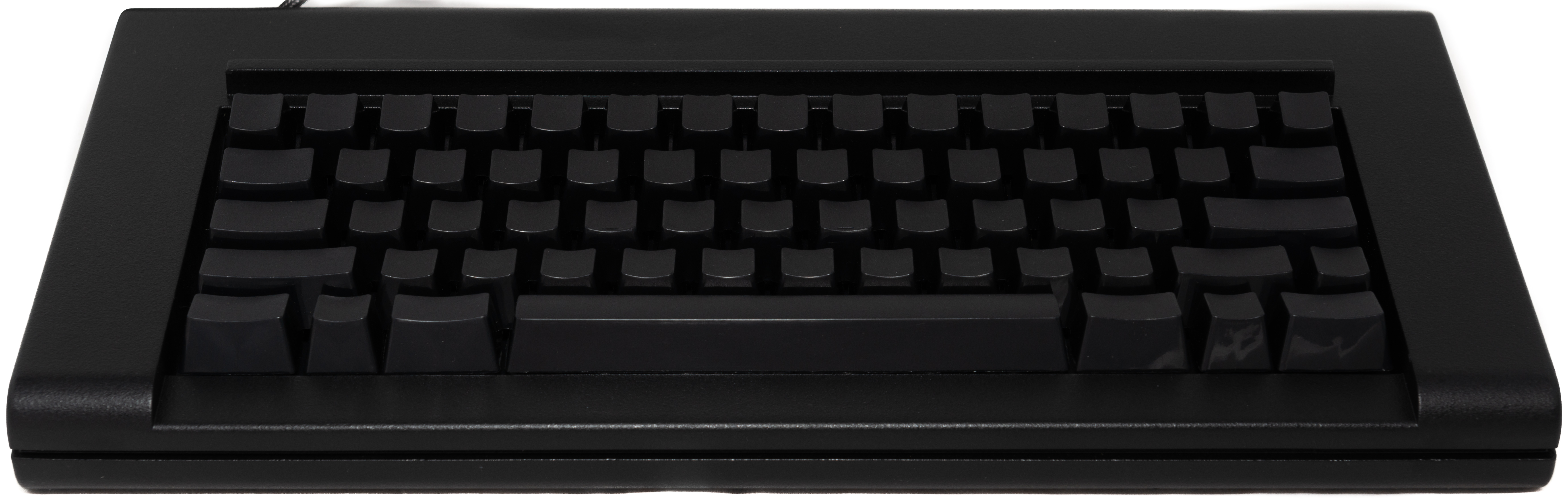

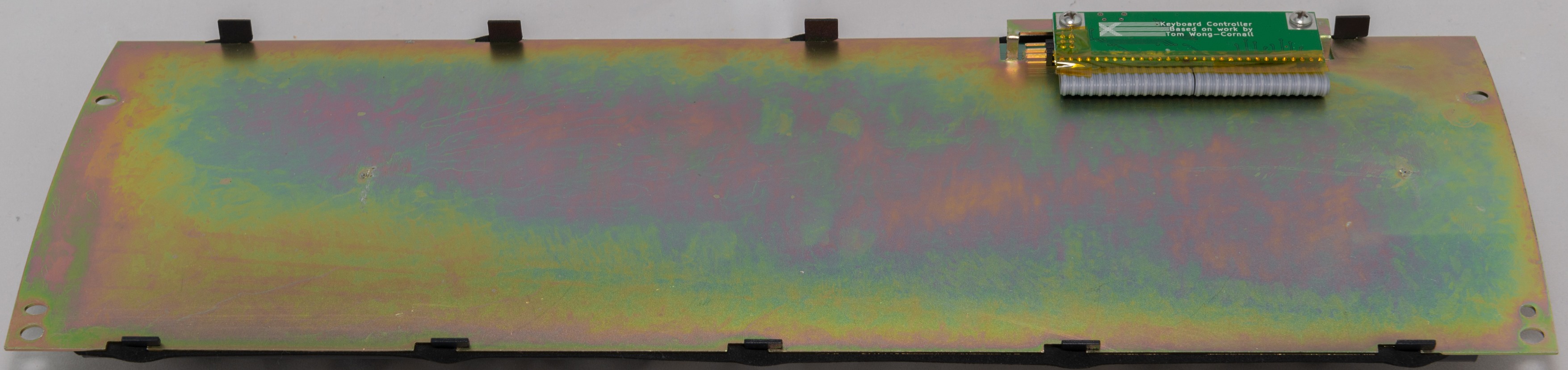

Really thinking about ordering a compact case and repair kit
Someone posted a quick sound test over on the Geekhack project thread but everyone please do let me know as video and text reviews come out as I may miss them otherwise.
Even though there is strong protective packaging, Model F springs are often dislodged during shipping which can result in a bad click sound or no click at all, and keys (and sometimes springs) may need to be reseated. I have found that carefully removing and flipping the spring upside down can fix most spring issues, and replacing the spring with another spring is a last resort.
If you like the characteristics of the original Model F, I think you'll like the new Model F!
8 more keyboards went out today, bringing the total to 25 so far.
Based on the current variations shipped, Black keys will no longer be able to ship early (most of them are in the second batch arriving in a couple months). There are many pearl/pebble sets for most variations in the first shipment (happy to switch you to the standard colors key set if needed).

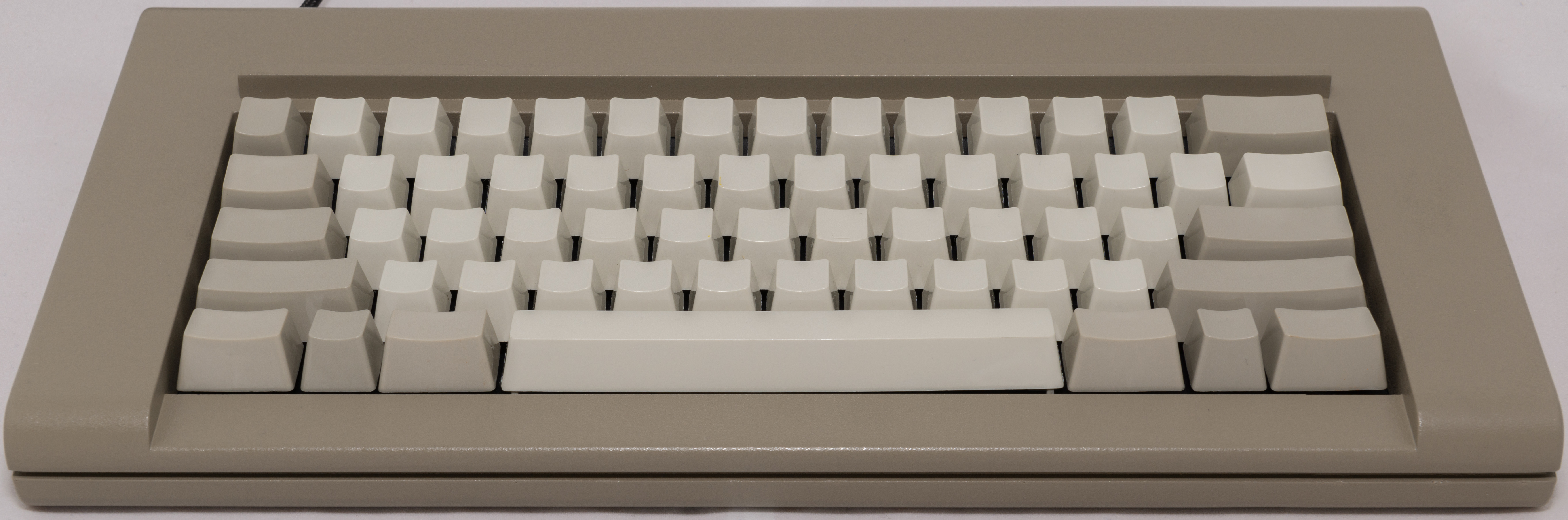

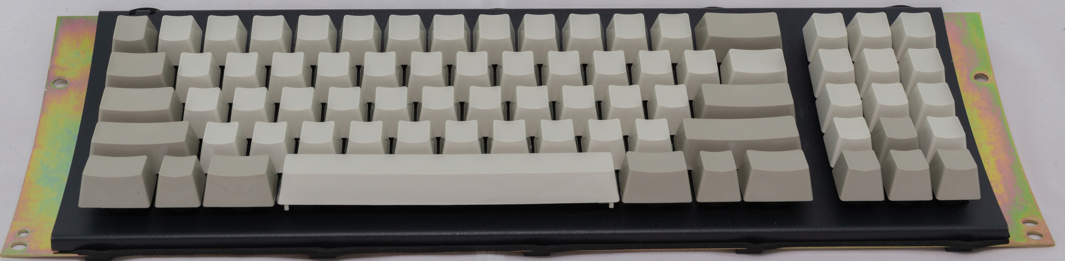

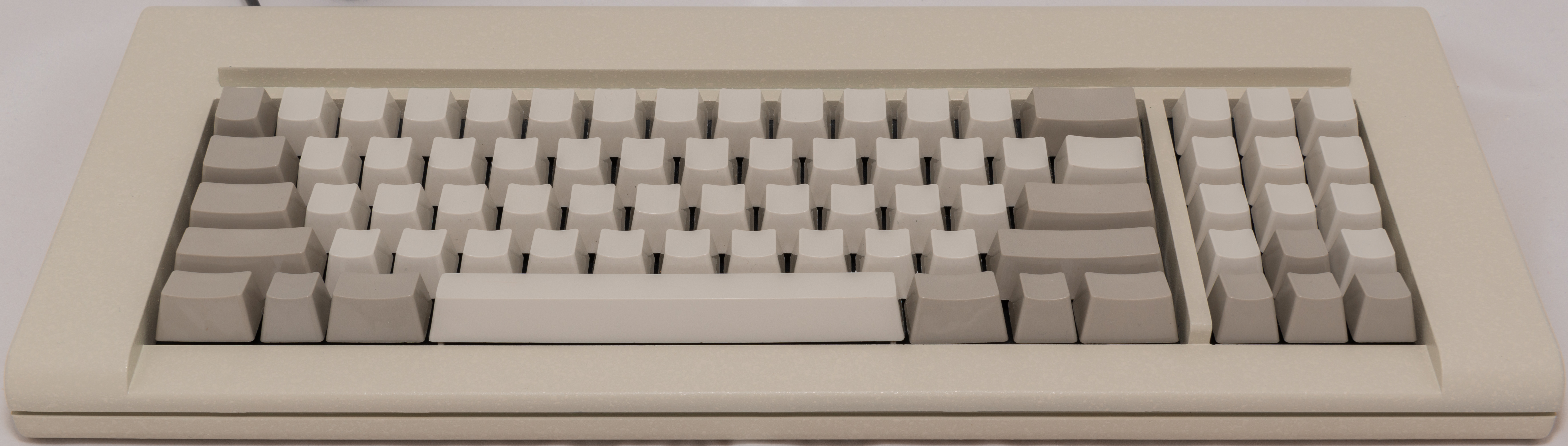

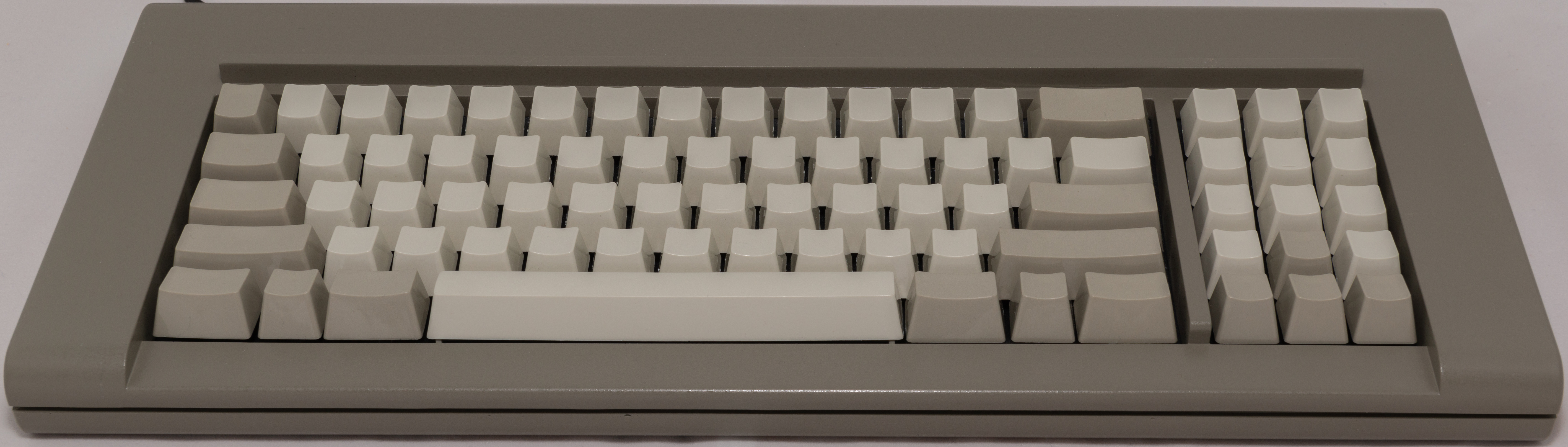

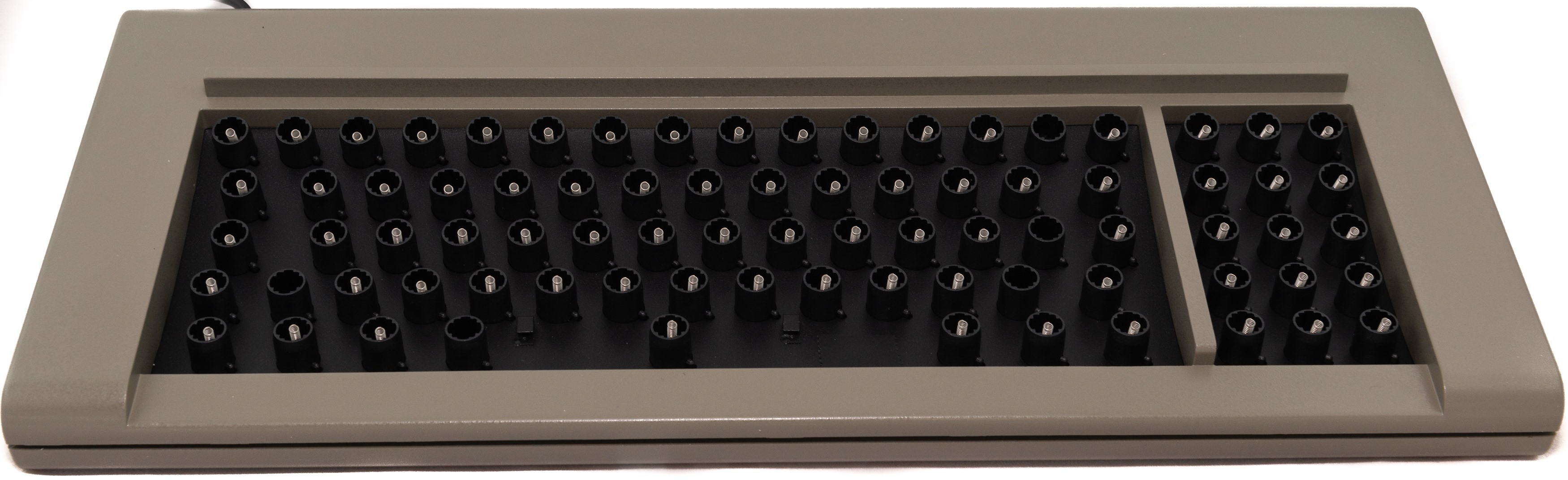

- 2019-12-31_19-08-39.jpg (2.79 MiB) Viewed 9319 times
- 2019-12-31_19-08-03.jpg (3.04 MiB) Viewed 9319 times
- 2019-12-31_19-07-05.jpg (3.28 MiB) Viewed 9319 times
- 2019-12-31_17-49-44.jpg (3.14 MiB) Viewed 9319 times
- 2019-12-31_17-48-56.jpg (2.65 MiB) Viewed 9319 times

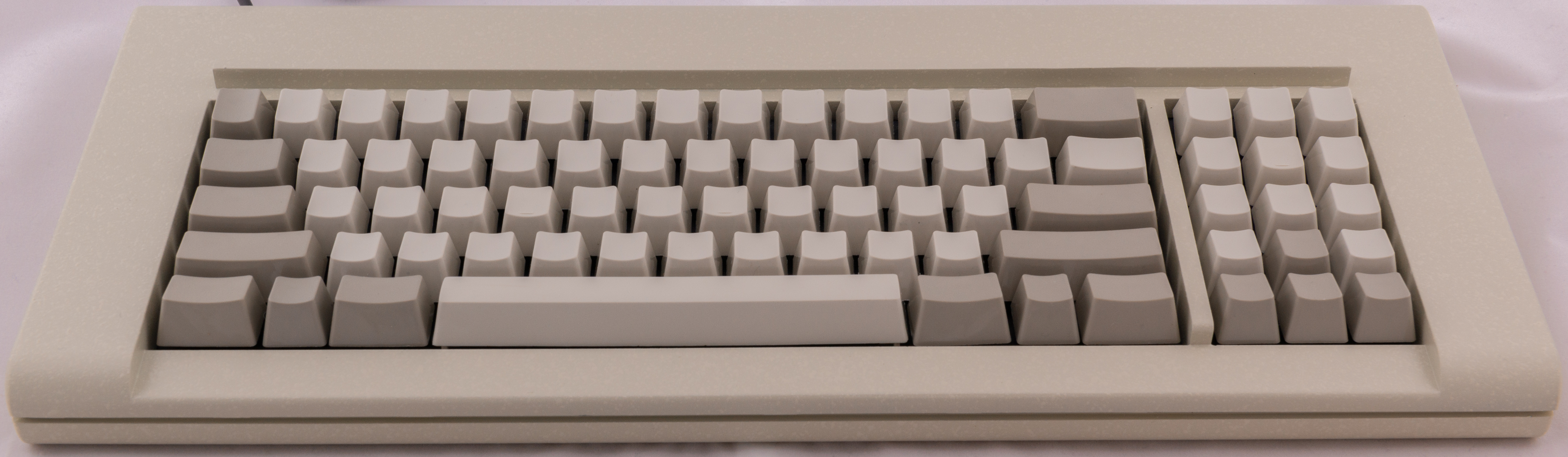

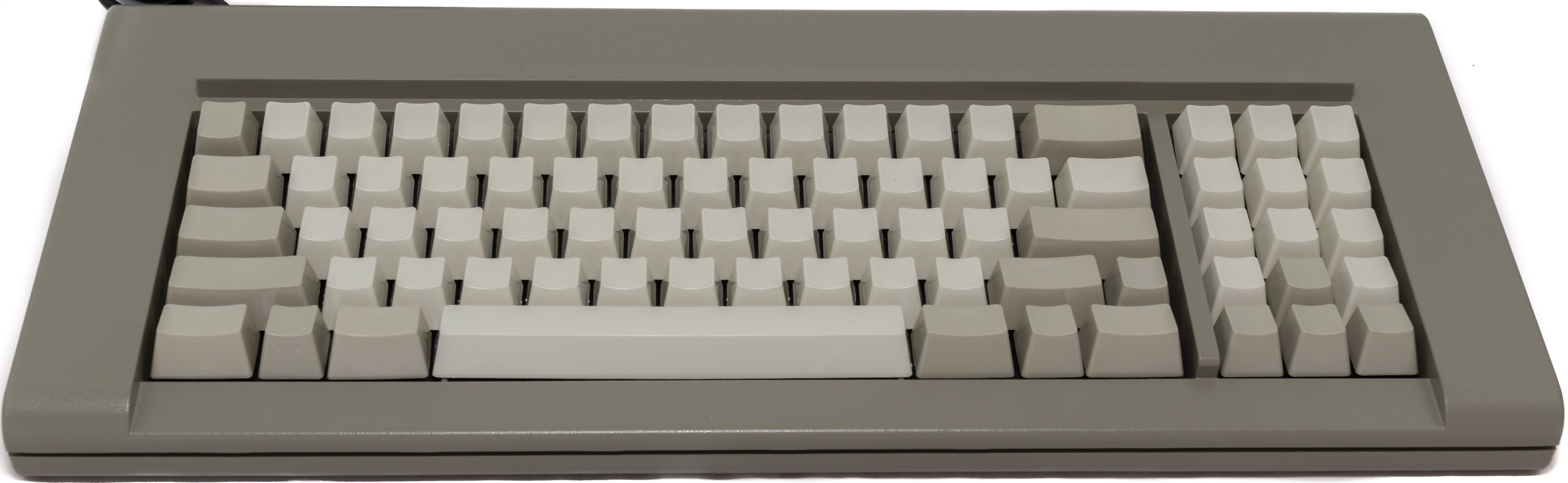

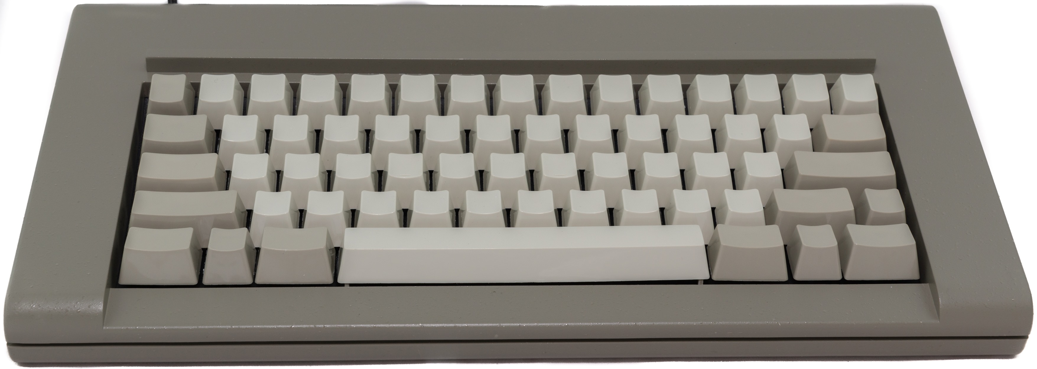

Another newly photographed variation that was mailed out:

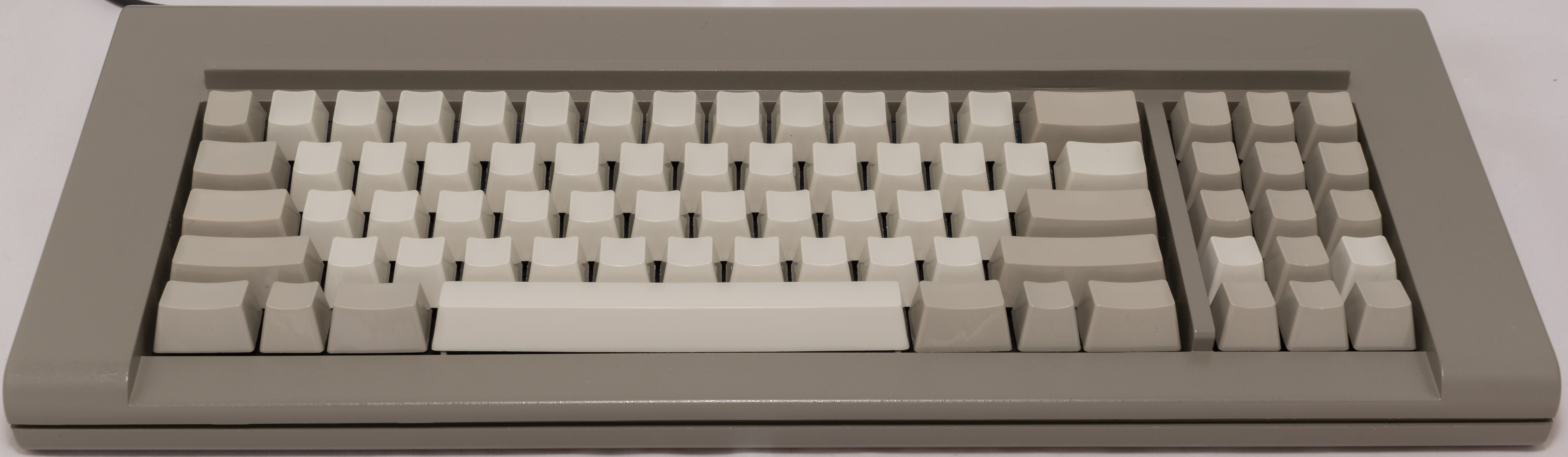

17 packages are shipping! All the key testing and replacement was done over the weekend and it still took about 5-6 hours of work today, not counting the key testing - about 15-20 minutes per keyboard.
Thanks Mimon - that would be great. The more the better - maybe on a few Saturdays once I have a backlog of sublimated key sets a bunch of orders can go out if a few people can help.

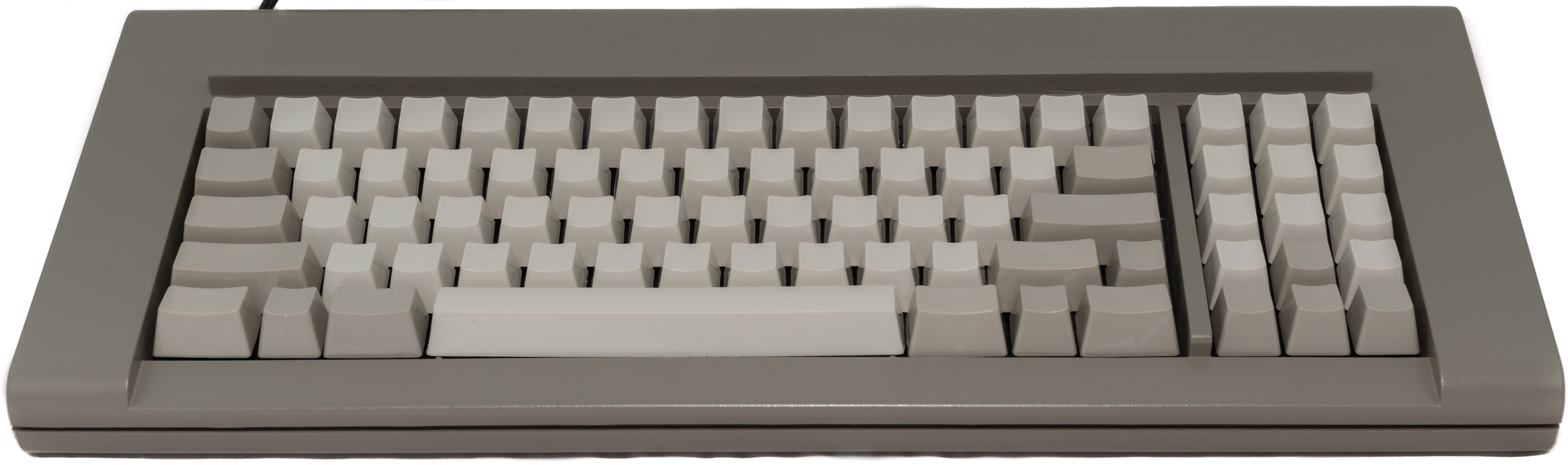

From today's group:
From today's group:

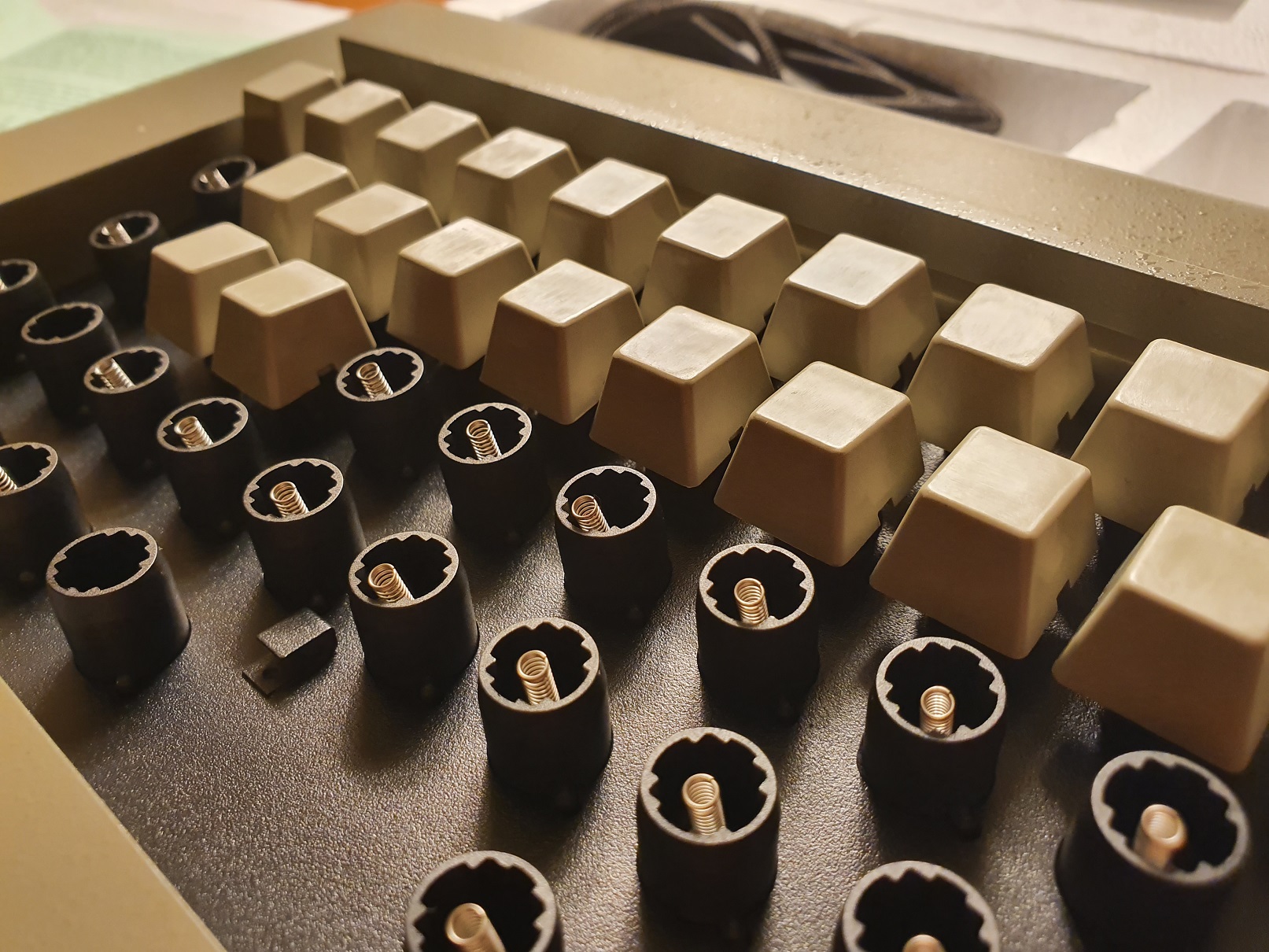

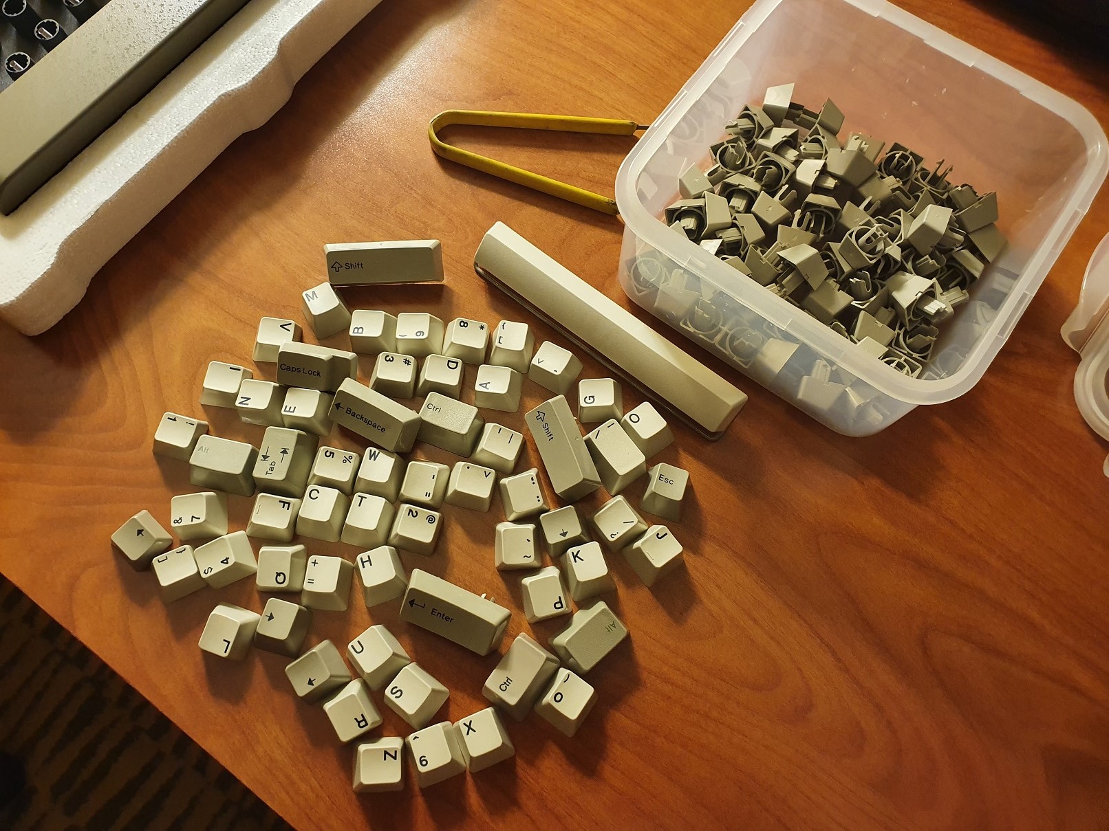

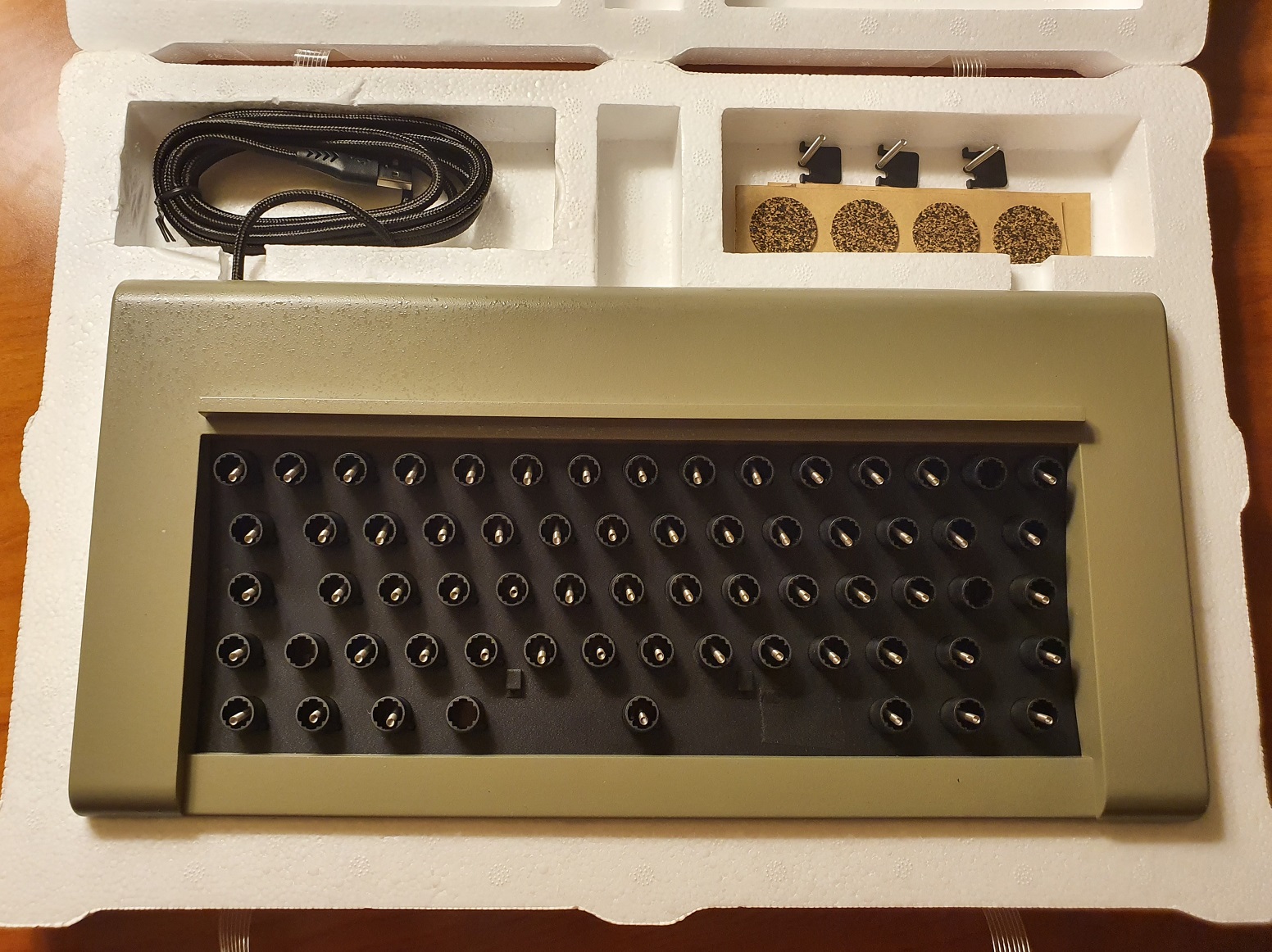

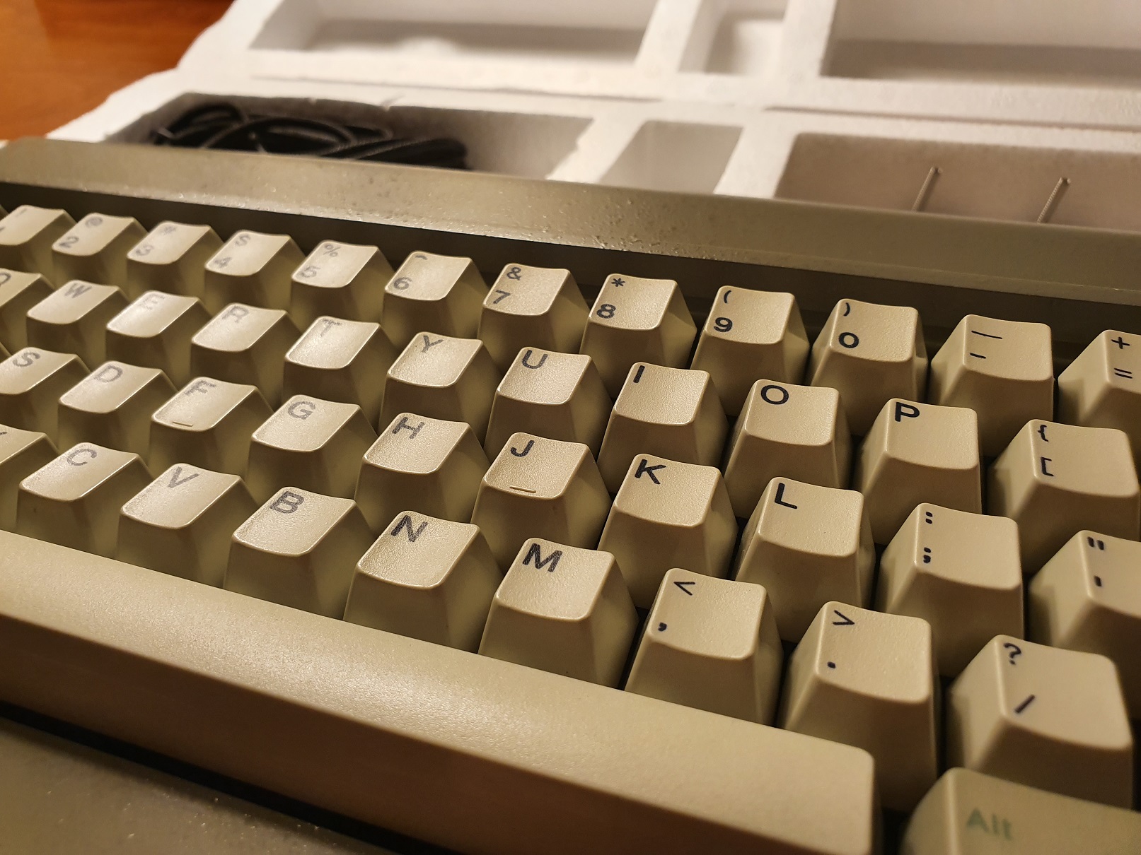

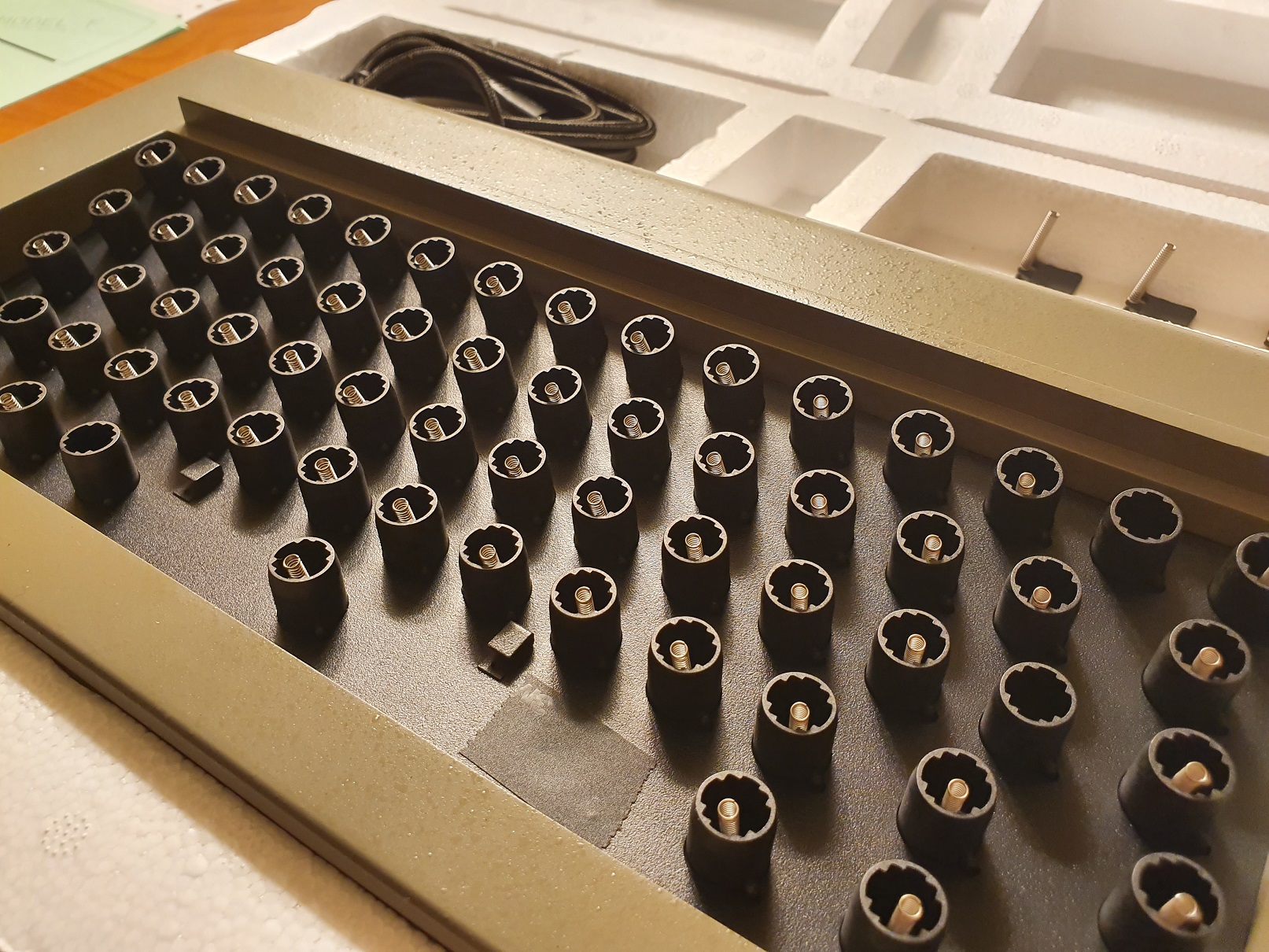

Just wanted to express how excited I was to receive the unit. By stroke of luck I happen to find myself in the States for business, and Eclipse was kind to arrange for my unit to be shipped while I'm staying here. Of course I had the low serial add on, and I had to opt for it to be shipped without keys. It made sense as it cost me more to have it shipped all the way to Asia, and risk it being potentially taxed upon entering.
I brought my own Model M keys to use temporarily while awaiting for the dye-sub keys to be completed.
Some pictures:
I didn't have the time to set it up yet, as I do not have a laptop capable of connecting to it (locked company laptop
). The keypresses are great, and as Eclipse remarked, some flipper may be unseated, so if the keycaps don't feel right or are making excessive pings, then remove the keycap, shake or wriggle the springs to reseat the flippers and it'll be fine.
Also, if you are opt-ing to use your own keycaps, do ask for the stabiliser inserts to be included. I forgotten about that, so I'll need to use my Model M's first.
Typing wise, I do not have a Model F to compare with, so I can only compare with my Model M. Overall keypress is lighter, more crisp, very nice to type on. This will replace my Model M as my daily driver moving forward. Packaging's attention to detail is appreciated, more than enough to protect the contents for rough shipping, as well as having nostalgia inducing features
All in all, I congratulate Eclipse for a job well done, as a former mechanical design engineer that has both participated in design, sourcing, supplier development & management in a large TEAM setting, for Eclipse to pull this off as accurately and as well as the final product indicates, (with help of course from various people) but mostly by himself, is a very large undertaking which I think he did it very well.
