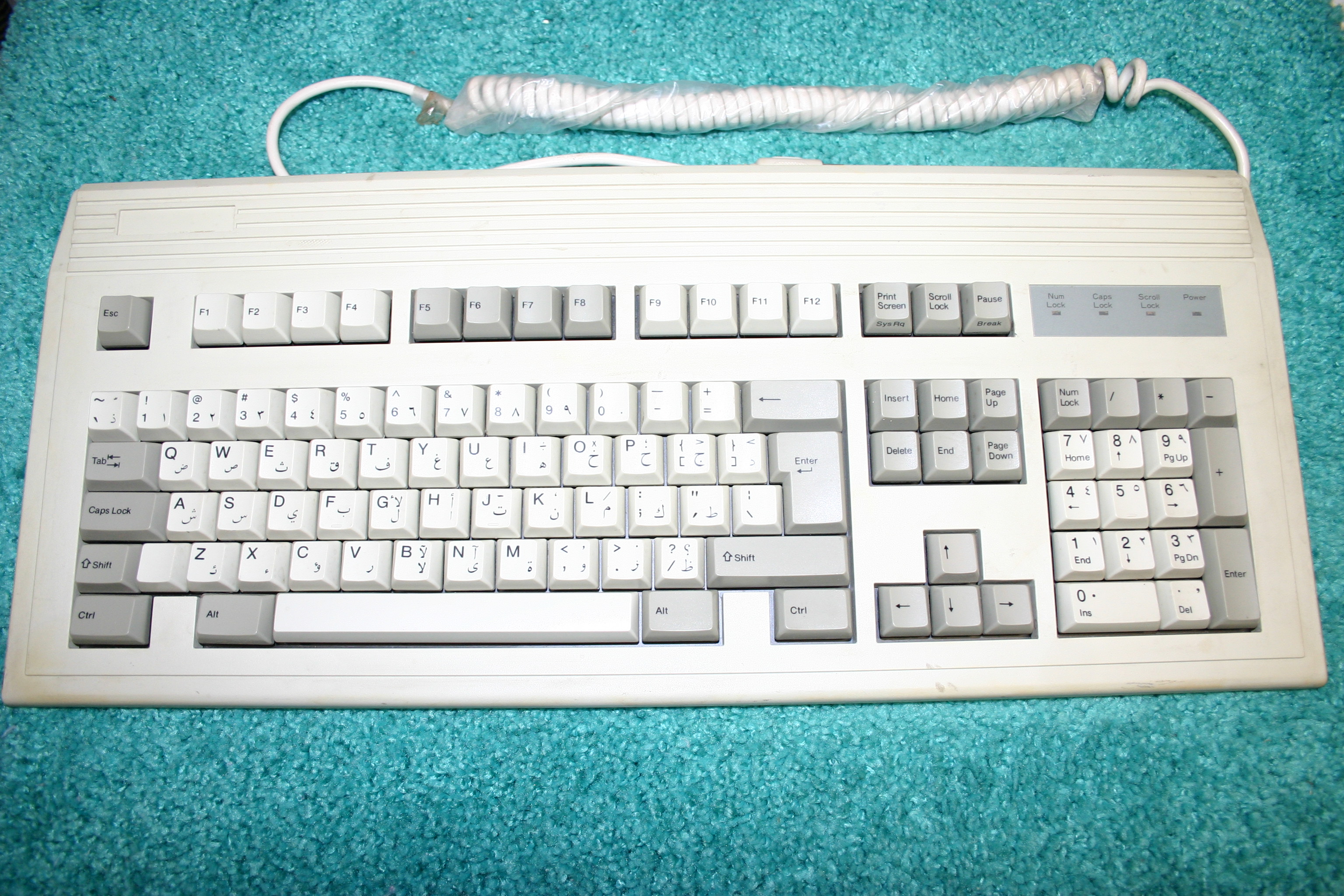

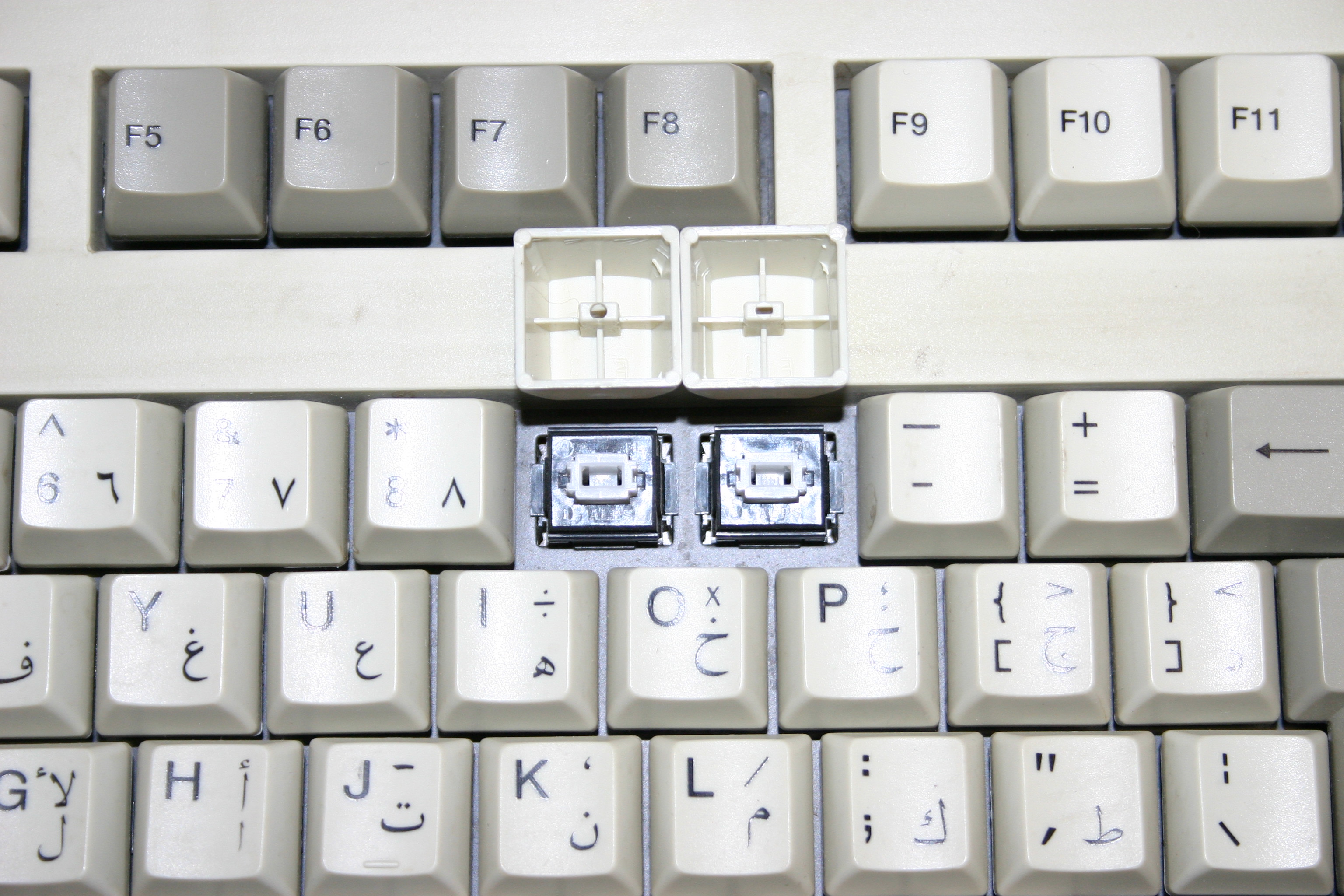

Egypt has very high temperatures with a humid environment. That could easily explain the issue with the switches, as the plastic of the stems deteriorated under those conditions, even if stored in a box and never being used.Polecat wrote: 12 Dec 2020, 22:30 My subjective chart is binary, as a keyboard is a binary device.
1. Ready to use, with no issues.
0. Nope or noper. Don't bother with cleaning, lubing, or other fiddling about. Yank out, toss in the trash, replace with #1.
Note that this is specific to Alps switches, since that's what I've been typing on for the past thirty years. I've had incredibly good luck buying used Alps keyboards, with one notable exception - a Costar CSK-2102 with (early) white Alps I got recently, from the ebay seller in Egypt. It's immaculately clean inside (as in never been used), with zero shine on the caps, but squeaks and binds so badly that it's completely unusable. No matter, it's nothing some switches from a parts donor won't cure, the value to me is the case and keycaps.I would like to know why these switches are so terrible though.
In any case, if you are going to throw it away, just send it over to me, I dont mind restoring it!
- Polecat
Funny, I buy an Alps keyboard and throw the switches away. Like Domino's Pizza, where you throw away the pizza and eat the box. But I just couldn't pass this one up.NeK wrote: 13 Dec 2020, 00:24
In any case, if you are going to throw it away, just send it over to me, I dont mind restoring it!![]()
I'll bet you're right. I knew Egypt was hot, but I didn't realize it was humid there. When I remove the switches I'll pop open a couple to see if there's any obvios damage before I toss them in the trash...uh...or send them to you.

[obvious_joke] So, were you in denial? [/obvious_joke]
- Polecat
Well this keyboard, or at least its switches, was in denial. Myself I haven't been quite that far east; something about Albuquerque?

Wow those symbols on some caps are cool, please throw away (= send them to me) the J and the R with the happy face!!!Polecat wrote: 13 Dec 2020, 01:02 I'll bet you're right. I knew Egypt was hot, but I didn't realize it was humid there. When I remove the switches I'll pop open a couple to see if there's any obvios damage before I toss them in the trash...uh...or send them to you.![]()
