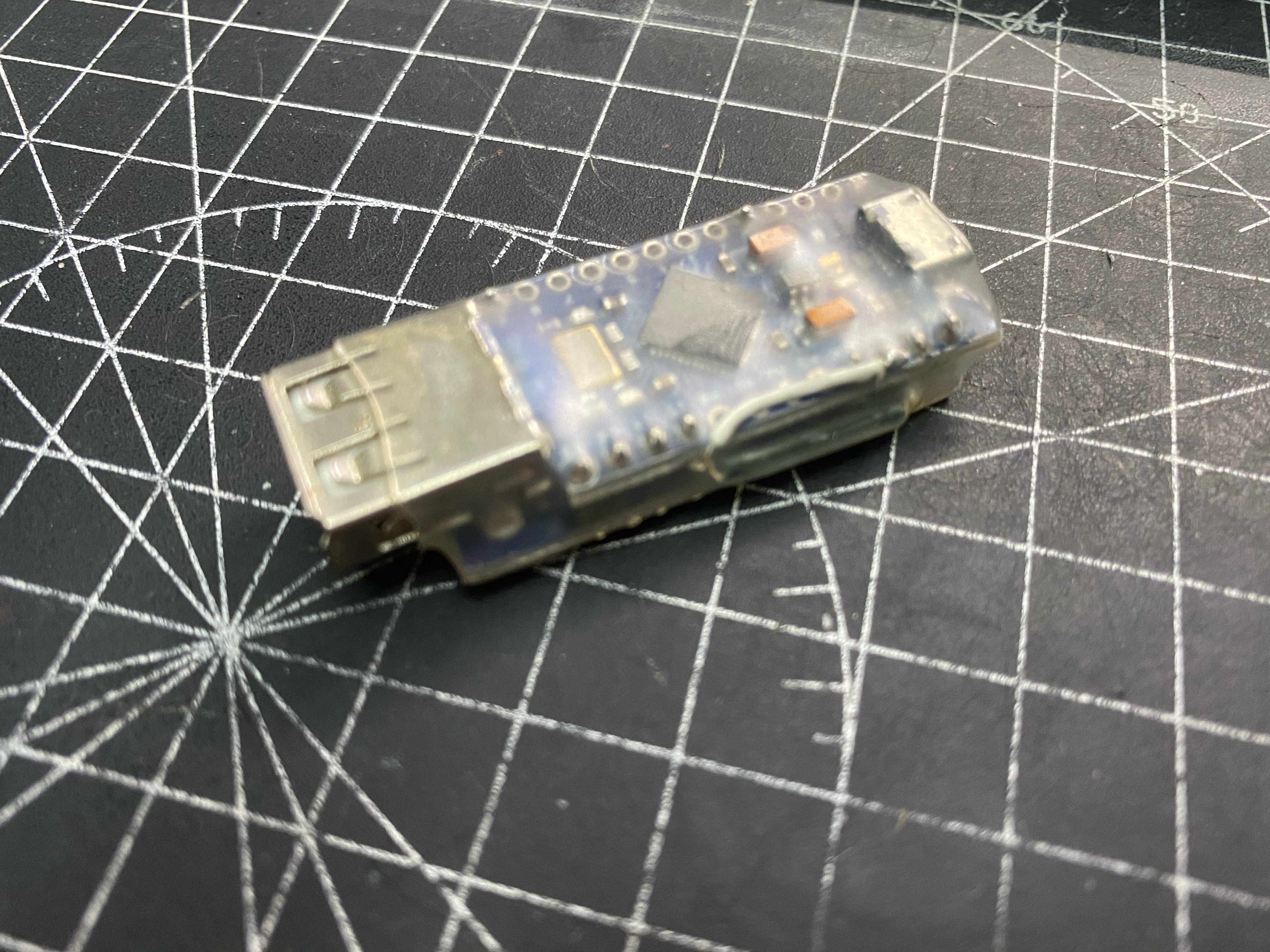

I use a pro micro and a usb mini host shield for one and heak shank the combo. I also use a reed switch as reset.
- image0 (1).jpeg (2.75 MiB) Viewed 13233 times

Cool! Have you encountered any issues from being on 3.3v?anthonymak wrote: 04 Apr 2021, 18:36 I use a pro micro and a usb mini host shield for one and heak shank the combo. I also use a reed switch as reset.

the pro micro is 5V. I need to replace the regulator to make VCC output 3.3V while the mcu still running at 16Mhz.raoulduke-esq wrote: 05 Apr 2021, 19:19Cool! Have you encountered any issues from being on 3.3v?anthonymak wrote: 04 Apr 2021, 18:36 I use a pro micro and a usb mini host shield for one and heak shank the combo. I also use a reed switch as reset.

how did you make this, i want to make oneanthonymak wrote: 04 Apr 2021, 18:36 I use a pro micro and a usb mini host shield for one and heak shank the combo. I also use a reed switch as reset.
