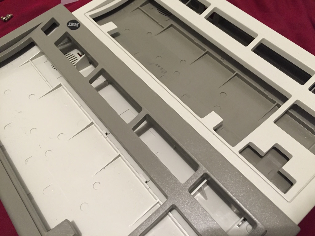

Well it's moreso because the SSK assemblies in mine brokeMuirium wrote: 20 May 2023, 11:35 Ask Ellipse, the man behind them. He’s active here on DT, too.
I know where you’re coming from re: shell compatibility. His aesthetic is… clunky to the point of brutal. Don’t know if he’s done us a favour and kept his design within IBM’s shell tolerances. Certainly wouldn’t count on it until proved.
So it would be nice to use them again
- micrex22
- Location: Canada
- Main keyboard: UltraNav
- Favorite switch: BS
Well, the first one started to crack because SSK plastic assemblies are VIRTUALLY CRACKING out of box from the stress they're in. And then the other one fell off from a high shelf where I was storing it and it split in half completely.
I'll just have fun with my two empty shells
- shells.jpg (167.56 KiB) Viewed 12512 times
- ssk_crack.jpg (259.46 KiB) Viewed 12512 times

Well, look on the bright side: the cool grey industrial one should be very easy to sell.
When I’m next in California, I’ll have my SSK with me to install Taylor Swift’s FSSK upgrade which is waiting with family over there. Think that will leave me with a spare SSK barrel plate on my hands if that’s all you need. I’m keeping the metal backplate and caps, though.
