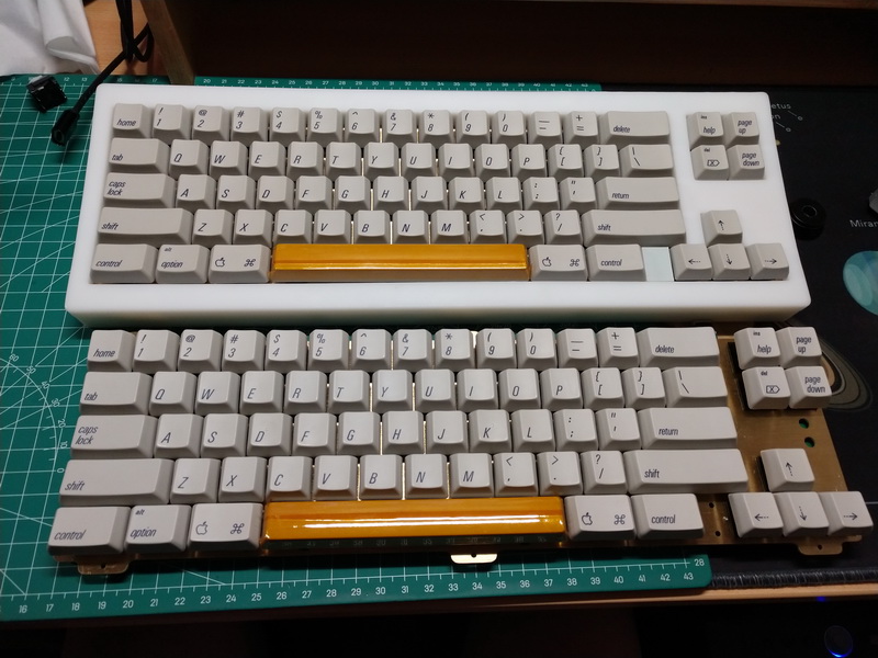

Recently, I have made some beefy stepped keys to replace two 1U keys. This idea came to me when I was asked if I can make the layout more ‘normal’. I did not want to tamper with the mount plate nor the PCB, so making a twin-stem 2U key that occupies the place of two adjacent 1U keys seemed to be the solution. The keys are stepped, of course, because there is no stabilizer wire and an ordinary 2U key would bind when pressed on the edges. The following video shows, among other things, how I make a base for a new keycap. For simplicity, I have used polyurethane instead of aluminium. One step in the video is missing—the bead blasting of the base (the video footage did not turn well).
- lispnick
- Location: Czechia
- Main keyboard: Keymacs A620N-88 Rev. A
- Main mouse: Kensington SlimBlade Trackball
- Favorite switch: Alps SKCM Orange
Spot the difference:
Detail of the classic bottom-right corner:
Stepped cursor keys:
… and how they are made:
