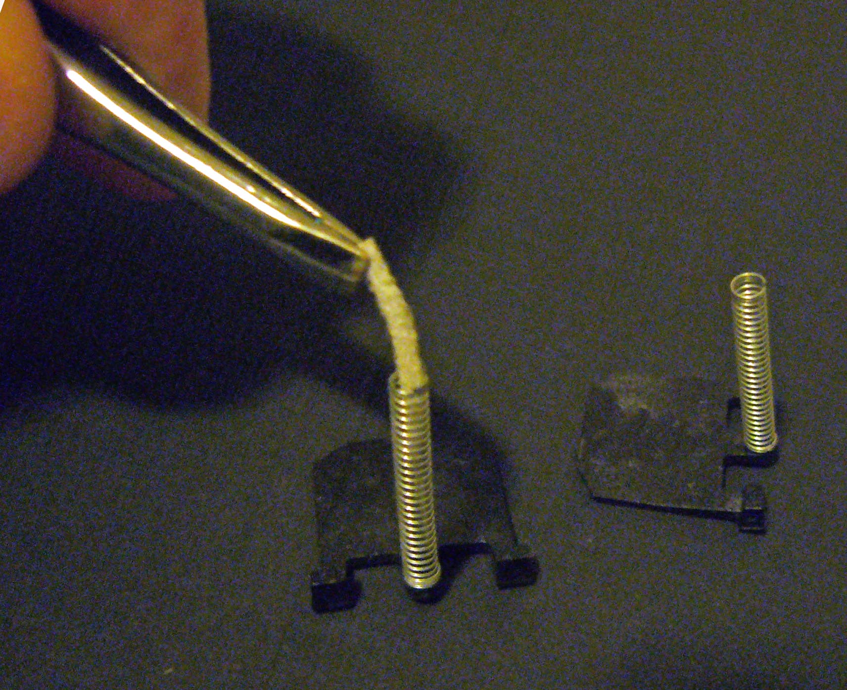

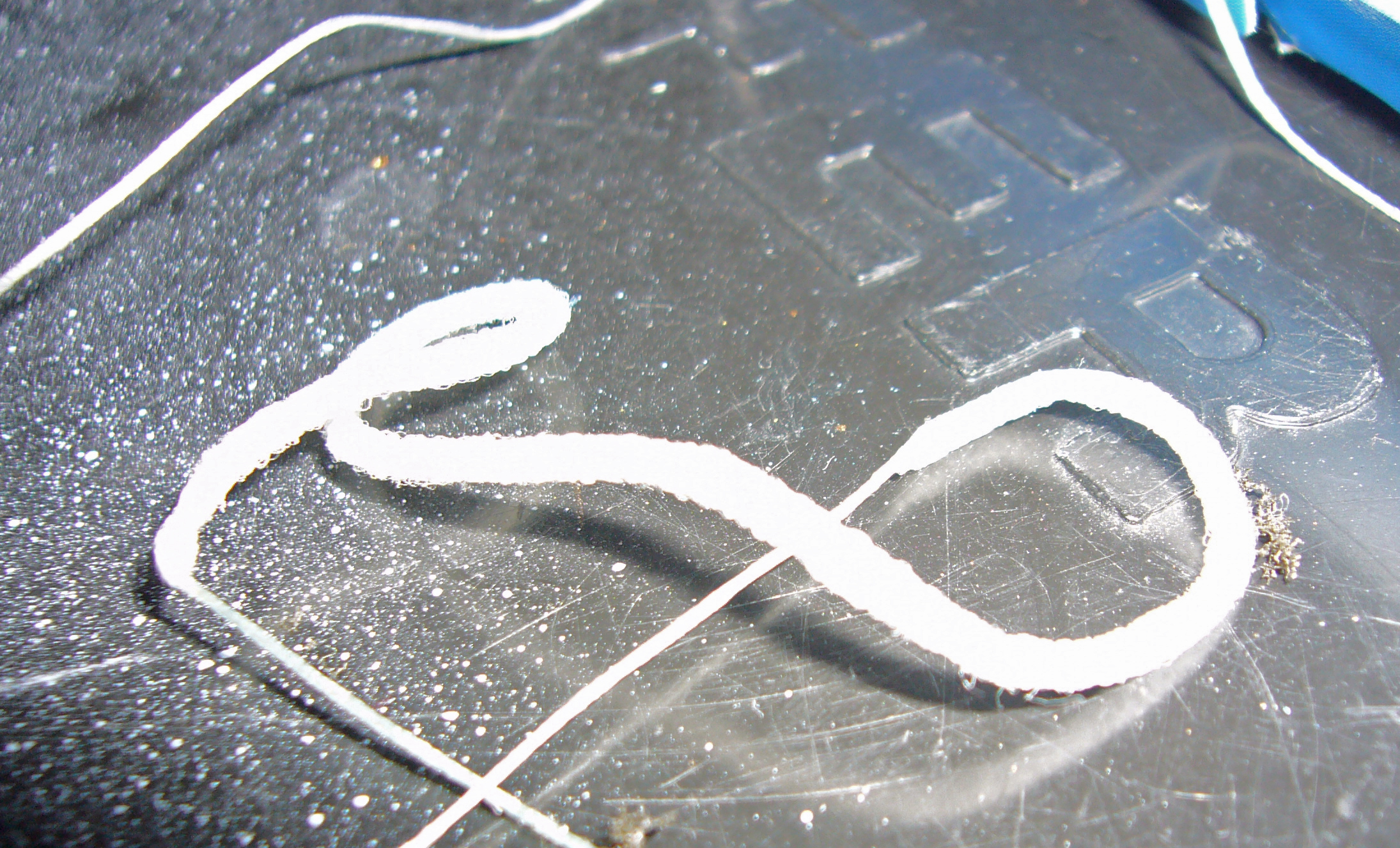

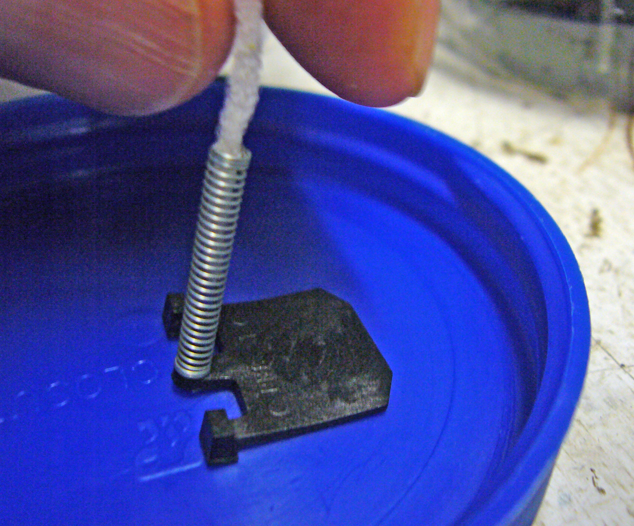

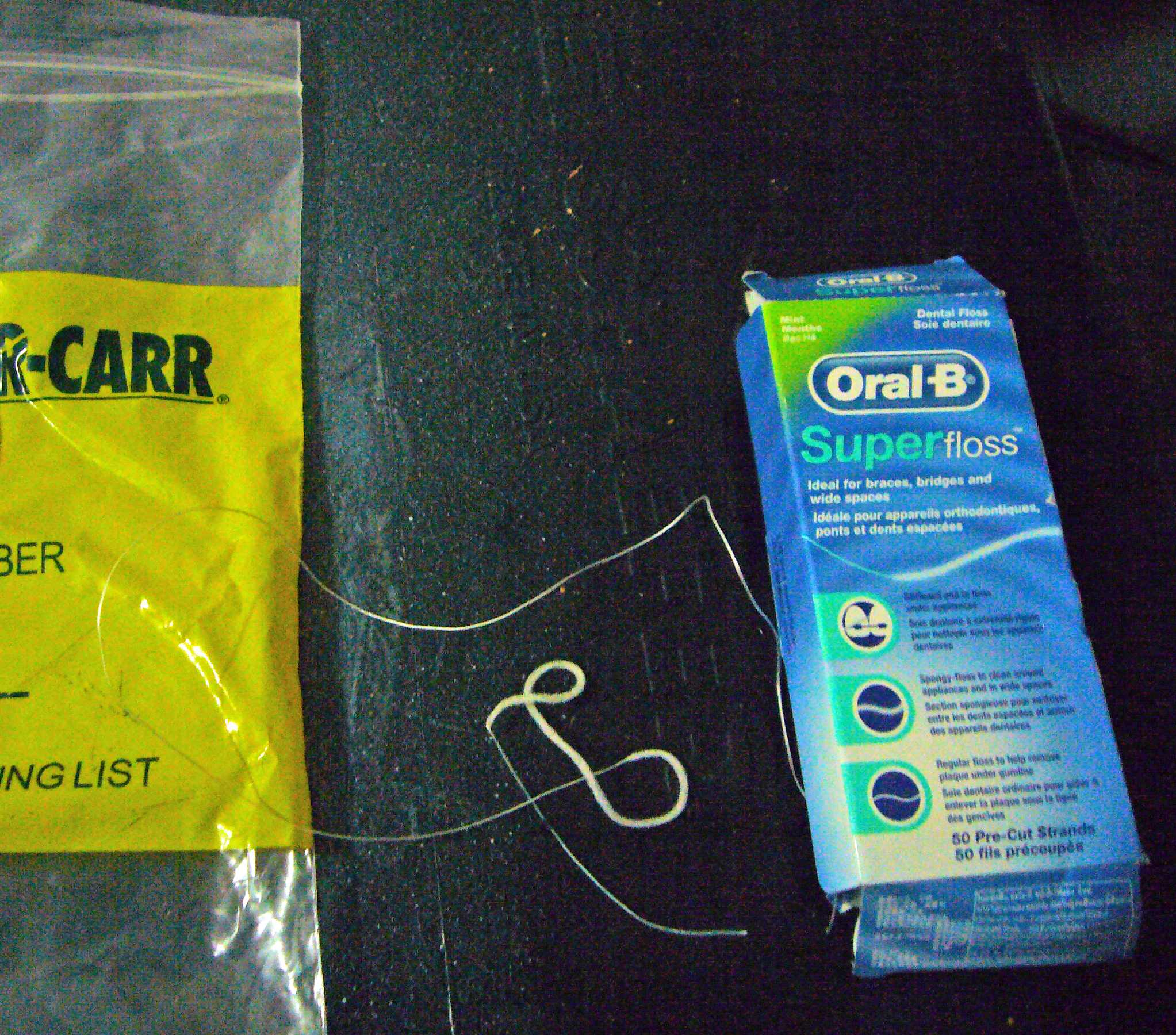

The floss mod can be a big help by reducing ringing (aka singing) overtones that may be the primary source of your neighbors' irritation.

I've done this floss mod and didn't think it made a significant difference as far as 'office collateral damage' type things go.

FWIW, I floss modded my daily driver Model M a while ago and then had to laboriously un-floss mod it as it was driving me nuts with inconsistent sound and feel between keys. Maybe I didn't do it right but I'm not sure how precise you can be with bits of fuzzy polyester string anyway.
