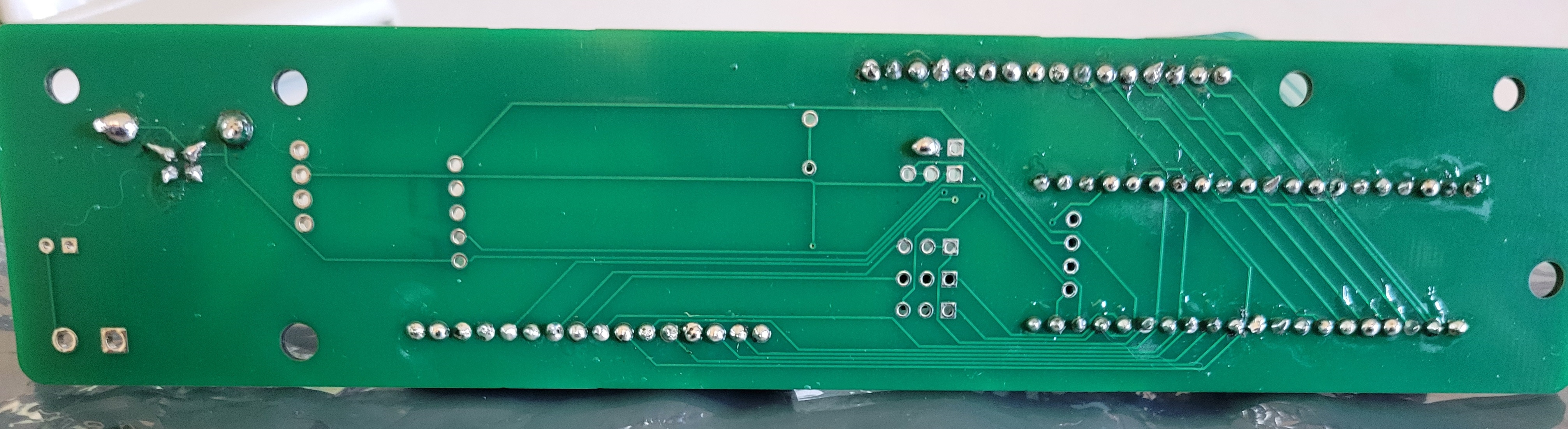

The biggest problem for my old eyes and shakey hands was not blobbing two pins together with an overabundance of solder.

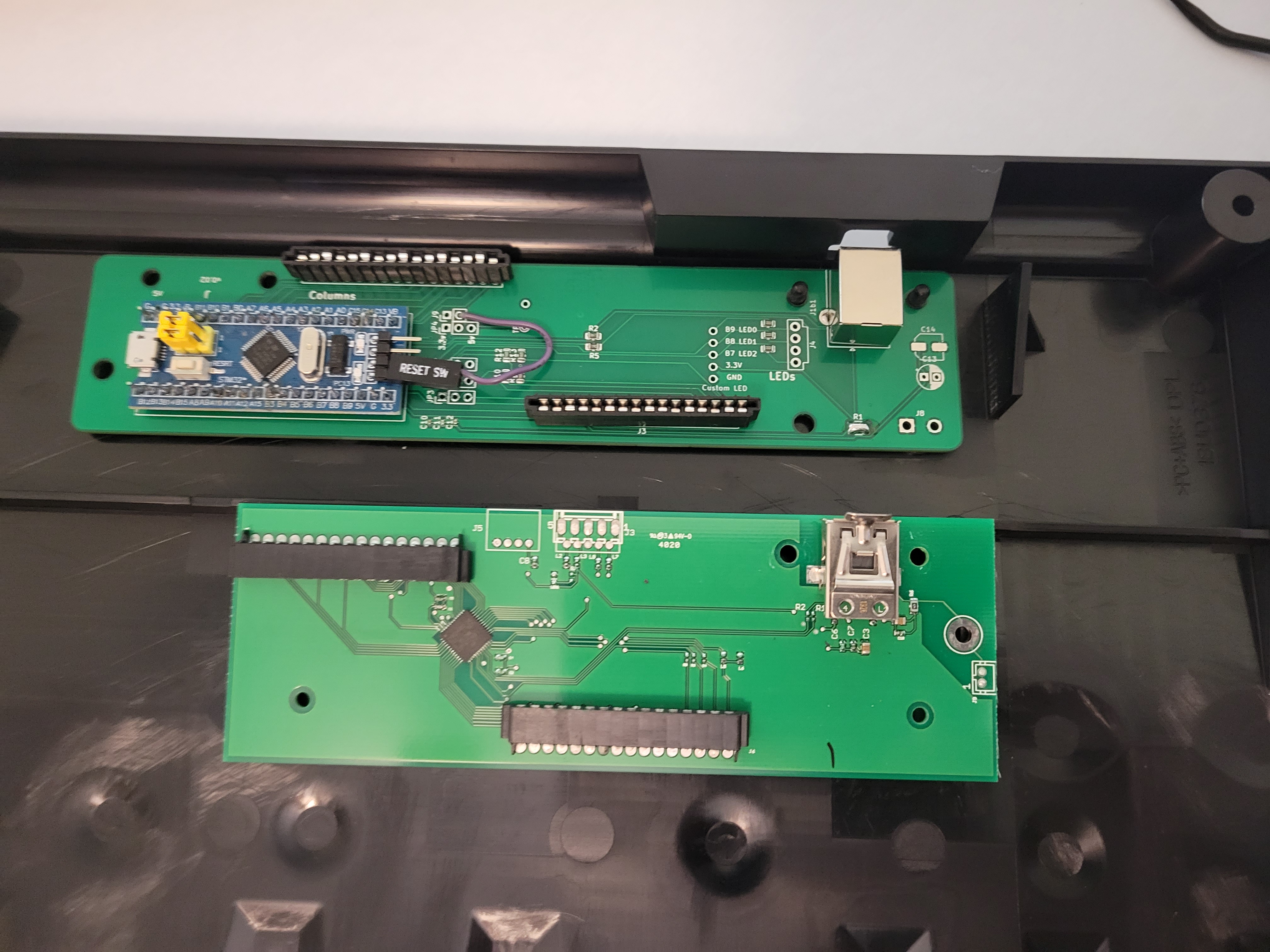

I got the thing assembled and plugged into into a machine to make sure it came up. The led lit up and the PC announced it had found a Model J keyboard. Then I opened up the keyboard and extracted the old controller. The instructions mention later models have posidrive screws securing the case, but mine has the old school Model M hex screws that require a thin socket driver. The easiest way to remove the friction washers that hold the stock controller in place is by cutting them. My plan is to secure the new controller with a dab of hot glue on each post.
Here is the old, cursed controller, with the new controller.
When I got everything connected for the test, I found the new controller was also cursed, most likely due to my shoddy work.
I fired up switch hitter, and all was looking good until I tried the F9-F12 block. They keys didn't register, then the board started spewing random phantom keypresses. This didn't stop until I unplugged the board and plugged it back in. Another test shows every other key seems to be working, but hitting the last block of function keys causes it to freak out.
I'm trying to figure out what could cause this behavior. My untrained eye doesn't see anything glaringly obvious.

The connectors are labeled Columns and Rows on the pcb, so I did a connectivity test between the connector pins and the pins on the bluepill. Everything checks out ok. There's no pin labeled A13, but I got connectivity to the pin wired to the board off the end connector. The directions suggested using a paper clip. I used a connector from an old motherboard reset switch.
So, still nothing obvious. I'm hesitant to button it up again without finding a smoking (solder) gun. The friction connectors are good for a limited amount of insertions.
