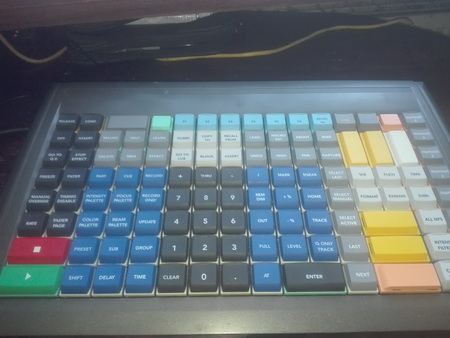

Hy,
at first,I don`t have any knowlege about keyboards.
I`ve following keyboard:
Tipro TMC-KMCV-C13-025
and I`ve following keycaps:
https://www.cmd-key.com/online-store/cm ... p525223831
That works fine for me.
The keyboard has 10 "double size" keys.but my keycaps have only 3,so there are 14 single keys missing.
Can you help me finding the keys wich I need?

If it is black keycaps (with transparent lids) which you are looking for, I can help.
But first you should make sure that under each of the 2u (="double size") keycaps, both switches have a spring, i.e. the cross-shaped part moves up by itself when you press it down. Simply remove the 2u keycap by gently lifting it and check both switches.
The reason is that in some keyboards manufactured by Tipro for a specific purpose and/or customer, one of the switches under 2u keycaps does not have a spring so that the force required to actuate the double key equals that of a single key. In that case, the springless switch serves as a stabiliser and cannot be used unless you put a spring into it - which unfortunately requires desoldering the switch.

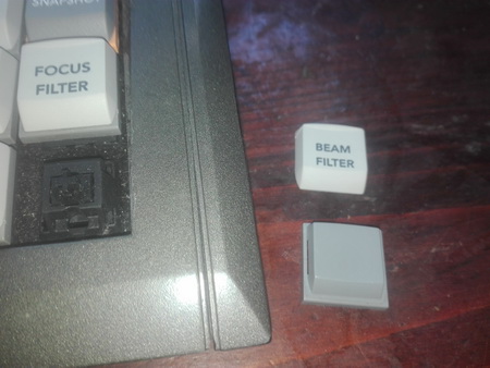

Hy,
probably I don`t understand the whole thing.
The "open place" on the picture in my last posting is the switch,right?
The grey button on this pic is the keycap?
And the white button is the lid?

Exactly.bibone wrote: 07 Feb 2023, 16:46 Hy,
There are so-called "relegendable" keycaps, consisting of 2 parts, the base and the lid. Here a few examples:
In your keyboard, the lids are not transparent, but are opaque and have been pre-printed by Tipro for their customer. In usual relegendables, you can insert a piece of paper between the base and the lid. As the lids are interchangeable, you could replace yours with transparent ones.
But the ones you have are difficult to get (at the left in my pic). I just have one or two dozens of them.
