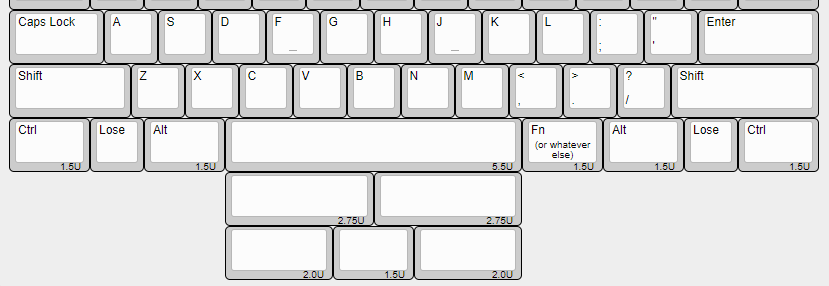

I tested my (potentially) ultimate layout on paper and then later on a self made 3D printed reproduction.
I have attached the very early sheet of my tests below. It is the original size and I played around with it quite a bit.

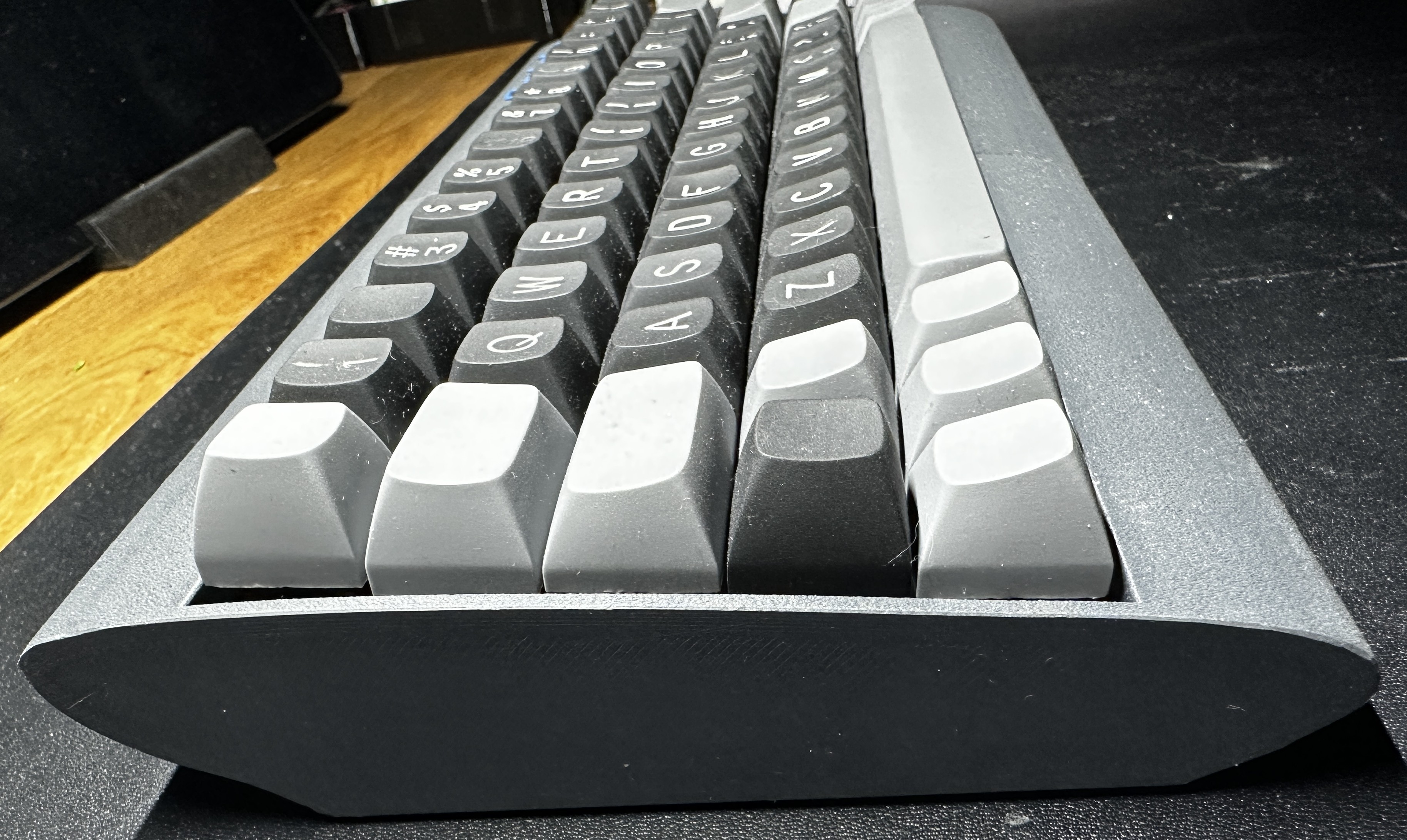

Just to talk about a 60% variant - I have been working on 6 or 7 variants already and been using them also in my daily rotation.
I have been working with lispnick on gettings things into a working configuration and what I came up with was a traditional 60% but with a huge Space Bar and some other mods.
I also played around with the case design in 3D prints and my favorite was a design that is more rounded like the attached. The important factor for me has been the ability to travel around with the keyboard (so it has to be reasonably weighted and has to fit in my backpack). I used stainless steel for the switch plate, because of the sound (I tested one made of Nylon as well, but the difference is there).
The keycaps are just test ones that lispnick sent me over but where actually from his scrap box, hence the not optimal look.

That swoopy case is actually pretty cool. Maybe it’s the whole monochrome thing: it gives me vintage sci-fi vibes.
Hard disagree on the spaaaaaaaaaaaaacebar though. But maybe if you split it…
Real talk: my fingers expect my modifiers, especially Command, to be much closer to the centre of the keyboard. I don’t even notice the blank areas out there on the HHKB. Putting vital mods way, way, way out there would be inhumane for me!

I started off with a small spacebar (6.25) as well, but now I dearly enjoy this size. Not only can I reach it perfectly in every situation, I also enjoy its sound. Once you reduce its size, I fear the unique bass gets lost also. People also see it as the first unique thing, so I had some good conversations along the way.... Just my opinion and I totally understand that others have different thoughts on it.Muirium wrote: 31 Aug 2023, 23:47 That swoopy case is actually pretty cool. Maybe it’s the whole monochrome thing: it gives me vintage sci-fi vibes.

6.25 is not small. I’d much rather have a 5 unit spacebar: one thing Apple gets right on their modern hardware, and I got used to on the PowerBook. Even my HHKB’s 6.0u still feels a bit too wide to me, after more than just a little use.
I really do like my modifiers at my thumbs, you see. And I only really hit space under N and M, as my ABS shine always testifies.
I get what you’re saying on the looks and character front. Looooooong spacebars scream typewriters and deep vintage keyboards. But I do find their form gets in the way of my function. That beast on the IBM AT is no bother at all to me, weight wise, but it pushes out my mods so wide I’m always slowed down when I’m on it. Thank the gods for the Kishsaver! 7u is my practical upper limit.

If it were for me, the space bar would be 5.5U, placed symmetrically within the alpha block (which does NOT mean to the block itself, but to the position of the F and J keys, or D and K for the early Apple irredentists).Muirium wrote: 01 Sep 2023, 22:56 6.25 is not small. I’d much rather have a 5 unit spacebar: one thing Apple gets right on their modern hardware, and I got used to on the PowerBook. Even my HHKB’s 6.0u still feels a bit too wide to me, after more than just a little use.![]()
This alignment would ease up splitting it into two equally-sized halves (for those wanting an "EZ erase" comeback), or the same plus an Fn key (a must[*] in any form factor smaller than a TKL — 75% and under).
[*] An objectively, unequivocally, undisputable "must"... because I opine so. Of course.

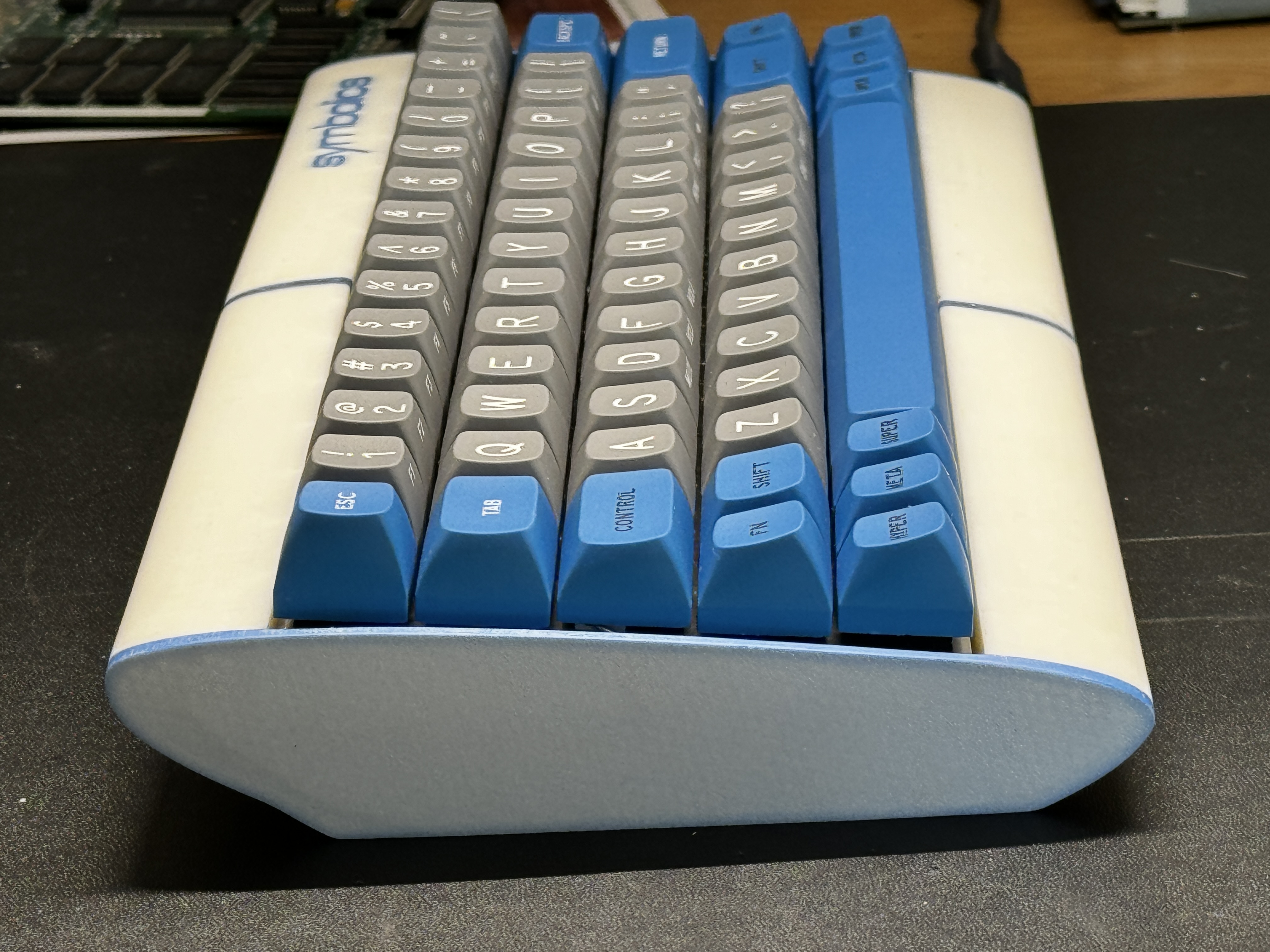

And here's the SpaceCadetSpaceSaver how I imagined it
Keycaps: NOS Blue Alps except for Space which has a White NOS Alps
PCB: Used Alps64 as baseline and modified it heavily for USB-C and switch placements
Switch Plate: 1.2 mm Stainless Steel Plate, lasercut
And of course: Keymacs keycaps (custom order)
