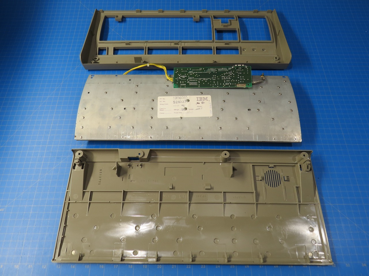

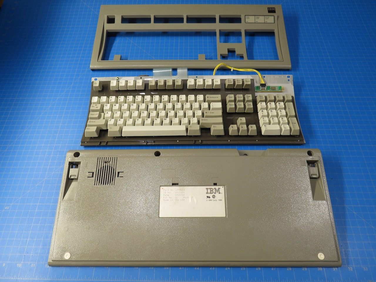

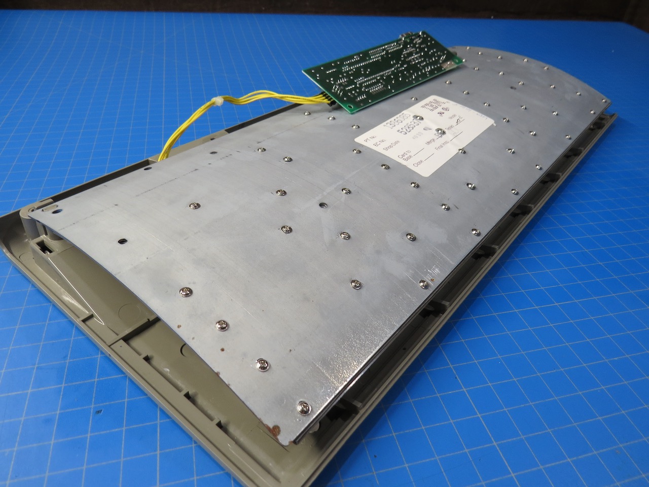

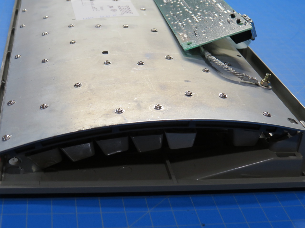

56 M2x6mm metal screws > 56 melted plastic rivets

Pristine enough for you?
New in box, untouched, protected by inches of intact polystyrene. Yet still has many broken rivets sliding around inside when you tilt it!
Model M is garbage by design. Those rivets are unforgivable! And this is from an IBM fan!
Clickykeyboards' screw mod is more along the lines of what IBM should have manufactured in the first place. But they didn't, because M's design goal was to be cheap, not an advancement in quality.

Another example of a NIB Model M with broken rivets in an old thread, with this revealing answer by the finder (emphasis added):Muirium wrote: 12 Oct 2023, 15:09[…] New in box, untouched, protected by inches of intact polystyrene. Yet still has many broken rivets sliding around inside when you tilt it!
So Muirium is indeniably right:litster wrote: 31 Oct 2012, 16:14Haha, it is clean! It is not dirty at all. No cleaning needed. 5 broken rivets, that's all.dirge wrote:Nice one bud! well done. How does it compare to used boards and unicomp?
[…] Model M is garbage by design. […]

Conversely, here's one I pulled from a literal trash pile with perfectly intact rivets:
My guess is that rivet failure rates are mostly tied to storage temperature. M barrel plates (at least Greenock ones) are Noryl SPN422L. It's an alloy of PPE, PS, and PTFE. PTFE is almost the definition of stable. PPE and PS are pretty good as far as plastics go but 40 years in a hot warehouse will embrittle just about anything.
https://en.wikipedia.org/wiki/Conservat ... erioration
