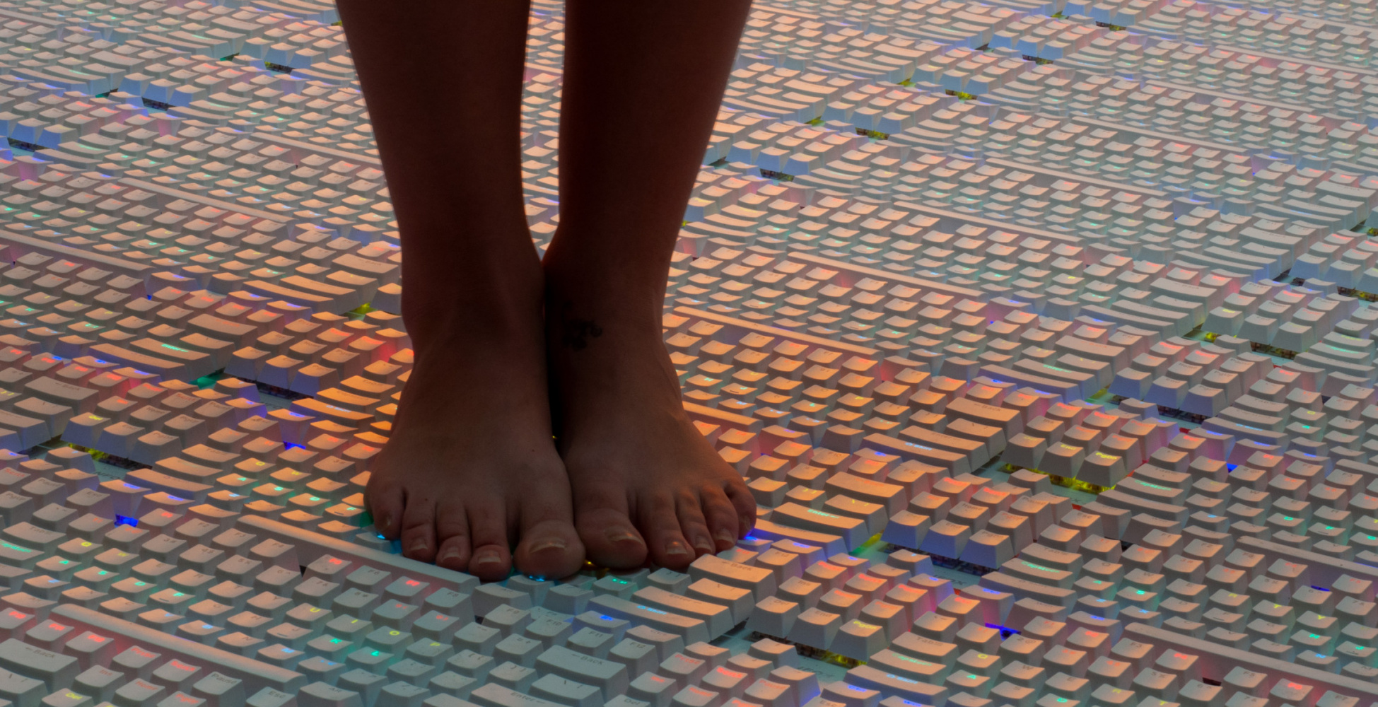

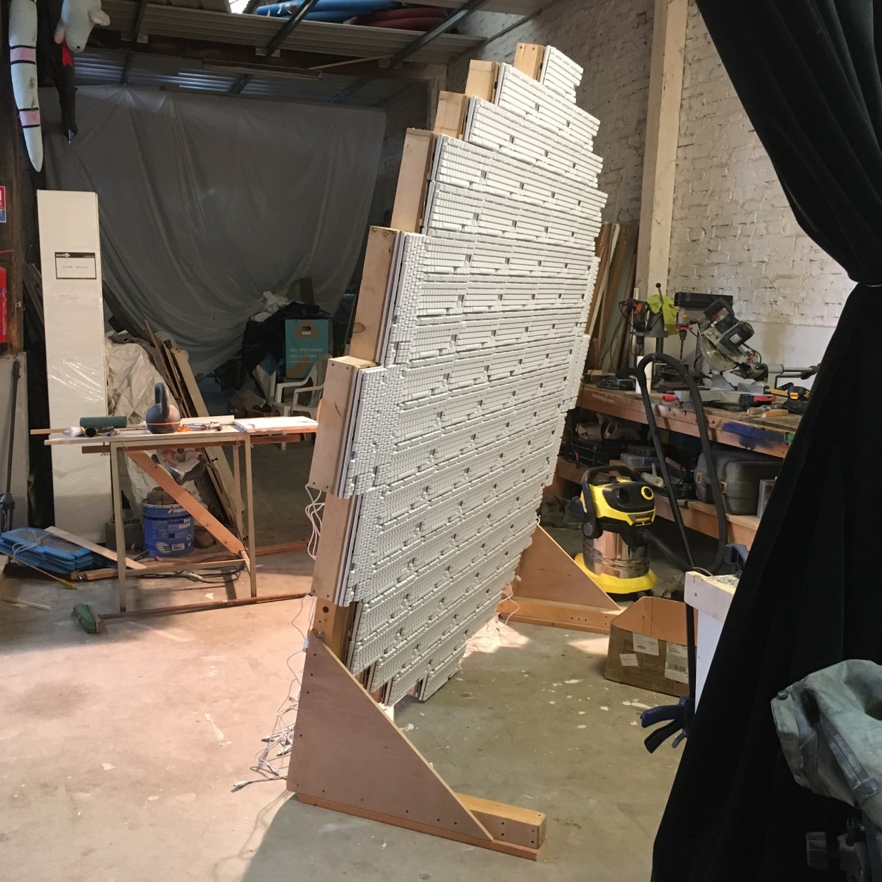

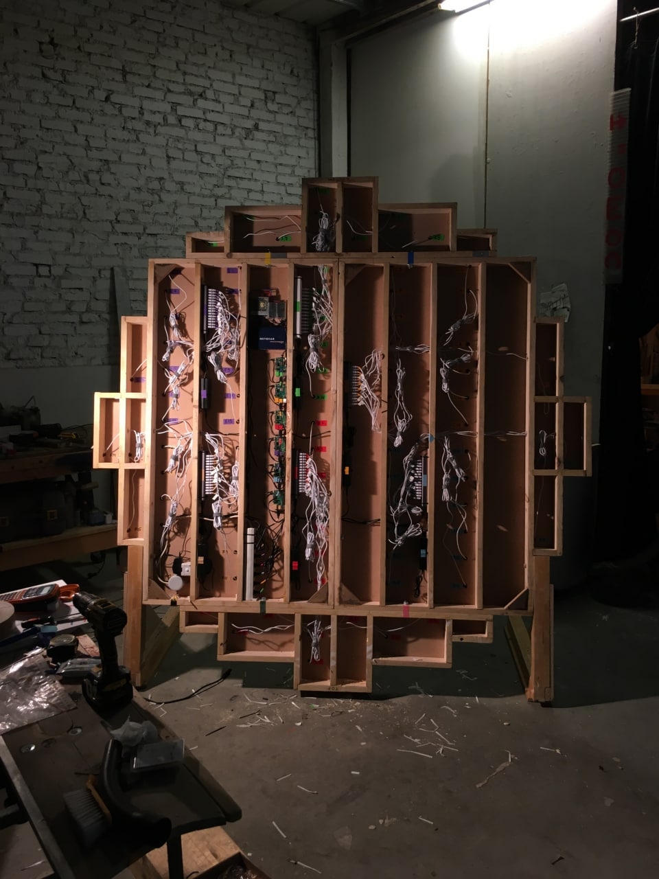

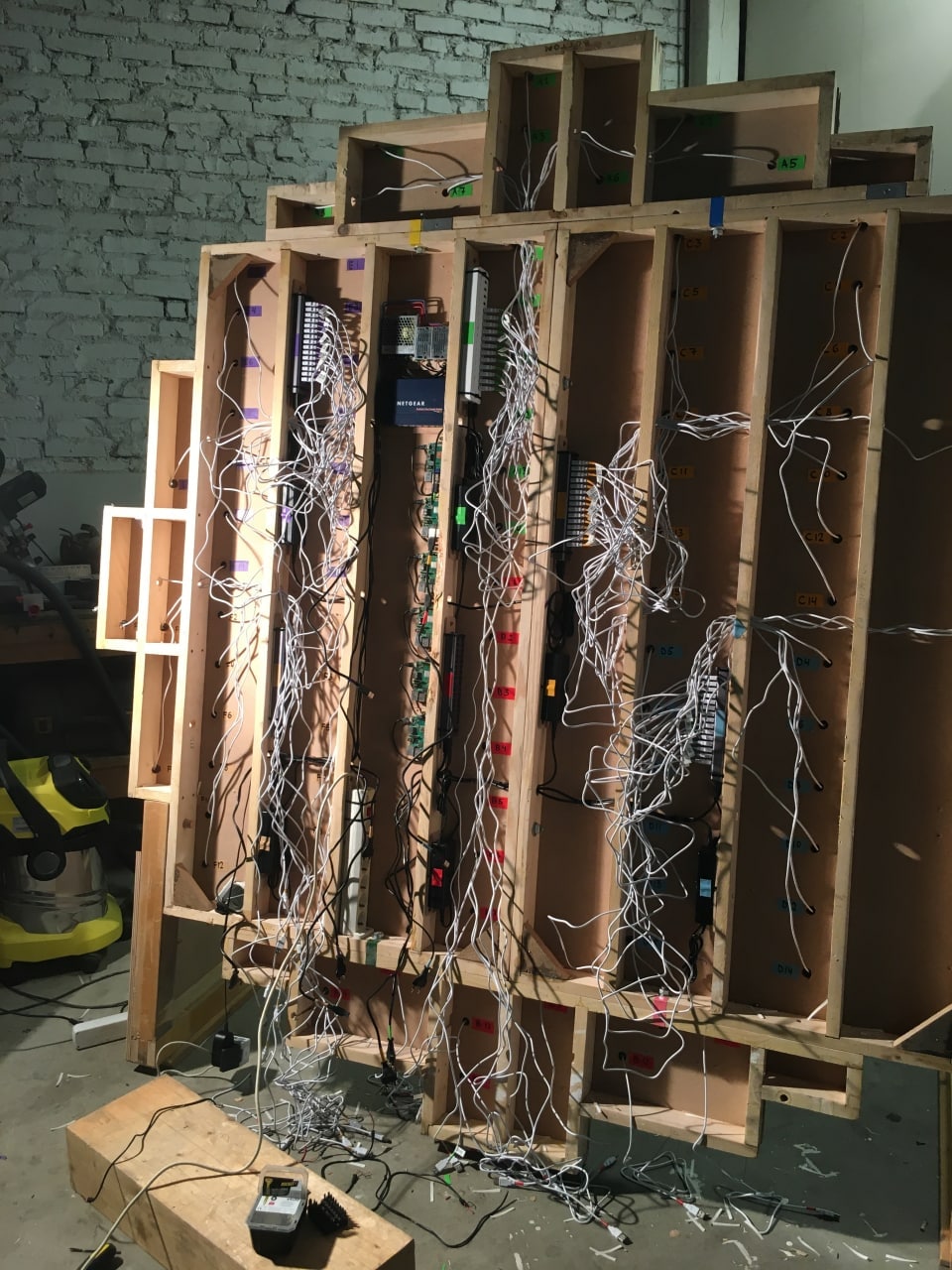

Sorry, it's been a year now. Anyway I did build this installation. It did work and it didn't break during 2 months, hosting hundrends of visitors. Here is a link to my website for this project:
https://www.mikhailmargolis.com/digital_swamp
There is a video
Thanks to everybody.
M
There is a video
M

Indeed! Artfully done.
The RGB backlighting, which typically looks garish on a desk, has a waving, rippling effect when used as a floor, along with the contours of the caps.
