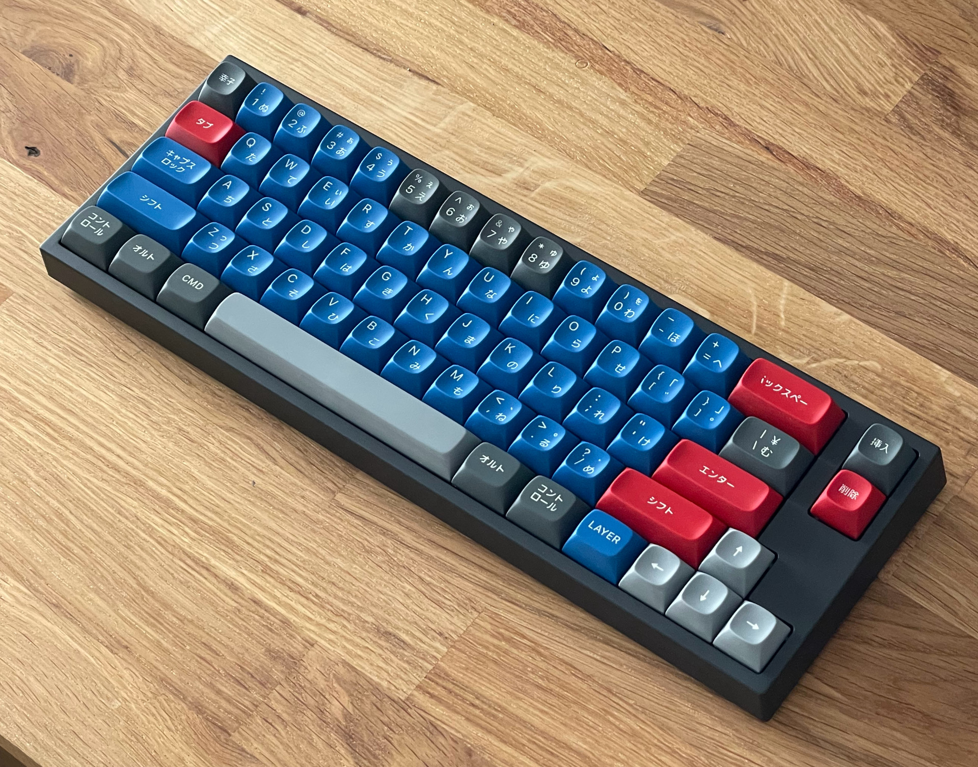

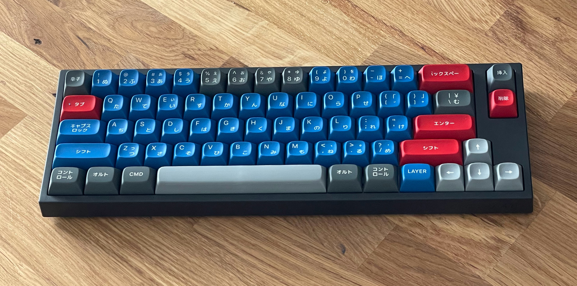

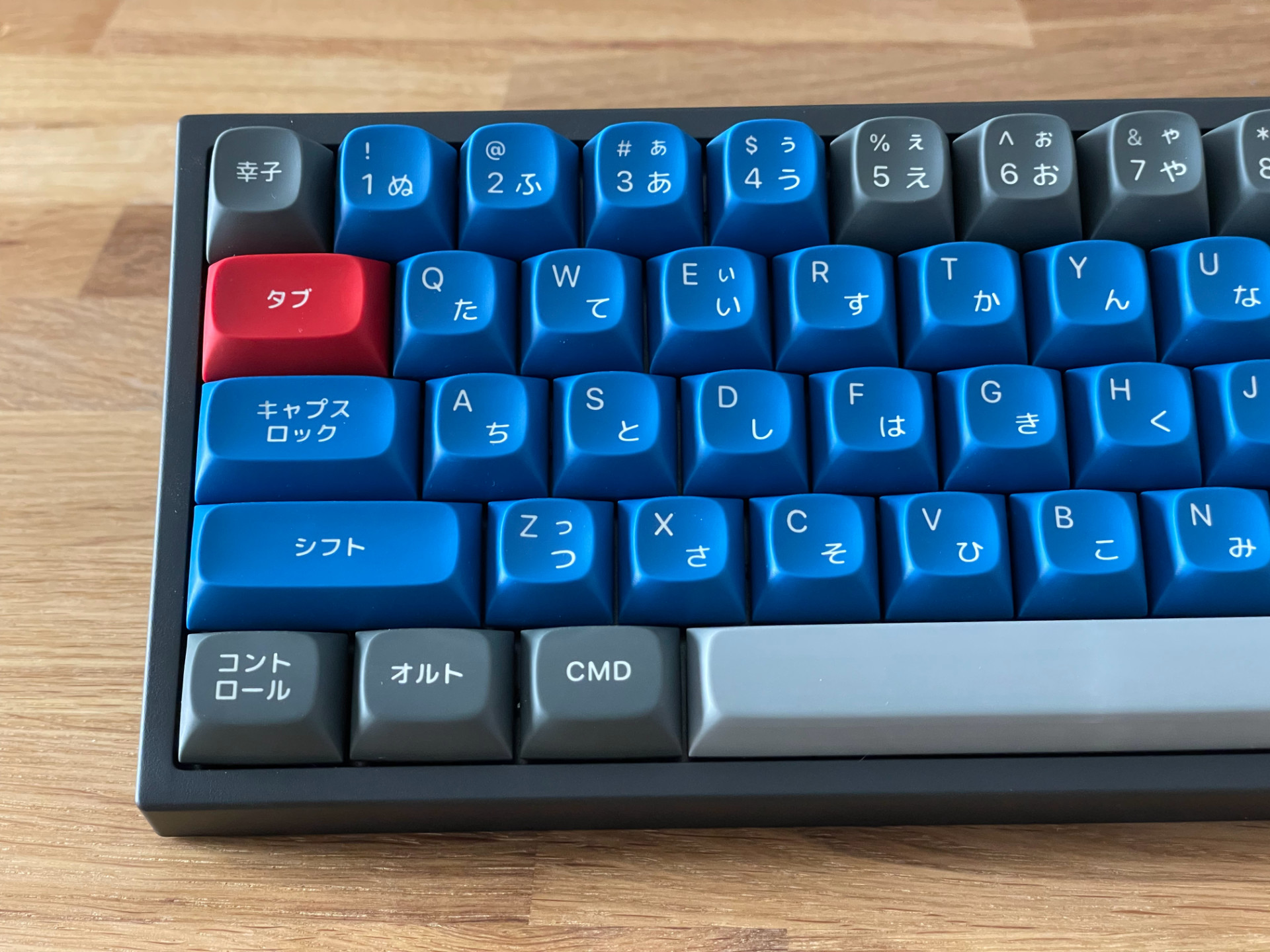

Thank you so much. Here are some quick phone snapshots fresh from today, right after I removed print-supports for four hoursmmm wrote: 15 Oct 2022, 21:21 This looks amazing! I would not have guessed these were printed. The legends looks crisp!
Can you tell us a bit more about the process of making these (and how you made the legends), and do you have more pictures from more angles?
It's a 'regular' resin print at 0.03 mm layer height. The legends are printed with a recess and filled with the very same resin, but with a different color. As mentioned before, the gray spacebar was a test print and the gray acted strange during print, resulting in white clouds. I've learned from that print though and will now make adjustments and print the final one blue, same as the alphas.
- top.jpg (579.79 KiB) Viewed 91781 times
- right.jpg (540.38 KiB) Viewed 91781 times
- left.jpg (544.58 KiB) Viewed 91781 times
- diag.jpg (950.74 KiB) Viewed 91781 times

Inredible results from those pictures. I'm curious about the infill though, did you just pour it on and remove excess before curing?andreas wrote: 17 Oct 2022, 17:51Thank you so much. Here are some quick phone snapshots fresh from today, right after I removed print-supports for four hours :lol:mmm wrote: 15 Oct 2022, 21:21 This looks amazing! I would not have guessed these were printed. The legends looks crisp!
Also this makes me wonder how that resin would take to a careful sandblast for some texture.
- andreas
- Main keyboard: 40% Ortho
- Main mouse: M330 Silent
- Favorite switch: Tactile
Hi and thank you so much,
the legends are filled with a fine brush — a real Zen thing all in all about 4-5 hours for the 189 glyphs
I tried pouring / overfilling, but due to the micro structure gaps from the LCD, I could never get the surface sufficiently clean again. It always ended in a strangely coated surface, because I use highly pigmented resin.
Sandblasting sounds like something fun to try, but I do not have access to a sandblaster.

Thank you so much. I totally forgot to mention, there is no post-processing on the caps in terms of coating, polishing, or sanding. It's still something I want to experiment with.mmm wrote: 18 Oct 2022, 00:17 Thanks for filling us in on the details. The hours spent filling in the legends have definitely paid off!![]()

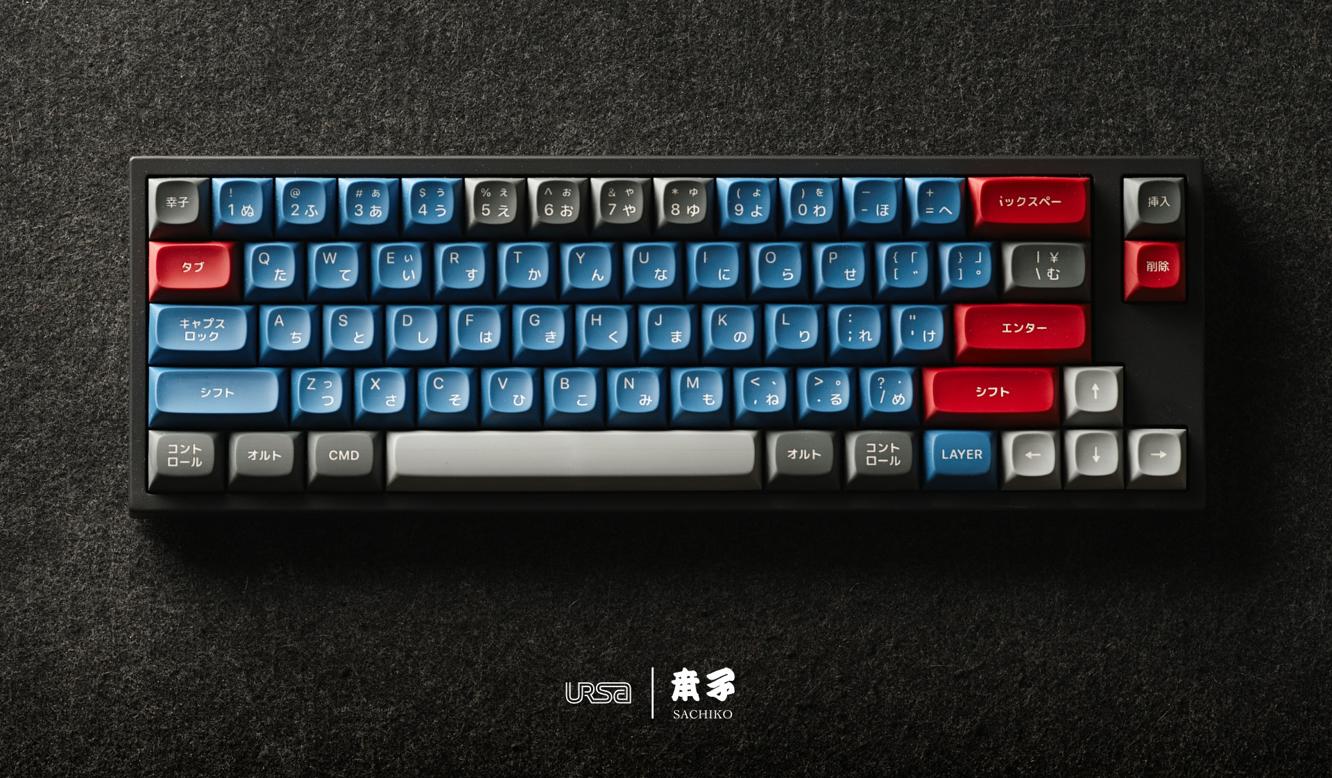

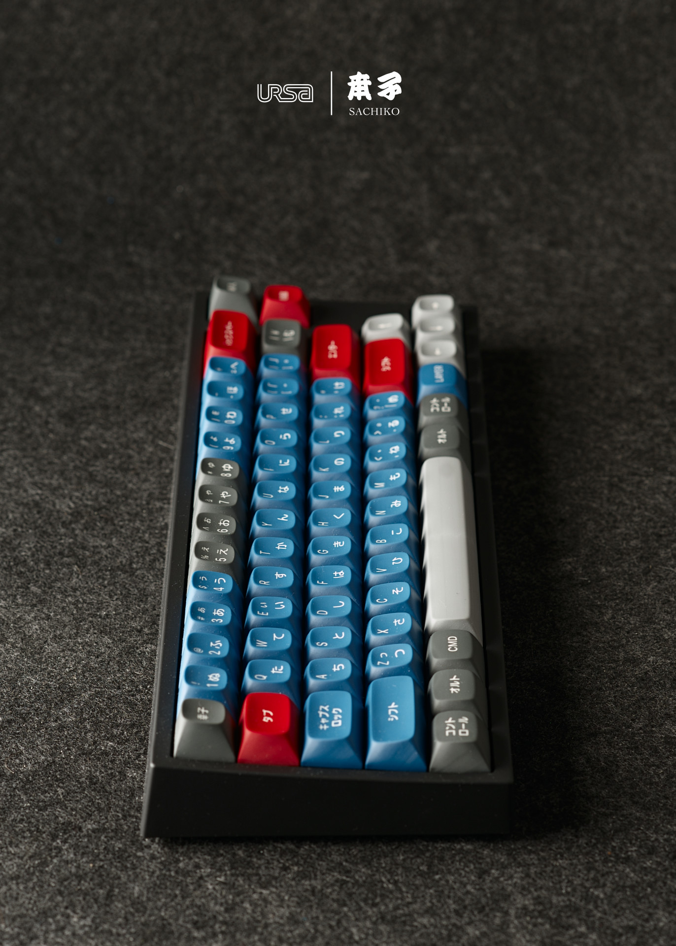

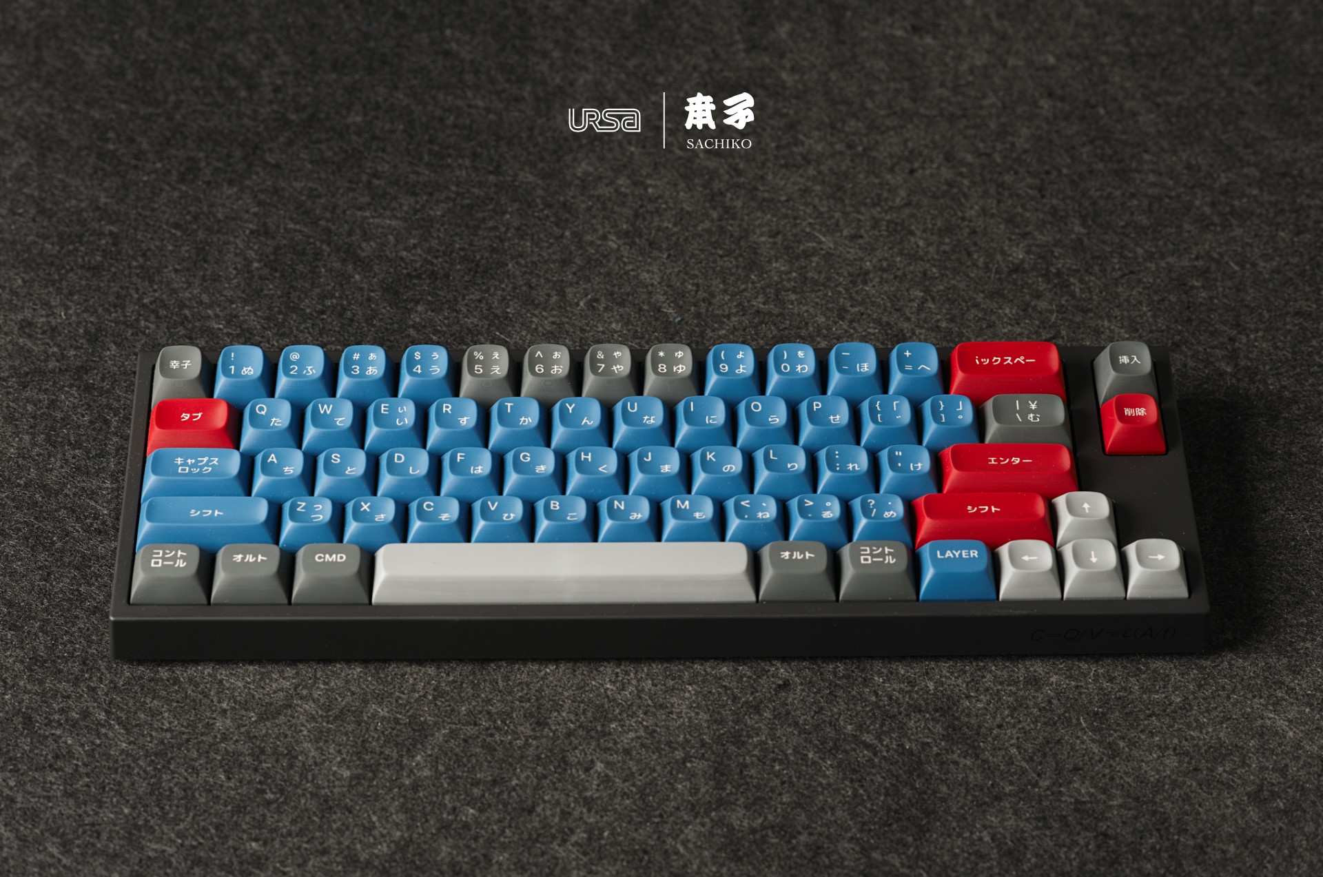

I took some more photos and would like to share them with you.
- ursa_sachiko_front_v01.jpg (560.29 KiB) Viewed 91591 times
- ursa_sachiko_top_v01.jpg (672.81 KiB) Viewed 91591 times
- ursa_sachiko_side_v01.jpg (499.03 KiB) Viewed 91591 times

Andreas: why not this?
Where did the good stuff go? Double shots want to be BOLD and Exhilarating!
- guidemetothelight
- Main mouse: Fantech XD5
- Favorite switch: SKCM Brown
Iam with µ on this.
The only set I really wanna buy is this red & blue one.
Hopefully in iso ?

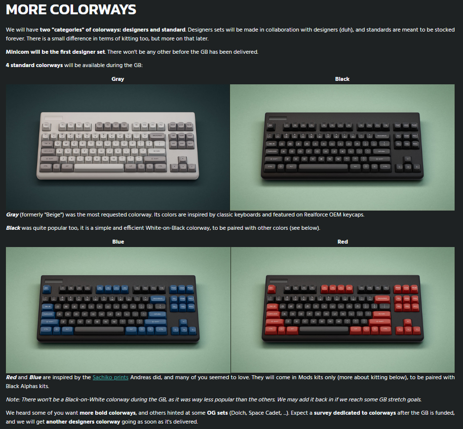

Saw this update in my email inbox:
In the spirit of listening to the moneymen and changing tack towards a group buy: I'd suggest once again changing to a distinctive, lively colorway. I'd be much more excited and likely to join this GB if the caps weren't so pallid.
The GB's not live, and won't be for a while yet by the looks.URSA GROUP BUY ANNOUNCEMENT
It has been a few weeks now that we have announced URSA to the world, and the first colorway by biip, and have been silent since. The reason is we have been looking for funding from private investors, set up meetings, met people, pitched URSA and well, long story short, they are not impressed. This has been a blow to our strategy, as we can’t afford to upfront the costs, but really wanted to have the products directly in stock. It took us a couple weeks to swallow our pride after our last hope faded away, and re-adjust our timeline and targets. Here is the new plan.
- TNT
- DT Pro Member: 0250
Hey Mµ,Muirium wrote: 02 Nov 2023, 15:22
I think you might have missed this section of the announcement:
- Muirium
- µ
- DT Pro Member: µ
That's the previous blog post, though, and the current one states there is an "initial colorway", with white on black as a "stretch goal." What's unclear is precisely which colorway that is. The email announcement is a great big picture of the pale beige and beige set I linked in the spoiler above. It's also the first one in your screenshot; the other three apparently being off the table until later. The "biip design" he mentions appears to be the Minicom colorway, which isn't actually pictured on the blog. There is a greyed out image of that design in the survey signup form, however.
My past experience with group buys is that "initial" things tend to wind up being the only ones ultimately produced. No battle plan survives contact unscathed.
When launching a GB, show us pics of the thing you're going to sell please. Other plans must wait, and they often do forever. Pick the very best one you've got and run with it.
