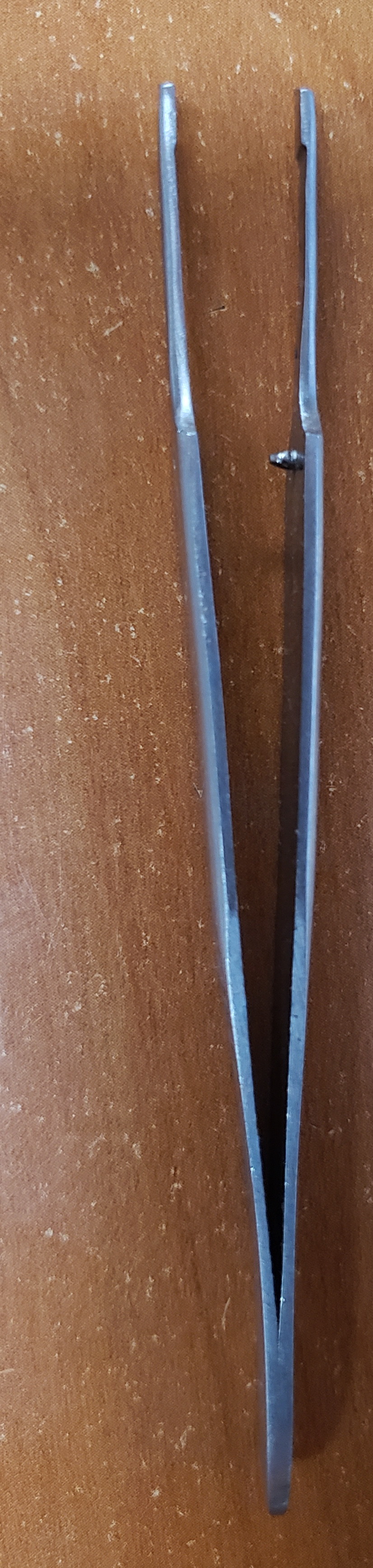

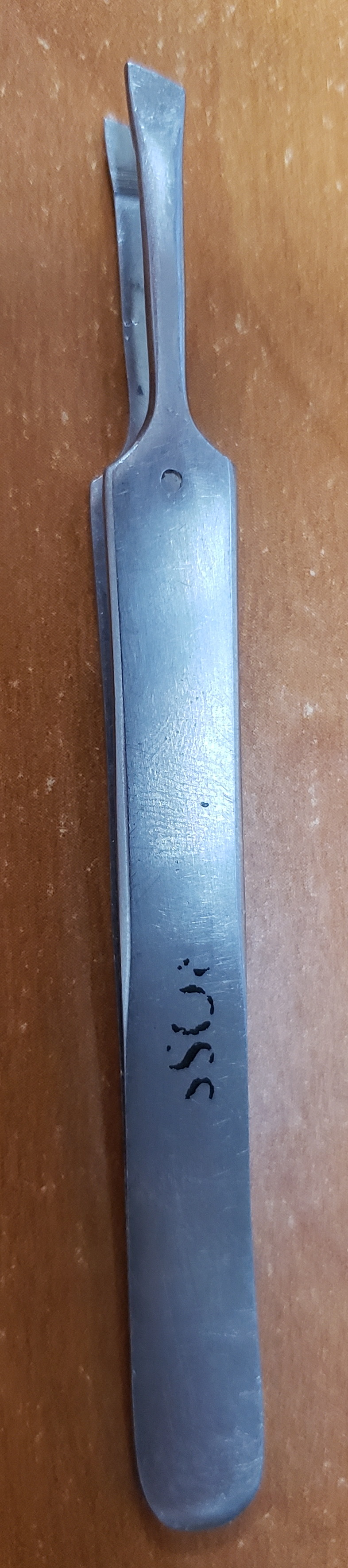

The best tweezers are those that have a beveled/angled edge but a few centimeters at the end being flat, and possibly serrated. My pair of tweezers is old and I can't find it for sale but if anyone has links to recommendations please share them.

My own tweezers used for reinstalling springs:
