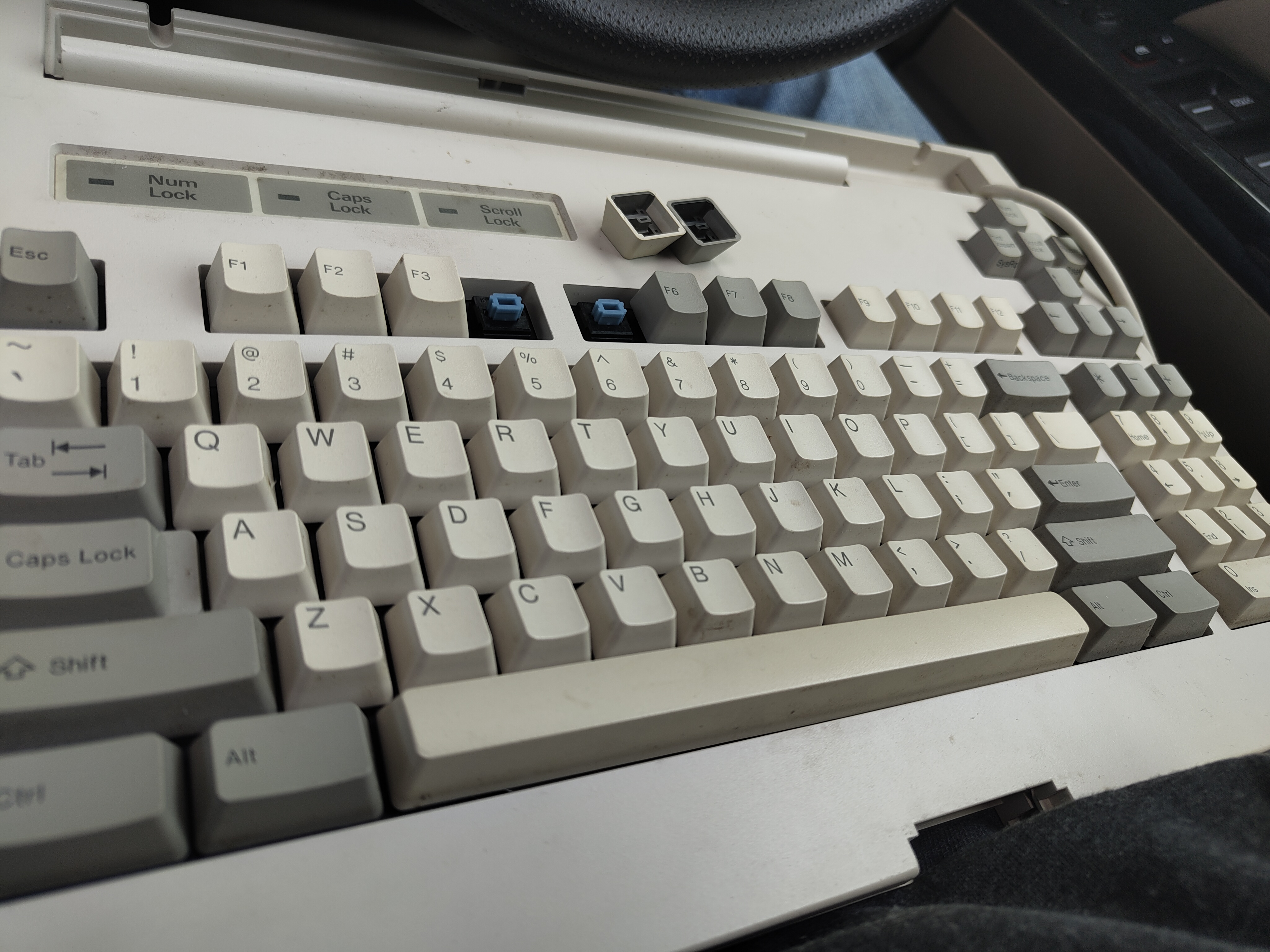

The AT101W is an excellent chasis, I have one that I transplanted blue ALPS into and it is a joy to use.
The black variant of AT101W is much harder to find and looks much more contemporary.

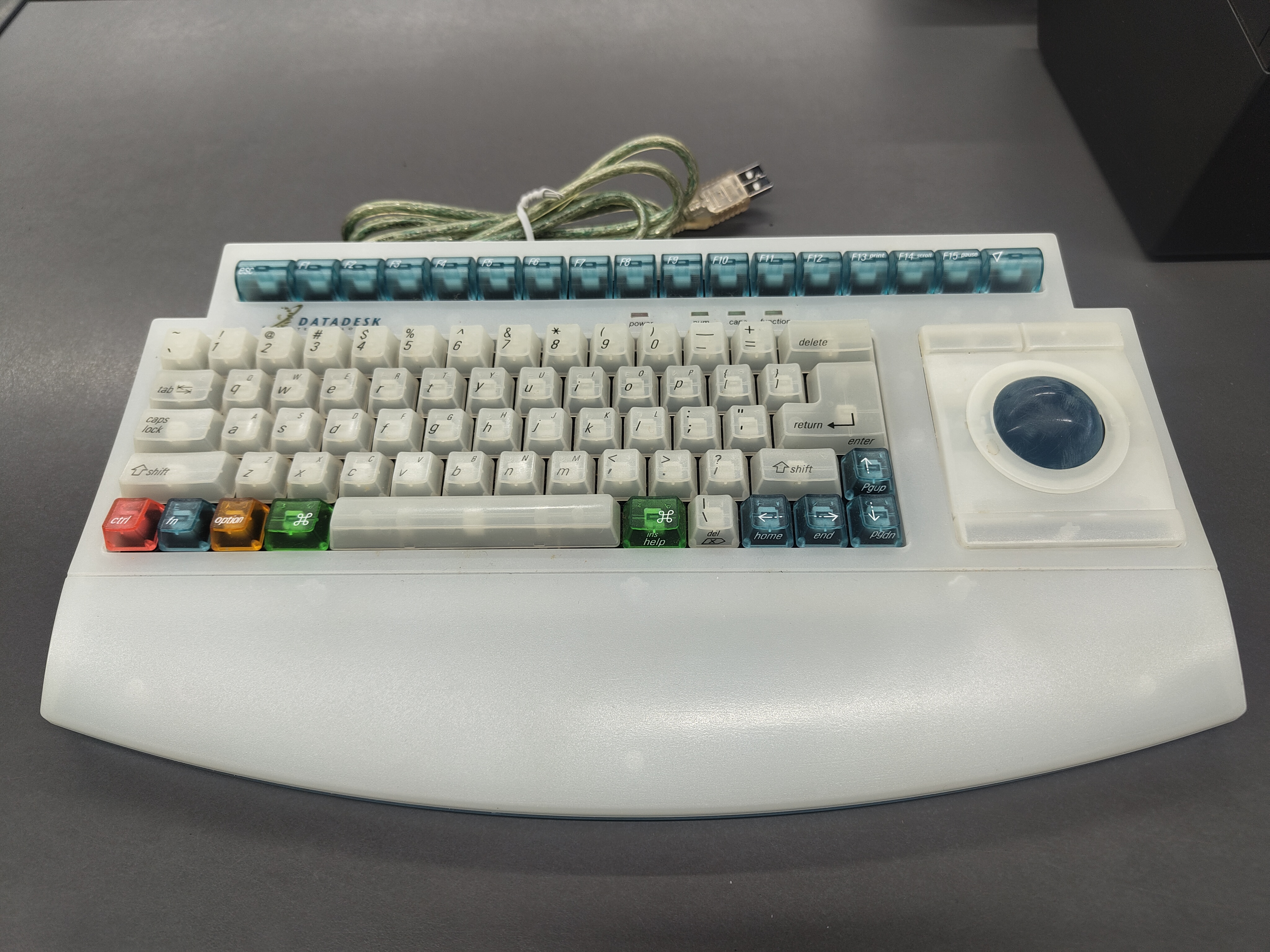

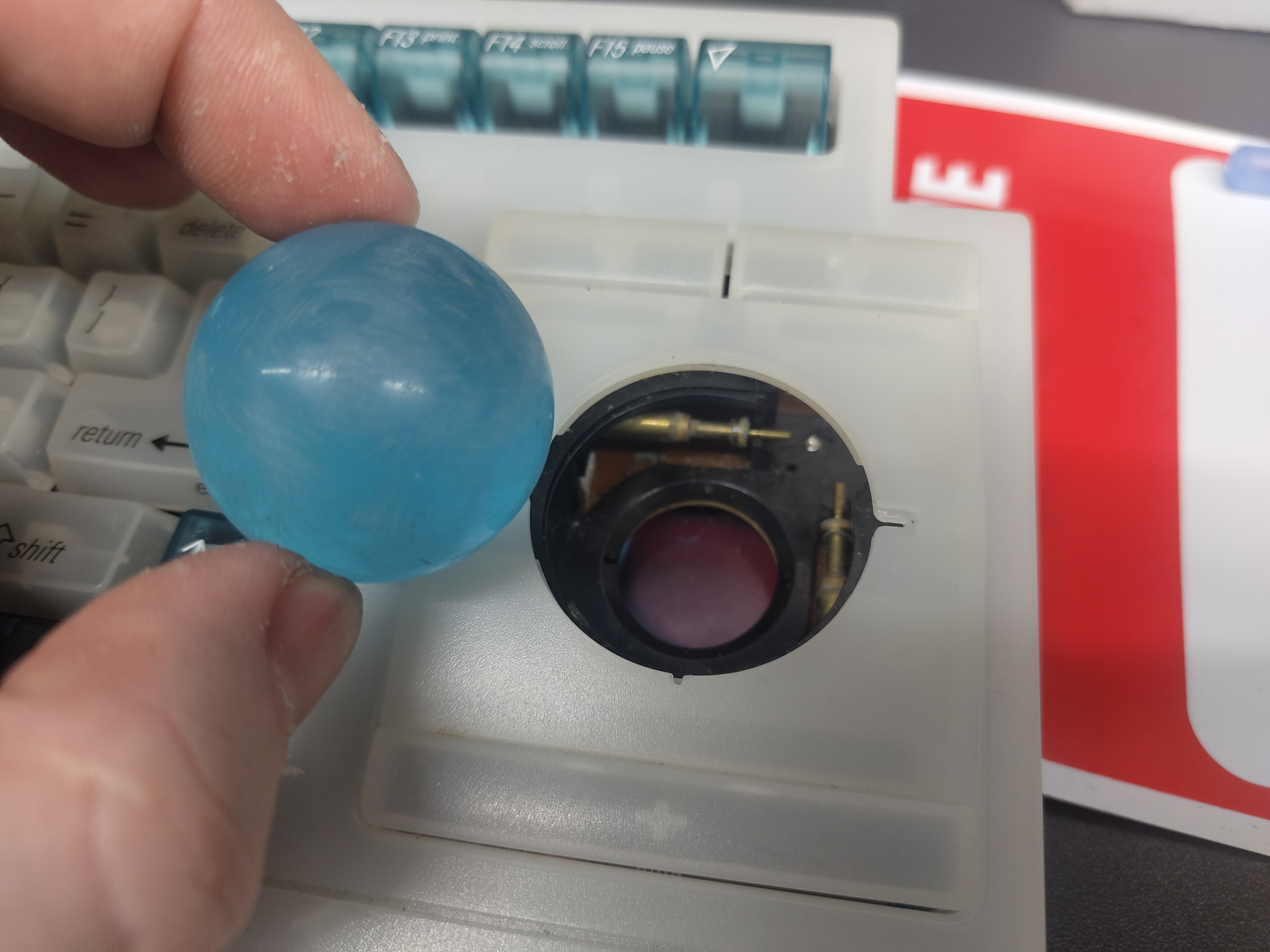

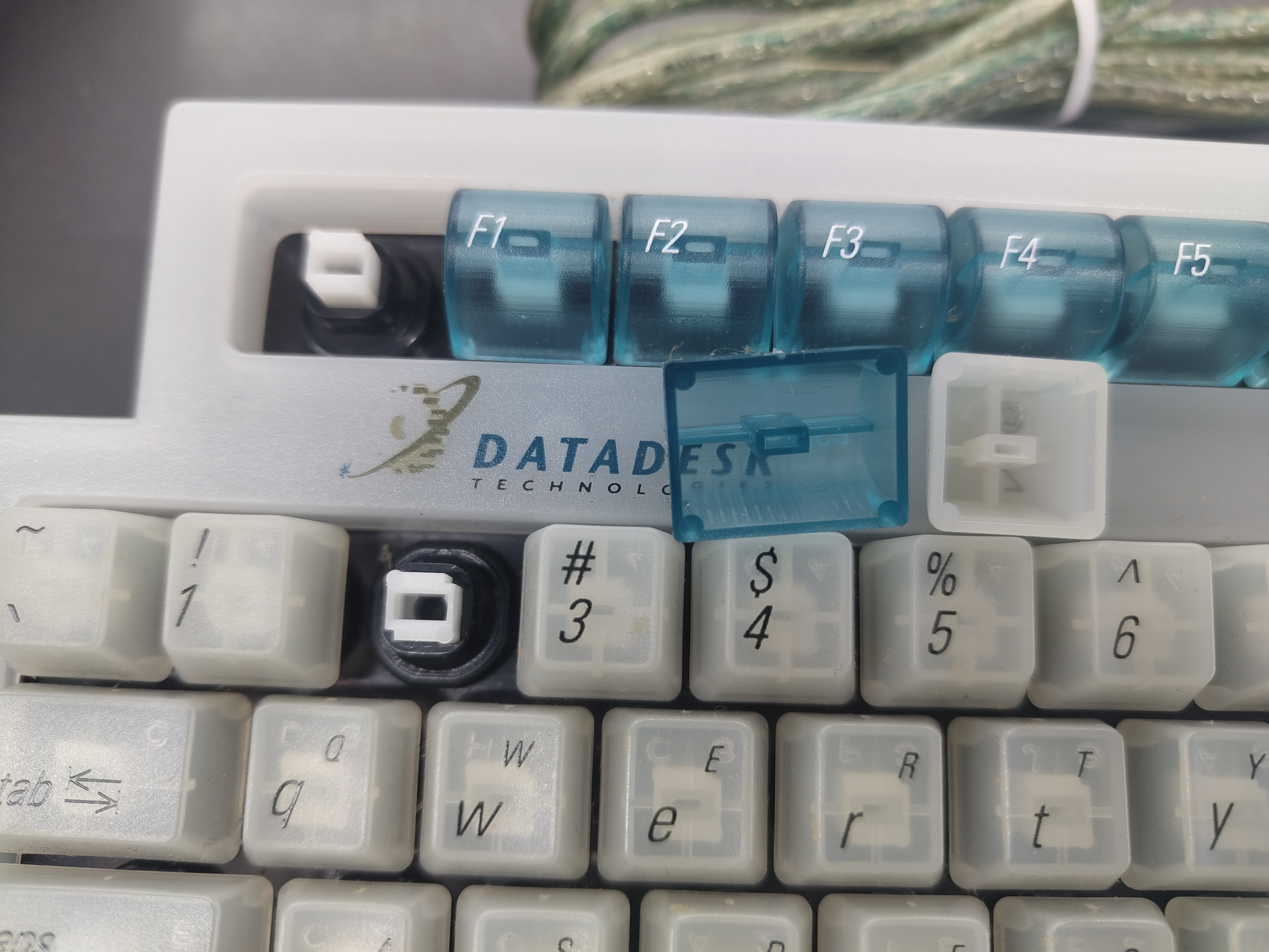

Picked up this wacky contraption.
Alps mount tiny keycaps on a dome and slider.
The translucent trackball which was one of the main attractions for me is unfortunately scuffed due to the rubber on the rollers having disintegrated years ago. I'll have to find a way to polish it.
- Location: USA
- Main keyboard: Dell QuietKey SK-8000 with Zorro Blue
- Main mouse: Microsoft Wireless Mobile Mouse 3500
- Favorite switch: Everything except MX Brown
This would be amazing converted to a mechanical. Imagine a custom PCB with Matias's switches and lighting too!

It would, but due to the tiny keycaps if you put proper switches in it the spacing between them would be larger and the effect would be quite strange. Would be fun to add a tiny T-NAV to a board that doesn't have it though.SK-8K wrote: 22 Nov 2024, 14:21This would be amazing converted to a mechanical. Imagine a custom PCB with Matias's switches and lighting too!
