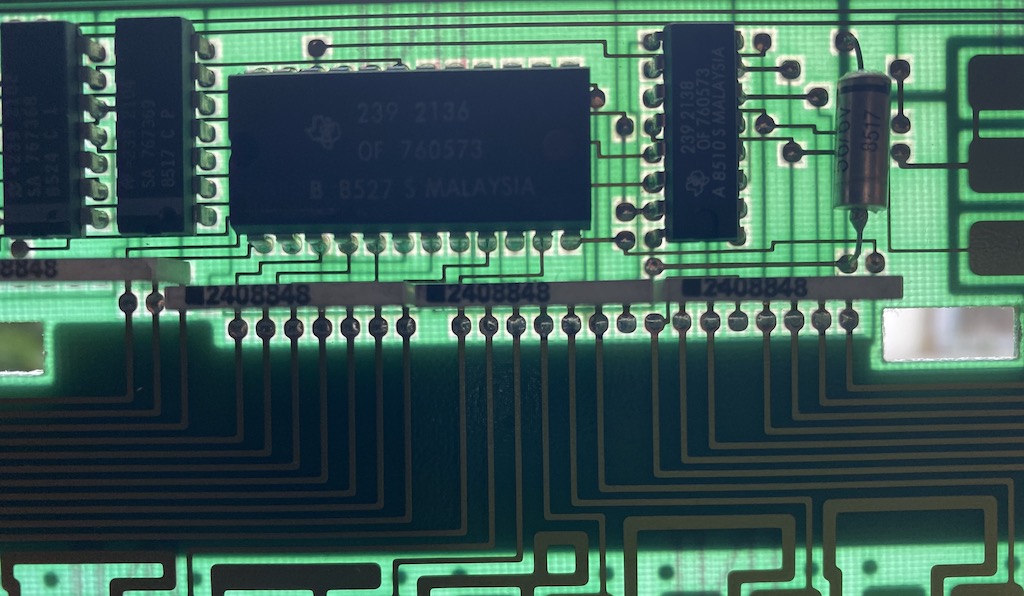

I don't quite understand, why it is necessary to completely cut off the original PCB/controller. Isn't it possible to cut the traces from the matrix lines to the rest of the PCB with a scalpel?
And even if this is not possible, I could still desolder the original PCB's ICs. With a custom TH-xwhatit, I might solder the replacement board via pin headers onto the old PCB - or use male-female pin headers to build a removable board. Or maybe I'm missing something.

You are correct, it's not necessary to cut the PCB. You could just cut the traces on the PCB or you could just de-solder all parts that connect to the columns / rows. Both of these imply that you trace out all connections to rows and columns and you are 100% sure that you have disconnected all of them from any original component.
I can't comment on how easy it will be to find space for such a combination in the case of the XT.
About using pin headers, the pins are not really arranged in a very regular fashion. So you'd have to make a custom version of one of the xwhatsit-like boards, that would have the same arrangement of pins. Also keep in mind, I don't know the diameter of those holes, there's a very good chance that those via holes to which we are soldering wires today, will not be able to take a pin header, and then you will have to drill a bigger hole, but you can't just drill through the existing hole, because you'll destroy the existing via, and soldering is gonna be a nightmare. You would have to solve that problem somehow if you want to use pinheaders.

pandrew wrote: 16 Feb 2021, 08:39 About using pin headers, the pins are not really arranged in a very regular fashion. So you'd have to make a custom version of one of the xwhatsit-like boards, that would have the same arrangement of pins. Also keep in mind, I don't know the diameter of those holes, there's a very good chance that those via holes to which we are soldering wires today, will not be able to take a pin header, and then you will have to drill a bigger hole, but you can't just drill through the existing hole, because you'll destroy the existing via, and soldering is gonna be a nightmare. You would have to solve that problem somehow if you want to use pinheaders.
The ICs mounted to the original PCB look fairly standard 2.54mm-spaced, so it should definitely be possible to solder pin headers to them once they are removed. I will check once I'm reunited with my board.
Regarding the connections to xwhatsit: Of course, that would be non-standard. But I'm not going to do any SMD soldering and I'm not going to pay huge sums for some prebuilt controller PCB which does not seem to be sold anyway. And I could just as well solder the TH-xwhatsit components to a prototyping PCB along with some pin headers in the exact required spacing.
It's not going to be a trivial mod, so I will first make absolutely sure that I cannot save the original controller.
