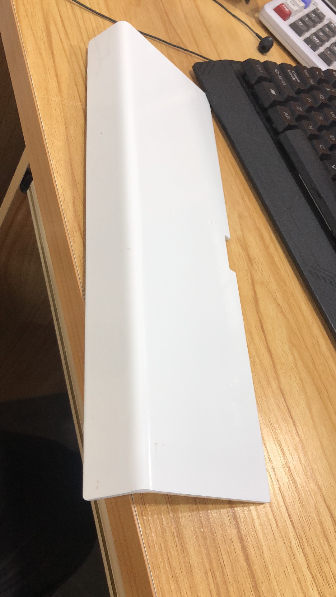

Got an update for you all. I have 3D printed a few prototypes from the CAD files I was given. The good news is they fit, in spite of it not being the most optimal print!
You can view the whole gallery here:
https://imgur.com/a/TWJeD1q
In case you are wondering, I had a bit more control over the print settings for the white door, so it came out a lot nicer. Unfortunately that printer was too small so I had to scale the model down a bit to get it to print. The fit on the grey one was a bit tighter than the original part, but I am guessing this is most likely due to how rough the print came out more than anything.

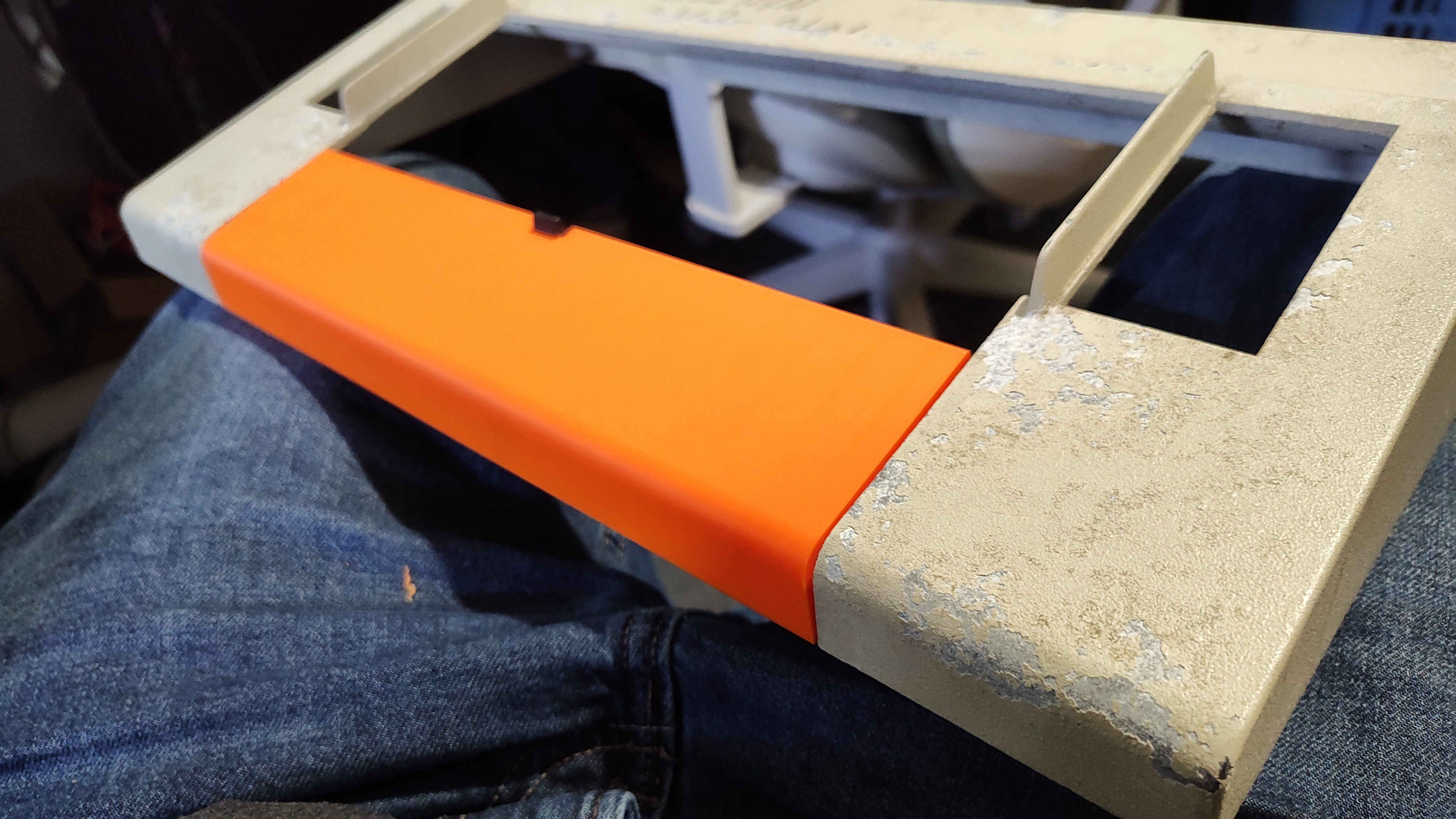

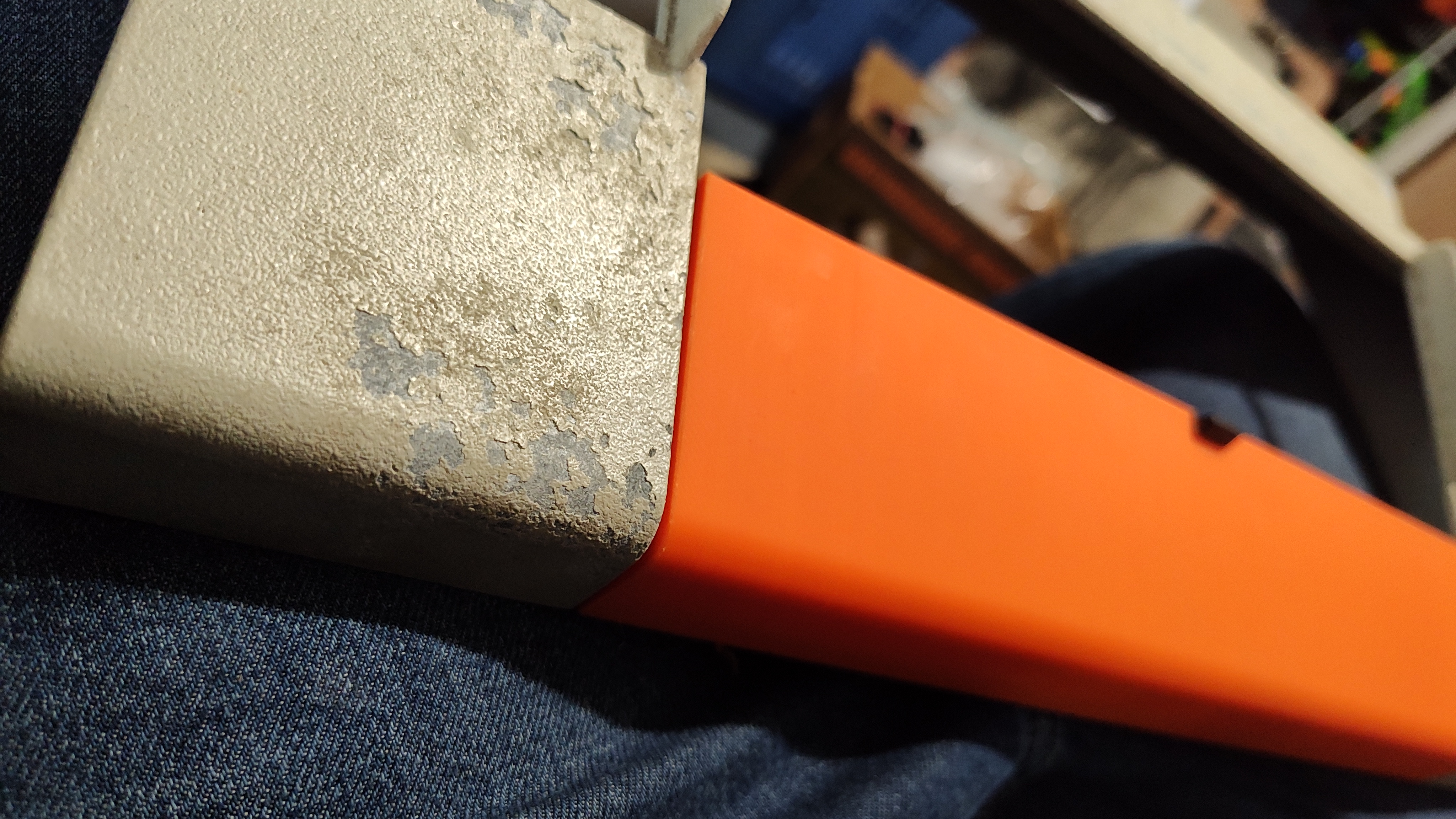

Not sure if anyone is interested, Im also planning on doing a small run of doors, but I had to make my own cad model after seeing an issue with the cad that was floating around. Right now the plan is 5052 aluminum for the doors. Here is a test print of the file printed in pla vertically on my voron.

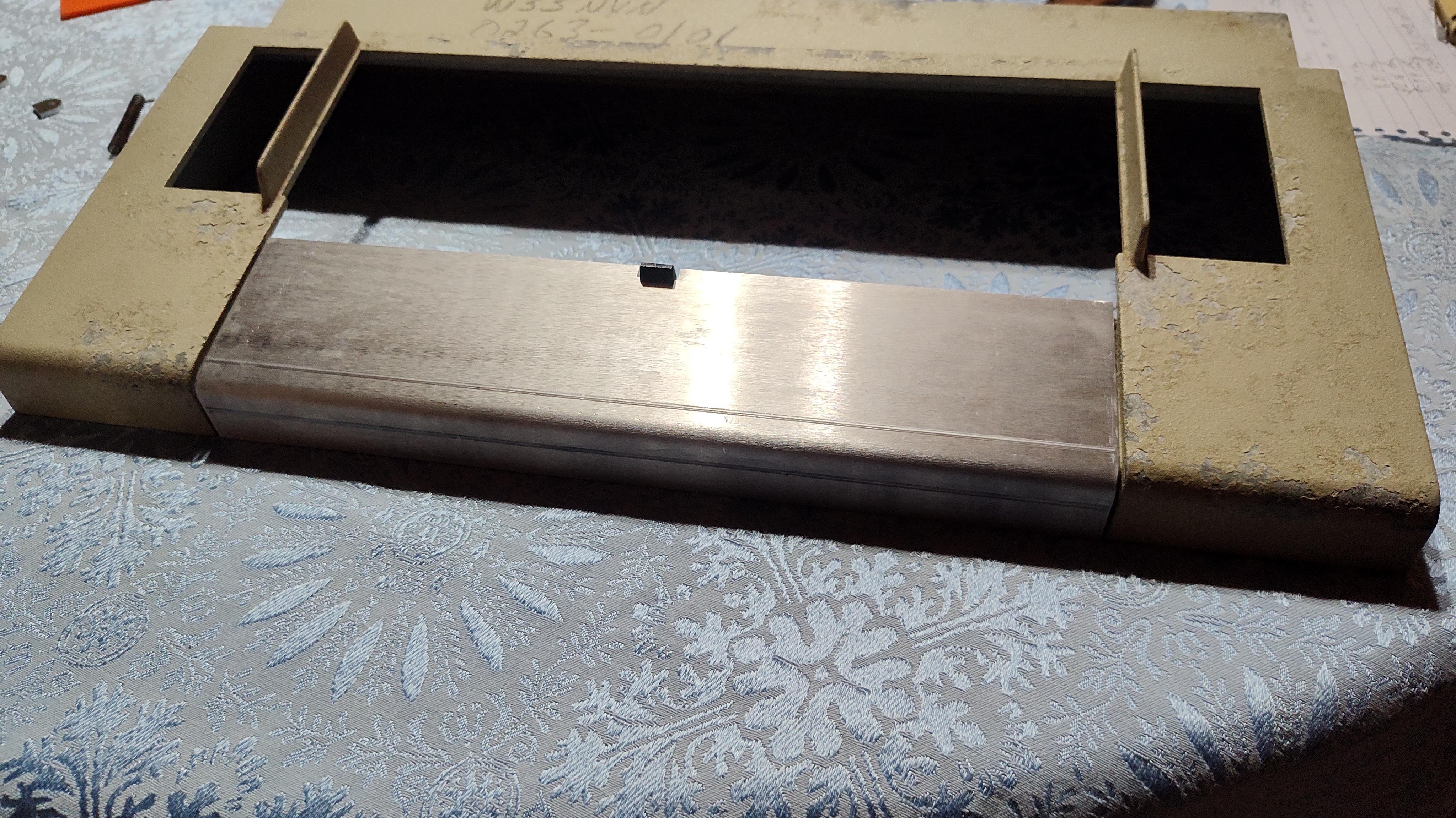

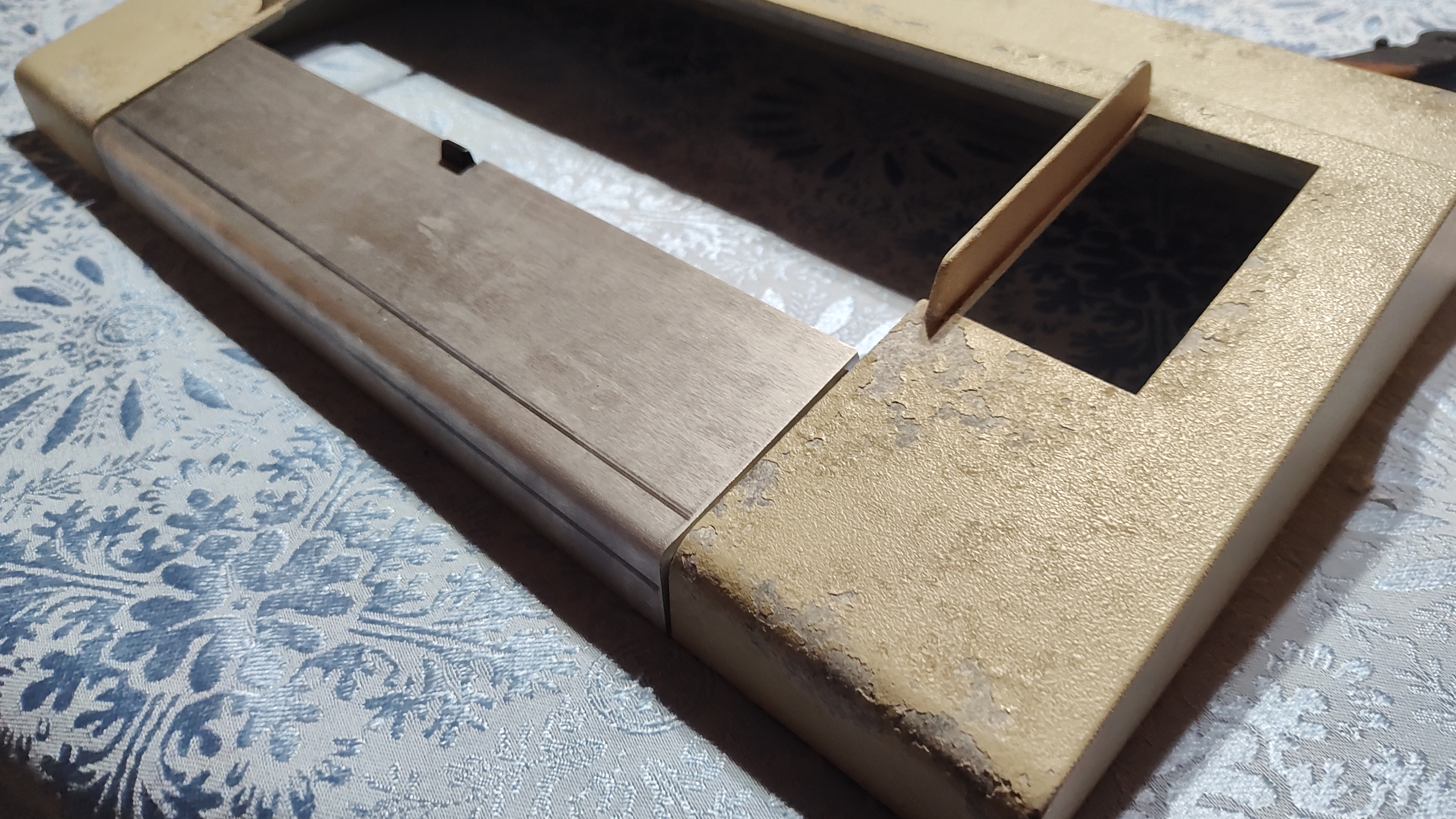

Just finished bending the door, going to weld the tabs on tomorrow
