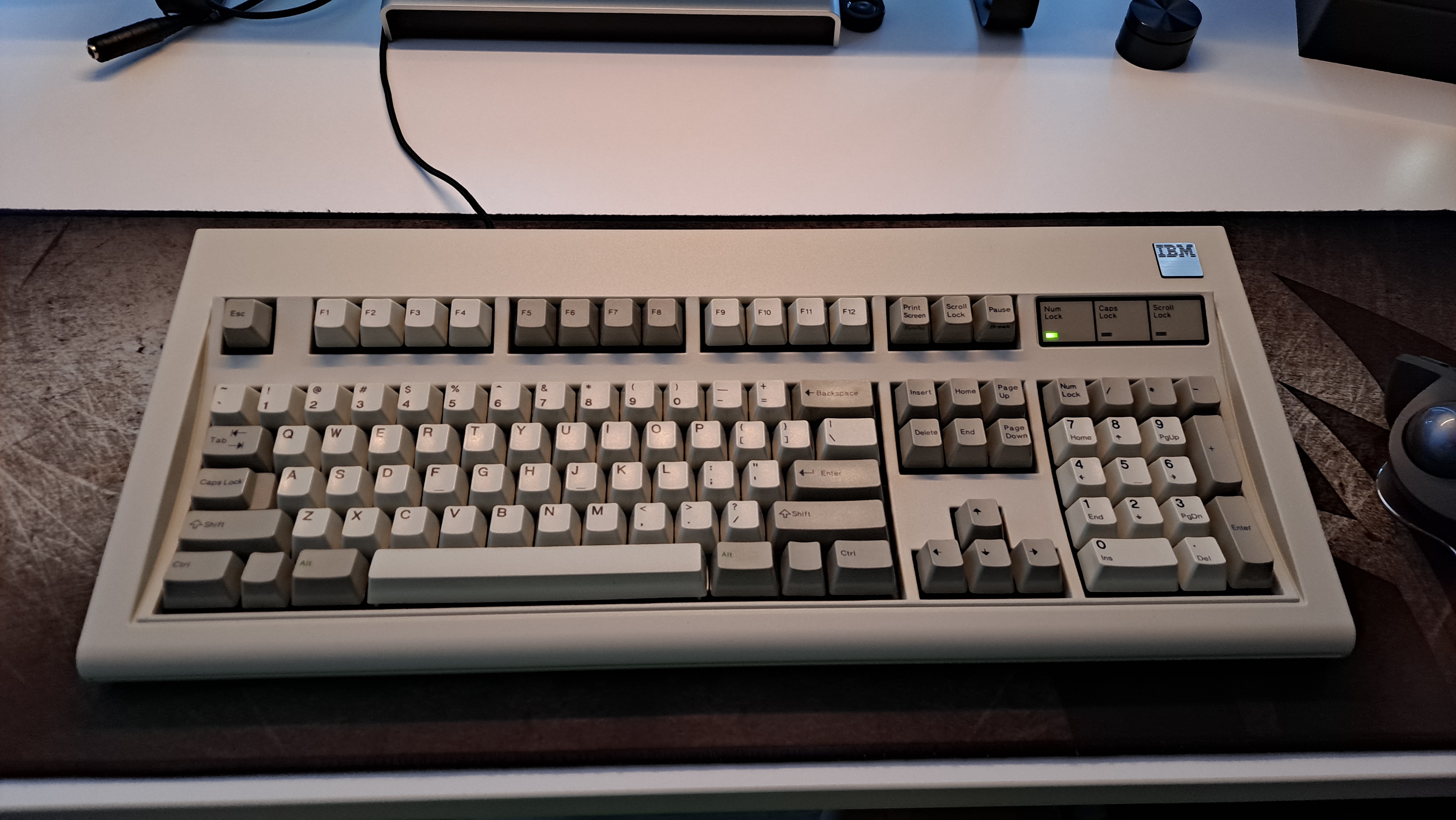

- Location: Australia
- Main keyboard: New Model F
- Main mouse: XM1r

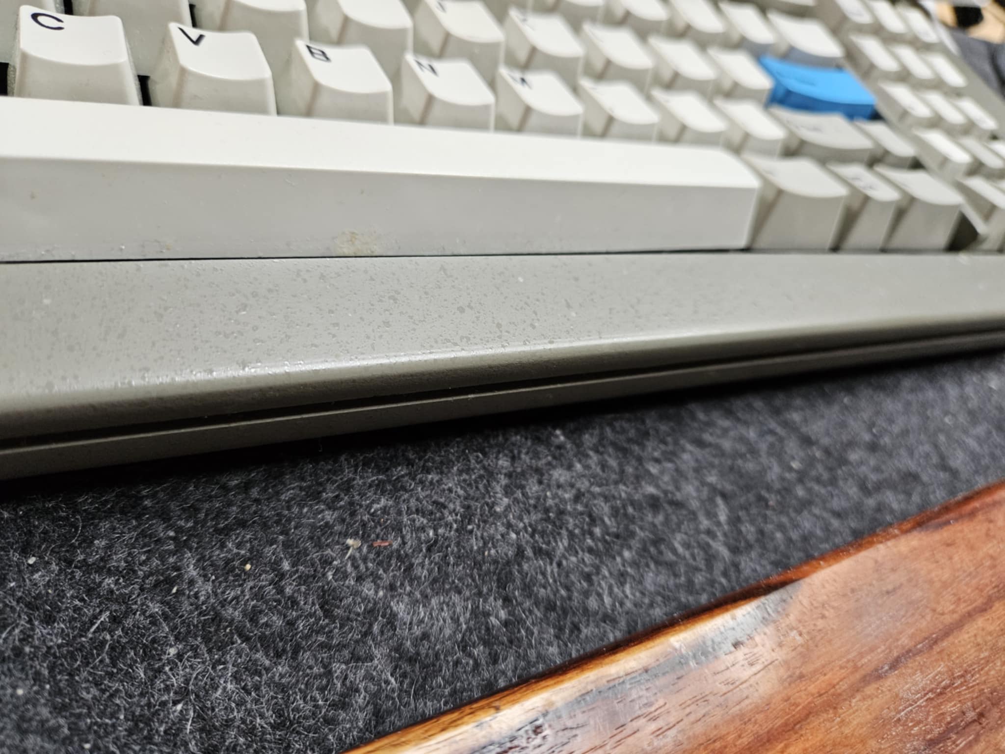

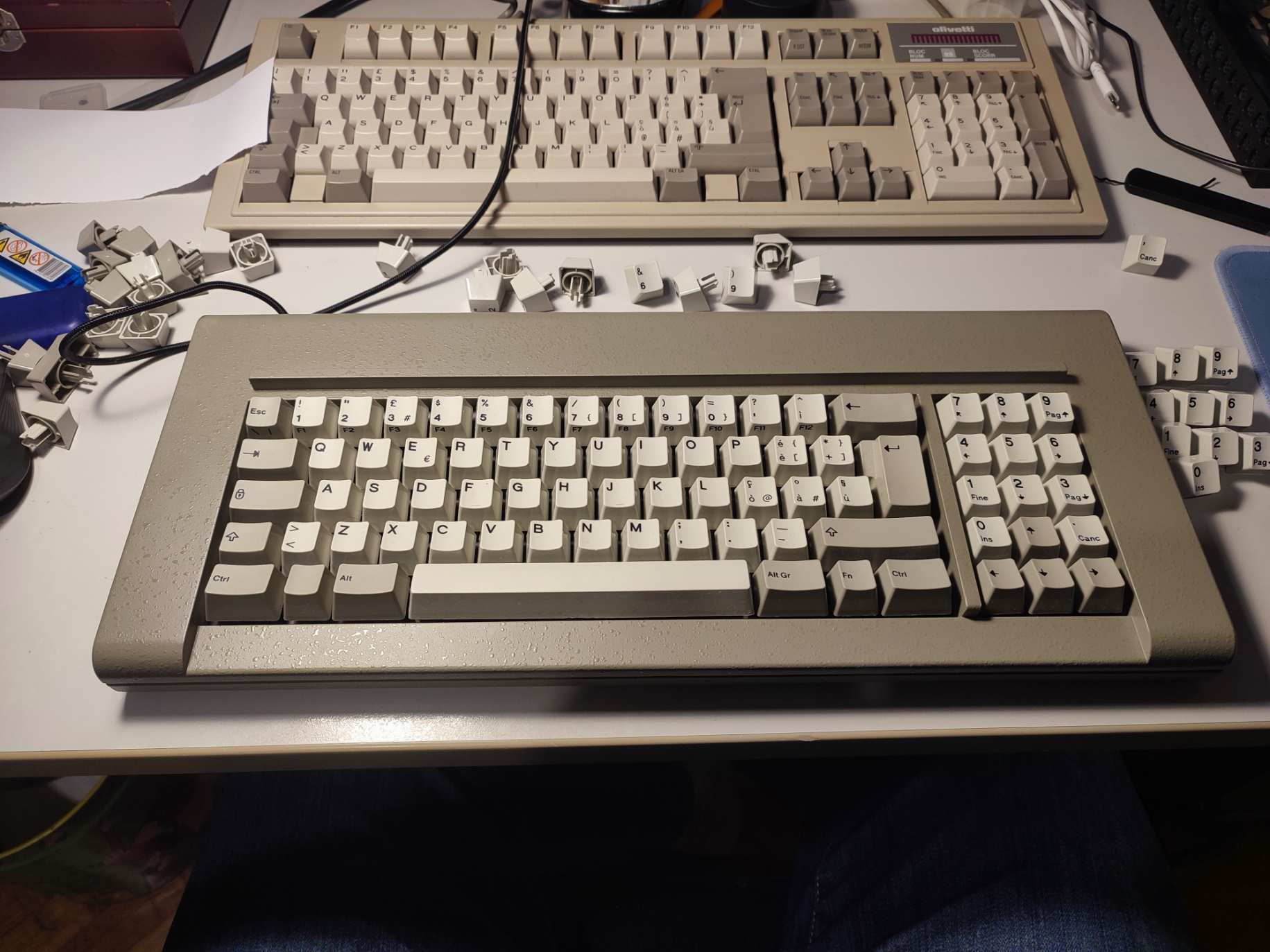

So I'm also having some of those issues with the paint, exactly where my hands rest. As others have said it's like the paint "softened" and melted in those areas, the areas I don't touch, the paint stays intact and hard. The fact I can remove the paint scratching with my nail is pretty lame honestly, I was expecting more durability.
Granted I've used the keyboard daily since June 2020, and my climate in switzerland is not exactly extreme, but I was always wondering if the loss of paint was normal, but I see it's not.
Here are some pics.
https://imgur.com/a/OCHBRbG
Also, I'm quite disappointed with the F104 that I received recently. I had to go back to the F77 as somehow every key felt heavier, scratchier and slightly binding when pressing them off center, and the spacebar spring not being strong enough. I gave it a month of exclusive usage, to see if there is some breaking in, but no, had to come back to the F77, because it was really impacting my typing speed and my typing experience.
Here are some pics.

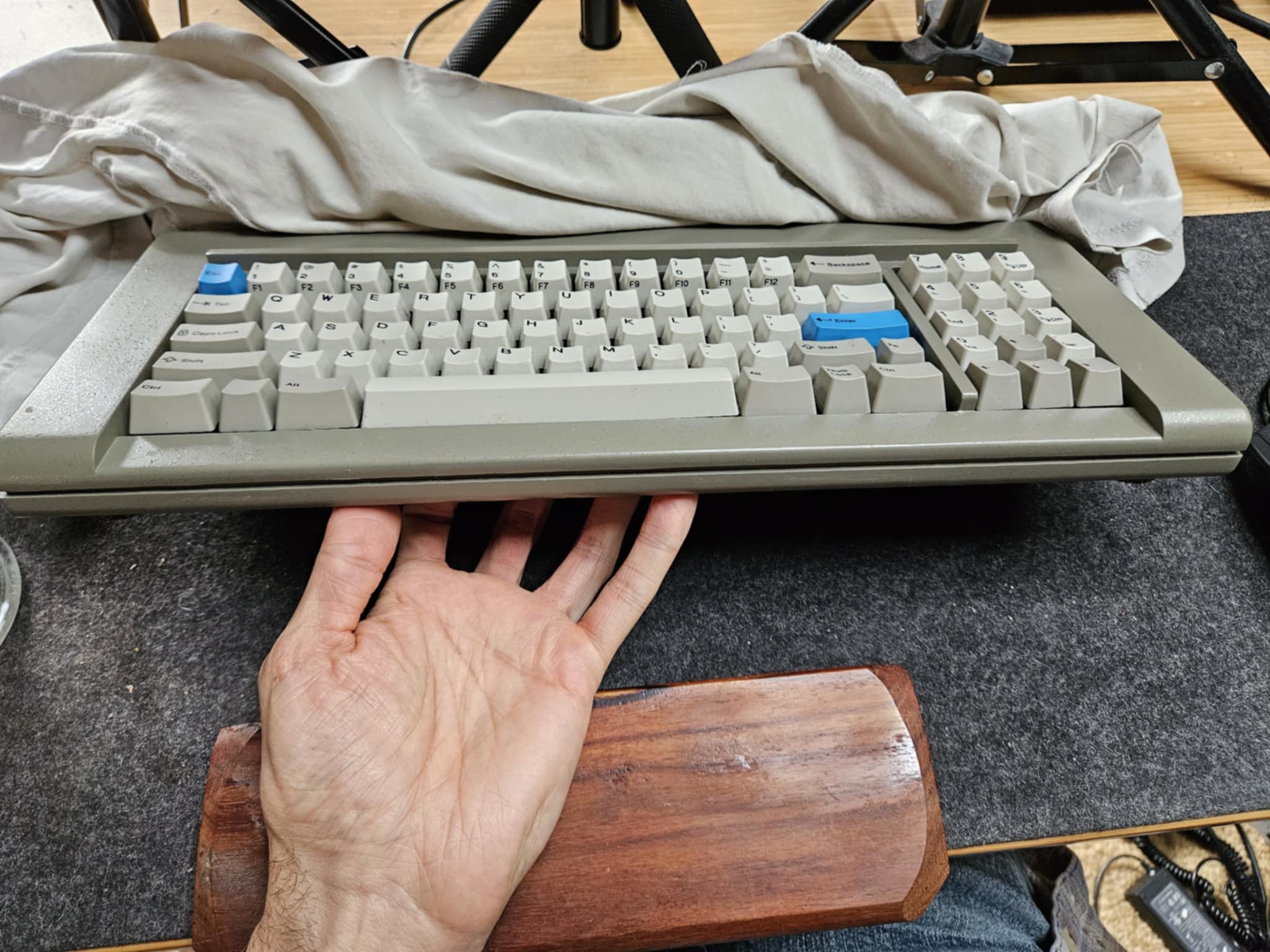

Here's my F77 (first batch). It's been my daily driver since it arrived and the paint finish nearly mint, I even have a wood wrist rest occasionally rubbing against the surface w/out issues. It's a bit dirty but otherwise in great shape.
- 1dfe174a-99ac-4bc4-96b6-89b28b43069d.jpg (223.96 KiB) Viewed 15111 times
- cc3b4f93-f1be-4b77-b015-87727377ac09.jpg (290.4 KiB) Viewed 15111 times

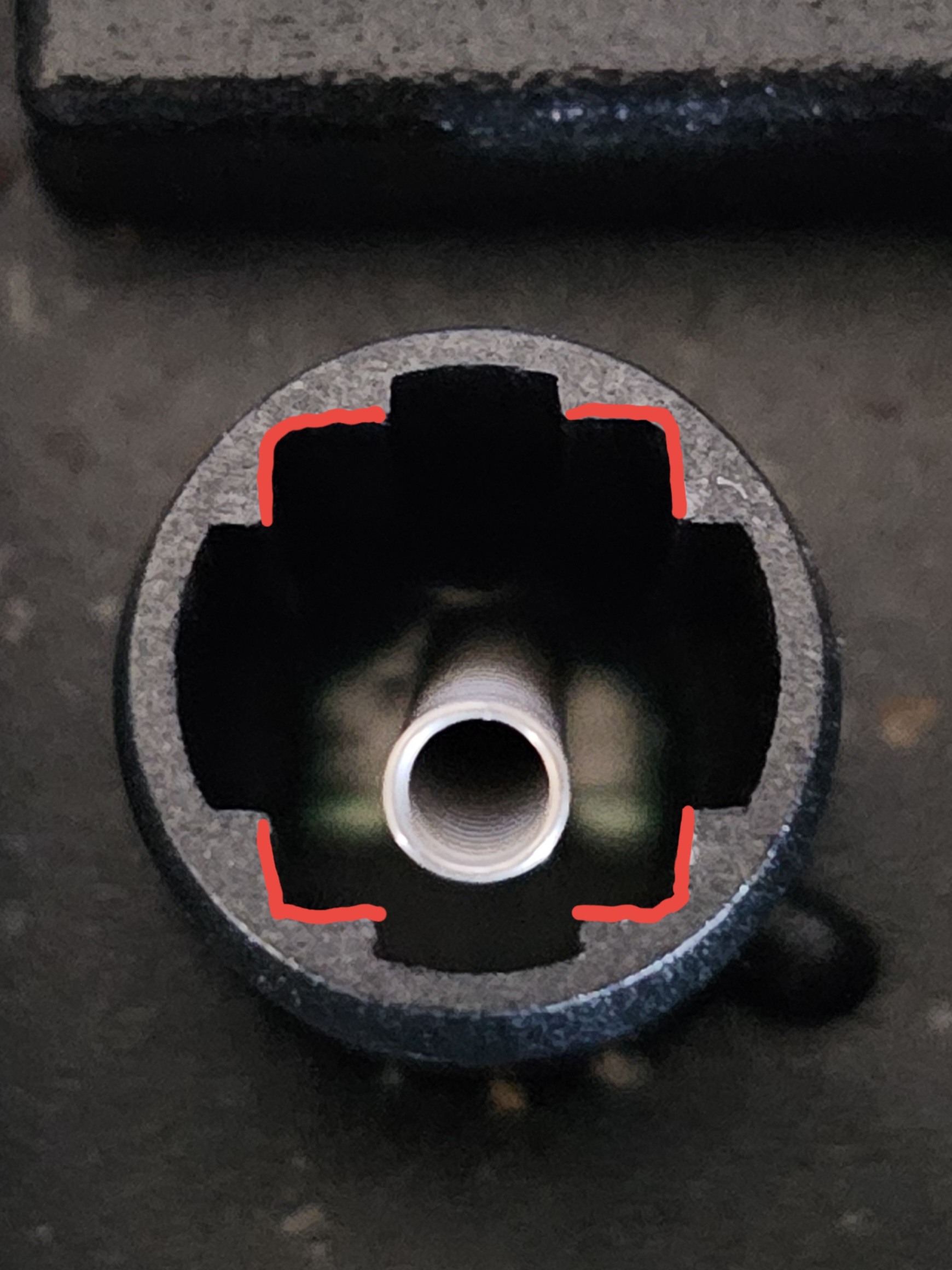

Crud. Feeling like a bit of a special case here.mbarszcz wrote: 15 Feb 2025, 21:17 YALE70, I gave your flat head screwdriver a try on my "E" key which is one of my worst, but it didn't seem to make any real change for me. I do see the light colored wear "dust" in the same place as you though.
Just in case, and because my original pictures are probably somewhat unclear, I marked the suspect edges in red. I just ran the screwdriver blade up and down along each of those edges at a 70-80 degree angle - that way you're not drawing the jagged edge into the barrel. Not sure about the rough number of passes, but I just do each corner equally.
Again, there's certainly more to it based on the more recent evidence from other folks, so ymmv.

Volkovich_ paint wear has been reported on zinc cases and has been discussed for the past few years, though it seems to affect certain folks more than others.
Years ago the powdercoating paint formulation was changed for all other cases (compact F62/F77, Model M style cases, beam spring cases) to make it more modern-looking and less of the old style texture. Paint wear over time has not been reported as a widespread issue on these other cases with the newer formulation.

YALE70 are you trimming the top of the barrel or the entire length inside the barrel, where the key stem makes contact? If the mold has worn a bit, it would make the inside area of the barrel slightly smaller which may increase friction (I have reported this possibility to the factory for analysis).
- YALE70
- Main keyboard: Model F Labs Classic F104
- Main mouse: MTE / Razer Basilisk V3 Pro
- Favorite switch: IBM Capacitive Buckling Spring
Just the topmost edge. I'm not actually removing any material (as far as I can tell), just smoothing out what to me feels like a slight burr on those edges that I marked in red.Ellipse wrote: 18 Feb 2025, 01:54 YALE70 are you trimming the top of the barrel or the entire length inside the barrel, where the key stem makes contact? If the mold has worn a bit, it would make the inside area of the barrel slightly smaller which may increase friction (I have reported this possibility to the factory for analysis).

So I have two F77 that I've had for a while. One almost three years and the other one almost 2 years.
One came in very good condition while the other one came quite brutally beaten up by the shipping. The keyboard itself was quite intact, but a big bunch of the keycaps and springs were crushed but Joe was kind and sent replacements for these.
Now that I've used the beaten up keyboard a while, it doesn't "feel" as good as the first one.
I guess all the springs and caps were slightly off. It's been almost 2 years now so I just have to accept it I guess. The keys on the second keyboard are just more "scratchy" and not as smooth as on the first one. The left shift for example I have to press in the center for it to actuate. If I press it in the corner, it doesn't want to go down.
I've noticed that the color now gets loose (discoloring) on both of them. It's on the place where my hand is resting.
Keyboard #1
Keyboard #2
Not living in the warmest or most humid of places (Sweden).
Anyone has suggestions of what can be done? Don't feel like doing a total repaint of them. Maybe someone has some good ideas as I cant' be the only one with this problem?

Yes, as I mentioned over email, it is expected that the uncoated original style paint will wear where it is rubbed during contact. To keep the project's goal as a reproduction of the IBM originals, the paint has no glossy automotive style protective finish.
Several years ago I changed the paint formulation for a less historically styled, tougher modern powdercoating which currently has an excellent track record of little to no wear (this formulation was first used on the die cast compact case F62/F77 cases, while the very first production run from 2019 used anodized cases for the compact cases). The original F62/F77 project's remaining keyboards were not discarded and will probably sell out over the coming months.
We discussed your issue with some keys having chipped stems at the bottom and those keys being the ones that required more careful on-center pressing - I don't think you caught all of them from the originally damaged batch but I noted that I am happy to replace the broken keys with the order you were placing. Broken keys should not be used.
Why not switch all the keys from one keyboard to the other to see if what you call the scratchy keys are due to the keycaps or due to the barrels? I suggest using them for a month or so before evaluating.

Is there a way to know whether which paint formulation my keyboards are using?
I made an earlier post about it, it seems the texture of my paint coatings is vastly different between the two keyboards:
The upper is my "old" keyboard (serial number 6xx) and the lower one is the new (serial number 9xx).
Switching the keys is a good idea. Only problem is that the keyboards are 800km apart from each other (using them in two different locations).
All the zinc case boards use the same uncoated old style powdercoating. The textures vary with each keyboard but they are the same paint formulations; just the bumps are different.

With permission I am posting a great review and photos of the classic style F104 keyboard from last month:
"First of all, I cannot thank you enough for the time and effort you’ve put into designing and developing the Classic Style Model F keyboards. It’s truly a blessing for IBM and keyboard enthusiasts alike.
Here’s my experience with the Classic Style F104 Model F Keyboard after using it for a few months:
I’ve been a long-time IBM Model M enthusiast, user, and screw-and-bolt modder, so I have a deep appreciation for these keyboards. When I first tried the Classic Style F104 Model F Keyboard, it was an entirely new experience, unlike anything I had encountered before. The keystroke, touch, feel, and overall typing experience completely blew me away. This keyboard is on another level, and I never realized just how incredible the Model F typing feel truly is. The metal case is the icing on the cake, it’s like a dream come true. Once again, I can’t thank you enough for making this possible.
I also decided to keep my original Model M keycaps, as I prefer the smoother feel over the newer, rougher texture. The solenoid was successfully installed, but despite the detailed instructions, I couldn’t find an option to control the power/intensity. Ideally, I’d like a slightly softer solenoid actuation. If there’s a way to adjust this, I’d love some guidance.
Your hard work is truly appreciated. I am very pleased with the product.
P.S. I also bought a third-party silver label, I think it’s a nice touch!
Best regards"
