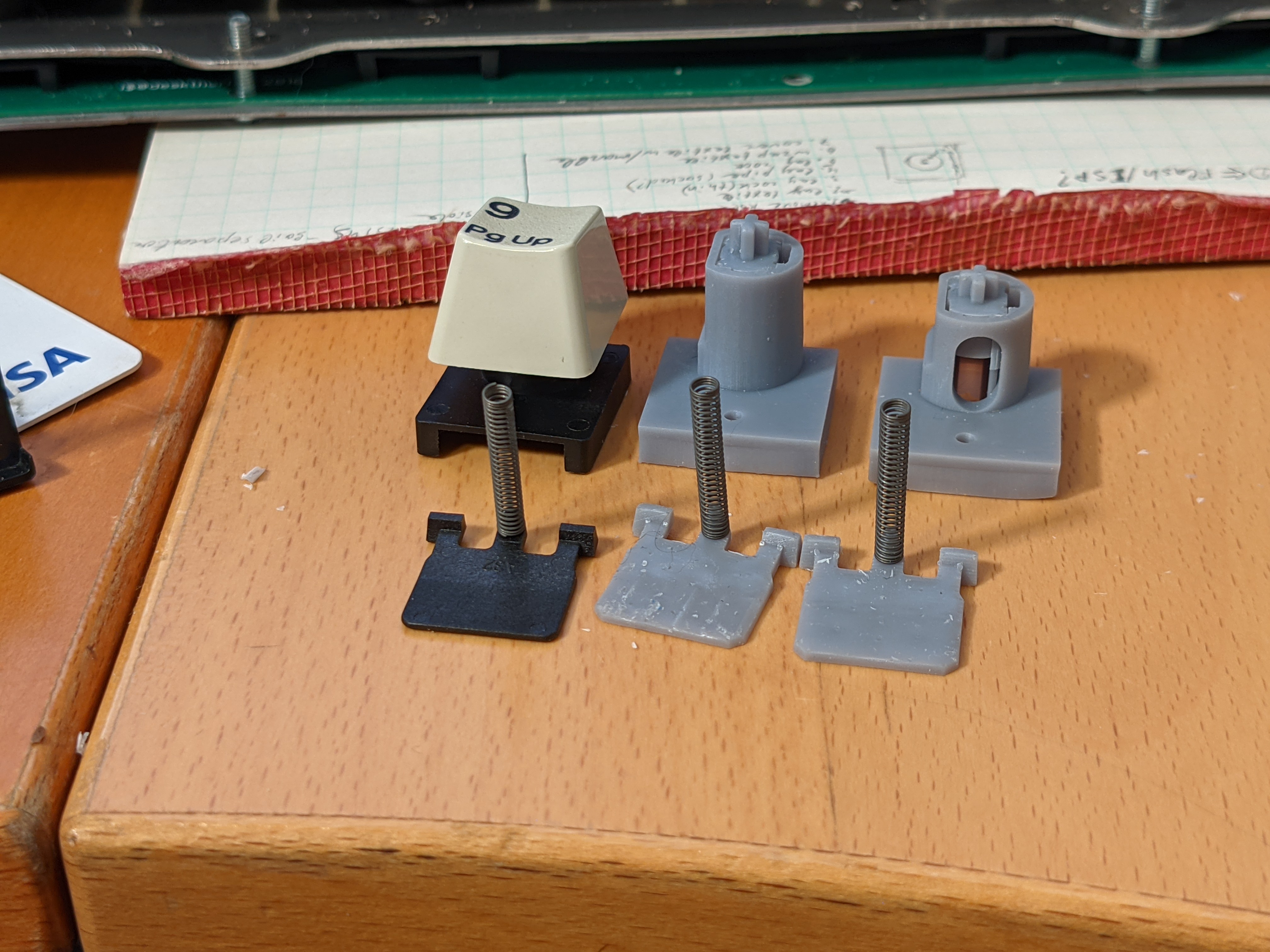

Current issue list:
  1. Stem barely fits into the barrel. It does fit into OG barrel pretty OK - not too wobbly, not too tight - but it's too tight with printed barrel.
    This is likely overexposure (I accidentally printed with 2.0s exposure, not 1.9s that I found ideal yesterday).
    Also, due to layers perpendicular to Z-axis, printed-stem-on-printed-barrel produces funny buzzing sound. There _is_ some binding, but surprisingly little.
  2. It clicks. Once. Doesn't return to original position.
    It does return to original position with printed stem. Sound and feel are pretty close to original, less pingy.
    It also kind of returns to original position with printed flippers - they do go up, but sound after the first click becomes pretty quiet AND it looks like the spring doesn't "unbuckle" into straight configuration.
    So it looks like it's both spring upper point is little bit too low, and spring lower point is a little bit too high.
  3. spring holders are a bit too large, had to file some plastic off. Could also be overexposure.
  4. Unlike Cheap Chinese Copies, one doesn't need to pay attention how stem is inserted into the barrel - the spring finds it's way onto the in-barrel catch automatically. I'm quite proud of solving that.
Turns out I don't even need rafts - landing bare supports onto build plate should be enough (they will be held in place by elephant's foot) - but I need a bit more supports to prevent sagging of large overhangs.
Also, I already bought some transclusent ABS-like resin, but I just understood I can simply cut windows into model instead - it's not injection molding, I can cut windows wherever I please _before_ printing, not after. Transclusent stuff should definitely help bringing more light in though.
Not sure if I should preserve those first prototypes for some museum - or even for the future shop LOL. "One in Stock! Brand New in Box FSF Barrel And Flipper Prototypes, part 101 or 102"

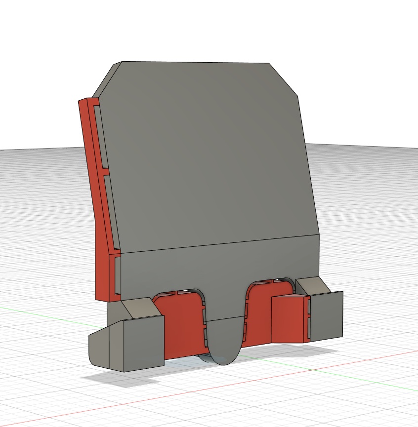

It looks to me that you can modify the flipper model so that it is printable in vertical position without support. Align the two side-tabs and the spring holder to one plane which will be touching the build plate when printing. Print vertically. This way you can also print much more tabs at once.
You can cut about 20% (along the cylinder axis) from the cylindrical spring holder so that you can put it on the build plate with this cut. Modify the side tabs so that they end in the same plane as the cylindrical spring holder cut.
You can print at least 30° overhang quite easily. 0° overhang being vertical. Using this overhang should be enough to get the axis of ration at the proper places even when the side tabs and the spring holder pin are modified.

vvp wrote: 01 Feb 2025, 12:29 It looks to me that you can modify the flipper model so that it is printable in vertical position without support.
That's easy - just rotating the model 90 degrees will do. Some supports will still be needed (because 0.35mm will be squashed and elephant-footed, and I want to actually use the final model for the injection molding without gross modifications), but way less plastic will be wasted. However, I'm not at the stage of mass printing yet (and hopefully never be - injection molding is just better), and printing the flipper bottom parallel to XY plane has it's advantages (like, it's actually flat when printed, not micro-grooved. I'll try to print a copy in vertical position as a part of the next batch - not yet gotten there between oncologist visit and other errands).

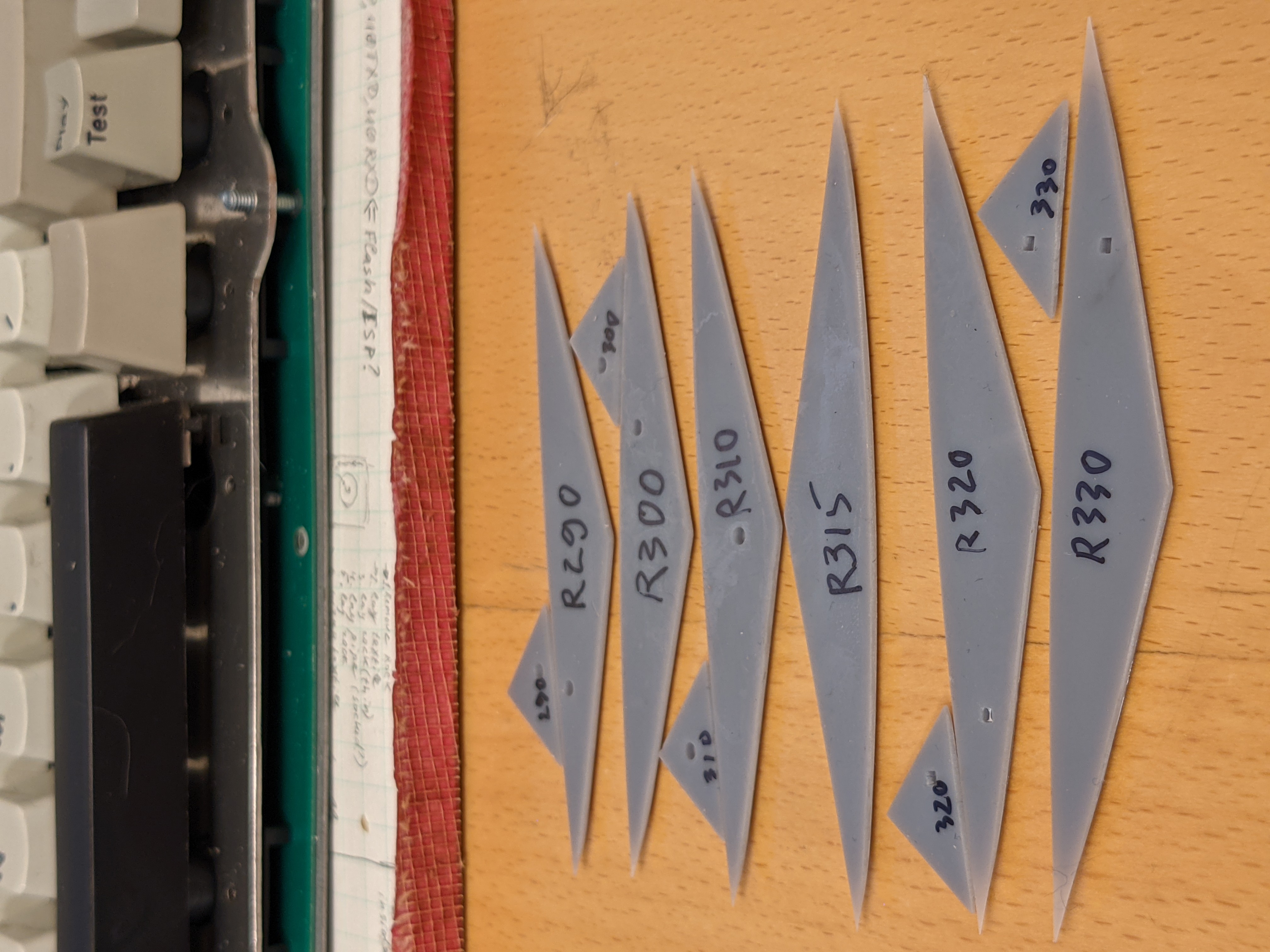

I accidentally silent buckling spring. Sadly, it's LINEAR.
Turns out, tactility turns out to be generated by flipper dropping on PCB and vibrating the hell out of the whole mechanism.
You may notice there's a window where the spring SUPPOSEDLY hits the barrel. SURPRISE, that doesn't affect the sound that much - OG flipper clicks quite loudly, 7-degree and 5-degree flippers barely produce any sound. So, the "spring hits the barrel makes model F loud" hypothesis can be safely retired.
As you can also see, I was able to chop 3mm off the barrel and stem. This still makes the barrel 15mm high, 3.4mm higher than MX switch - meaning, in turn, that using existing MX keyboard cases will not be possible without shortening the spring.

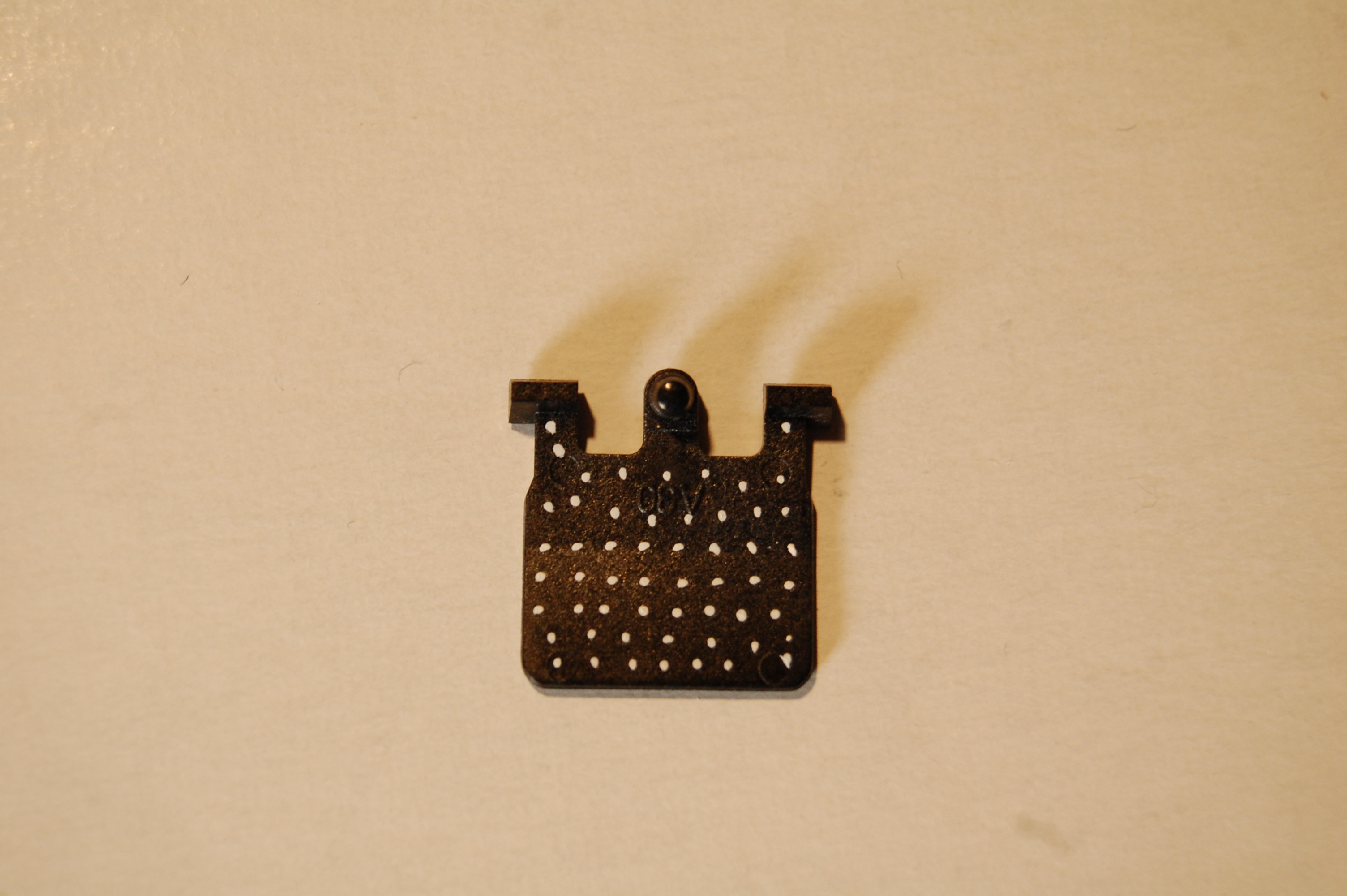

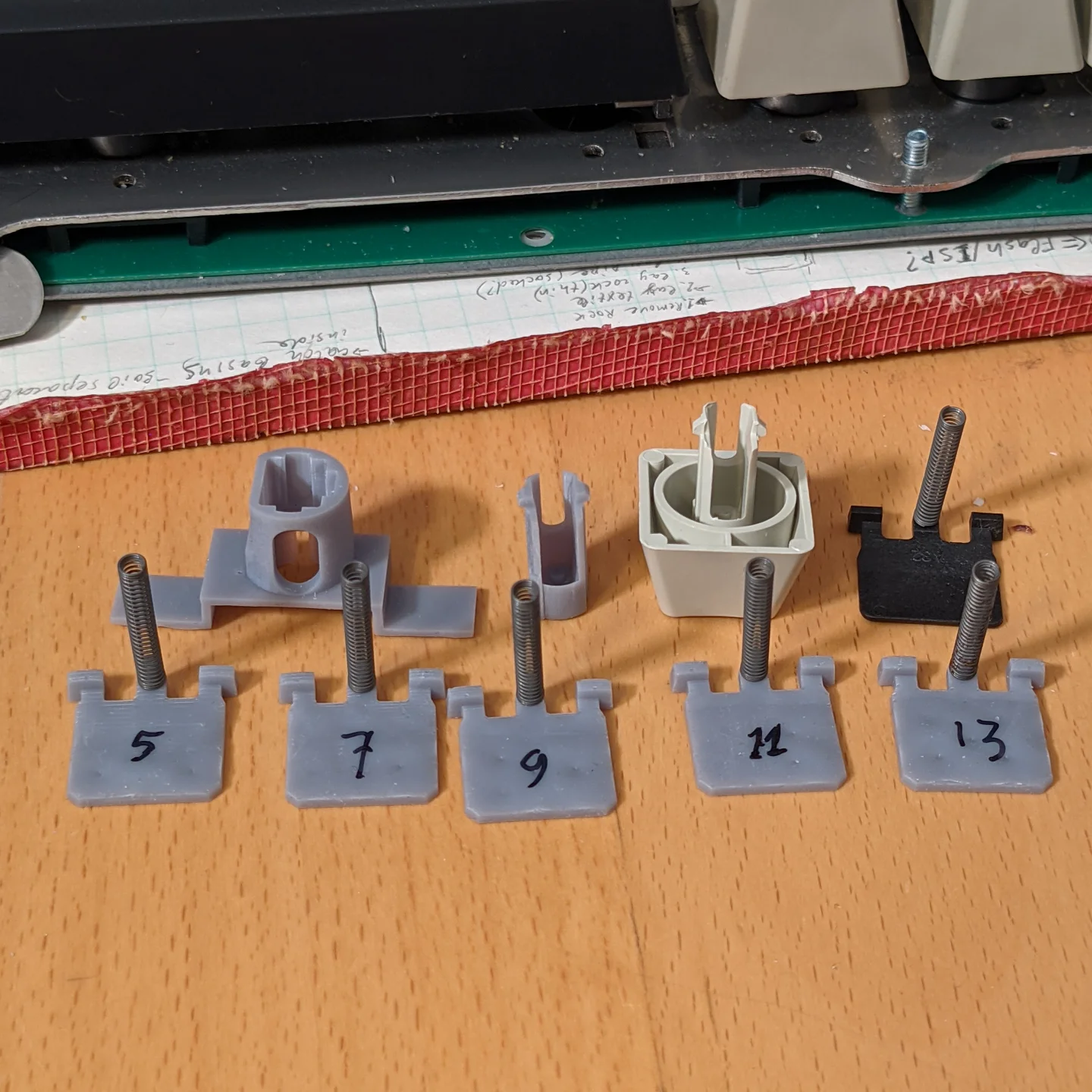

Batch 3 was ruined by washing in the hot water on internet advice. So here's batch 4:
numbers are elevation at rest, in degrees.
5 is whisper-quiet, but also almost linear feel. The spring is buckling, don't get me wrong, but almost imperceptible, even with original barrel+stem. Rarely: flipper goes down before spring buckles.
7 is the weirdest of them all - flipper frequently goes down before the spring buckles. Also very quiet.
9 tends to stick pressed.
11 - half as loud on downstroke, upstroke is still silent.
13 - probably 75% loud, upstroke probably half as loud (but still quieter than downstroke - originals are louder on upstroke if you're not MASHING it)
Looks like I need to look more closely to the feet part - looks like even 0.1mm difference in spring height matters.
Almost dialed in interchangeability of barrels and stems with IBM barrels/stems - not that they'll be used together, mostly to be able to tell they'll actually fit together.
Also, in light of the barrelgate, looked more closely on model M barrels from Unicomp. They definitely put some effort into not having parting lines where stem can contact them!

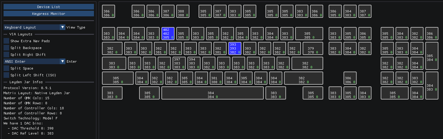

I must report success !!
I have been silently working on the 3d printed flippers using the conductive filament which I bought in amazon: EONO Electrically Conductive PLA Filament
Flipper 11.jpg (122.26 KiB) Viewed 10726 times
This is literally the first text which I am typing using a regular model m, using the FEXT PCB, a Leiden Jar and my 3d printed flippers using conductive filament.
The keyboard which I have used has a particularly bad barrel plate. This was a very bad decision as it has taken me long to ensure that all the keys register properly. I believe that now that we know that it can flippers can be 3d printed, the next step is to replace the original ones which I am using in my FSSK :)
These flippers are less conductive than the original ones. I had to reduce the threshold in the Leyden Jar firmware. I am typing with activation offset of 7 (instead of the 20 which I have been using with my "regular" FSSK.

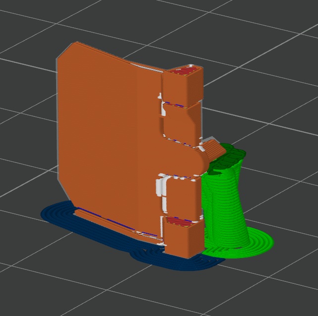

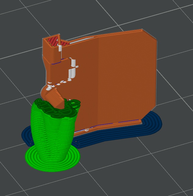

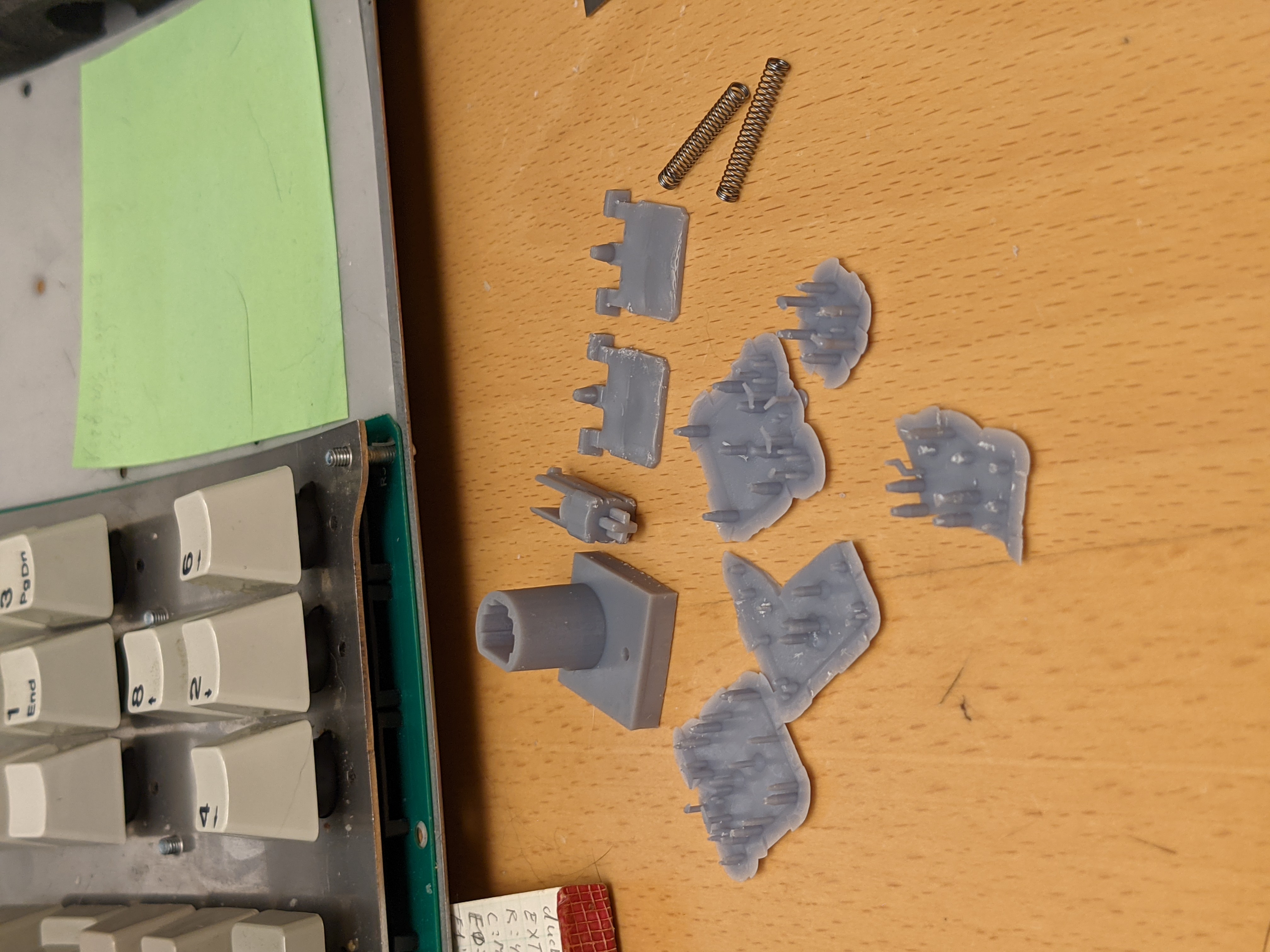

Printing the complete keyboard was less than 3 hours.
I had print the flippers lying on one side, to ensure that the spring pressure is done along with the layers, so it does not break. In order to print efficiently, I designed my own support in the 3d model.
Flipper 11 -printb.jpg (70.16 KiB) Viewed 10726 times
Flipper 11 -printa.jpg (63.47 KiB) Viewed 10726 times

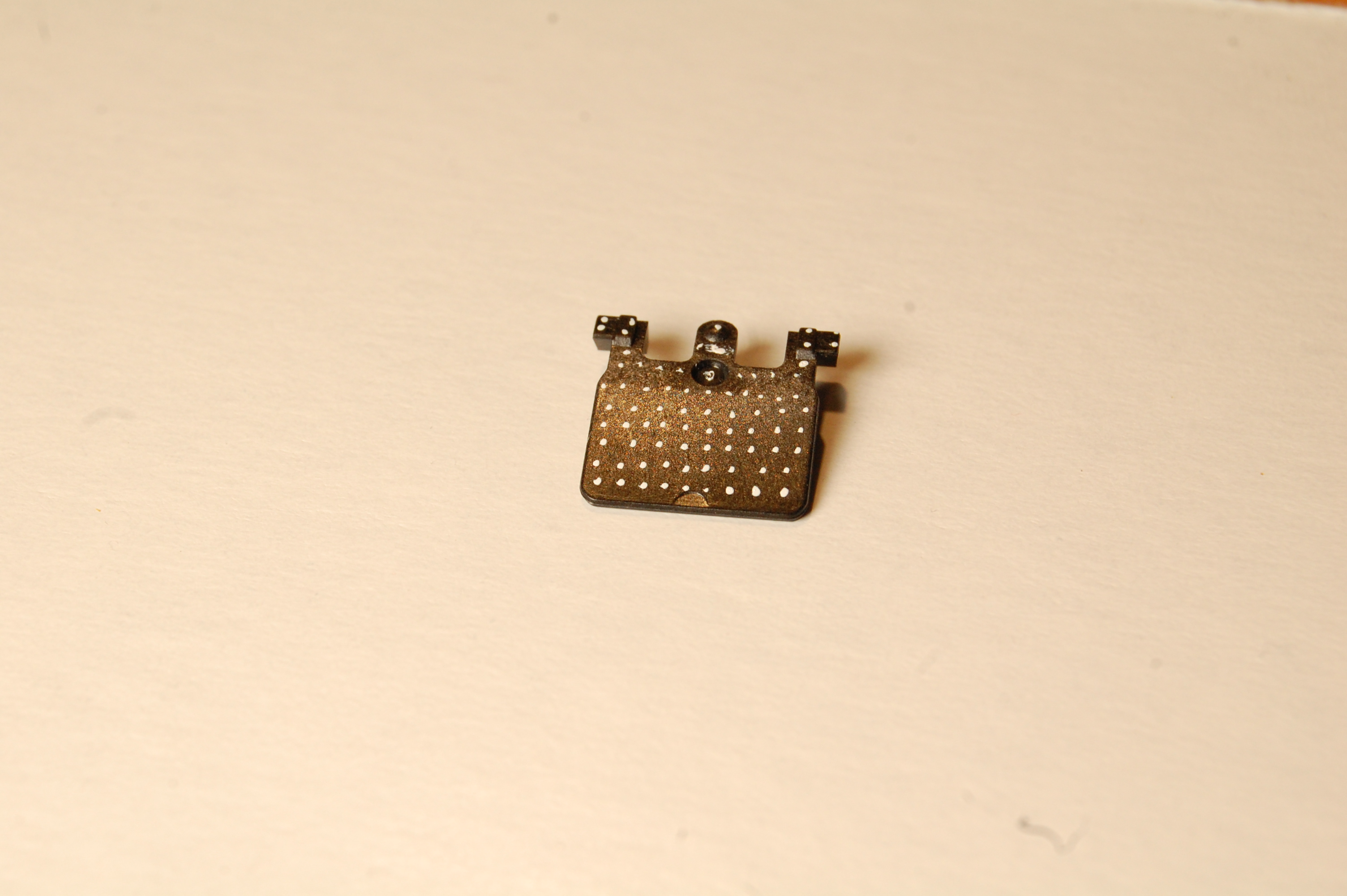

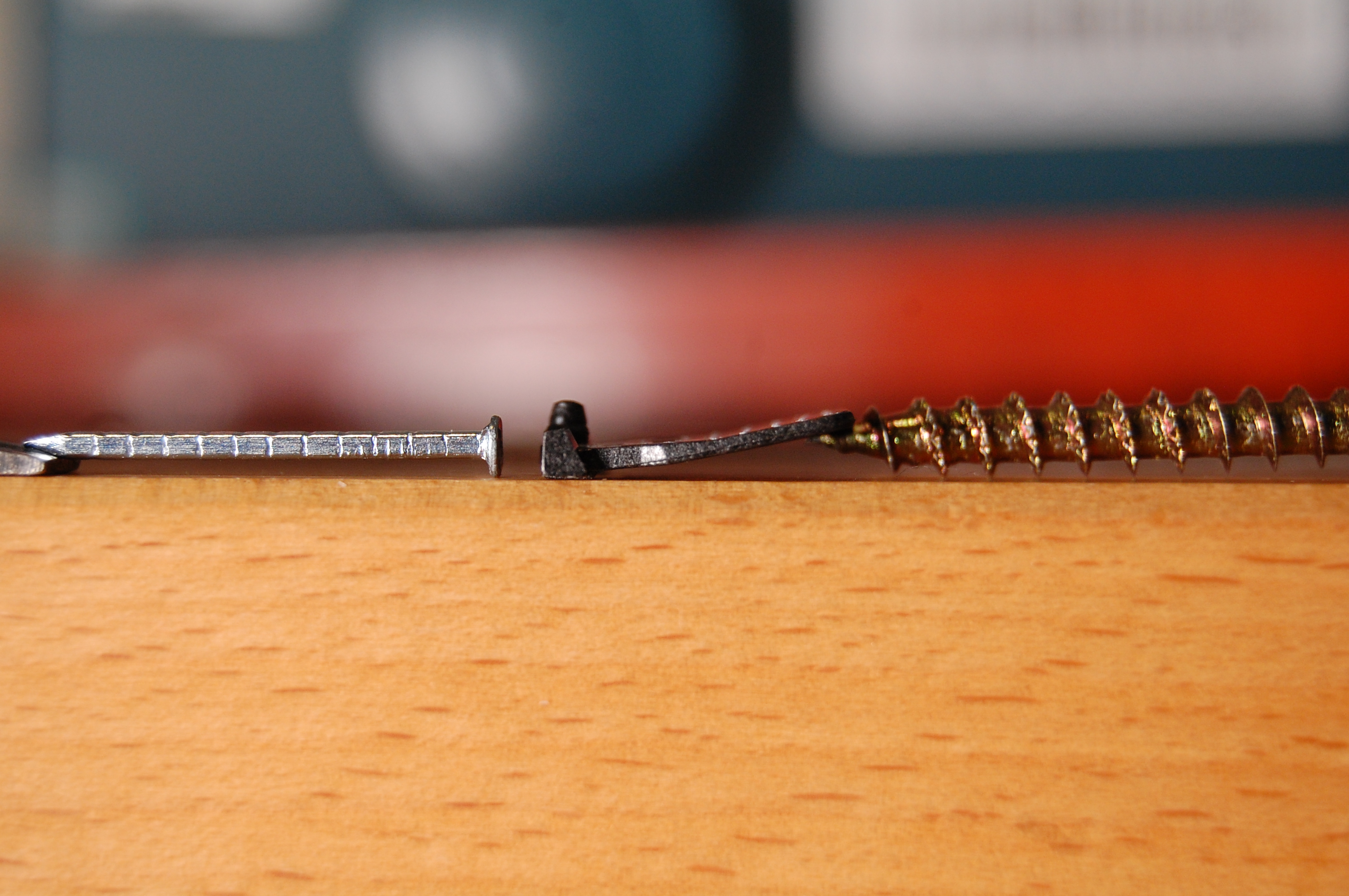

The "less conductive" part might be because OG flippers underside is actually not flat - it's a cylinder with some huge radius (I tried to figure out that radius from photogrammetry, but the photogrammetry effort failed miserably, so I'll try to deduce that radius from plain old photographs and counting pixels.), and your model appears to have a flat bottom.
Flat bottom over curved plate will result in a PCB contact patch being one or two narrow bands instead of a theoretically large rectangle with curved flipper.
There's no good way to compare - if you compare on a PCB laying flat on the table, printed flipper should get ahead, if inside actual keyboard - OG flippers should get ahead, and there's really no way to put them into "apples to apples" situation.

Finally, let me say that there is some manual work needed to clean each and every flipper.
  • Removing the quasi-square support it is simple with small pliers.
  • Getting rid of the lower long support is more difficult. I need to improve the interface between the support and the flipper.
  • The pin holding the spring needs manual cleaning. This is particularly bad; if one "cleans" (cuts) too much, the spring is lose with the associated impact. I am thinking on replacing the self computed support with my in-part design (red parts). This will allow to reduce the amount of filament used, reduce the manual processing and improve the interface with the spring.

DMA wrote: 14 Feb 2025, 04:40 The "less conductive" part might be because OG flippers underside is actually not flat - it's a cylinder with some huge radius (I tried to figure out that radius from photogrammetry, but the photogrammetry effort failed miserably, so I'll try to deduce that radius from plain old photographs and counting pixels.), and your model appears to have a flat bottom.
The resulting part is less conductive. It is a fact.
It is also factual that with the right adjustment in the DAC threshold it works. I keep typing this text with my test keyboard :)
As I already said before, there are some adjustments that can be investigated:
  • Increase the thickness of the "flat" part of the flipper
  • As you said, shape it as a section of a cylinder
  • But we can go further, what about designing different shapes for different sections of the keyboard ? I have noticed that the flippers in the middle row register lower values (to be confirmed with the oscilloscope). It should be possible to design different flippers which adapt better to this "difficult" part of the keyboard.
I will post pictures of the full process, in the form of a manual/tutorial, to allow everyone to 3d print, process and install the flippers in their model m :)
I just need to find the time. This weekend is already fully booked with activities. It will need to be next week.
Note addressing those who just take ideas without offering any idea nor solution (no need to address the individual as he knows his name):
thanks a lot for all your missing support in this journey. You can now continue misusing DT for your sole benefit. Do not worry, you will be able to steal the ideas and share no benefit with the author. I just hope that the new border tariffs battle help in your business :)
After reading the above, you may continue with your great contribution to destroy this place, where some others share information in an open manner, for the benefit of the community.

idollar wrote: 14 Feb 2025, 08:16 [*] The plastic barrel plate had big holes where the screws had to come in. They would not create any pressure, leaving the plastic barrel plate lose at this very point. I used some filament and heat, applied with a cheap solder, to first fill the hole to then drill (with a dremel) a new hole.
There's a thing called "3D pen" - which is basically handheld FDM printer extruder with a manually operated filament feeder. Should be ideal for this - with less burning plastic smell at least :)
idollar wrote: 14 Feb 2025, 08:16 The "less conductive" part might be because OG flippers underside is actually not flat
I wish to retract this. Spent couple hours today trying to make a high-res photo - which I actually made, see below - only to find out that that cylinder radius is HUGE and only noticeable in how light reflects from the bottom of the flipper, actual non-flatness is like 0.01mm over the flipper area
While I was writing this down, it occured to me that I actually have a resin 3d-printer with supposedly 16x24um horizontal resolution and so I can just print curvature gauges (because I have some idea about said curvature radius being around 300mm) and measure by simply putting two parts together and looking at it at magnification (being old sucks, damn presbiopia). Sure, not NIST-traceable, but should be good enough.
idollar wrote: 14 Feb 2025, 08:16 The resulting part is less conductive. It is a fact.
Original flippers are not conductive at all. Their surface resistance is >20MOhm/mm, that's well within insulator territory (I have a megohmmeter, but it's currently broken, so I can't currently measure more than 20MOhm.). Your filament is advertised at 7 ohms/cm - you can check actual resistance by sticking multimeter probes into it 1cm apart (and if it displays "O.L" - 1mm apart).
Lower levels might be because flipper's bottom surface isn't smooth enough - which can be rectified by sanding OR just sliding the flipper over the flat part of the iron at "wool" setting (careful about melting flipper legs and burning fingers!) - probably wrapping the flipper in tracing paper to prevent it sticking to the iron and melting completely.
idollar wrote: 14 Feb 2025, 08:16 [*] Increase the thickness of the "flat" part of the flipper
supposed to be 0.8mm. But may result in LOUDER CLICKS, so why not!
idollar wrote: 14 Feb 2025, 08:16 [*] But we can go further, what about designing different shapes for different sections of the keyboard ? I have noticed that the flippers in the middle row register lower values (to be confirmed with the oscilloscope). It should be possible to design different flippers which adapt better to this "difficult" part of the keyboard.
Backplate curvature not supposed to change.. I have one laying around (in fact, typing on it now) - so I'll be back after I print those curvature gauges.
idollar wrote: 14 Feb 2025, 08:16 Finally, let me say that there is some manual work needed to clean each and every flipper.
This isn't really much of a problem with 3d-printing flipers for oneself. May be even considered a benefit, when stuff is too easy people don't value it that much :)
Seriously though - I would consider reducing cross-section of the points where support touches the part itself, and reducing overhangs - say, by making the part "v"-shaped where it contacts the support. Supports don't have to be thick, especially in FDM world.
PS: photogrammetry attempts made me semi-ruin one flipper (I think I'll be able to clean it, but..)

Just a quick post to state that I keep typing with my 3d printed flippers.
The firmware of my keyboard needs some adaptation (the layout of the keyboard that I used is ANSI). There are two keys which need some adjustment, probably because the back screws are too tight. Otherwise, it works as my other FSSK/FEXT keyboards.
I believe that after some testing, we will have a solution to transform our model M keyboards into model Fs.
In the meanwhile, I have received some new FEXT (x10) and FSSK (x100 PCBs. I updated the FEXT to avoid the issue with the hole.
I will post about this, adding some pictures, as soon as I find the time.
Cheers

This is a set of convex and concave curvature gauges, R290 to R330. R315 is there because value calculated from the whole backplate gave me R315.
Turns out, the keyboard part (R2 to R6) is R310, and the upper part is >R330, may be >R400 - at least on my model M backplate. I have XT, AT and F122 backplates, but my lifting restrictions currently prevent me from accessing those. Expect more results in about two weeks.
Flipper also seems to be most closely matching R310 - so R310 is the golden value I guess (NOTE: that R310 arc must include the pivot point too!)

DMA wrote: 19 Feb 2025, 05:18 Turns out, the keyboard part (R2 to R6) is R310, and the upper part is >R330, may be >R400 - at least on my model M backplate. I have XT, AT and F122 backplates, but my lifting restrictions currently prevent me from accessing those. Expect more results in about two weeks.
Very clever movement DMA! Thanks for the information.
I would like to report my experience with the 3D-printed flippers:
  • Positive: I had no problems with under-sensing keys. All keystrokes are well registered.
  • Positive: I had no problems with over-sensing keys. There is no cross-pressing contamination either.
  • Positive: No flipper has broken. This does not mean that it will not happen. But after heavy typing during a week, it has not happened.
  • Negative: The feeling of the keys is heavier. This is probably due to the reuse of the springs, which means that we need to test different springs.
  • Pending: I would like to take this keyboard apart to check the status after this week. It will help to adapt the 3D design. My intention is to update it to reduce the post-processing of the flippers coming out from the printer. DMA, I can use your measurements above in this process.
  • Pending: I am 3D-printing a "Rock / Print Tumbler": I plan to smooth the flippers in this device to check whether it helps with the key feeling (which is already good).
  • Comment: I can confirm this is not a quiet keyboard. The flippers hit the PCB directly.

OK, I've got to measuring my fleet of Fs.
XT: R290
AT: R290
F122: bottom plate R290 (or slightly smaller), top plate even smaller than R290. NOTE: F122 is the only one that doesn't close with barrels not populated. So this is likely on purpose, to create more pressure in the middle of the plate.
Special guest: IBM 79F0167 AKA 5576-A01 AKA "Brother buckling spring".
flat in R1-R2 area, R290 in R3-R6 area. It _really_ looks like the bend starts under the center of the barrel of the TAB key. JDM is, as always, superior to everything else. It's, like, double-superior, because the bottom part of the case is curved inside to match the backplate, so that backplate rests on 3 "east-west" keyboard-wide rails.
PS: @genericusername57 thanks for the offer, I was able to work around that and result is.. NOT GREAT, to say the least. So it's calipers and patience all the way..
