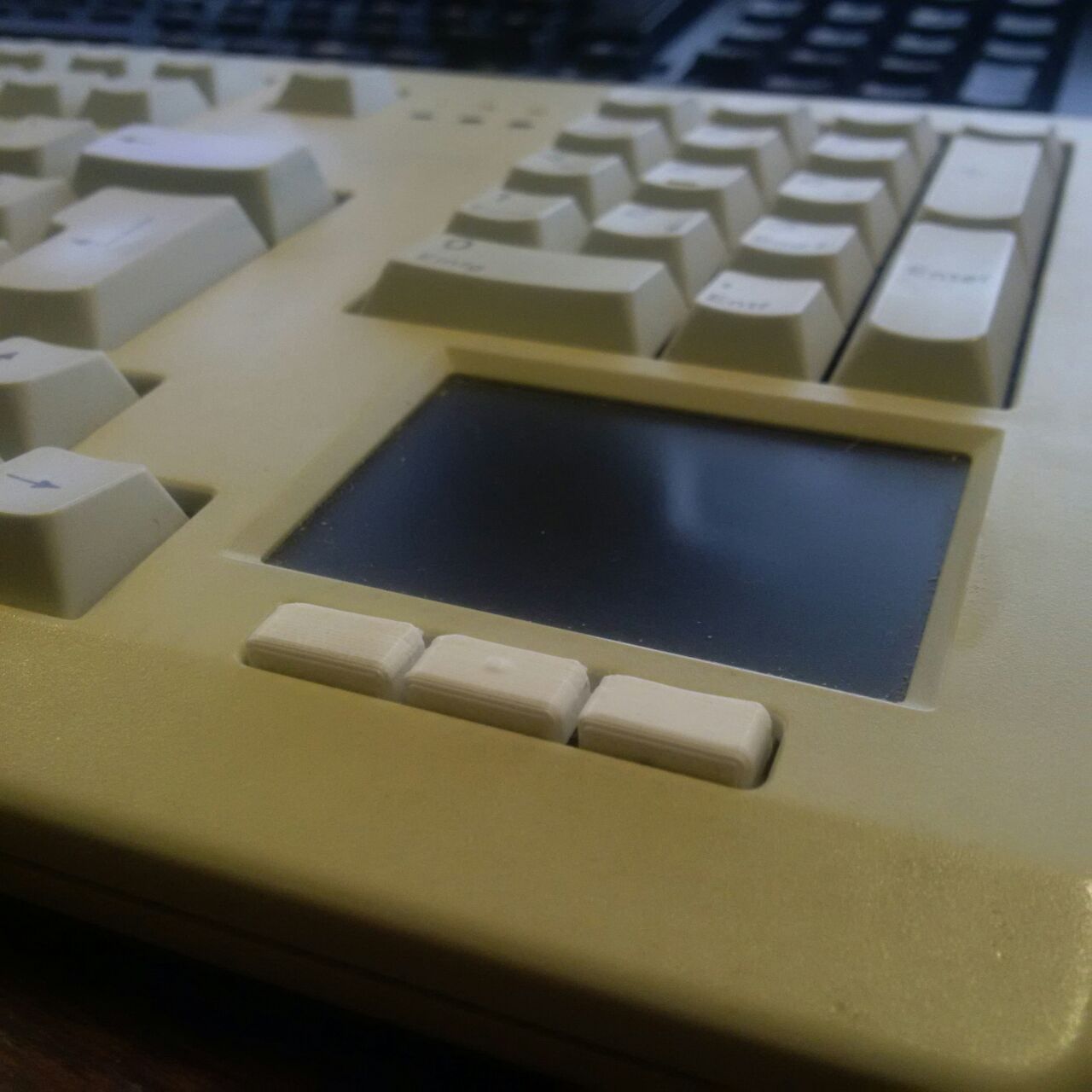

The middle mouse button has a tiny bump on it to help locate it without looking.

browncow wrote: 29 Jul 2023, 22:54 The middle mouse button has a tiny bump on it to help locate it without looking.
[photo]
I don't quite see the use of a bump there, would one not cover all 3 keys with 3 fingers anyway (and feel misplacement at once)?

kbdfr wrote: 30 Jul 2023, 07:26
[photo]
i found that the keys are now a little bit to small to be comfortable, and i often had troubles not pressing the left/right one by accident

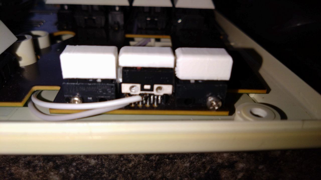

Here's a closeup of the third mouse button assembly with the printed keys/holder. i went through few iterations, thinning out the "hinge" on the keys, because it was way too stiff.
