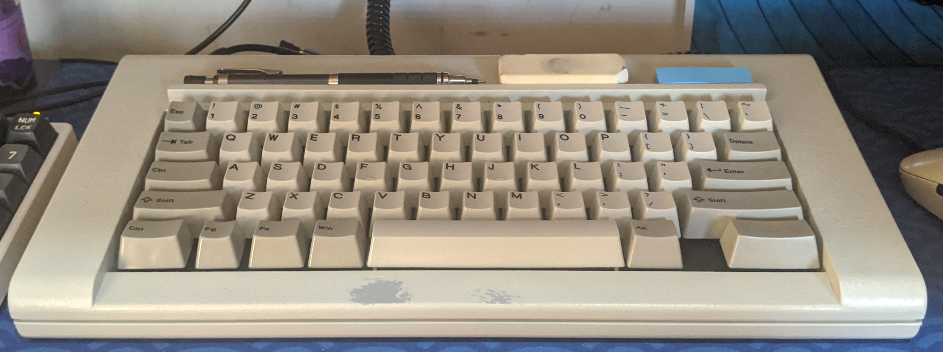

Also below is a photo of one of the aforementioned keyboards that I have been testing and optimizing firmware with; it will be going to a user of the German layout (pardon the cell phone quality): Flashing Leyden Jar - can use Windows, Mac, and Linux (same instructions):
For keyboards with the Raspberry Pi RP2040-based Leyden Jar controller (F122, B104, B122, and others in the future)
Open the Leyden Jar diagnostic tool, which is in a folder inside the comprehensive QMK-layout-files.zip file linked above, click Refresh Device List, and click Enter Bootloader. After clicking Enter Bootloader, an empty hard drive named "RPI-RP2" will appear in your computer's Explorer. All you have to do is copy to this drive the .uf2 file inside one of the leyden_jar_firmware_package folders which can be found in the QMK-layout-files.zip file linked above. There are several firmware variants with different numbers of calibration bins and activation offsets.
I recommend the one with 5 calibration bins and an activation offset of 7. A higher number of calibration bins allows for a margin of safety around keys with different unpressed capacitance levels (for example, if there were only 1 bin then all keys would activate at the same value, but some keys may have an unpressed value close to or higher than the activation level, meaning a key would send a signal to the computer without being pressed. I like to see the pressed value at least 3 higher than the DAC Threshold for that key's bin, and an unpressed value at least 3 less than the DAC Threshold for that key's bin (with capacitive PCBs, a pressed key may change the capacitance of other keys).
Calibration bins allow for different activation levels based on the initial unpressed level of each key when the keyboard is first plugged in. More bins is safer but there is a performance penalty that is infinitesimally small, several thousandths of a second. Rico notes that matrix scans are 3 times faster on the Leyden Jar compared to the xwhatsit controller (720us to scan 18 columns compared to xwhatsit's around 2ms since it is a 500hz polling rate). In other words, 5 bins would be 5 x 720us = about 3.5ms total scan time for 5 bins on the Leyden Jar compared to 5 x 2ms = 10ms for 5 bins on the xwhatsit. The xwhatsit Vial firmware uses 5 bins, so the RP2040 could even use 15 bins and still have approximately the same scan rate performance as the xwhatsit controller.
The default Leyden Jar firmware is expected to have 5 bins and an activation offset of 7 to be more foolproof, but premade firmware files with fewer bins and varying offsets are also available in the above zip file (for folks who want theoretically the best performance that they can never actually notice in real-world usage!). Firmwares with 2 bins may be more likely to have issues with one or two keys sending a signal without being pressed, so I do not recommend them. Be sure to close the Leyden Jar diagnostic tool before using Vial.rocks or the Vial software.

I've got an update regarding my warn paint.
Three months ago I received a replacement case for my f62 because the paint did not last at all. I'm pleased to say that the new case is holding up perfectly. There is no wear to speak off. The paint hasn't softened and rubbed off like my last case. My experience is that there is a difference between the paint in my two cases, despite there being no expected change to the formula.
I started using the first case on the 2024-02-22, and this photo was coincidentally taken exactly three months later on 2024-05-22. I replaced the case on the 2025-01-29 and today on 2025-05-02, a bit over three months later, it's still perfect. The new case is an industrial grey. Both cases experienced their first three months in the summer to autumn months. They were both used full time. They were both used in the same room and neither of them were transported at all.
I'm pleased that my new case is holding up. I'm now of the opinion that the paint on the previous case was defective and there isn't something about me that was causing it to dissolve.

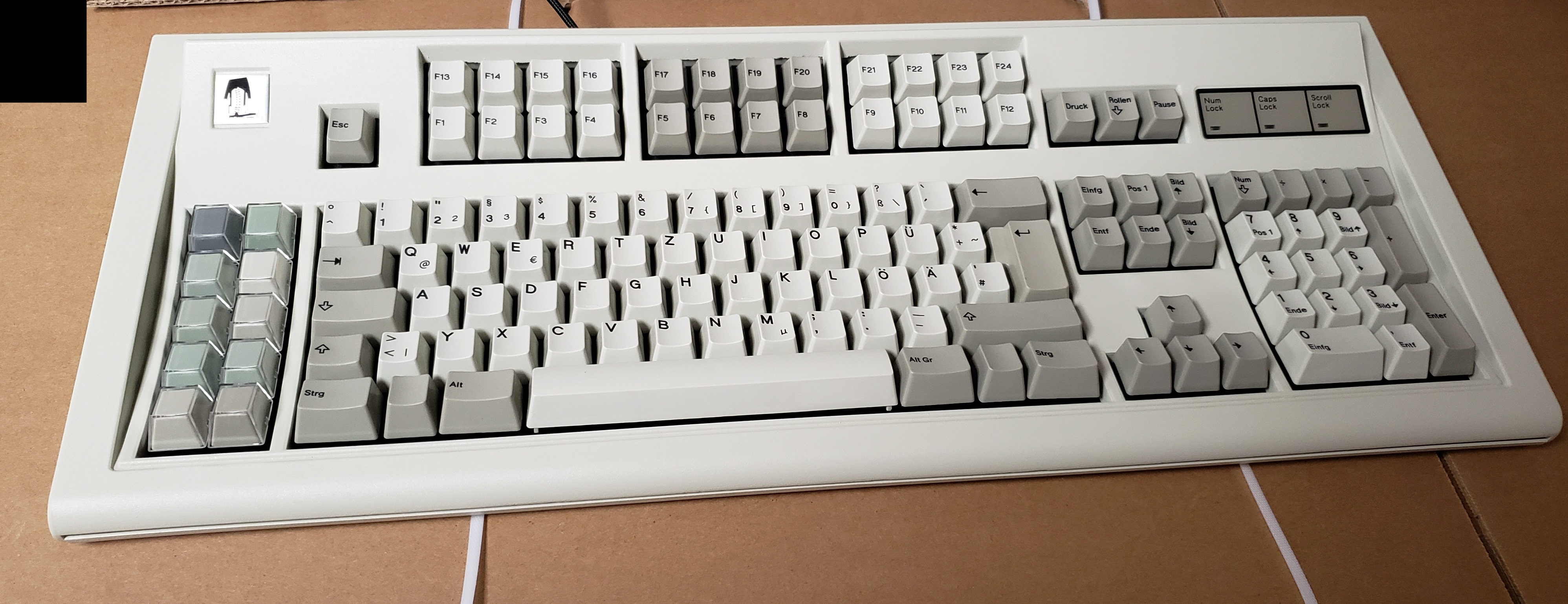

Re. scan time and bins, on my F77 the calibration seems to first put keys into two bins, but it notices they are so close that it moves all of the keys into one bin. The scan time with one bin ends up at 0.63 ms. (I haven't made external tools for the firmware so it has a debug mode where it uses the keyboard itself to "type" this kind of debug info into a text editor. The row data are bit masks of columns in that row/bin – all keys end up in bin 1 at the end but bin 2 shows non-zero rows so some columns were originally placed there.)
Calibration 250 ms
Done=1 Load=1 Save=0 Skip=0 Doubt=0 flags=09
Min = 117, Max = 130, Offset = 20
Scan time 0.63 ms
Bin 0, threshold=108 keys=0
Row 0 0x0000
Row 1 0x0000
Row 2 0x0000
Row 3 0x0000
Row 4 0x0000
Row 5 0x0000
Row 6 0x0000
Row 7 0x0000
Bin 1, threshold=145 keys=77
Row 0 0x03FF
Row 1 0x03FF
Row 2 0x03FF
Row 3 0x07BF
Row 4 0x027F
Row 5 0x03FF
Row 6 0x03FF
Row 7 0x037F
Bin 2, threshold=148 keys=0
Row 0 0x0238
Row 1 0x03E8
Row 2 0x0358
Row 3 0x0000
Row 4 0x027C
Row 5 0x03F8
Row 6 0x03FC
Row 7 0x0378
Bin 3, threshold=137 keys=0
Row 0 0x0000
Row 1 0x0000
Row 2 0x0000
Row 3 0x0000
Row 4 0x0000
Row 5 0x0000
Row 6 0x0000
Row 7 0x0000
Bin 4, threshold=210 keys=0
Row 0 0x0000
Row 1 0x0000
Row 2 0x0000
Row 3 0x0000
Row 4 0x0000
Row 5 0x0000
Row 6 0x0000
Row 7 0x0000
That is great to hear Arkku!
Having manually analyzed many production F122 keyboards, including their unpressed and pressed values for each key, I believe that an offset of 6-7 (difference between pressed and unpressed values for a particular key) is acceptable for virtually all F122 keys if bins only allow 2 or 3 adjacent numbers for each bin, in terms of unpressed values. So I think your updated Leyden Jar firmware could start with those figures as an initial version.
To keep things simple I would like each bin's reference level to stay the same as what Rico has set. I like that your firmware plans for future deviance requiring more bins, without needing to recompile firmware in the future.
resonator thanks for your update. Glad your keyboard case is holding up so far but I do still expect it to wear over time. Please do keep us updated every once in a while.
