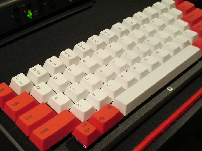

This is a mini-review of my new custom mx-HHKB. These are built to order by "ymdkeyboard", a Chinese vendor on eBay. You can order the keyboard completely assembled or as a DIY kit. Prices range from $75 to $135 shipped. There are a couple of special options for an additional $15 each. Mine came to $112 shipped.
http://www.ebay.com/itm/CNC-Case-Plate- ... PmkteQHXug

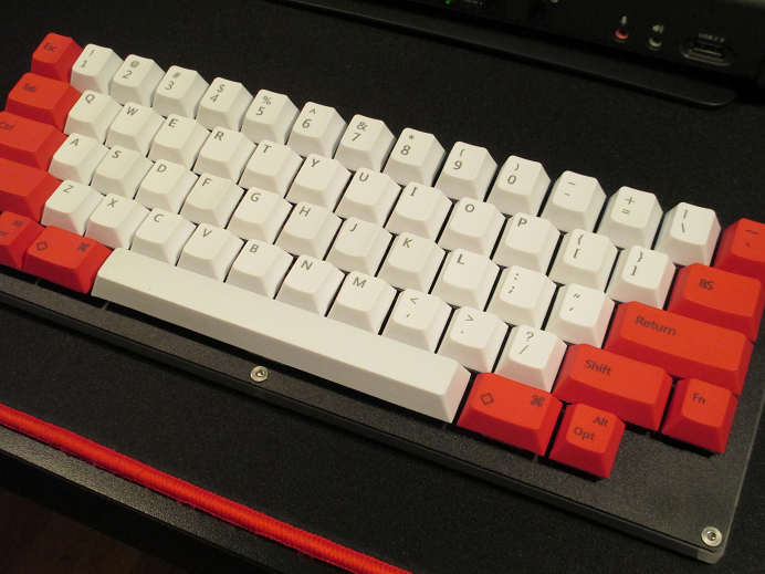

Design: Simple sandwich consisting of an aluminum top plate and aluminum bottom with sandblasted acrylic in the middle. Choice of colors for the aluminum plates. I went with black.
PCB: KC60 SE, preprogrammed to the standard HHKB layout.
Layout: HHKB with 1.00--1.50 --7.00--1.50--1.00 bottom row.

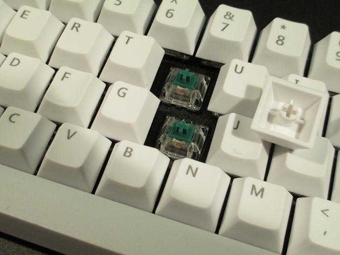

Switches: Choice of Gateron or Cherry mx with a complete selection of subtypes in each category. My choice was Gateron green.
LEDs: Rich assortment of colors in either 3 mm or 2x3x4 mm. My choice was no LEDs so that I would have the option of opening the switches to swap springs and/or sliders.

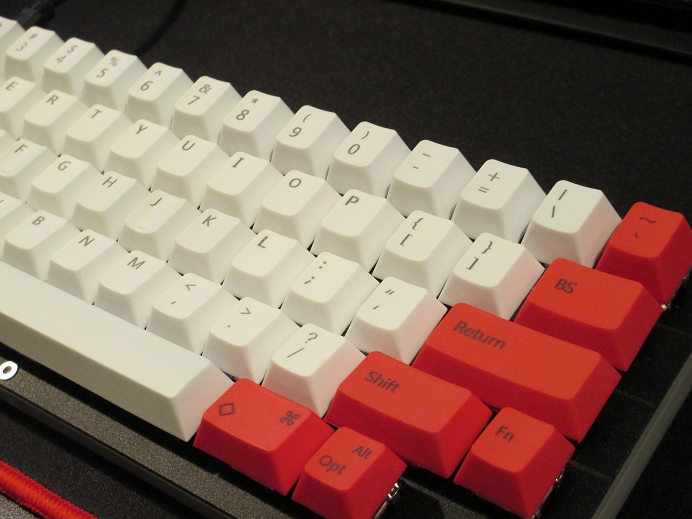

Keycaps: PBT lasered or blank, Cherry or OEM profile, various colors. The vendor also sells keysets separately on a separate eBay link. My choice was lasered white alphas with lasered red modifiers.

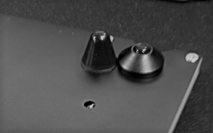

Feet: Screw-in conical aluminum feet. These are nice, but I like more elevation, so I installed some taller self-adhesive conical rubber feet.

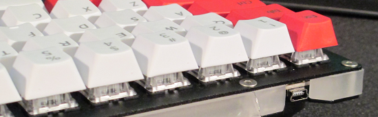

Connector: Mini_USB in left-rear of the case.
Positive Impressions: I like this keyboard. This came somewhat as a surprise, because usually I don't like Cherry mx switches or clones thereof. However, I took a gamble on Gateron greens, which turned out to live up to their reputation of being smoother and somewhat lighter than Cherry greens.
Other contributors to my positive impression are the 60% form factor, pleasing aesthetics of the simple symmetrical design, and the HHKB layout. The board is also light but very solid. I find that I can type rapidly and accurately on this board, and the switches feel just about right. The keycaps have an agreeable slight texture, like pumice stone. Lasered legends are certainly not as nice as dye-sublimated ones, but they are serviceable and they provide the correct labels for the HHKB layout.
The keyboard also sounds good. The simple sandwich construction of acrylic and metal seems to provide an ideal matrix for the Gateron green switches. I prefer the sound to other 60% keyboards that I own with metal cases, which tend to have a harsher timbre.
I ordered the board with no LEDs because I don't particularly care for them and so that I would be able to remove the switch tops to replace components. I had thought that I might install lighter springs, but the Gateron greens seem fine as they are. I might alter that impression after using the board for longer typing sessions.
Negative impressions: There were some negative aspects. Upon arrival, the box was crushed along one long edge and the bubble wrap inside was fairly flat, but the keyboard was intact. The mini-USB connector was a bit loose, and the Cherry-type stabilizers were a bit rattly on the Left Shift and Return. The spacebar was extremely rattly. However, I was able to remedy the rattles in the Left Shift and Return keys by squeezing in some Super Lube 21010 grease without disassembling the board. For the spacebar, I installed a blue O-ring on each of the three stems, applied self-adhesive foam rubber strips inside the spacebar to deaden sound, and squeezed in Super Lube 21010 grease, again without disassembling the keyboard. The rattles have disappeared.
Overall conclusion: Overall, I consider this board good value for money and a great option for those who would like a 60% form factor, HHKB layout, optional LEDs, and Cherry mx or Gateron switches. The rattly stabilized keys were an initial concern, but this was easily fixed in a few minutes by applying some lube and sound-deadening materials.
