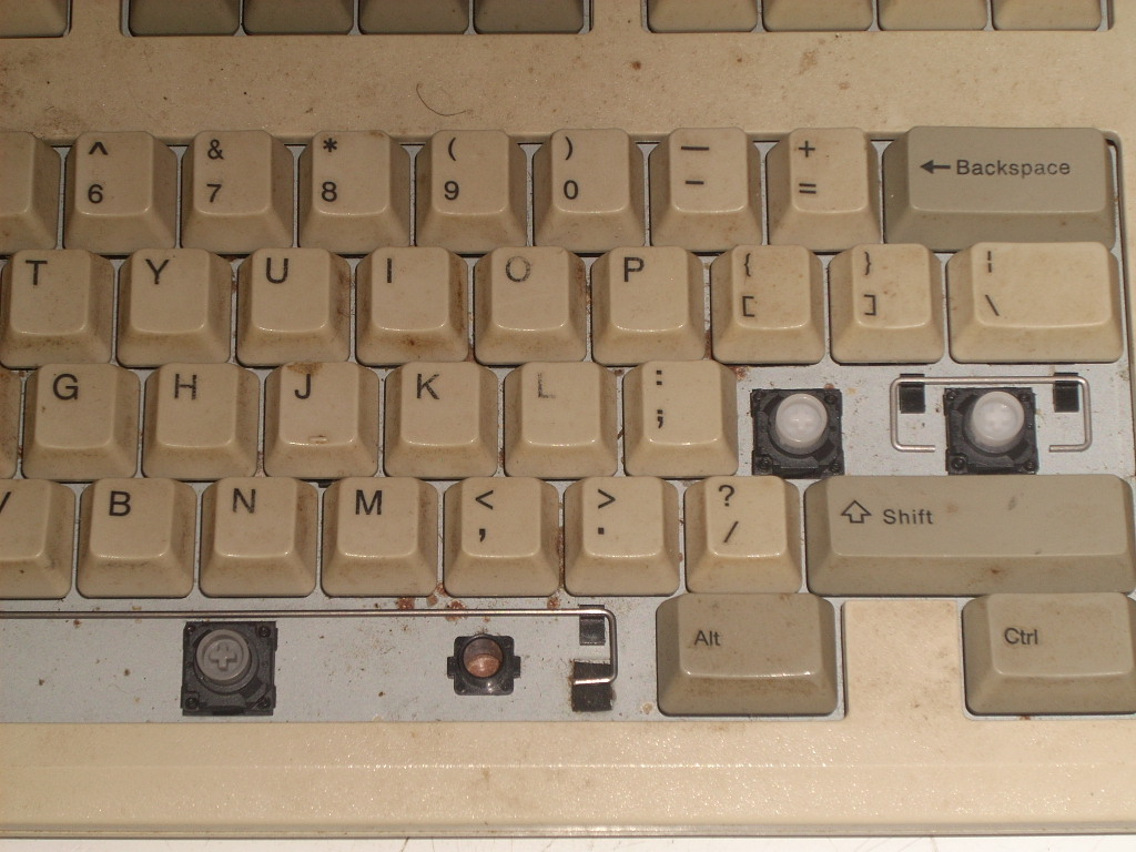

On a side note I tried the hydrogen peroxide heat retrobright method (heating the keycaps to 40 Celsius for three hours in a pot on the stove in hydrogen peroxide diluted 50% with tap-water) and while I got phenomenal results it also killed the original 12u spacebar (warped and later snapped) and the printing on the alphas started bleeding slightly. Check out how yellowed the keycaps were originally on IKSLM's pics:
http://shrani.najdi.si/?1s/YI/XneLUXG/2 ... 201055.jpg
http://shrani.najdi.si/?2S/nW/VPBPsLQ/2 ... 201102.jpg

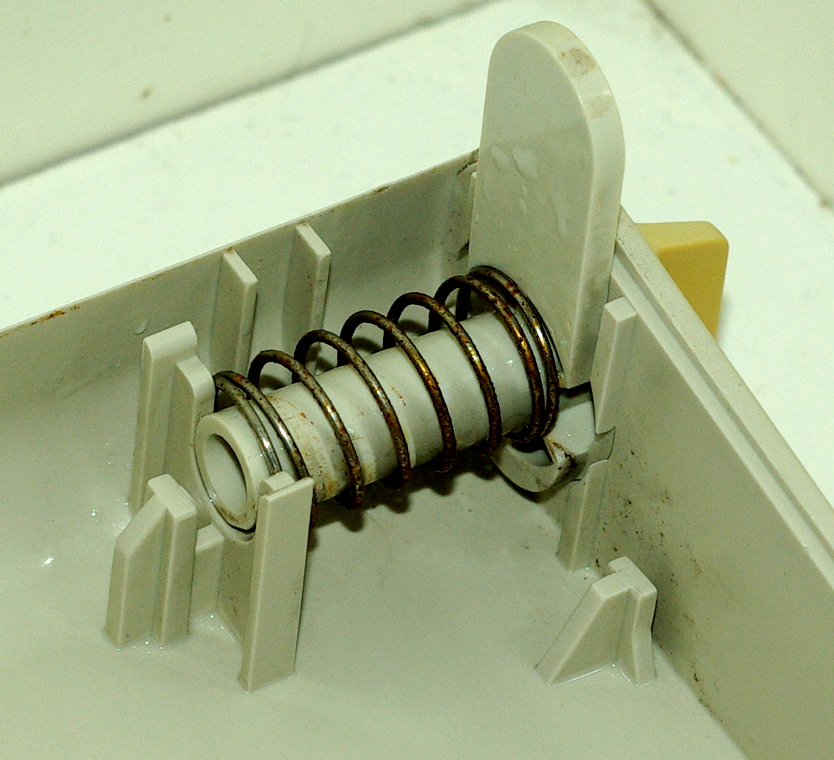

Notice the lube on the stabilizers:

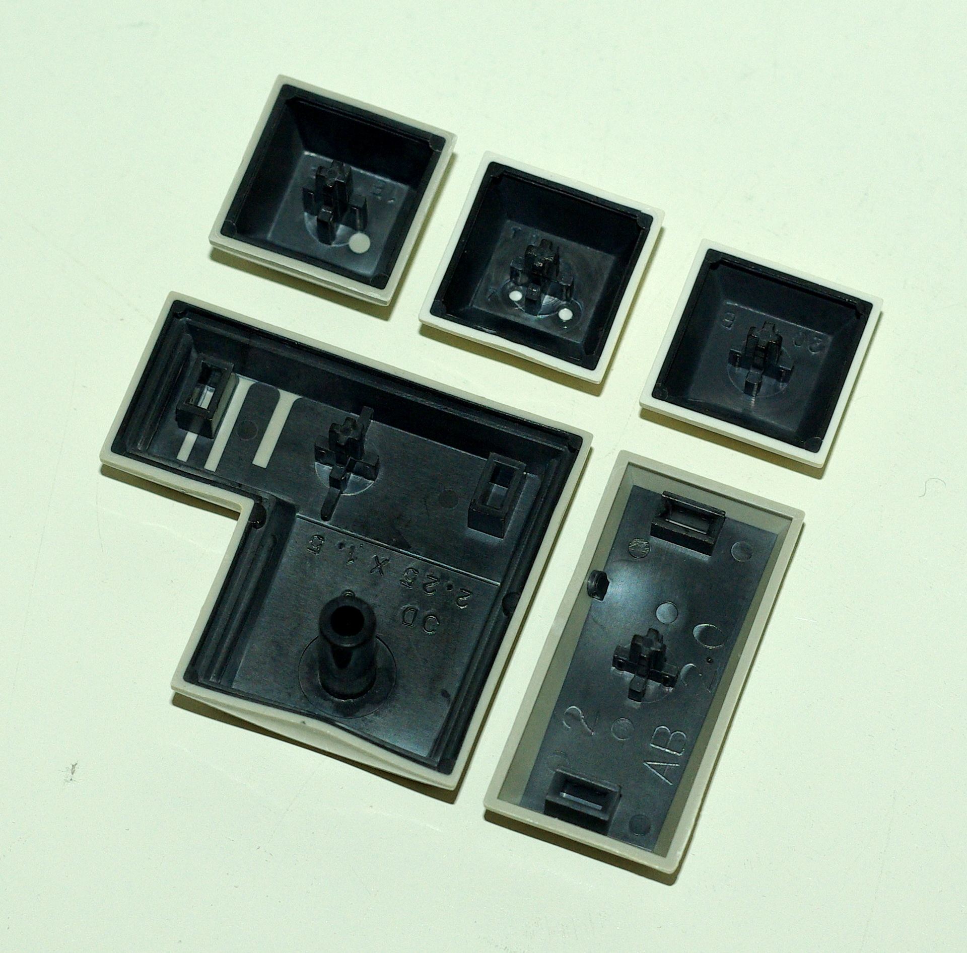

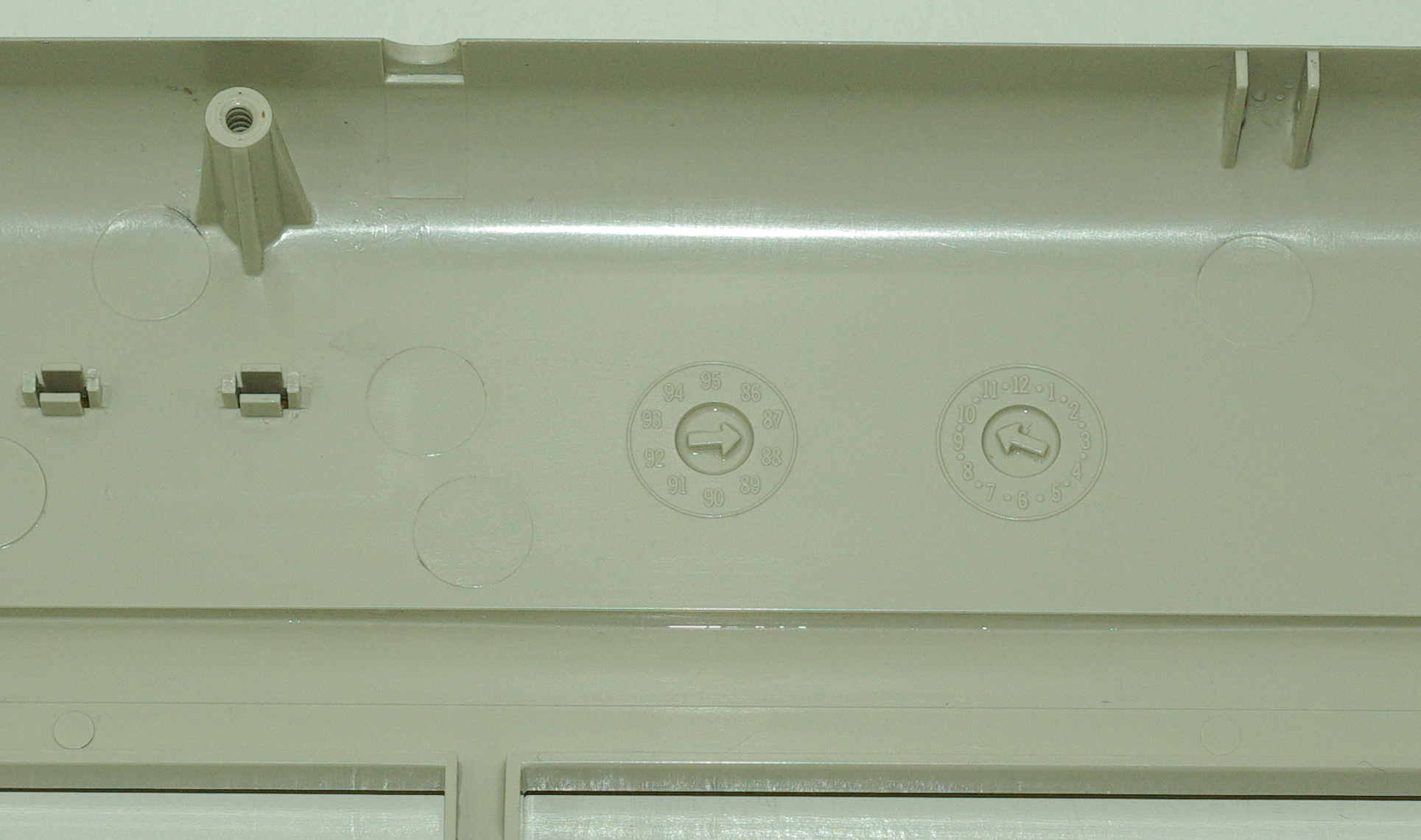

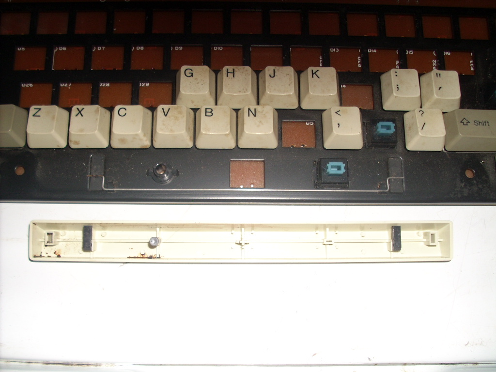

Why do so many factories have mould date wheels that sit in between two years?!
Also, unless this has been modified as a prank (highly unlikely) we're now faced with an interesting question: are cyan and grey the same switch and the factory was just transitioning as this example was made, or are they different models? It's fairly common for enter to be a different model of switch, but generally the same switch is used for enter and for space under these conditions.
Considering how similar white, grey and cyan seem to be (at least, this may years on in poor condition), I have to wonder what anyone felt they were gaining (and not costing themselves in terms of logistics) by having three types in the same keyboard!

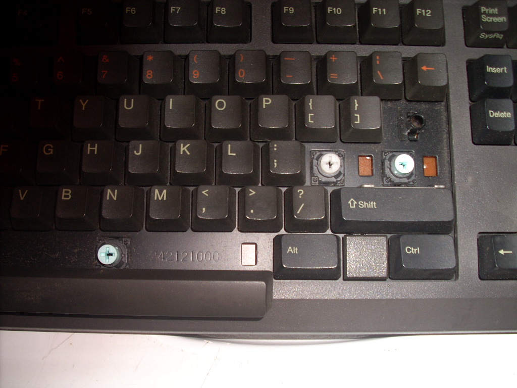

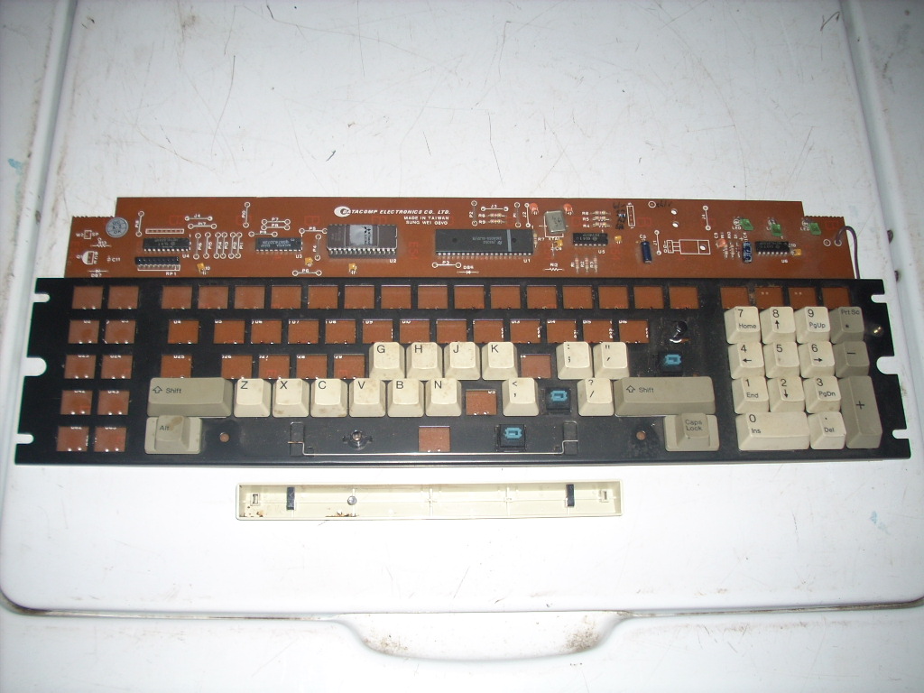

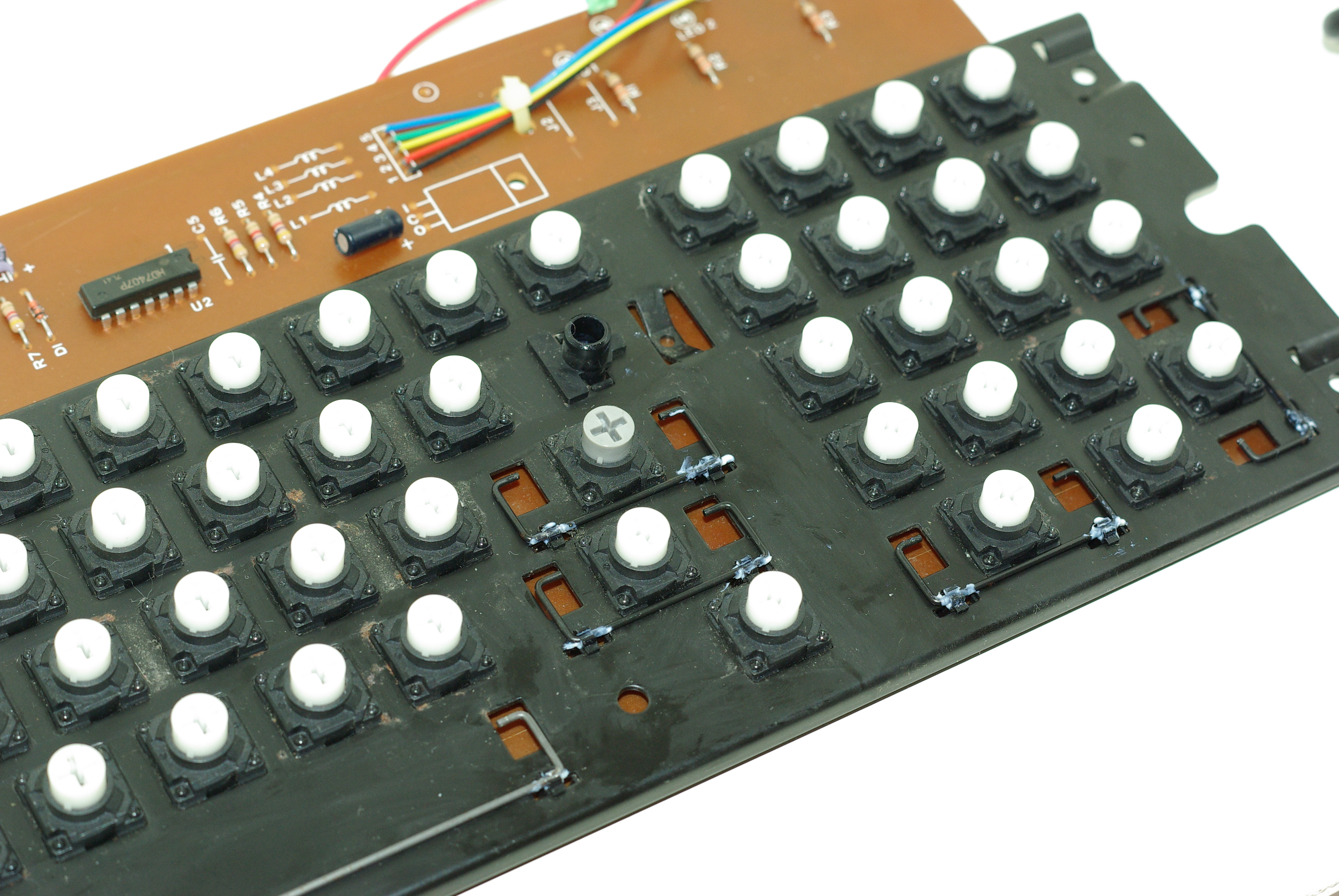

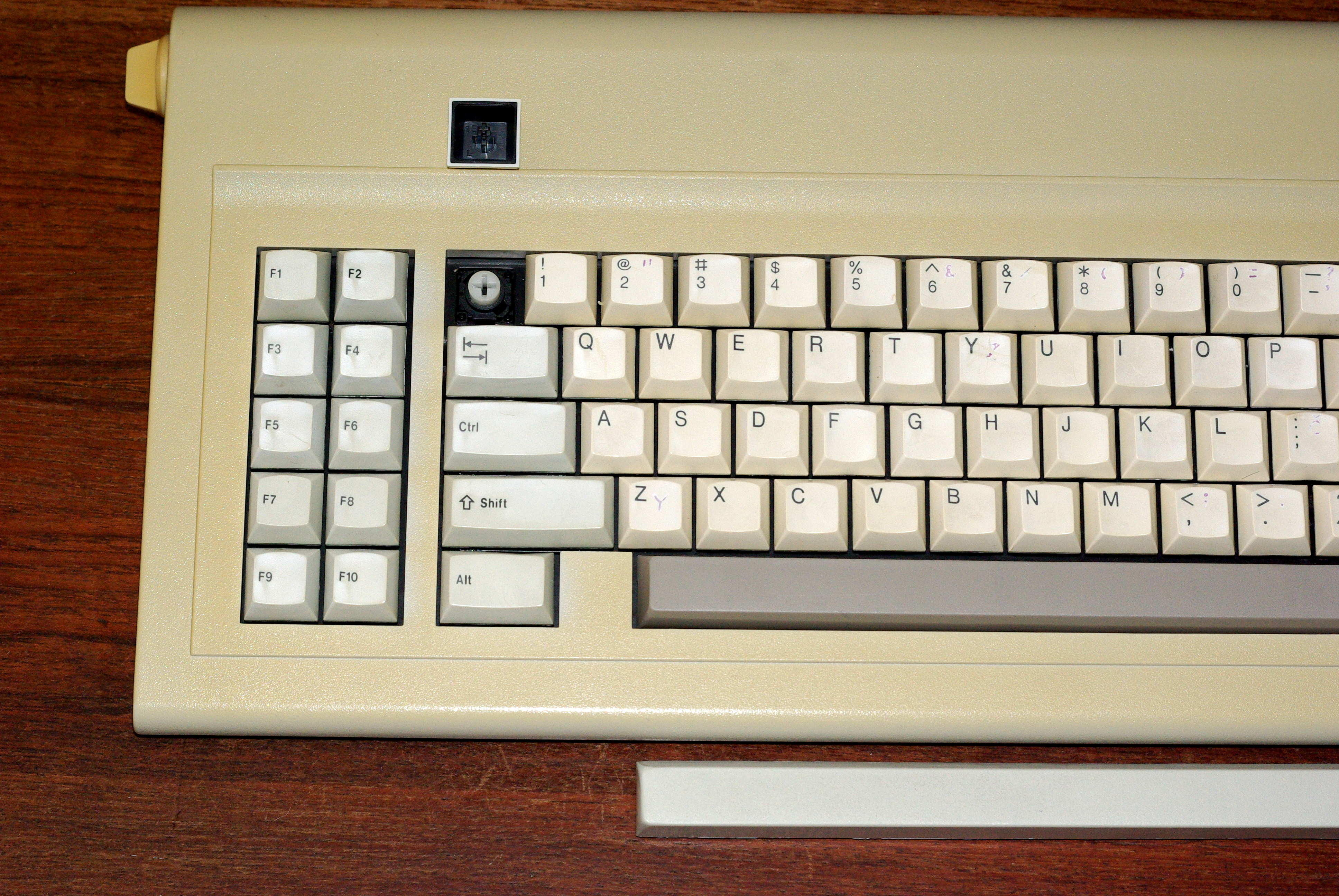

Curiousity got my goat, so I went out and checked a couple of my Futaba boards. The DFK-121 has cyan for enter and space, white everywhere else. The Leading Edge AK-1012 has gray on the spacebar, white on enter and elsewhere. I have a spring gauge here someplace, which might work to give us some force measurements of the different types. I've never tried that on keyboard switches; I used it in a past life to set the force on musical keyboard (organ) contacts.
I also checked my DFK-777 blue Alps donor in case there was any switch strangeness there (there wasn't). But I was quite surprised to see the spacebar arrangement. There's a blue Alps switch off-center, but also a cutout in the plate and pads on the PC board for an Alps switch in the center position. The spacebar itself has a Futaba inverted stem in the center (unused), and an Alps stem in the off-center position. Was this to allow for two different spacebars, with "version #2" having an Alps stem in the center? Seebart, if this is the same as yours I'd be happy to send you this spacebar to replace your warped and broken one.

Polecat wrote: Was this to allow for two different spacebars, with "version #2" having an Alps stem in the center?
Seems that way and proves Datacomp obviously planned that way.
Polecat wrote: Seebart, if this is the same as yours I'd be happy to send you this spacebar to replace your warped and broken one.
Yes, the inverted Futaba mount in the center is what I need I will gladly take you up on your generous offer!
