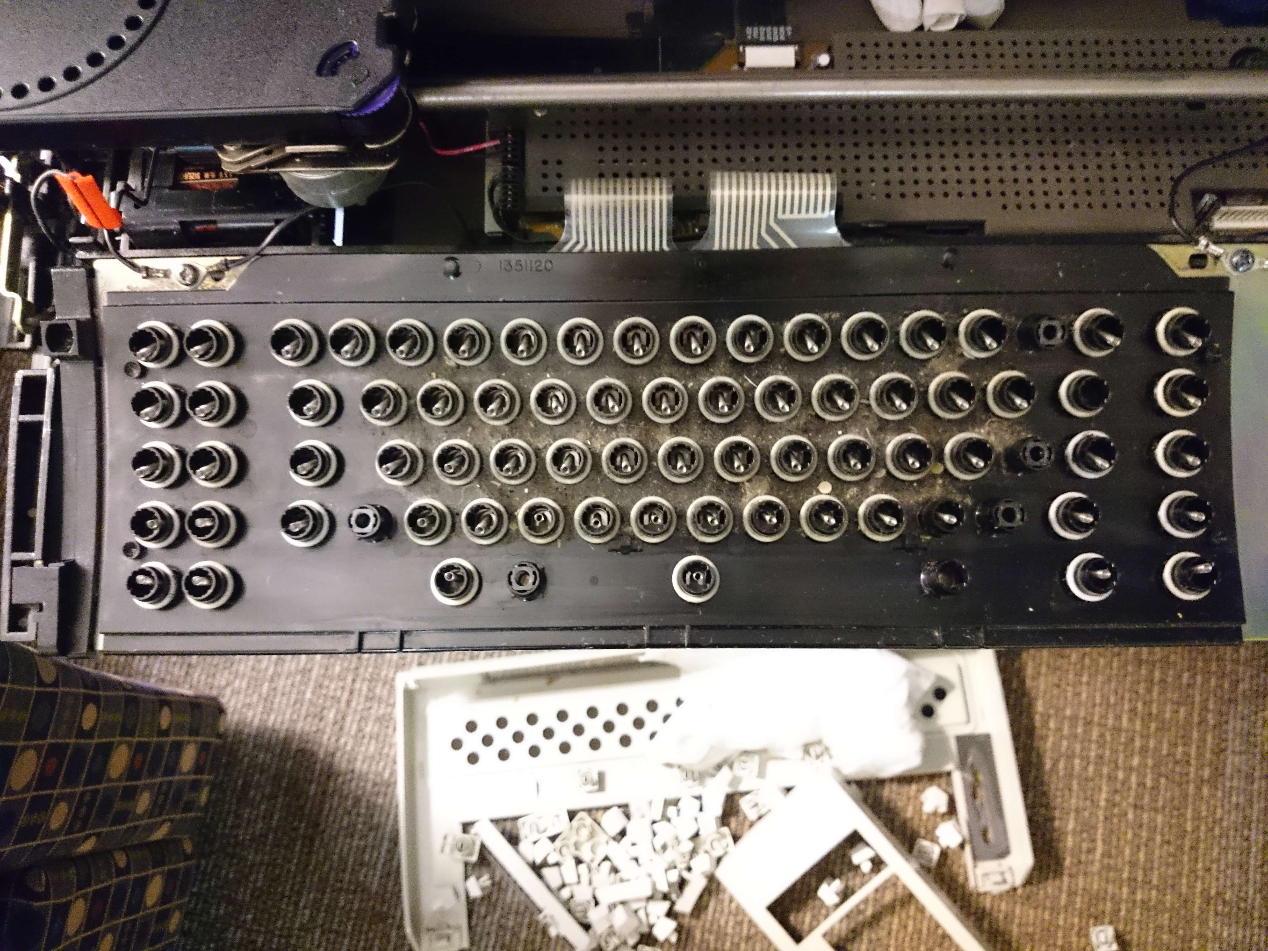

The wheelwriter keyboard i took apart didn't have a rubber sheet but o-rings instead . This made it louder/more clicky

https://trello.com/c/uYSx2zmT/7-ibm-whe ... -5-o-rings
Don't some reason there are these curious O-rings equipped onto the IBM Wheelwriter 5, the earliest typewriter equipped with Buckling Springs. They wrap around the barrel to provide a cushion for the keystem when it bottoms out.
These O-rings reduces the volume of the Wheelwriter 5 keyboard, by cushioning the keystem when it bottoms out. You'd imagine that the sound of the typewriter itself would definitely overshadow the meager noise of the actuation, but actually when the key bottoms out, it gives off a loud clang that you feel in your bones.
These are compatible with any IBM/Unicomp Buckling Spring barrel. However, in later buckling spring keyboards, such as the IBM Model M and Wheelwriter 3 or Wheelwriter 1000, the keyswitches are already quieter by design, despite the fact that it has no O-Rings.
In fact, when you add O-rings on this newer buckling spring design, it sounds only as loud as a ThinkPad rubber dome keyboard. So if you're thinking about bringing your Model M to work, try installing some O-Rings.

I had this happen with an action writer. removing the mat when bold modding has a similar effect and I greatly prefer how it makes the M feel2ter wrote: 28 Mar 2018, 23:02 The wheelwriter keyboard i took apart didn't have a rubber sheet but o-rings instead . This made it louder/more clicky
