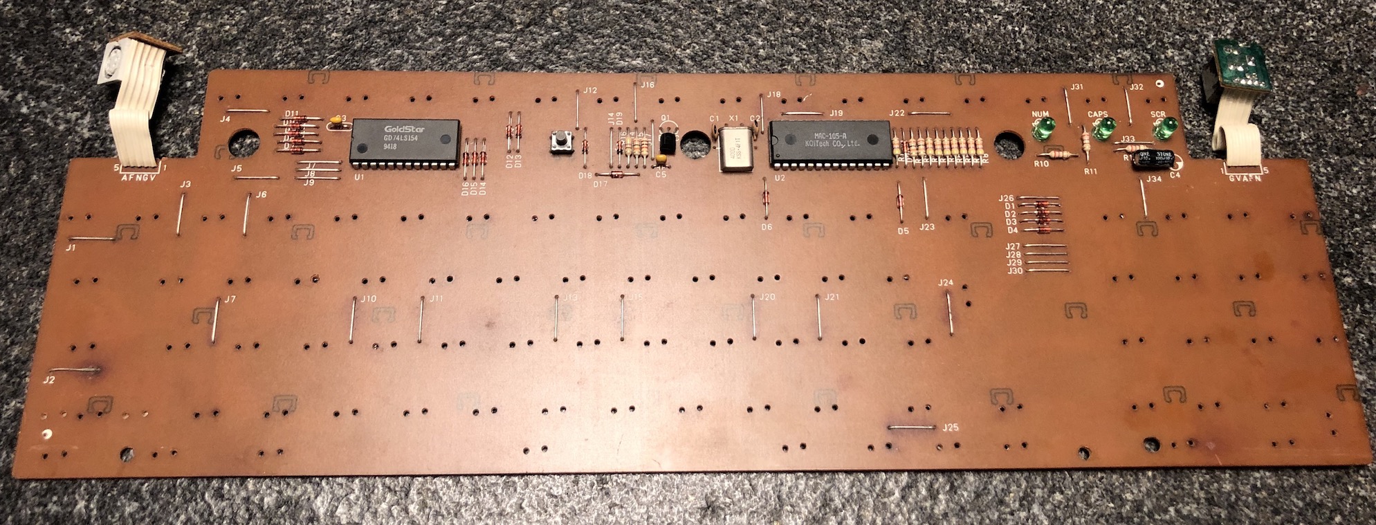

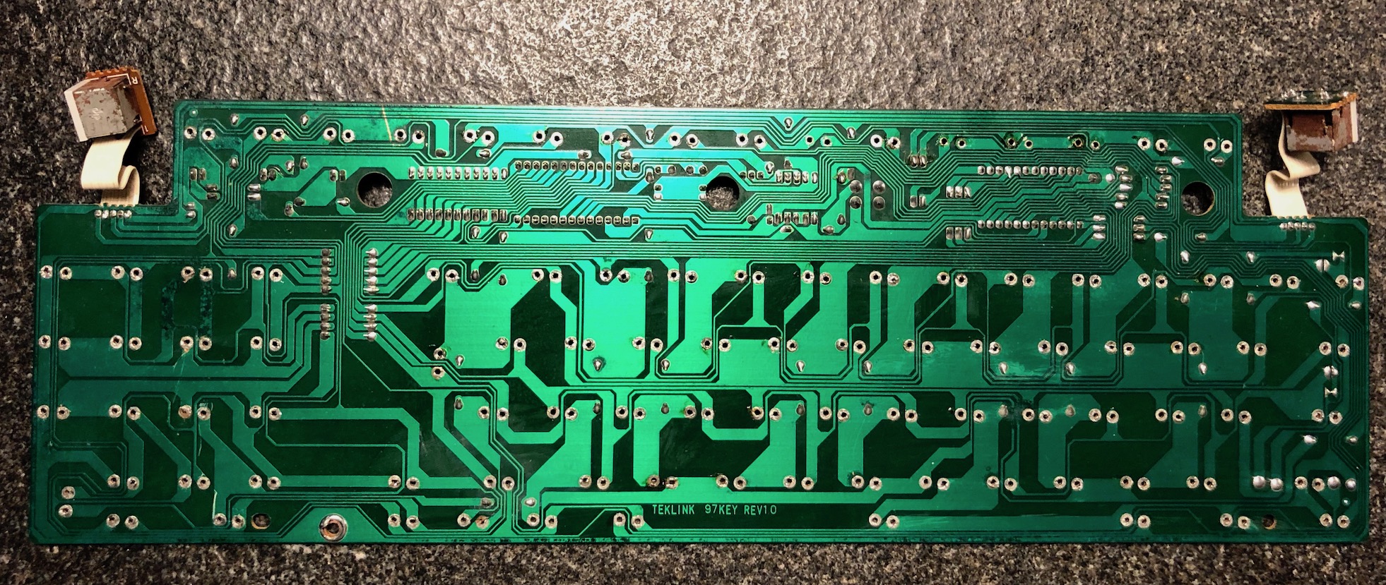

Here are a couple of photos of the board:

Strange. I don’t know what would do that to a controller. But I do know that ADB is an oddball protocol that’s too half by smart (thanks Woz!) saving one pin at the cost of a great deal more complexity.
Soarer’s controller is definitely an option. You likely know the drill: map the matrix and remove one or both of those chips, then hook up your Pro Micro (if it has enough pins to map to the required rows and columns) and use Soarer’s tools to describe the matrix.

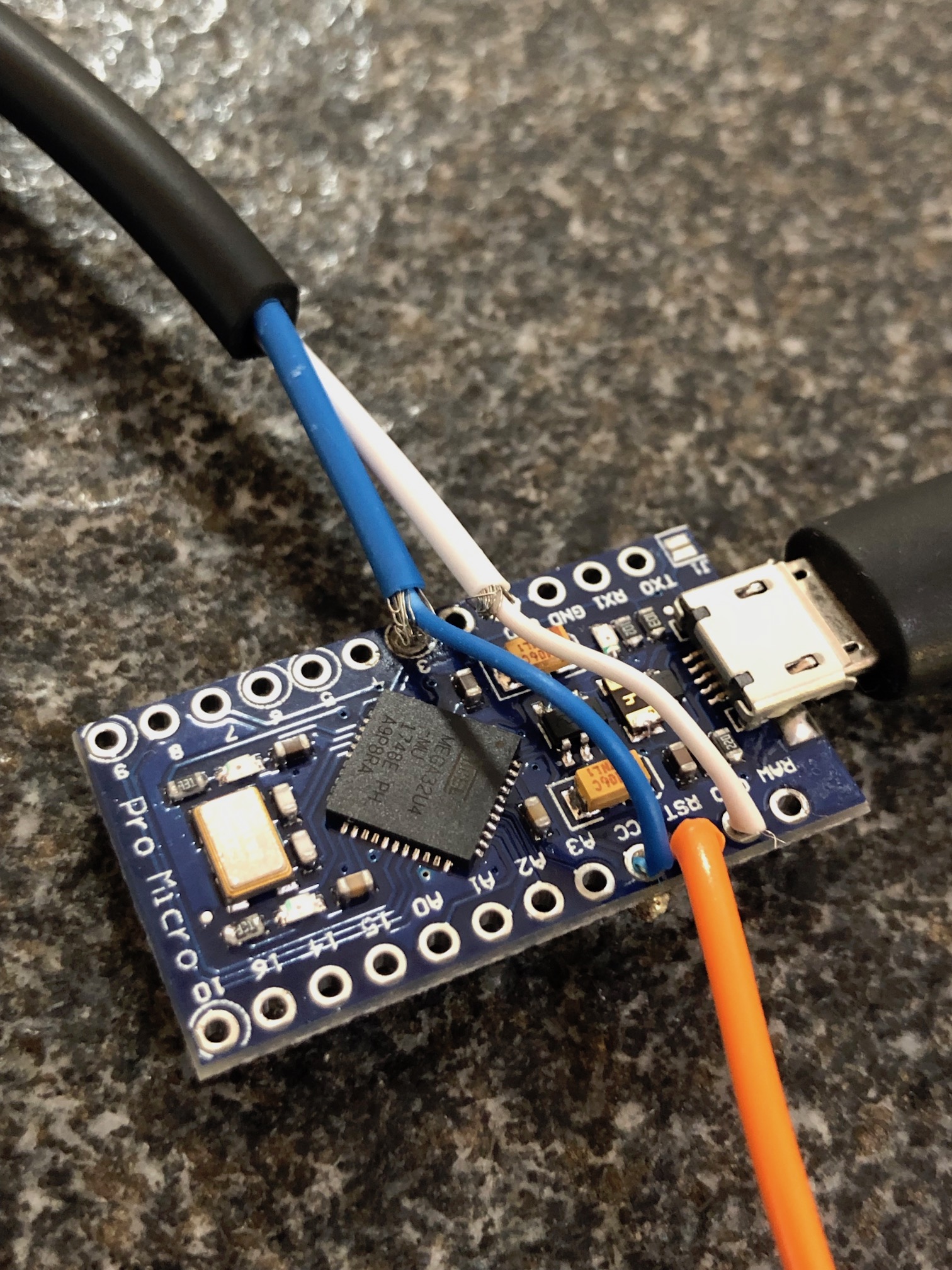

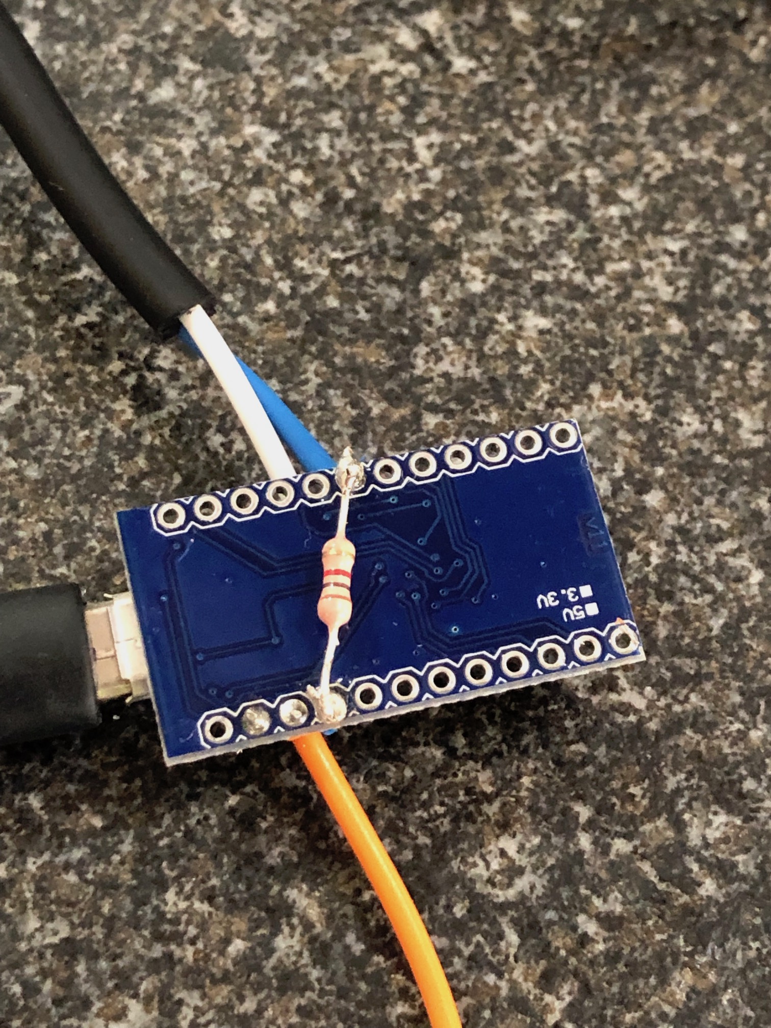

Thanks for taking a look guys. Here are a couple of photos of my wiring:
I'm using a hacked up svideo cable, and the pins for it are as follows:
ADB pin 1 - Outer blue - connected to Pro Micro pin 3 (DATA)
ADB pin 2 - Outer white
ADB pin 3 - Inner blue - connected to Pro Micro VCC
ADB pin 4 - Inner white - connected to Pro Micro GND
I also wired a 1K resistor on the back, between DATA and VCC. The orange wire is just for shorting RST to GND to reset the Pro Micro.
Hasu, I'm not sure which key I pressed in that log yesterday, so I've repeated the test a bit more carefully. Here's an annotated log where I press the 1, 2, and 3 keys:
