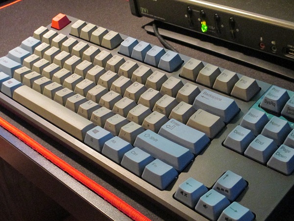

Upon unpacking the Leopold version, my first impression was not as positive as it was with the RF/Topre version of this keyboard. The disappointment was due to the colors of the keycaps. From the photos and renders I had seen, I was expecting colors with greater contrast and vibrancy. Instead, the gray and blue caps looked muddy and washed out.

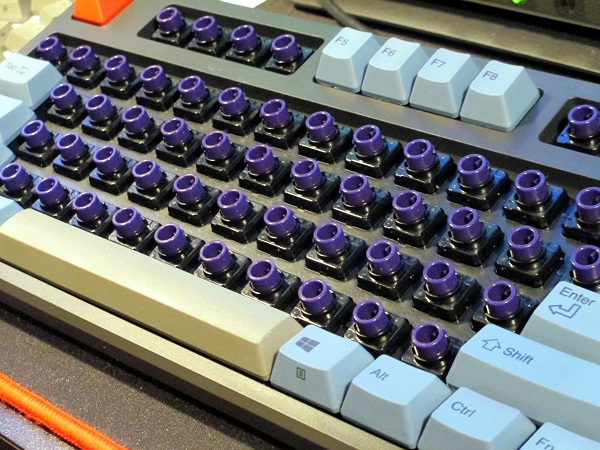

Fortunately, I had purchased some Topre keycap sets from Widebasket a few years ago, so I set to work pulling off the gray caps, which gave me a chance to capture an image of the lovely Topre switches with their purple silent sliders.

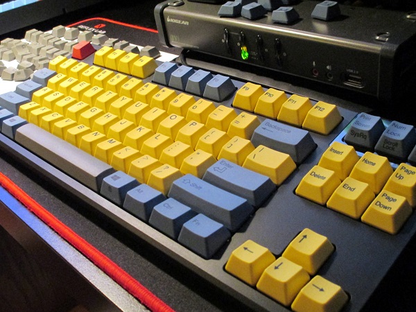

Looking for high visibility, I first tried some bright yellow caps. These certainly stood out from the crowd, but it was too garish, even for me.

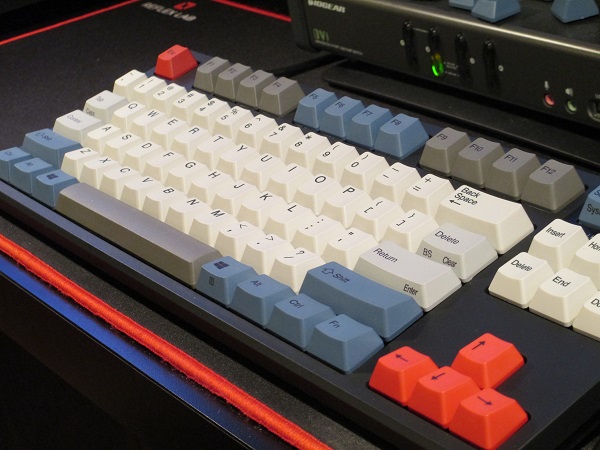

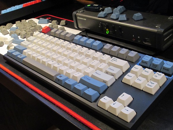

Replacing the yellow with white toned things down. I also went back to alternating gray and blue for the top row. In addition, because I have used an external Hasu USB-USB converter to remap keys to a HHKB layout, I installed some HHKB caps to get appropriate legends.
The single red Esc key looked a bit lonely, so I decided to finish the job with red arrow keys.
More's the pity that the previous versions of the Realforce boards had a non-standard bottom row. Now that the R2 has a standard bottom row, my old Topre keycap sets do not fit. Nevertheless, the overall scheme looks fine to me.
