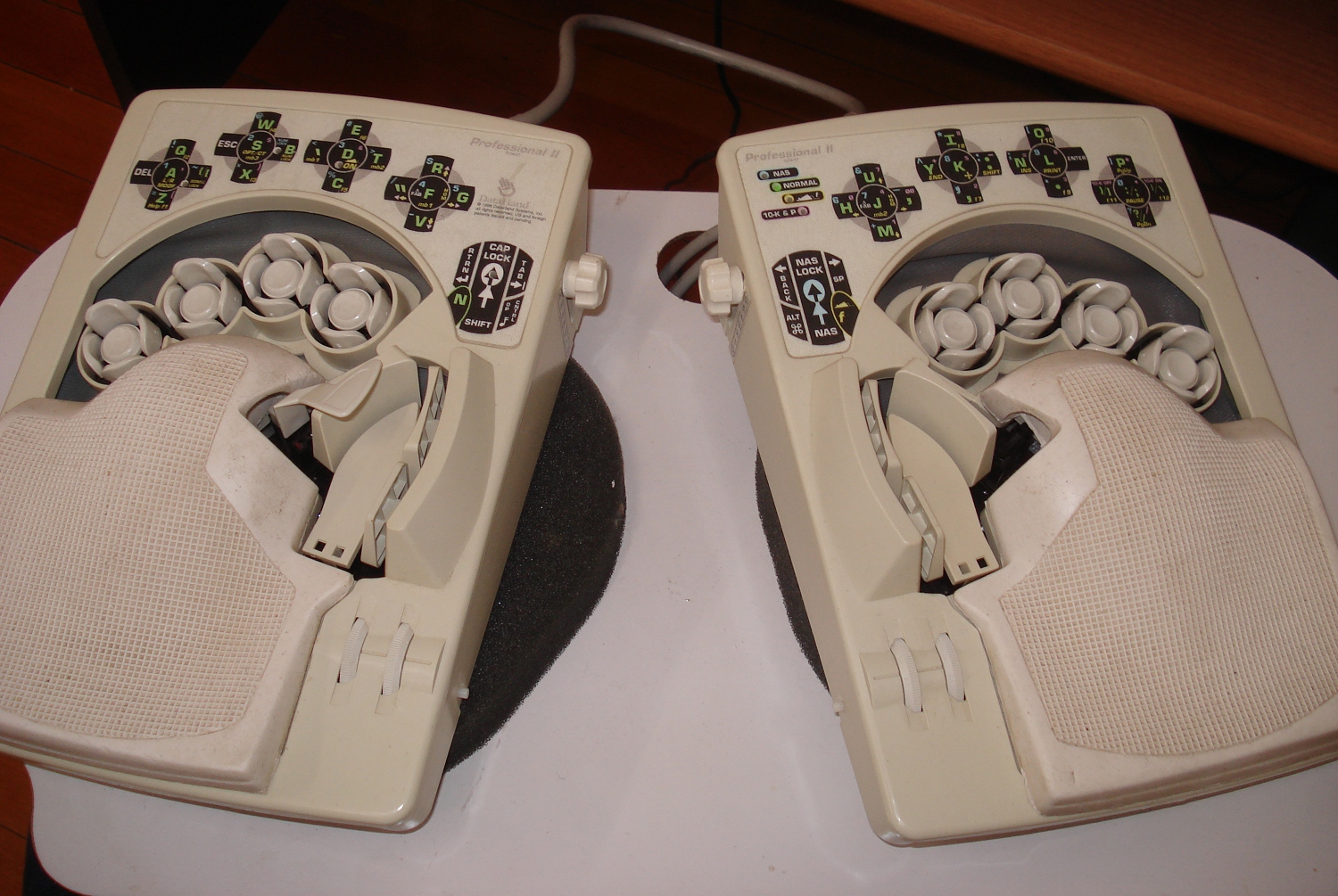

I am currently typing on this:
My first two impressions:
1. Oh my god, does this smell. (It must have come from a smoker`s household...)
2. I have forgotten because it took me so long to write 1.
Now I will try to figure out how to get a serial mouse working with Windows 7...plug-in again, works!

Okay, since it seems fully functional it would now be time for cleaning. I am kind of dreading this because I'm so scared of breaking it.
I think now is as good a time as any to say:
THANK YOU, WEBWIT!!!!!!
...and do you have any cleaning advice?

Say, is the right Fn-thumb button missing or is this simply a "Personal" model?
EDIT: Also check Webwit's pictures at http://webwit.nl/input/datahand/. He has also uploaded some manuals there.

That button is broken but some glue and maybe a little extra plastic should fix that. I'm working on it.
Webwit even sent me a manual as well. And some keycap fridge magnets. Thanks again!

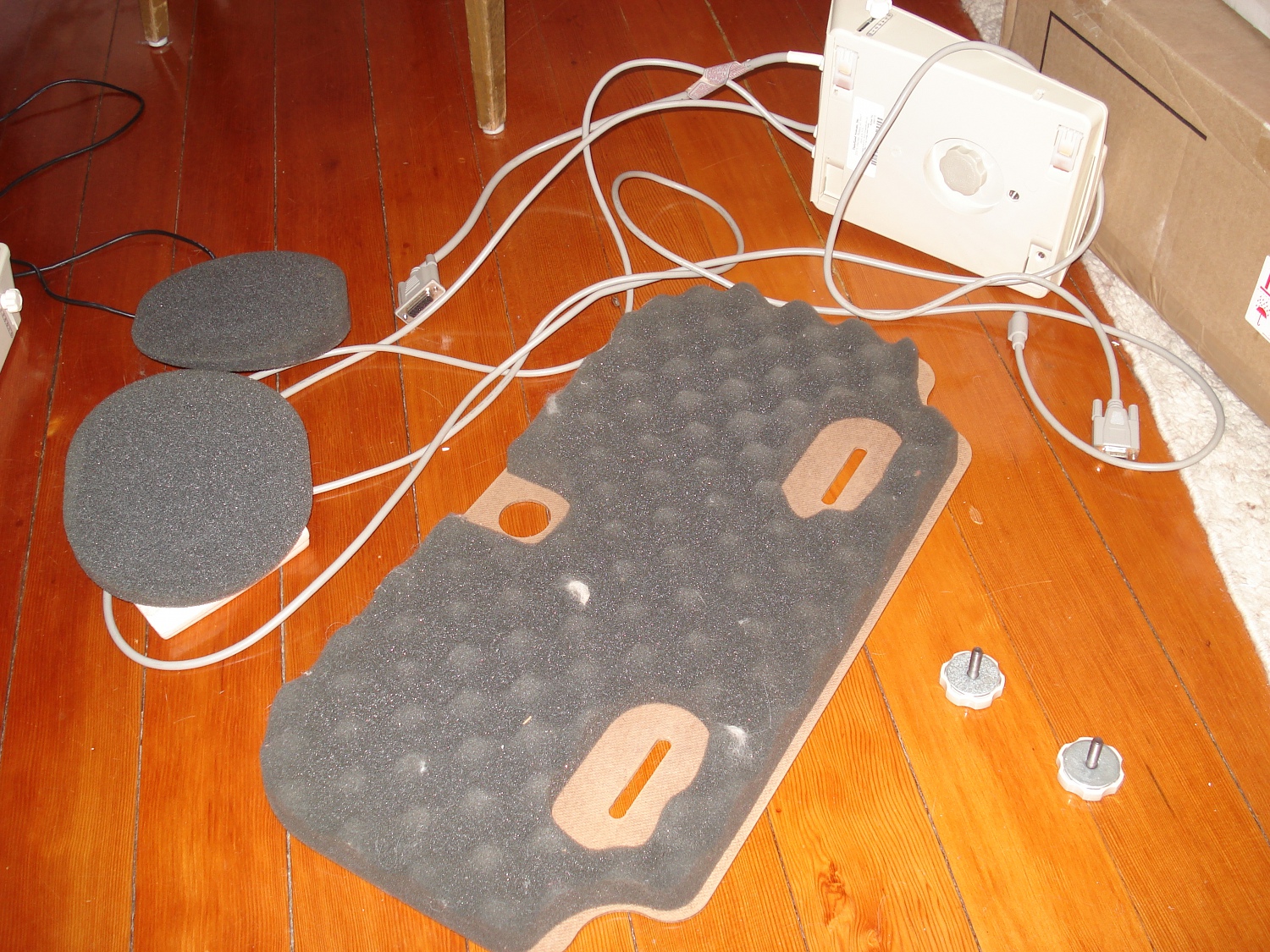

It's probably rude to make a picture thread and put only one picture in so here is a picture of the "leg mount kit".
It's just a piece of thin wood with some foam under it. Works very well and is easy to make, so if you want your own for a keyboard or laptop be inspired!
At the bottom right you see the bolts that are used to attach the unit to the plate, on the left two extra foam pieces that go on the top under the units to give them a little tilt and in the top right is the bottom of the right unit were you can see the hole for the screw. I know it's not terribly exciting but it's a Datahand and it's MINE. So pretty exciting for me.

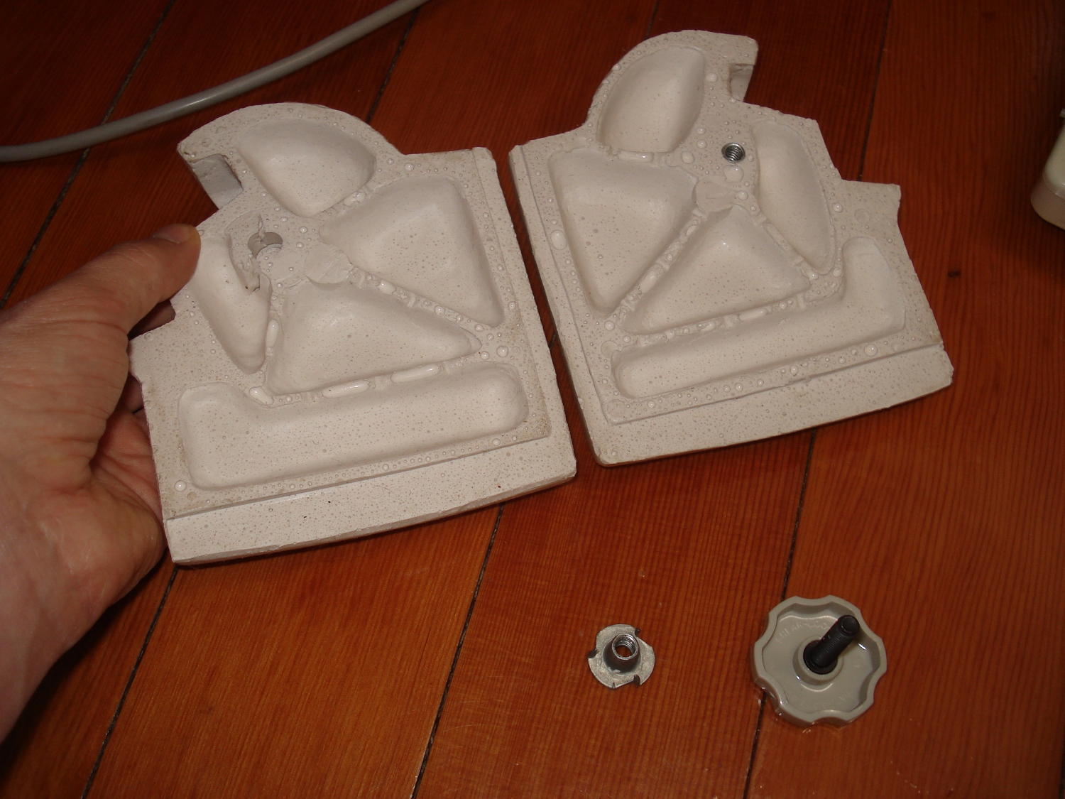

This is the under side of the hand rests.
As you can see the left hand one is broken. The metal piece that was inlayed is the piece at the bottom. It must have just ripped out. The material is very soft. To quote another thread "feels like dead octopus". The material is soft sticky plastic and pretty heavy though, so it's not a problem, even without the screws it doesn't really move at all.

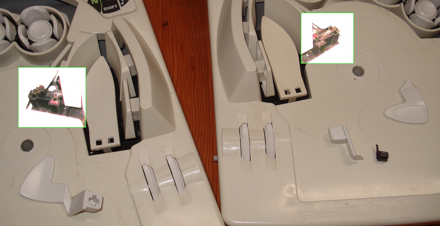

Okay, this is the reason why I could actually afford this.
This and webwit's generosity no doubt. I still feel like I robbed him.
I've enhanced the image a little so you can see what the problem is. Looks like somebody accidentally leaned on it or something.
I'm fairly confident that either some fancy glue and a little added plastic or a replacement made from bent wire will be an easy fix. In this case it really works for me that the switches activate so easily because it means the parts have to withstand very little force.

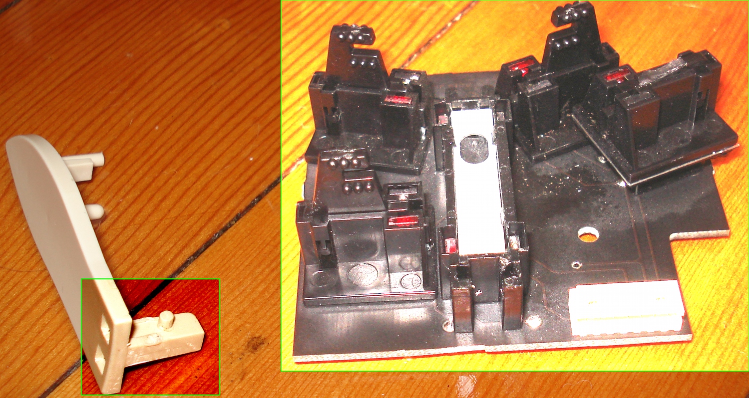

I wish I would grow up in the respect that I always have to try when somebody tells me I can't do something...webwit wrote:I have some tips from Lynn for the other keycaps, but I think she told me not to mess with the thumb unit.
So as you can see I left some scratch marks but nothing that should be visible on an assembled unit and maybe after applying some very fine sandpaper.

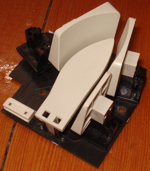

The side switches are relatively easy. Just hold them with a pair of pliers and gently pull them off. As visible on the right, the pliers leave some bite marks, since this part of the unit is exposed that may bother some people.
The bottom switch is actually really hard to get of but there is no thinking involved. The plastic is thick and bends instead of breaking so the only thing needed is courage. I just eased a carpet knife in between the two pieces and then replaced it with a screw driver. If I had some sort of other plastic availabe I would have used that to avoid the marks but as I said I think it will be fine.

Nice! Good view here of the optical sensors.
- off
- Location: the crapper, NL, EU
And TIL(another thing) that the datahand actually uses optical sensors for (at least the thumb)switches)!webwit wrote:Nice! Good view here of the optical sensors.
And that I can relate to. Deeply.icarium wrote:I wish I would grow up in the respect that I always have to try when somebody tells me I can't do something...
Props for doing the wrecking though! GL cleaning and fingers crossed everything still works smoothly.

All switches use optical sensors. It's a magnetic/optical switch.
Consider the "south" key here. Bottom part where the screwdriver holds it is where the keycap is mounted. By pressing the key, you separate the two tiny magnets. They provide a light tactile feeling and a clicky sound when they snap together. At the sides, you see an optical sender and receiver. When you separate the keys, you provide a gap so the receiver gets a signal.
The sensors are the same as seen in ball mice from the nineties. The ball moved against rollers mounted on wires, the wires rotate, at the end of the wire there is a wheel, the wheel rotates. Optical transmitter/receiver at both sides of the wheel, the signal passes between the wheel's edges when it rotates, translating into mouse pointer movement.

Can you show a top side of the palm rests? They don't use the threaded insert anymore, it just has a locator nub. And they aren't scalloped out on the bottom, just solid material, and very heavy. I am going to try and replicate the palm rests with a mold so I can copy my 'large' palm rests for Hoggy. I think it's just a silicone or latex, but I don't know.
You now have to look over your shoulder when in public, 'cause everybody wants what you got, buddy! LOL
Congrats, and it's pretty cool you're taking it entirely apart and getting intimate with it. It'll pay off later. I believe the plastic is ABS. I want to dye mine as well even though it is white since I never take it out of the box.
