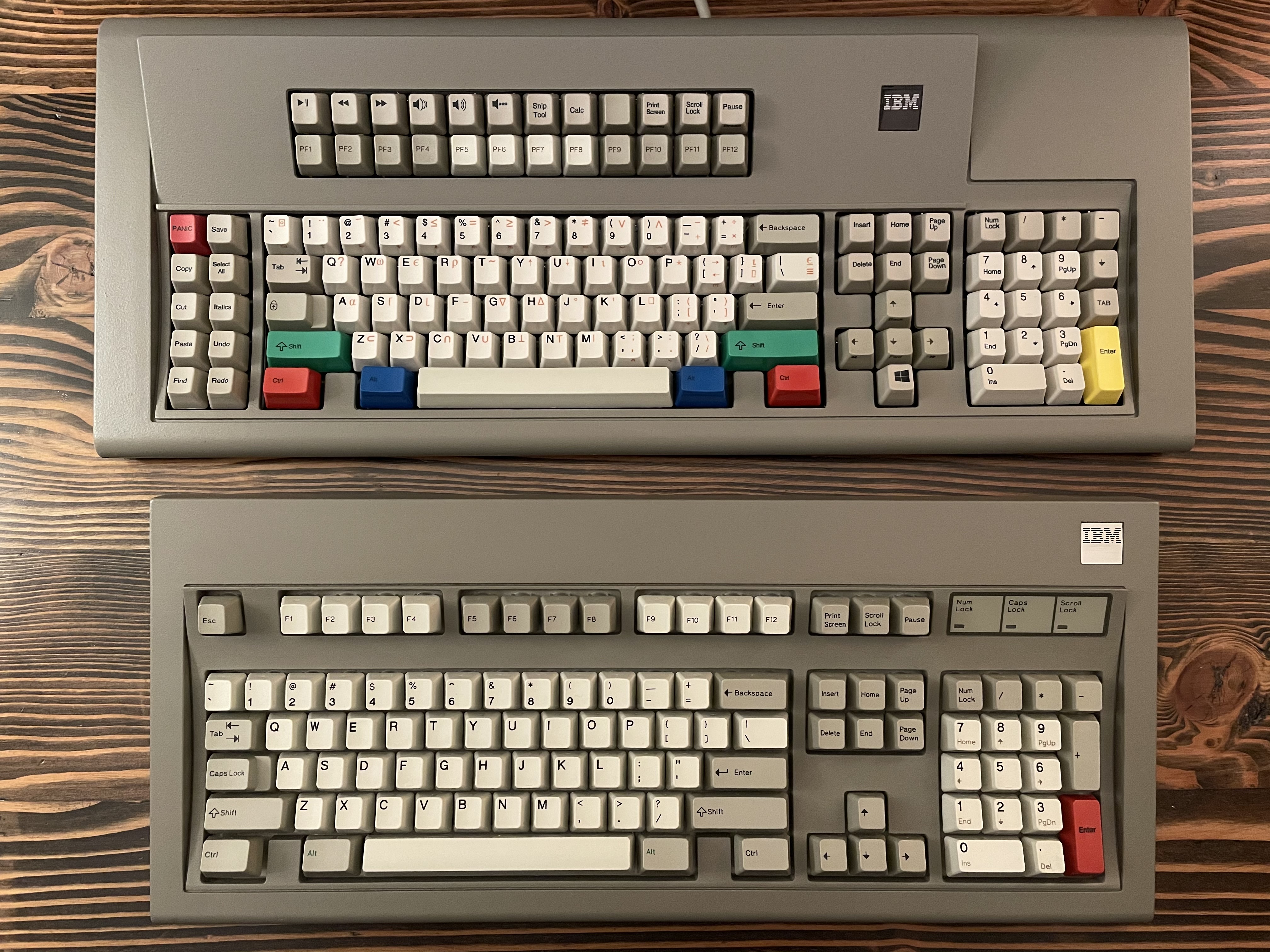

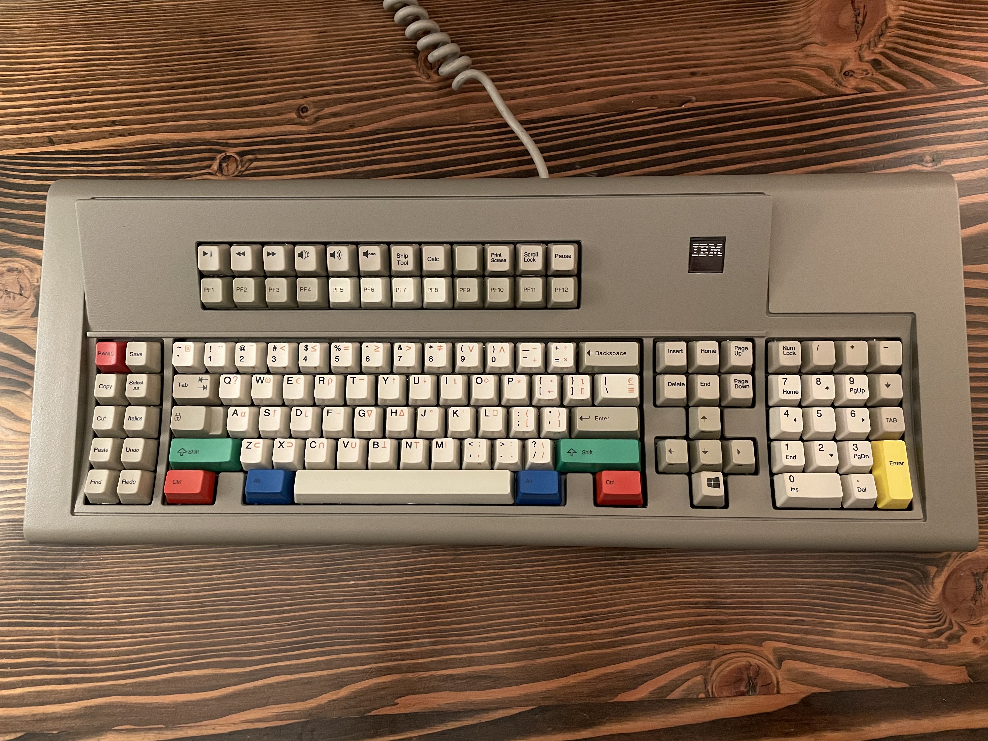

My result:
Industrial M 122.jpg (2.99 MiB) Viewed 5865 times
latemodel24
12 May 2021, 04:07
Wow that looks really good!

ddrfraser1
12 May 2021, 04:46
0th gen for comparison

E TwentyNine
12 May 2021, 15:34
It looks good but it seems that these color matches always need just a *little* more olive/green, they're too gray.
I doubt you'd notice it in person unless, like here, it's up against an original.
I wonder if many who have industrials got them color matched what we'd all get for the values.
ddrfraser1
12 May 2021, 15:39
E TwentyNine wrote: 12 May 2021, 15:34 It looks good but it seems that these color matches always need just a *little* more olive/green, they're too gray.
I agree completely. I wondered if it was down to the gray primer I used. OG has slightly more sheen too but that could have been solved with another coat or two of satin clear coat.
latemodel24
20 May 2021, 23:38
Is that a f122 or a m122 you pained in that industrial color.
