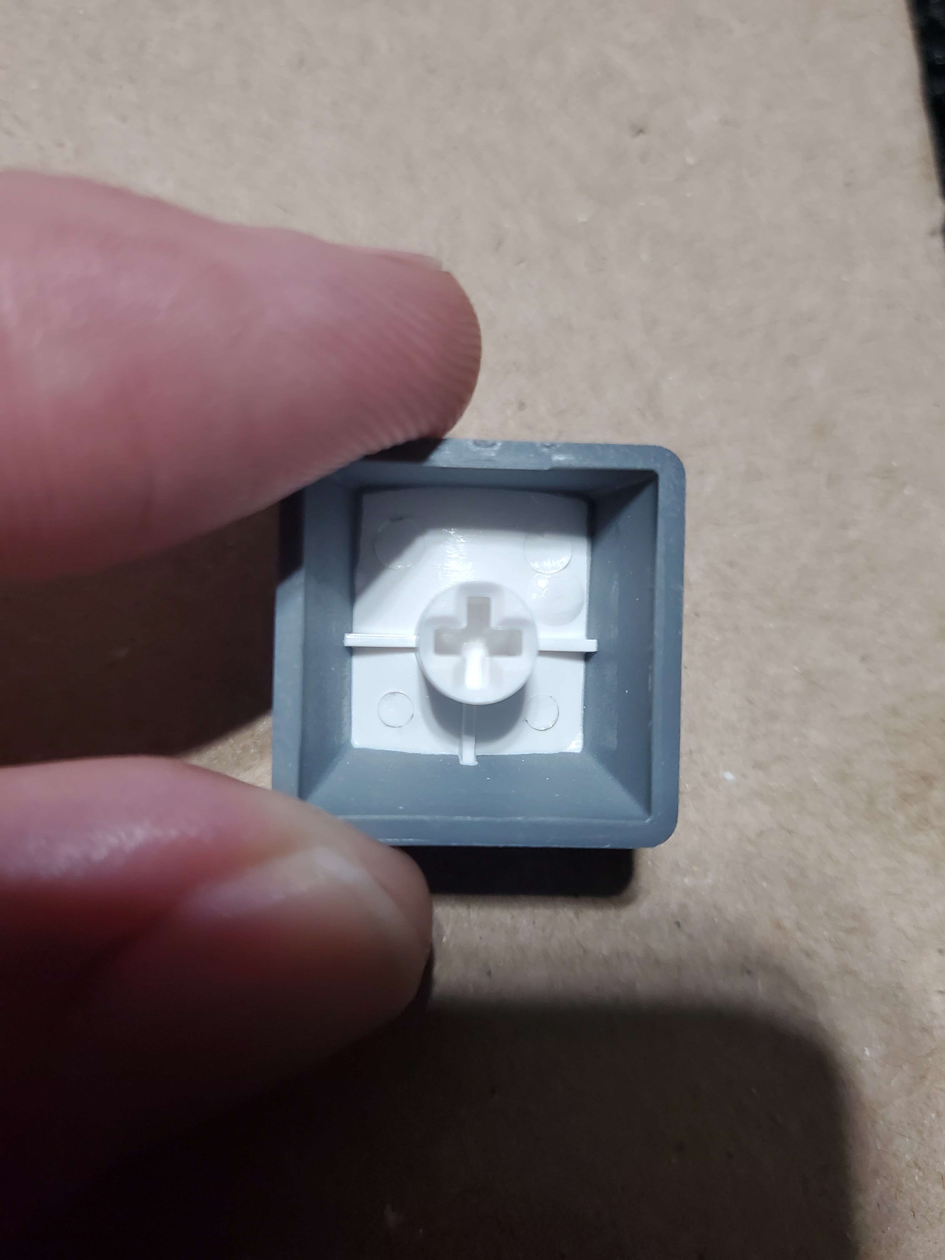

Here's the cap from the F key on my Das, since I figure it is probably one of the most used. A few of the caps on that board are starting to shine even though they're PBT and that's the set I have had on the same set of box switches the longest.
Does it look even slightly damaged at all to you? Do what you will, but I would just get some decent double shots to replace the lasered caps that came on that one and enjoy.

How hard is it to just post a couple pictures of the damaged caps, lol

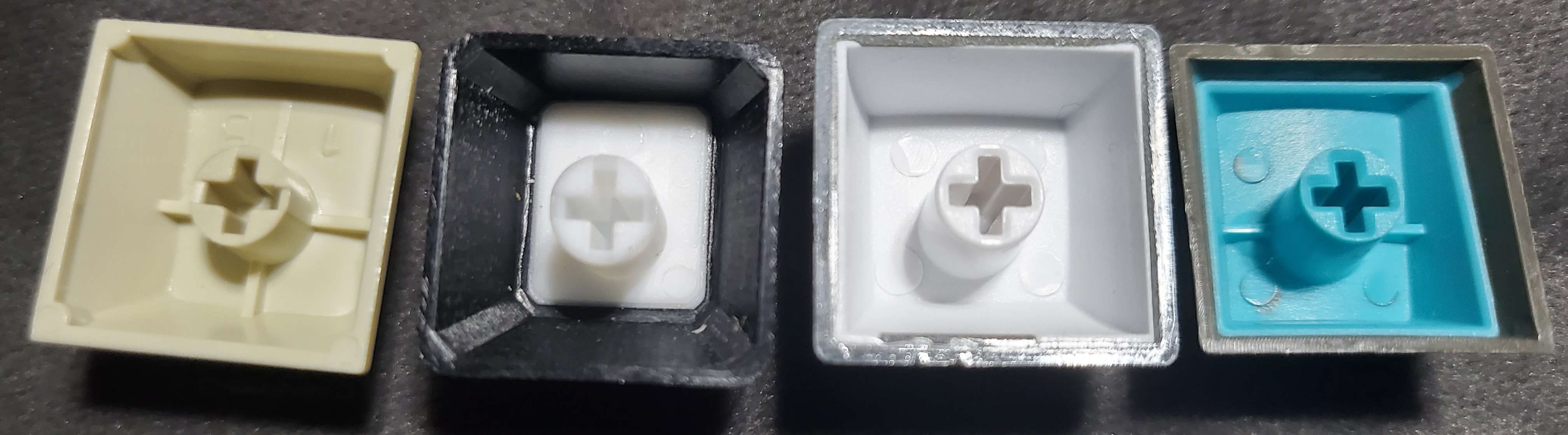

Here's the rest of the caps I have used for extended periods of time on box jade or navy switches from batches from 2020-2021:
From left to right:
Unitek K-151L OG caps used on box jades, TG3 OG caps on box jades, AKKO double shots on box navies, cheap Amazon double shots on box navies.
I have another box jade TG3 board, but that would be redundant. I put each of these caps one-at-a-time on a Cooler Master Quick Fire Rapid with MX blues and they were not loose on them.
From left to right:
