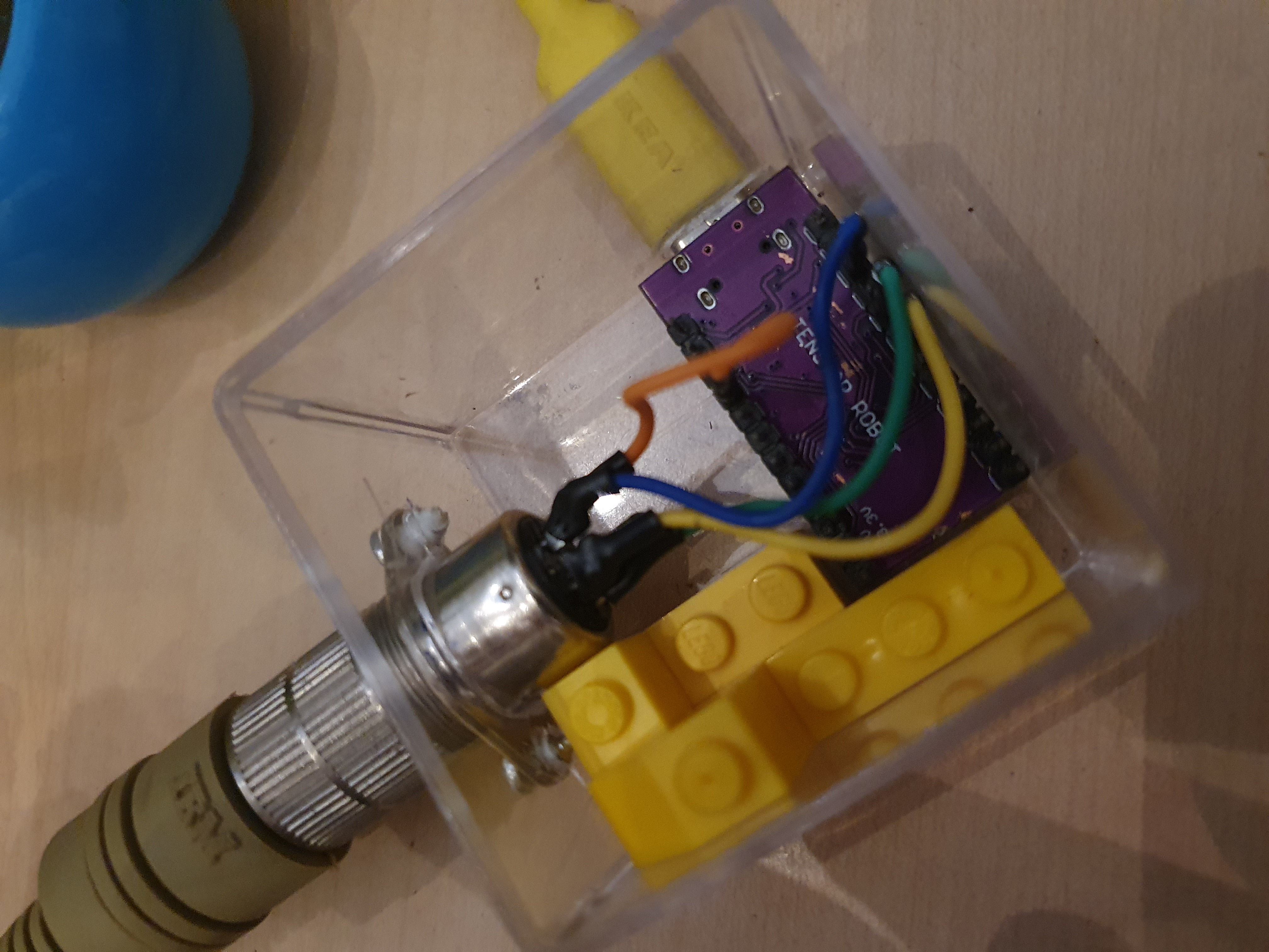

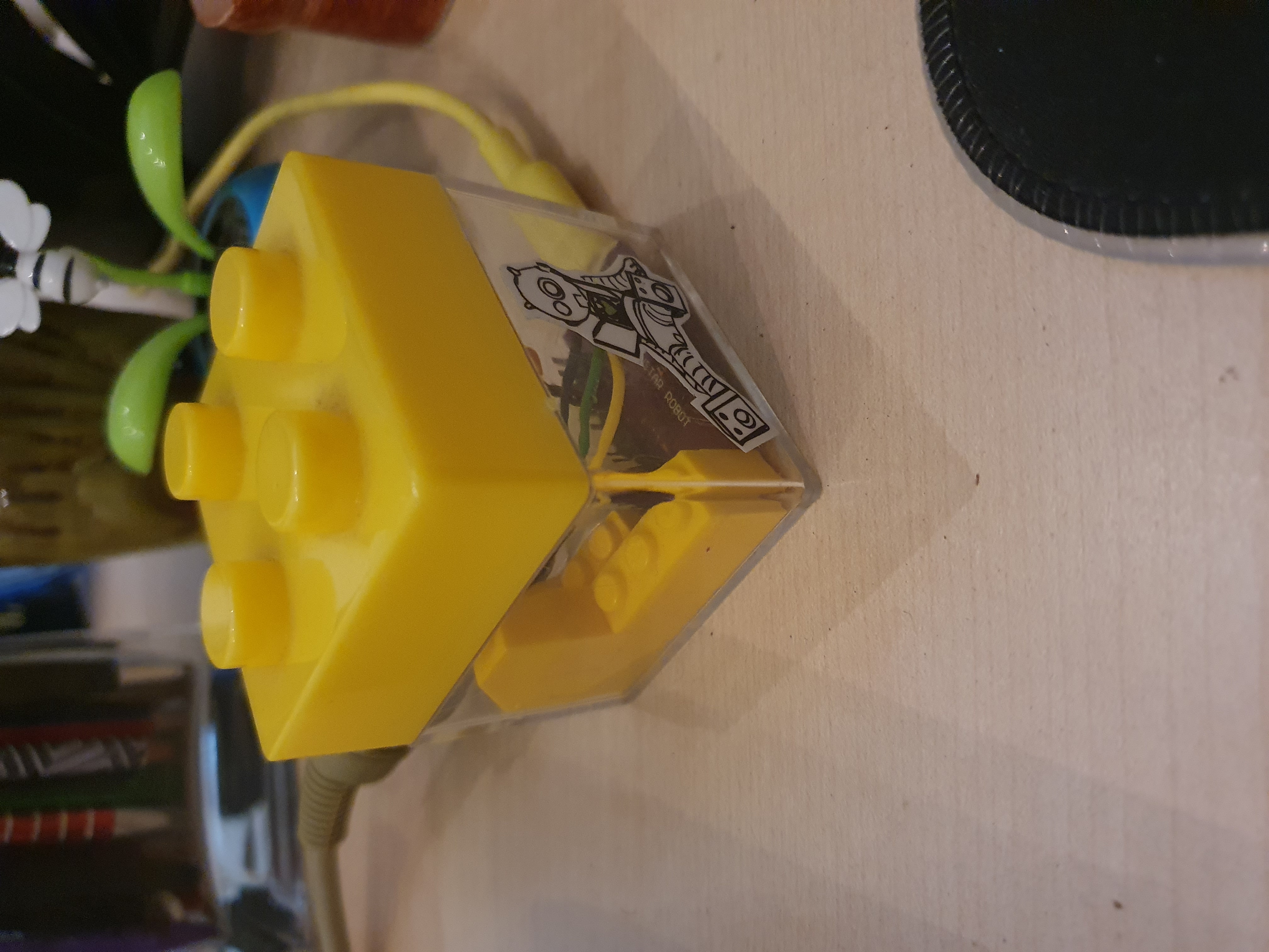

Hi and congrats for your haul. 5 are quite a bunch of model Fs. Lately I found quite interesting and profitable converting an F122 with a firmware (tinkerboy credit) qmk/vial enabled that means key mapping on the fly without the need of uploading a new firmware every time you need to change something in your keymap layout.
Updating the Soarer’s Converter (ATMEGA32U4) to QMK Firmware with VIAL support is a comprehensive guide tut made by the same author, thinkerboy, you can find here and upload it for the first and last time on a prom1cro atmega 32u4 microcontroller.
In the picture below the result of my little brewing
