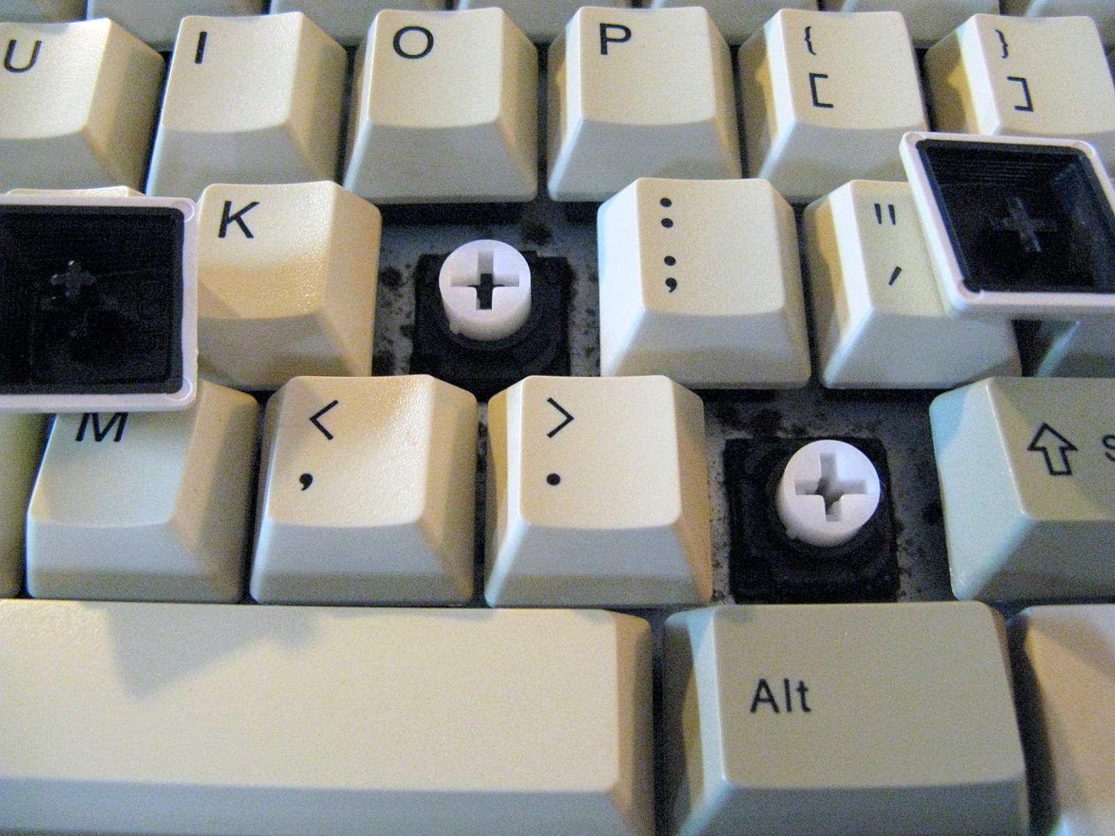

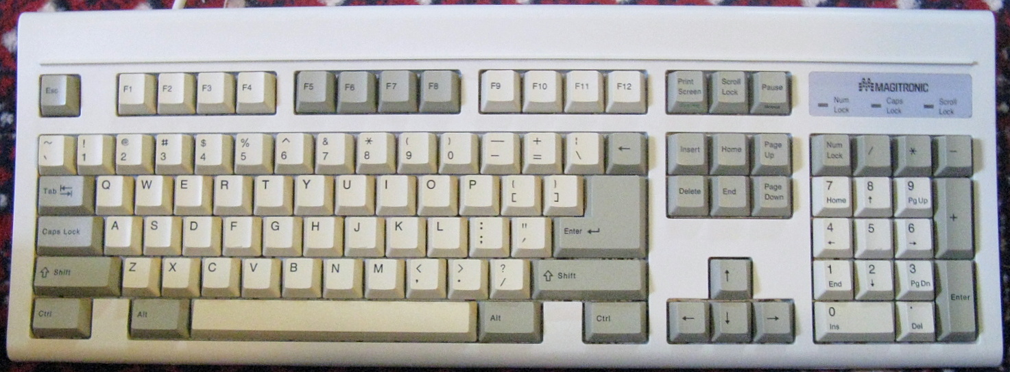

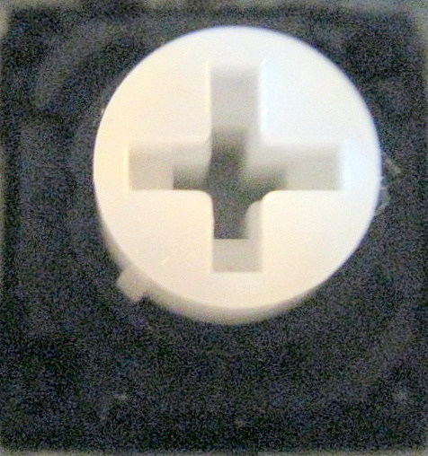

do i have an old junker that you cannot identify? I provided pictures so as you can use for your wiki if desired. it is an old dinosoar that looks like a smk or futaba, but inverted. i took apart and cleaned sometime ago- was pretty nasty.
it is linear for sure, no bumb, actually very nice- like a pillow, plate mounted with ds, has some nice heft to it as well.
smk, futaba.........?

[wiki]Futaba clicky switch[/wiki] — top-right photo.

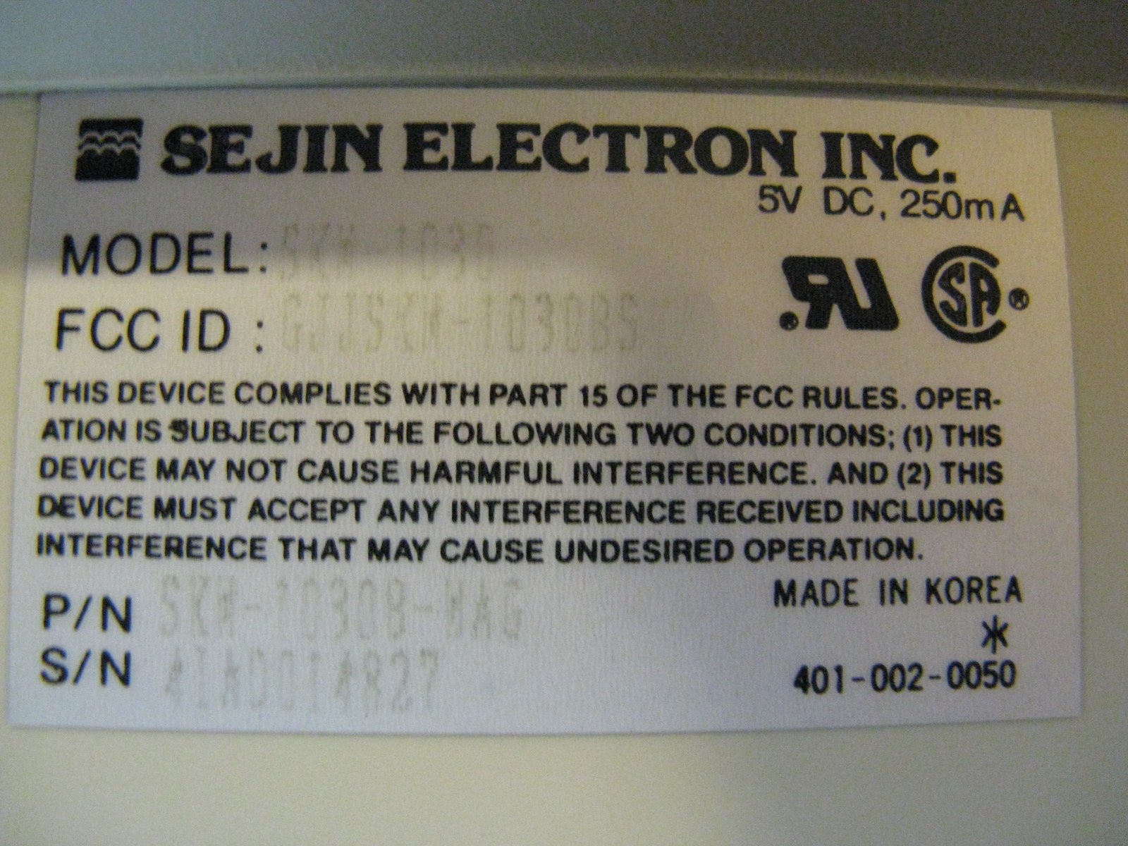

That's a normal Futaba. The term "inverse" is confusing — strictly speaking, the Cherry MX mount Futabas are the inverse ones, although visually you'd think of the normal ones as "inverted". Futaba clicky switches were mostly used by Sejin Electron, which is what you've got. Chicony used the Cherry MX mount ones, and they're less common.

gotcha............thanks!
