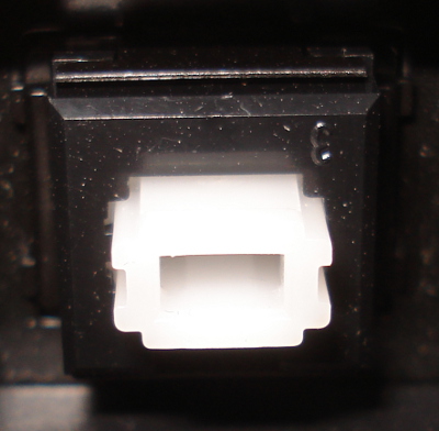

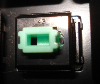

  • Ducky DK1008/1087 XM black linear switch, showing numbering (not internals) — I have a bag of these switches
  • Ducky DK1008/1087 XM green clicky switch, showing numbering (not internals)
  • Ducky DK1008/1087 XM integrated LED switch, showing numbering (not internals)
  • Filco Zero XM white clicky switch, showing numbering (not internals)

Here you go, fresh from my DK 1087! :)
27 Feb 2013, 22:31
Thanks! Good, exactly what I expected to see. (Basically, just checking whether all their switches are the same. That top number appears to be specific to their products.)

27 Feb 2013, 22:54
Voila! :)
27 Feb 2013, 22:56
Thanks. Heh, no funny business with either switch. Makes a change actually.
